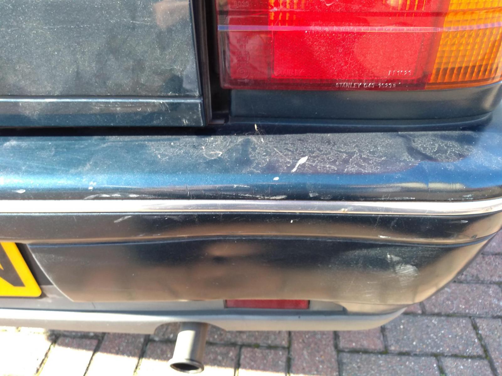

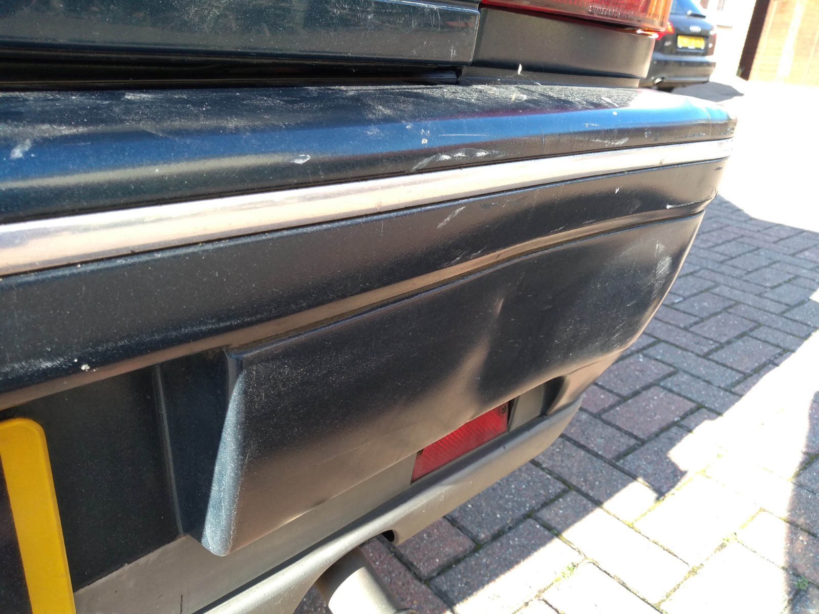

Zelandeth Posted November 7, 2018 Posted November 7, 2018 Also any photos of the damage? Just because it's by all rights beyond economical repair doesn't mean that some folks on here wouldn't take it on as a repair if the car's in otherwise good nick. Given the problems have started since the car has had a shunt I'd have a good dig around for anything that's been physically broken. If the exhaust has taken a bit it's not impossible that there's a joint cracked (the front flexible joint was always pretty fragile on these as I remember) and a leak upstream of the O2 sensor can cause quite a few odd running issues. Does this use a micro switch to detect closed throttle or just a standard potentiometer? Don't assume that serving the throttle open a bit will necessarily work - some systems will get confused if it's reporting an open throttle that's totally static for more than a few seconds, assuming that there's a fault with the throttle position. I discovered that on the Lada when the throttle cable snapped...wedging it at 25% didn't work as the value wasn't changing, it kept throwing a throttle position sensor coherence error and dropping the engine to a (very rough) idle by messing with the fuelling. Good safety feature if the throttle ever stuck open though (as happened to us on a Fiat Panda once). I'd reckon this is likely to be a wire/connector that's come off somewhere or been damaged rather than a component failure though.
Prote Posted November 7, 2018 Author Posted November 7, 2018 On 07/11/2018 at 05:19, bub2006 said: What would be the plan with the vehicle when you have finished with it too? If you are scrapping it I'd be willing to talk price for it for spares for mine.Hi, I'm in North Kent. Would be good to see it live on as a donor. I have new Pagid brake discs and Ferodo pads that are yet to be fitted. The engine's done 49k miles and is silky smooth.
Prote Posted November 7, 2018 Author Posted November 7, 2018 On 07/11/2018 at 12:33, Zelandeth said: Also any photos of the damage? Just because it's by all rights beyond economical repair doesn't mean that some folks on here wouldn't take it on as a repair if the car's in otherwise good nick.
Prote Posted November 7, 2018 Author Posted November 7, 2018 I think under the bumper something has been pushed in. The rear quarter side panel looks fine -no obvious creasing, etc but rear door needs a slam now. The interior is immaculate. Here are pics of the Proton when I bought it in May. It will need some welding to the sills for the MOT in April. It had new cambelt, water pump, tensioner, coolant/oil/filter change too. I need something reliable now as I have to look after my housebound elderly parents. michael t 1
