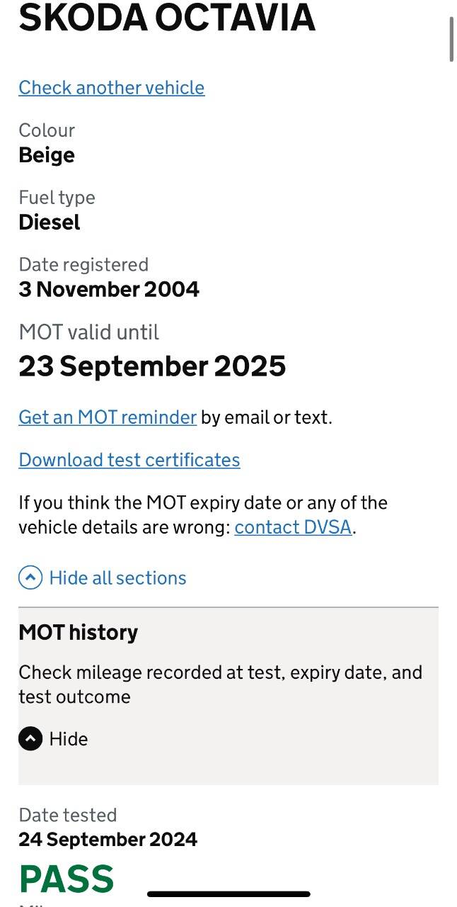

ŠKODA failed the MOT.
knackered bushes, loose headlight and not much else.
ordered the bushes and I’ll get wheel off to see how much of a knob they’re gonna be versus getting the garage to do them.

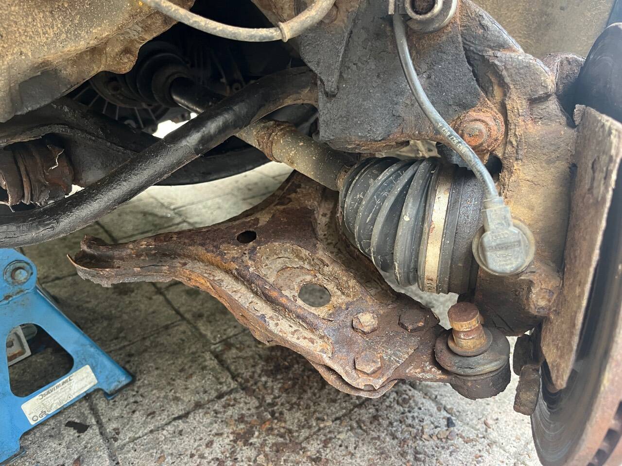

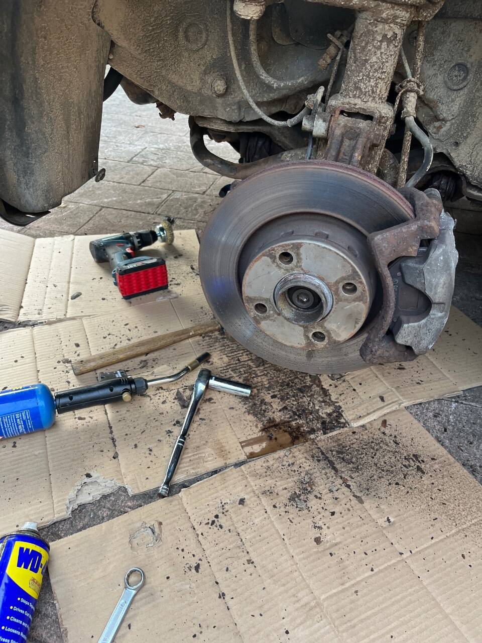

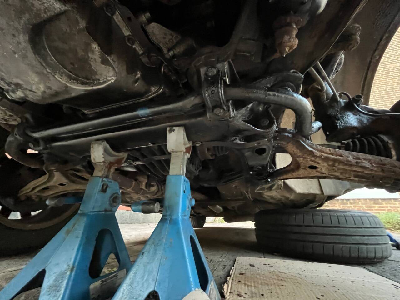

A reminder of what requires replacement, the snap off suspension arm.

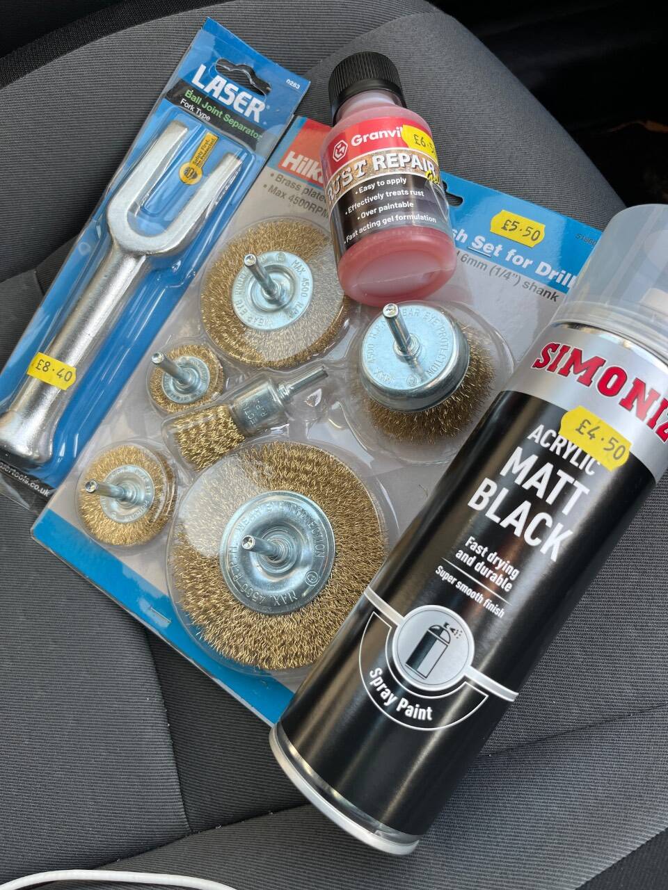

Gave the bolt a soaking of spray and set about wire brushing the grotty subframe and bits to get something more respectable to work with…
Sadly, the bolts were made of 100% Thatcherite (not for turning) so even after a fair bit of heat, I was beginning to think this was a ‘pay the man’ job.
At least a fair bit of weight saving was achieved as layers of rust and barnacles came off.

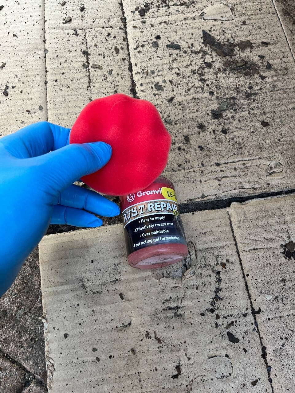

Was then a was of liberally skinning on some rust-o-gel or something and letting it sort out the surfaces.
Followed by a cuppa and then a quick swizz around underneath with a rattle can of black to tidy up and spare the blushes.
I also couldn’t budge the ball joint bolts, so it is definitely going to a garage to sort.
It untaxed and unMOT so I’ll have to book it and send it with instructions to fit and then test. Should be ok I think.

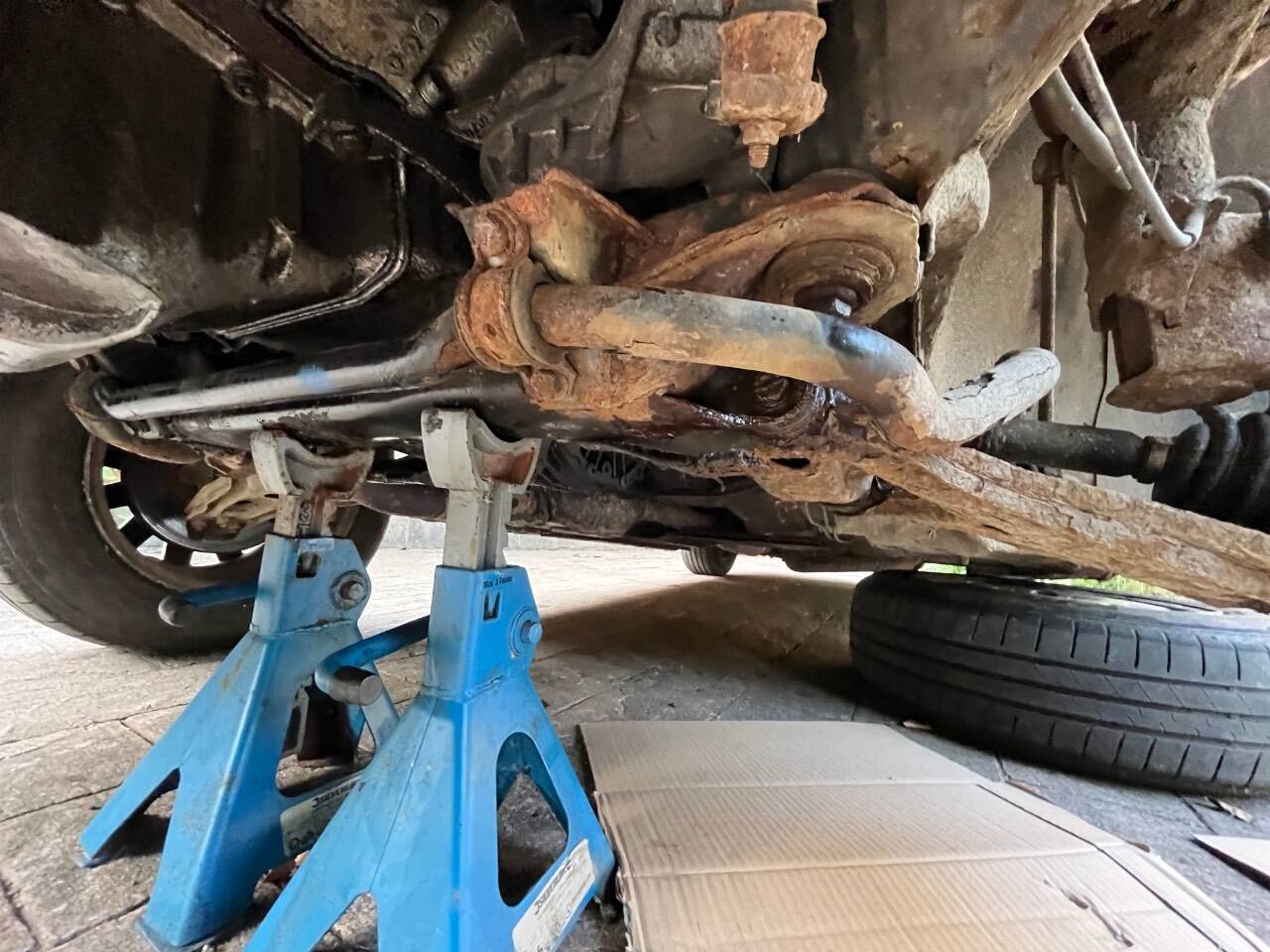

Accumulator got a quick brush, treat and spray over too.
Before
After
and a reminder of why I’m under here..
Currently left like this awaiting the wheel to go back on and me to book into a garage.

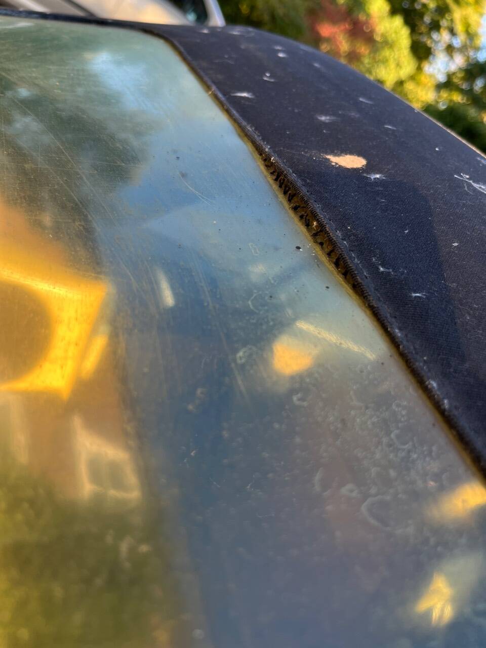

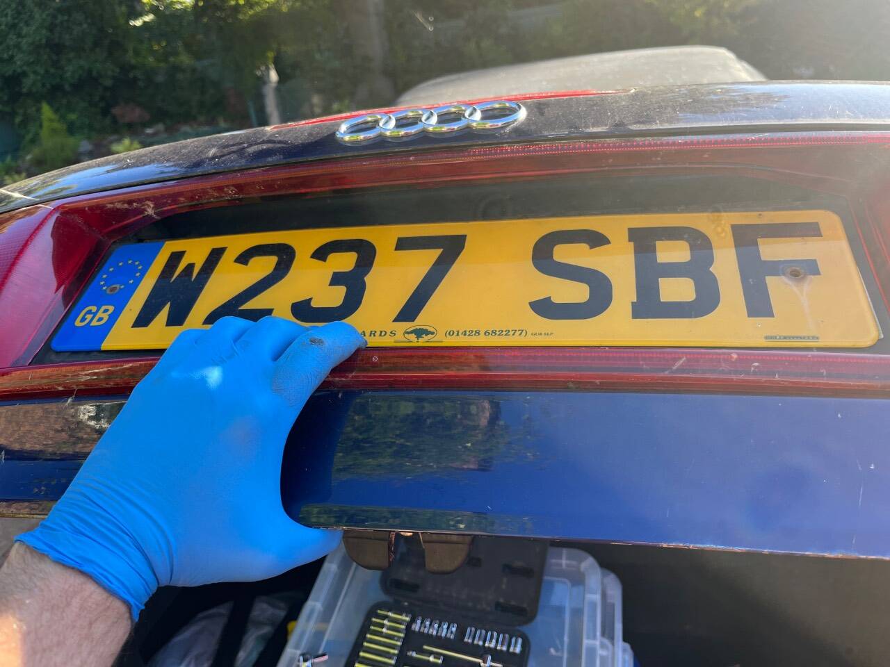

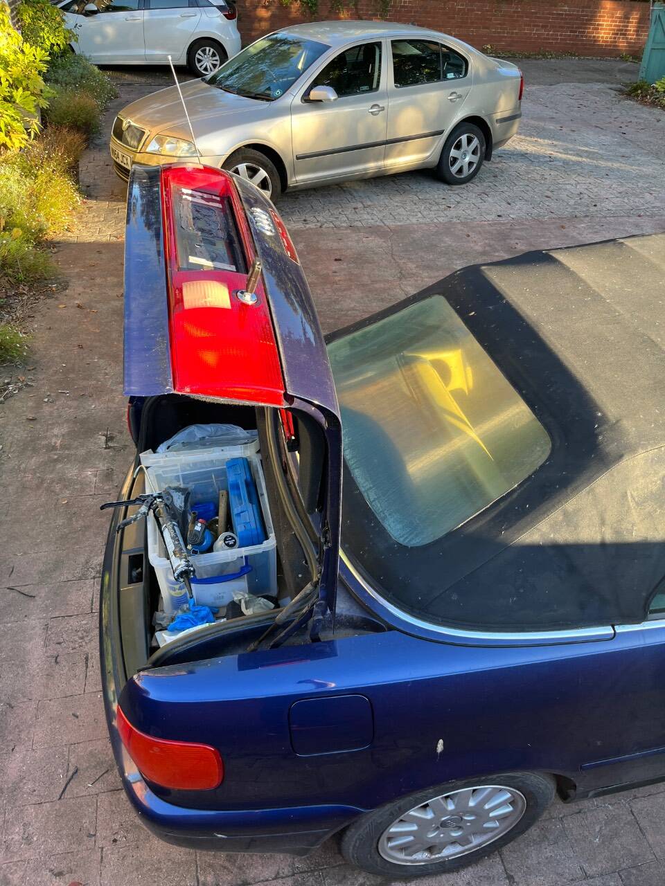

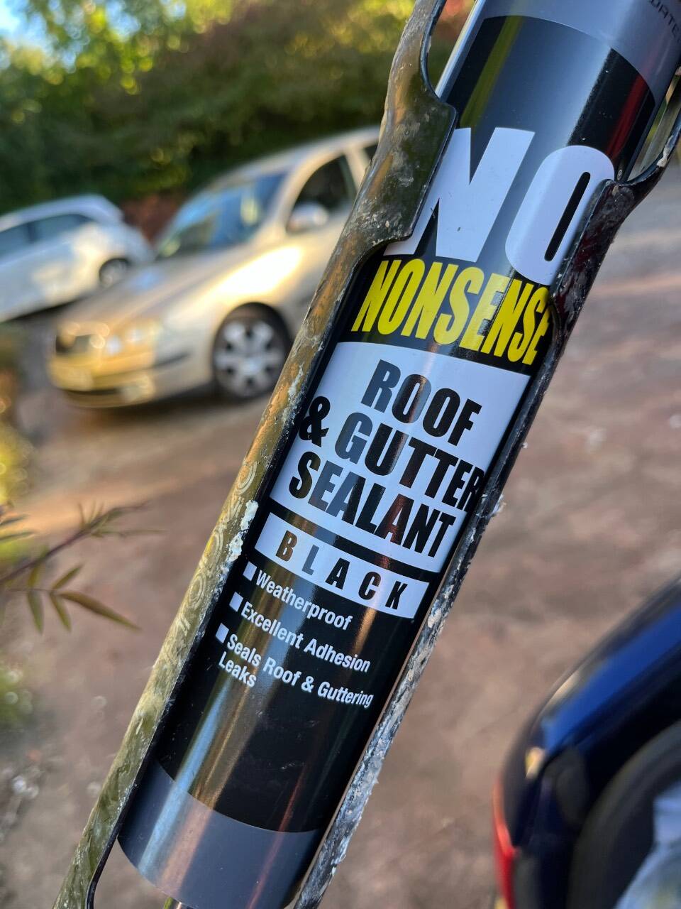

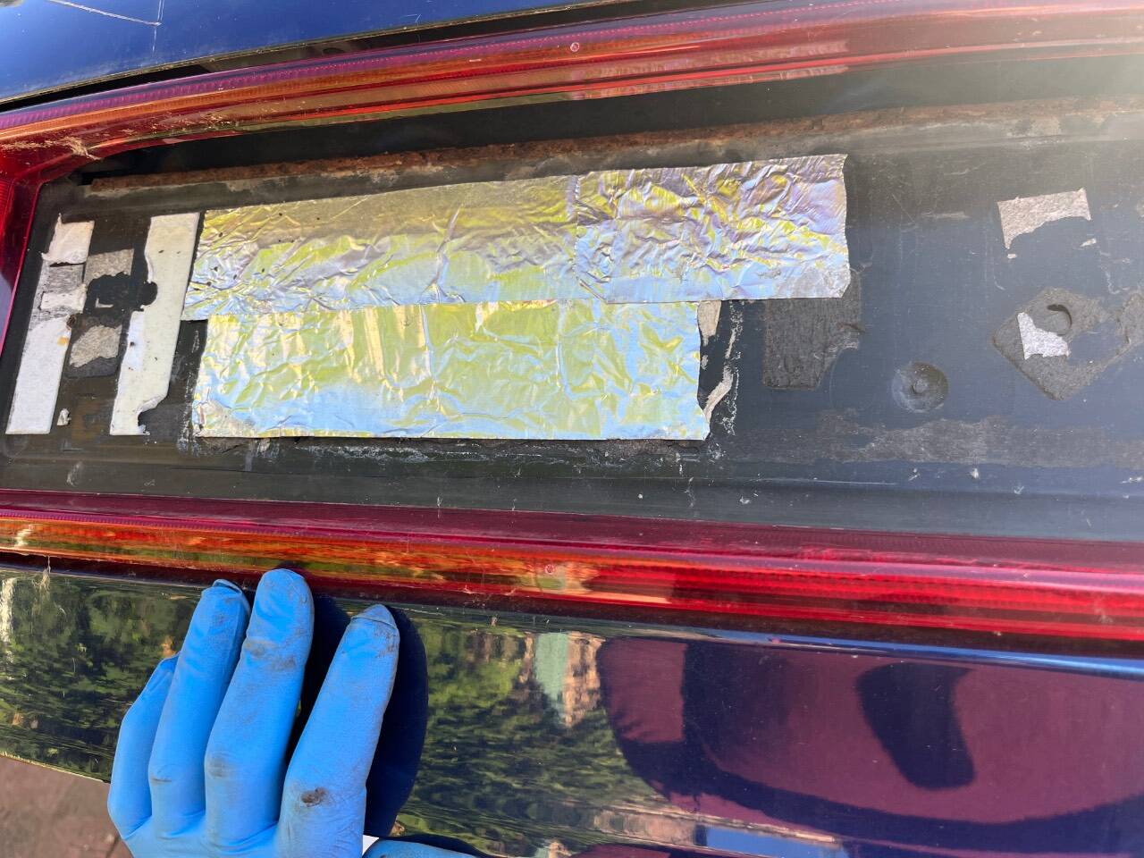

In need of more tinkering, I deduced to tackle the leaky boot. There was rumor of a hole of sorts behind the number plate that caused a lot of water ingress to the boot lid. Main issue was not corrosion but the sheer damn weight it made the boot when trying to lift it in anything but bone dry weather.
Lets take a peek…
Ah yes, waterproof* tinfoil tape
Ah yes, perfectly* sealed plastic cutout and stuff back in piece.
Stanley blade required and many wipes to clean the gasket sealant away and prep the surface for a new and improved bodge.
Splodges
Precision smooshes
Drying in the sun
And a bit of mastic on the bolts for good measure…
I also noticed the roof was starting to come away so put a dab of gasket sealant in there, pending a better solution.
All that remained was to remember to put the wheel on from yesterday, move the axles stands safely out of the way and drop the car…
Oops…
Quick rejack and shuffle and all good with no lasting damage. 😅
Started it up and walked around the lights and bits pre-mot, let’s hope we get something back on the road.

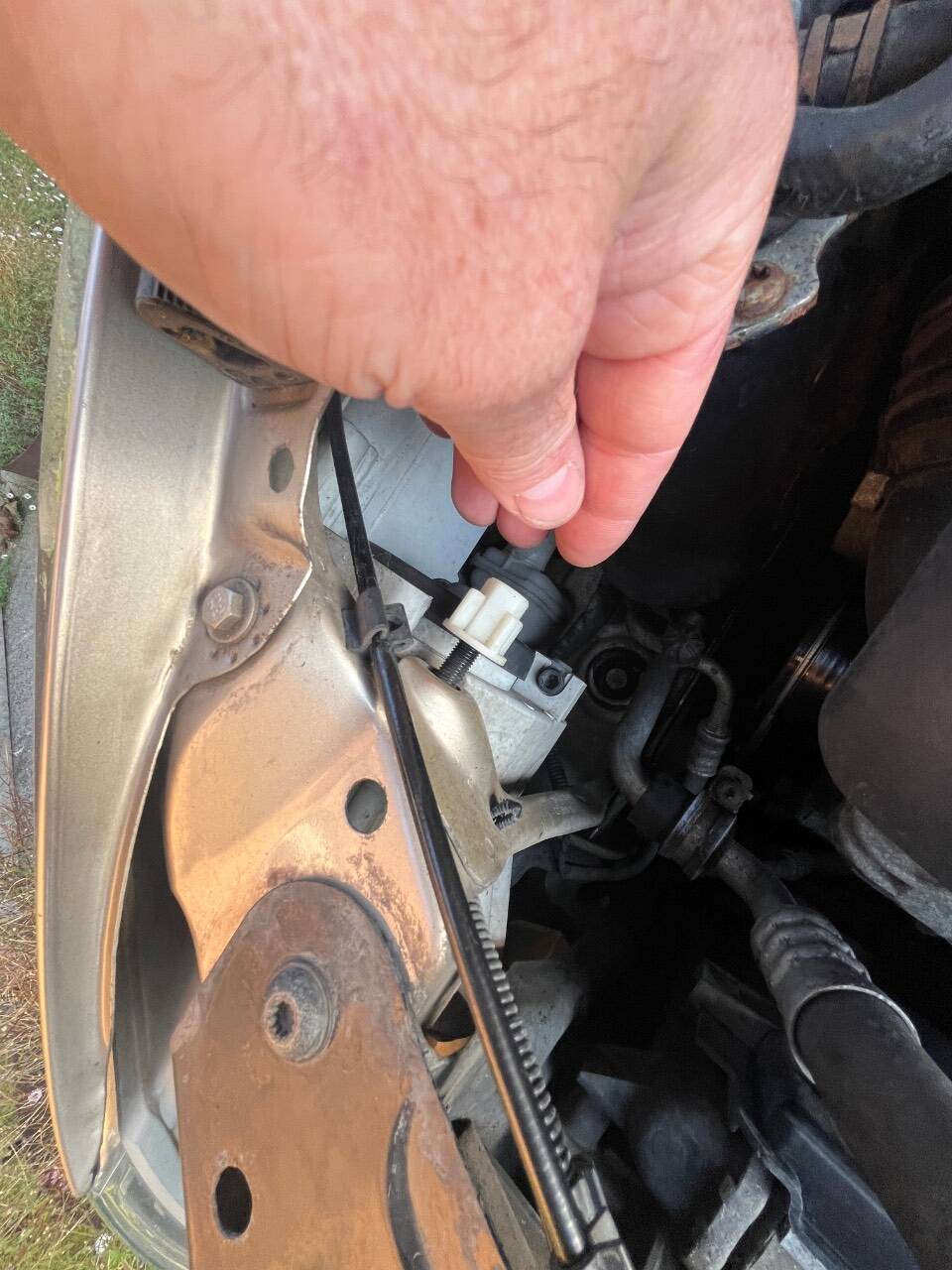

Few bits today, got the nut/bolt part I needed from the main dealer, only £1.50 so that was good.

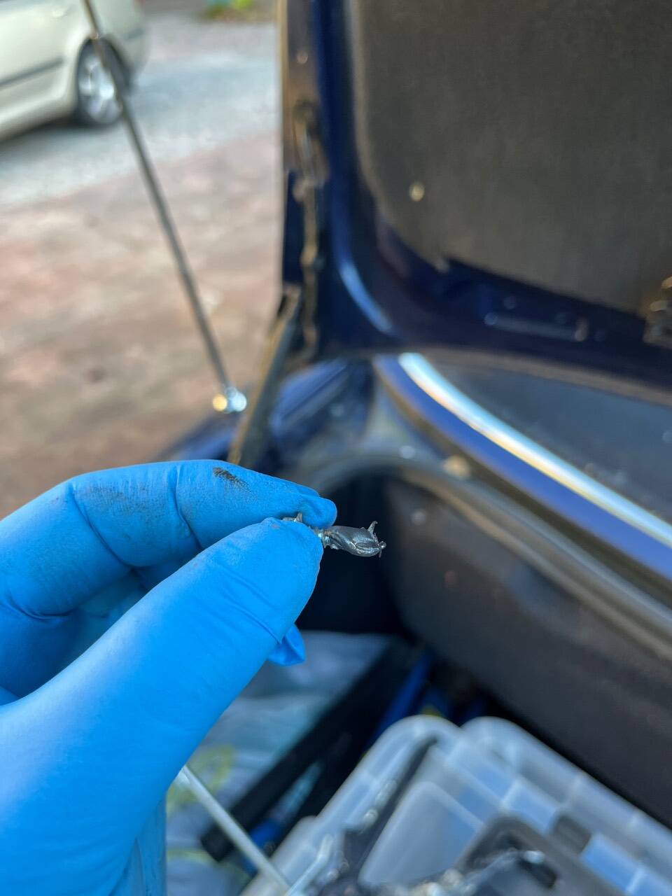

The long bolt was on back order so my plan was to take out the original bolt and see what I could find in the garage that would fit the same thread.

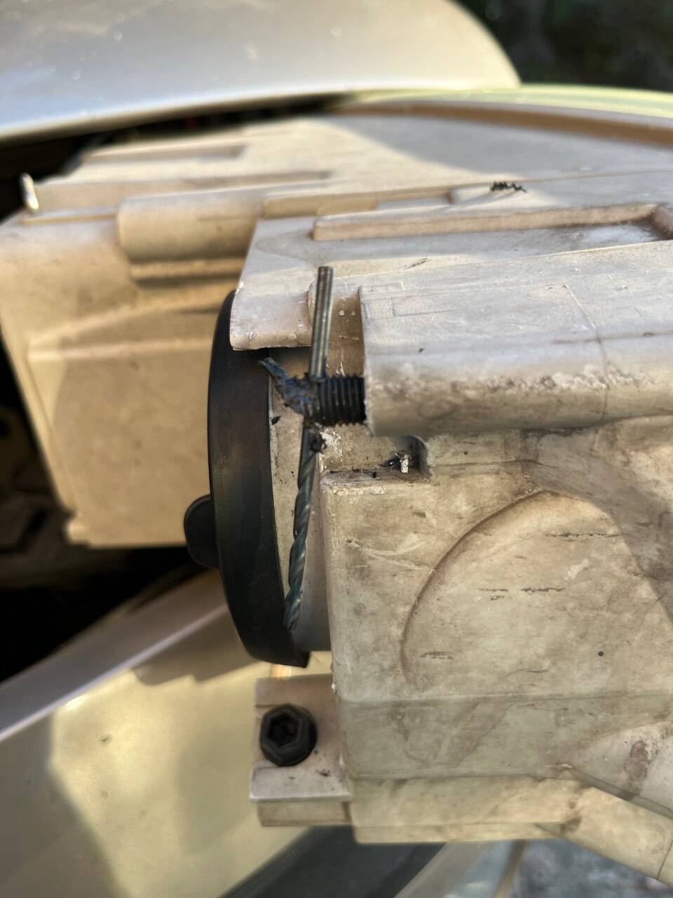

After taking the airbox out and a few bits, I realised the Octavia has pop out headlights 🤣. So a short bit of reassembly later and I was left with just the headlight to sort.
Even then, I literally didn’t have much to work with. The plaggy bolt was snapped and resisted attempts to remove it.
I had the idea of drilling through the small bit sticking out and seeing if I could use the drill bit as an unwinding key.
Much success

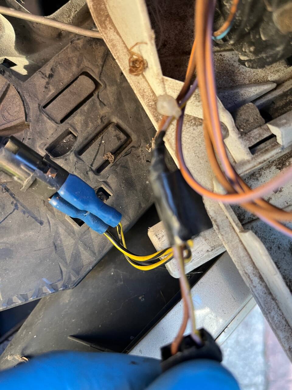

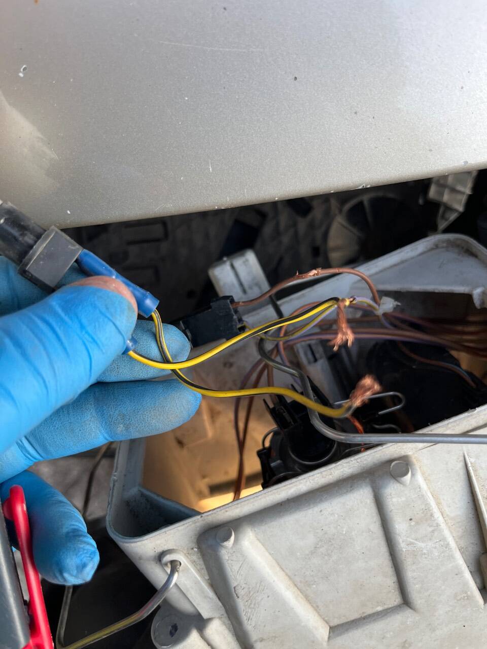

Now it should have been a case of getting in  and teasing  the sidelight out for a quick bulb swap…
…ah, who doesn’t love bodge wires?
Answers on a postcard…
I did a bit of fannying about and I could get the bulb on via hijacking the other wires but there seemed no live feed to this sidelight.
It felt too much like a faff to start to disassemble the light interior and trace the wire so I opted for a new compete unit for the sake of £50

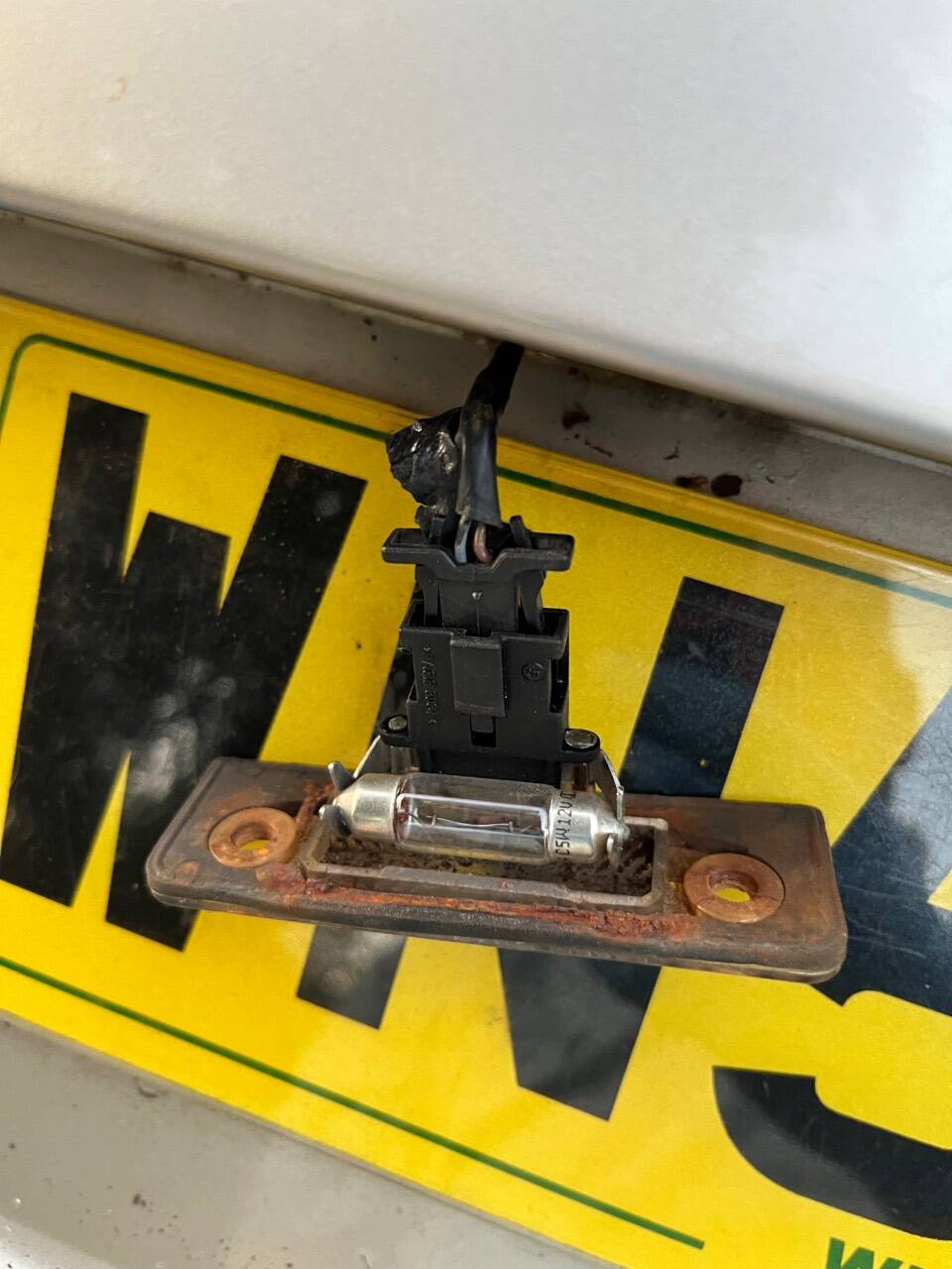

- I can probably flog my battered one for a tenner at a push.

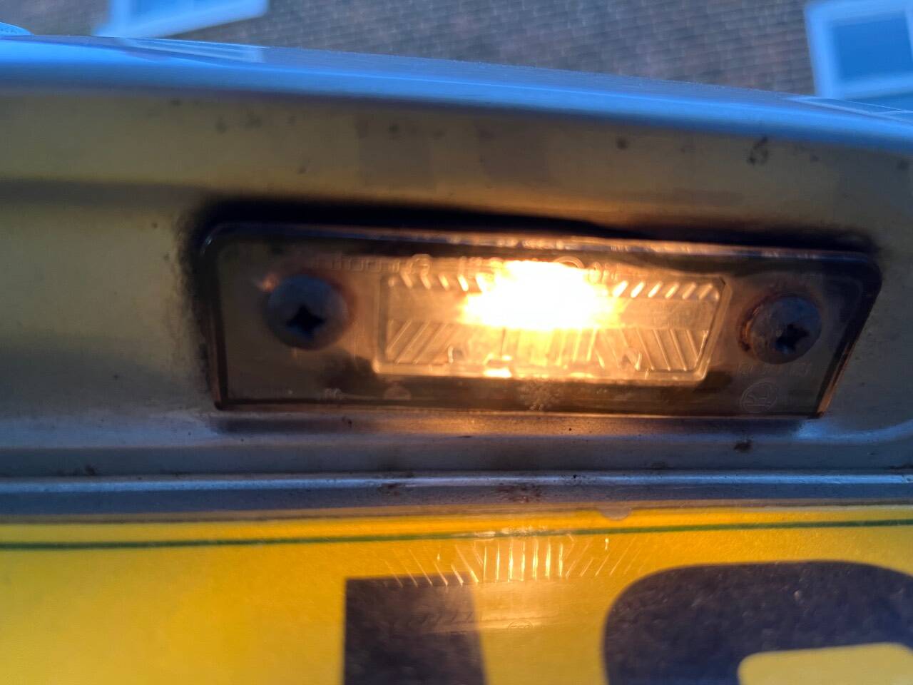

so, pending a new delivery, on to the rear light.
Not much to say, I’d ordered some new LED eBay lights (not a big fan but it’s my WDOB not a keeper) but the holes were not in alignment properly plus they looked shit.
So plan b was to get the old unit, run it under the hot tap to clear all the crap off, dry it out and straighten the pins.
It looked like a pin had been bent pushing it in and so it wasn’t actually connected.
Fixed it and checked before screwing back in and much success.
Done.

Opening the light cluster on the passenger side had revealed some interesting* wiring.
Rather than try and fix it internally in the light case. I just shelled out for a new light unit, the old one looked pretty yellow and manky anyway so for the sake of £50 it made sense to get a new one.

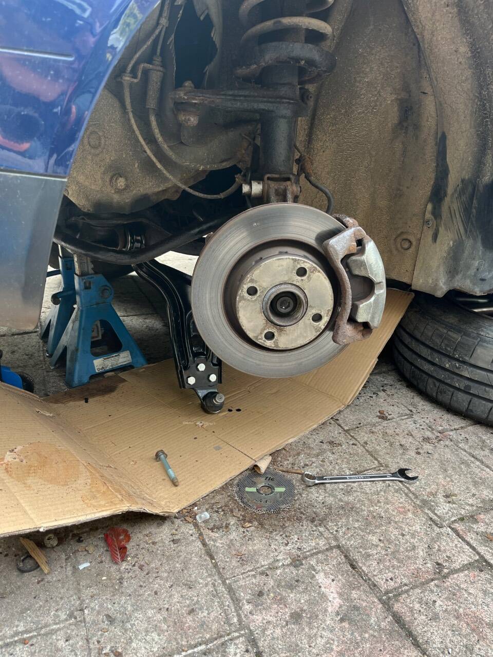

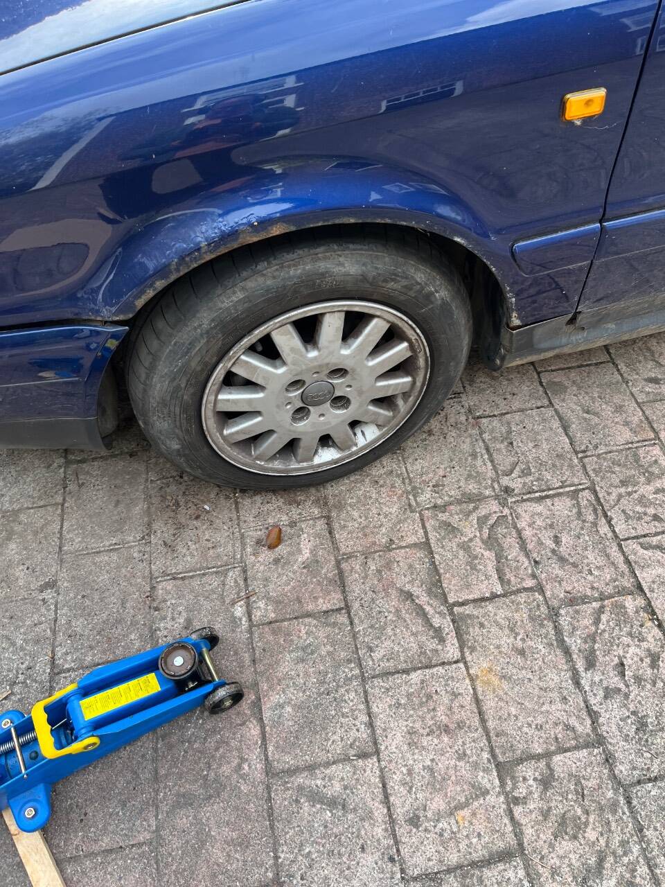

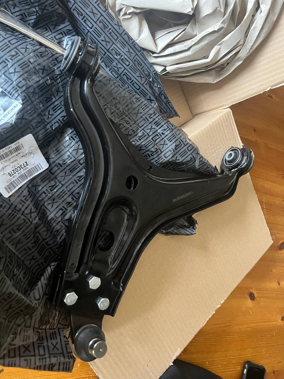

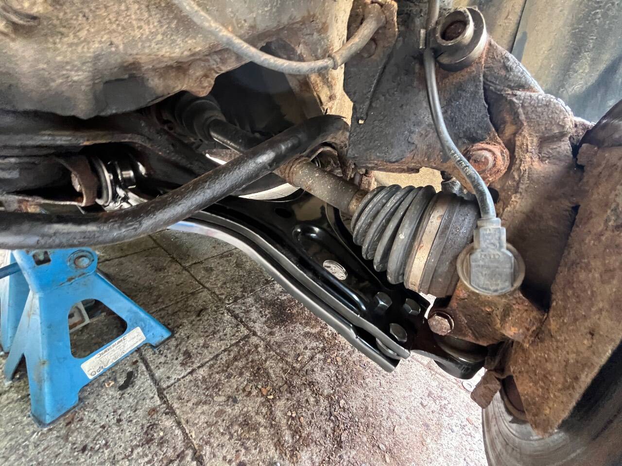

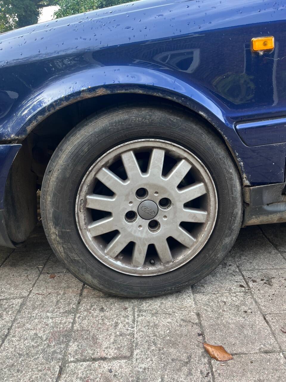

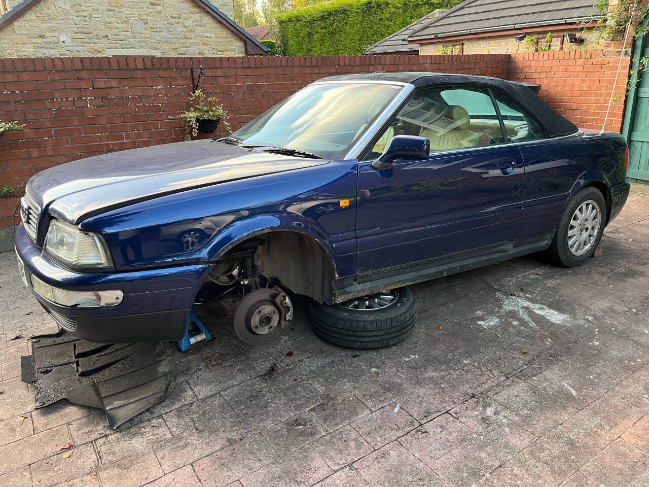

Despite saying I wouldn’t do this at home and going so far as booking it in the garage for them to do the bottom arm, the Audi had other ideas.

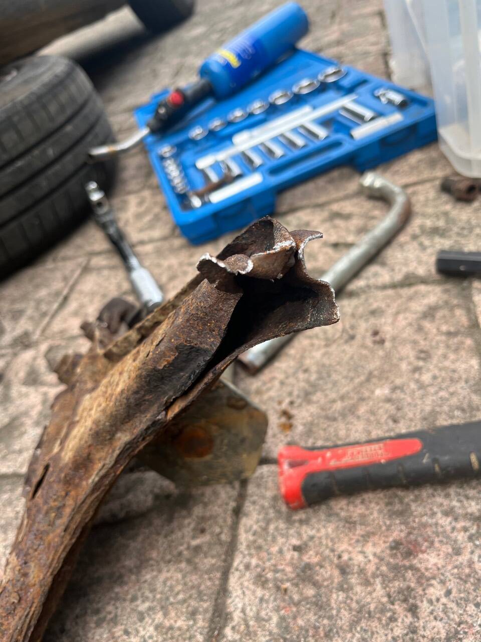

Moving it off the drive this morning resulted in a grim sounding thunk and this…
The arm had snapped 🤨
I spent a bit of time debating whether to ring the garage and get them to tow it or whether to just have a crack at it.
I had some time on my hands so opted for the latter.
Last week’s spray with WD40 has had time to work and I was a bit more motivated to get it done and so the ball joint came undone.

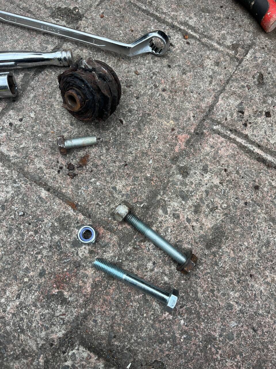

Arm was totally shot, with the ball joint out, I was able to push the arm back and shear the other side off by hand.😳
This made access a lot easier to get at the bolts. But I needed to pop and buy a set of swan neck spanners first.
First side came out nice and easy.

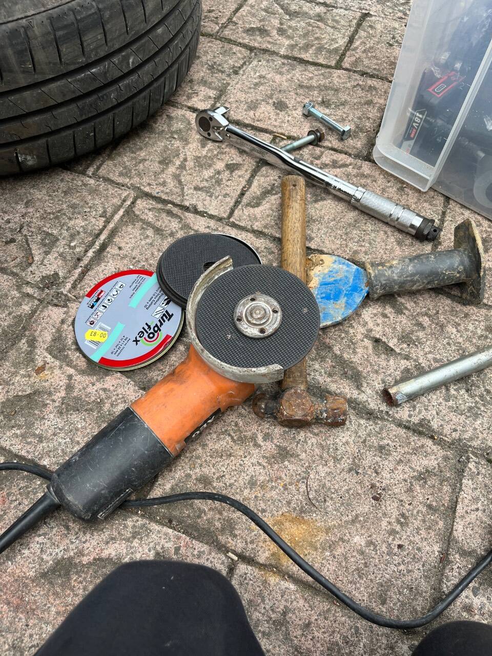

Second side did not. The nut came about 80% off but the thread was too crusty and no amount of swearing, spraying, heat or futile hammering would free it off.
Palm is bruised from the increasingly stiff turns of the spanners to try and shift it.
Another pop to the local motor factors shop was required to get some cutting discs and a new bolt for what was coming next..
Sadly couldn’t get hold of a proper high tensile bolt so this is a temporary fix to get to the garage tomorrow and sort.
A short while later…
In she goes…
Much better
Looking much better and all set for tomorrow’s run down for a bolt swap out and hopefully an MOT 🤞
