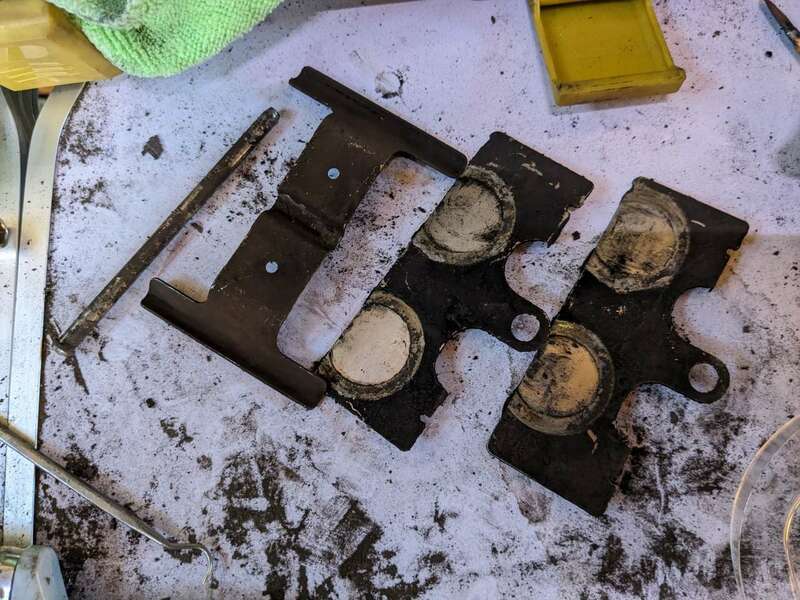

I had new pads to go along with the skimmed discs. Didn't get new fitting hardware because ££££ so just cleaned up the old bits. Before and after.

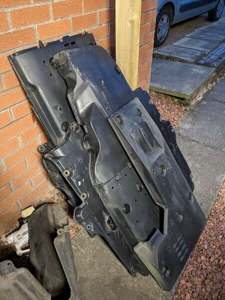

I had already got the car entirely in the air in preparation. All the plastic undertrays, arch liners etc had to come off and on this there are plenty of them. Gave the underside a clean with the pressure washer and some Screwfix degreaser.

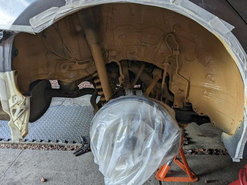

It took a bit of foutering to get the gun dialled in, the first arch I sprayed it on way too thick, like icing on a cake...
Once I got it dialled in I used the stuff quite efficiently. Here is how the arches look with the liners back in;
Given how clean the rest of it now was, I gave the undertrays a clean with some degreaser before refitting.

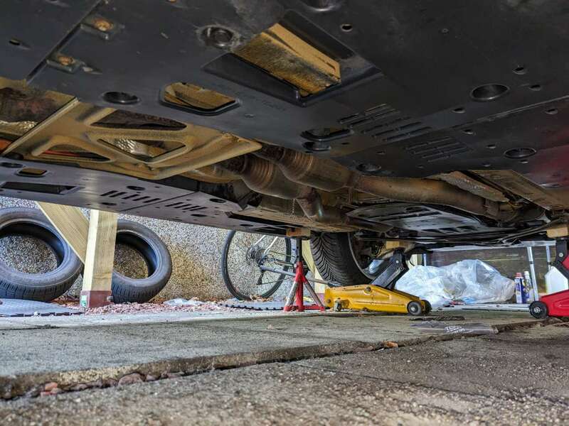

And the finished underside;

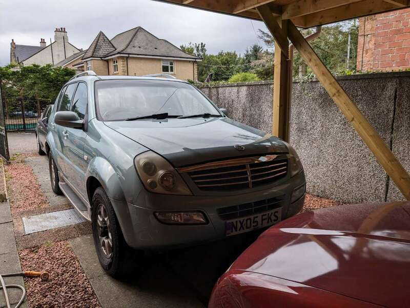

I've been doing a good job of not buying any cars recently. Maintaining my ideal fleet of three vehicles for several months. When @sdkrc offered his veg friendly Rexton 290 for sale though I was powerless to resist. I supressed my feelings of deep dread and anxiety and agreed to take it on. Sam  even delivered it to my door and offered most agreeable payment terms. A+++ seller, would recommend.
It was very fairly described so I knew there were a couple of issues needing prompt attention and that it is generally pretty baggy. I get the impression this the actual running gear etc are very robust but that everything else is less so and hasn't worn the miles well. It's sub 20 years old, but with it's considerable bulk, old school five pot diesel and separate chassis it feels like a big old truck. Evidence below of said bagginess, yes, that is it in gear.
In truth the main selling point is the license built Mercedes OM662 engine under the bonnet. It's a 2.9 litre, 5 cylinder, turbocharged (not that you'd know it) with I believe a fully mechanical fuel injection setup. This engines prowess in alternative fuel running is legendary and hard to beat for veg oil running.

The kind of motor car other road users park two spaces away from in the supermarket car park.
Glad it's not just me who saw that 🤣
The thing is monolithic, if I park it in the car port I can hardly get round it and it has an eclipse effect on the strip lights on the roof.
