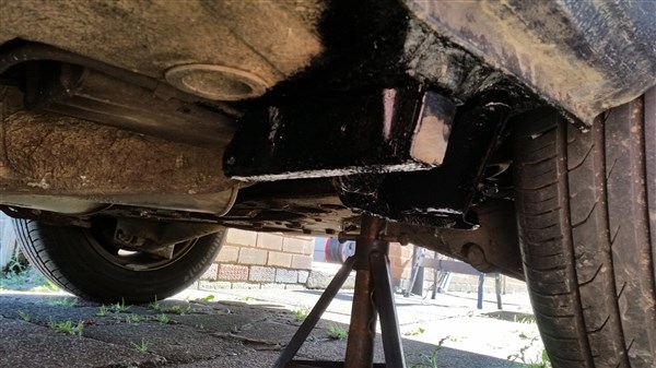

The now completely ruined arch
Richardthestag's MOT man must need to clean his glasses as I found this 4" long hole on the seam of the NSF floor/arch joint, about 3" from a jacking point & less from a chassis rail so should have been a fail I think. I'll have to get it welded at some point in the next 11 1/2 months.

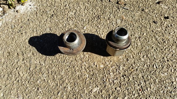

One wheel nut on NSR was missing it's thick washer so wasn't clamping the wheel properly, I found a slightly large OD washer with a slightly small ID. I quick wizz around the inside with a grinding stone made it a nice tight fit on the nut & once hammered on it sits in the slot for the washers without falling off. It even fits in the hole in the wheel :)
I ended up wire brushing right along the inside edge of the sills & all four corners of the floor pan as it had surface grot etc, here's a before & after of the NSR.
