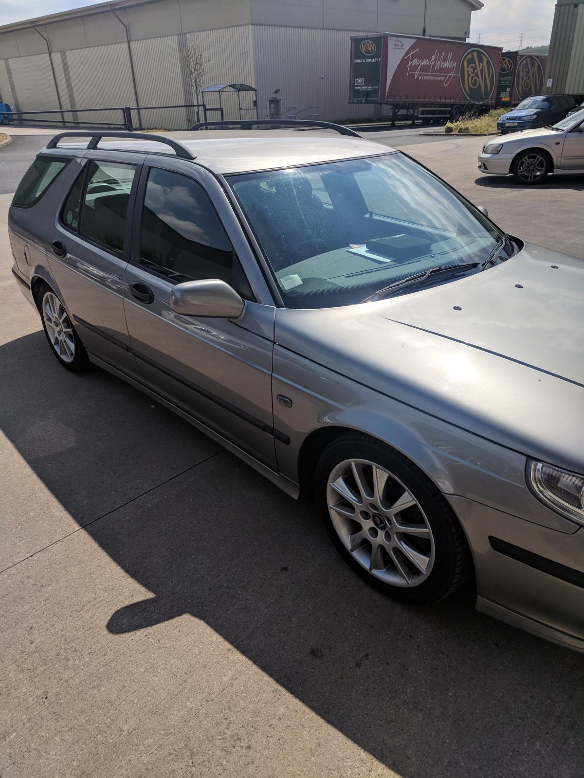

I thought I might as well start a thread to put updates in rather the polluting the news 24. I've been over to Manchester with work today which has given me a good run out to get used to her and whilst it's mostly good there are of course a few niggles. I do like the way it drives and I have to say in spite of the mismatched rear shockers it handles better than I though it would given its dubious ancestry and obscene amount of power through the front wheels. Also the ride isn't as stiff as I feared (although it's probably as well I came at it from the stiffly-sprung Primera rather than a Citroen...) Sitting in the leather armchair cruising along it's a very fine place to be listening to the excellent stereo and generally feeling like a winner.
