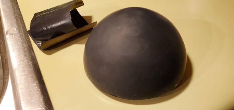

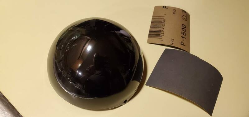

PhilA Posted November 24, 2020 Author Posted November 24, 2020 One lid, shiny but far from smooth. 600-grit paper, dish soap and a touch of water. Smooth down and caress with the paper. With still fairly soft paint you can't just rub at it, it'll clog the paper then rip up (the paint) and put deep scratches into the surface. You can feel when it's working well, the dish soap lubricates nicely while taking the sanded off paint away; you can hear the gentle hiss of the paper across the surface working at it gently. Patience is essential. First pass complete. Dried off with paper. High spots have been taken down to a matte finish, remaining low points are still gloss. Repeat until low spots vanish. Then, the same all over but with 1500 grit paper and dried. That's now nice and level, ready for another coat of paint and the process to be repeated. Phil LightBulbFun, DeeJay, Saabnut and 2 others 5

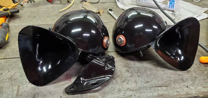

PhilA Posted November 25, 2020 Author Posted November 25, 2020 Second coat of black. Gearbox only acts the fool when it's heat soaked. I have a theory. I'm going to test said theory next week. Watch this space. Phil LightBulbFun, Coprolalia and Dan_ZTT 3

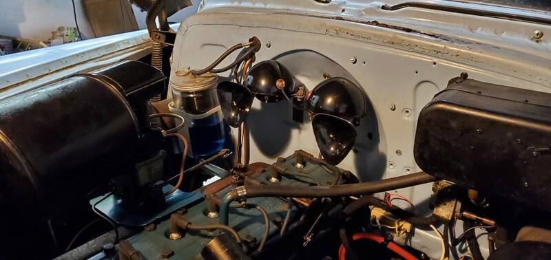

PhilA Posted November 28, 2020 Author Posted November 28, 2020 Finished painting the horns. Now they need a bracket making up. Phil Saabnut, mercedade, hairnet and 1 other 4

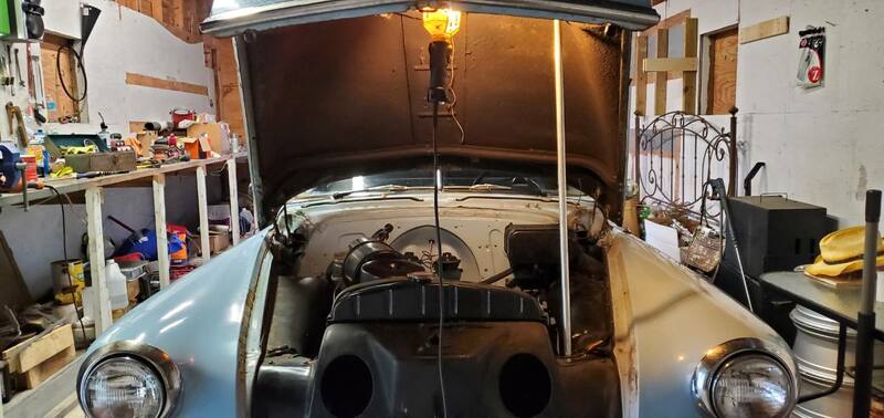

PhilA Posted November 30, 2020 Author Posted November 30, 2020 Drilled the rivets out that hold the brackets together. Need to relocate them clocked round the horn a little, started on that yesterday but ran out of time. I did do something i have been meaning to fit a while, cut the top off a shanked bolt (looks like it was for suspension or something) and cleaned it up. Set it in place of one of the panel bolts. Now the rod I use to prop the hood up properly can't slip. Better for being parked up at shows with it open, too. Phil Saabnut, hairnet, Dan_ZTT and 4 others 7

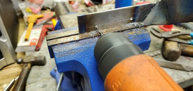

PhilA Posted December 1, 2020 Author Posted December 1, 2020 I did things with fire and hammers. Drilled holes. Realized I measured wrong and gonna have to start over again. But it's a start. Phil RayMK, LightBulbFun and MorrisItalSLX 3

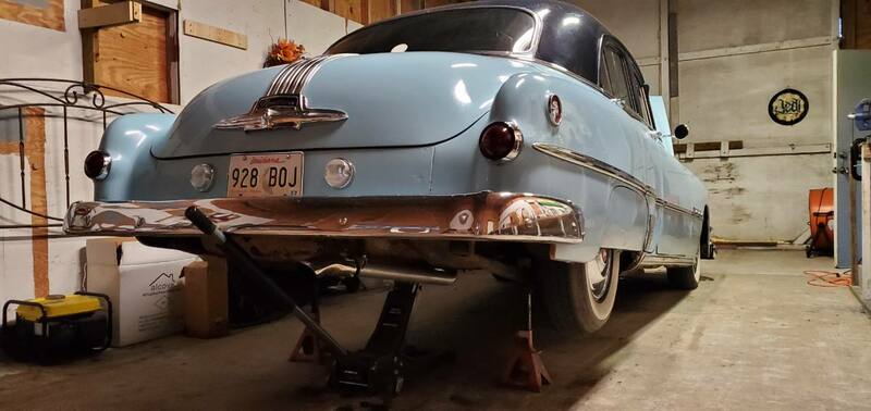

PhilA Posted December 4, 2020 Author Posted December 4, 2020 I think I need to get up under the car again and check things- I've got a vibration that feels like the propshaft starting to kick in. Greeeeeaaat. Wouldn't surprise me, many years devoid of grease, and it was a bit clink clank when I got it. Phil
PhilA Posted December 4, 2020 Author Posted December 4, 2020 Jacked the car up. Right rear wheel is soaked in EP90 but the hardy spicers are ok The clink clank is the differential and splines. Rear axle rebuild time. Phil puddlethumper, Saabnut and GBJ 3

PhilA Posted December 5, 2020 Author Posted December 5, 2020 I put some "stop leaking and shut up" in the axle. Adjusted brakes. Changed oil. Greased suspension. Tightened fuel sender, was loose. Cleaned it. Will be ok for now. Phil loserone and LightBulbFun 2

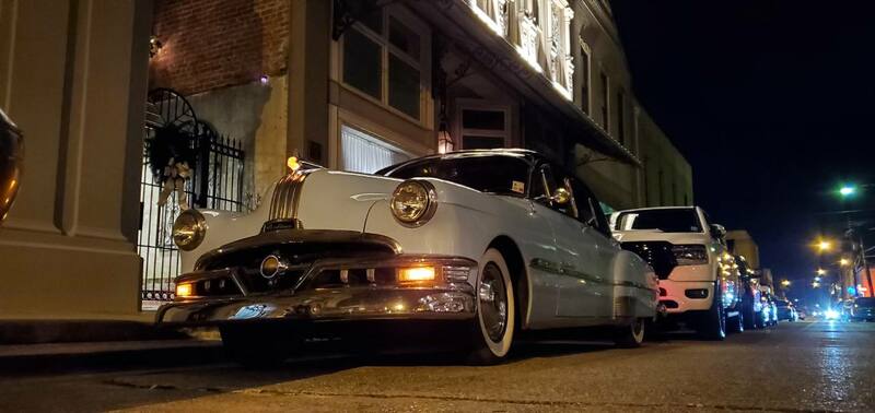

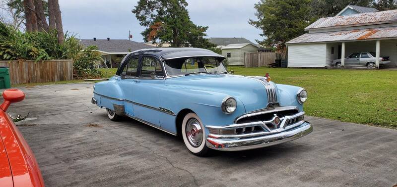

PhilA Posted December 6, 2020 Author Posted December 6, 2020 76 miles. Half a tank of fuel. One breakdown. Unforecast rain. Phil LightBulbFun and Dan_ZTT 2
busmansholiday Posted December 6, 2020 Posted December 6, 2020 That's a big car that looks very small compared with the thing behind it. What went wrong, apart from it raining?
PhilA Posted December 6, 2020 Author Posted December 6, 2020 3 hours ago, busmansholiday said: That's a big car that looks very small compared with the thing behind it. What went wrong, apart from it raining? I adjusted the rear right brake slightly too tight and it got hot, bound up and got a little smoky. I jacked the car up on the shoulder, backed the adjuster off enough to stop it getting hot but the bias needs to be reset. Phil
