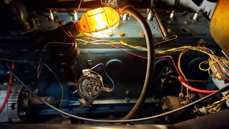

PhilA Posted June 22, 2020 Author Posted June 22, 2020 Still hot in the garage. Managed at some point to soak this wiring with oil. The looming tape went all gooey. Removed it in prep to fit heavier gauge wiring to the alternator and battery primary circuits. Now I smell of diesel. But it did remove the goop from my fingers. Phil Skizzer, scdan4, GrumpiusMaximus and 1 other 4
PhilA Posted June 22, 2020 Author Posted June 22, 2020 Crimped and soldered a suitable O-ring onto the new alternator output wire. Got it all lined up and started to loom it back together. Ran out of enthusiasm and rebuilt the inline resistance under the dash that goes in parallel with the GEN bulb. The bulb by itself is inadequate to get the circuit to start charging at low enough RPM, so a resistor in parallel helps with this. It also has the added benefit that if the bulb burns the circuit is still complete and the alternator will still charge. Handy because the bulbs aren't off the shelf any more (they used to be though, which sucks). Phil LightBulbFun and GrumpiusMaximus 2

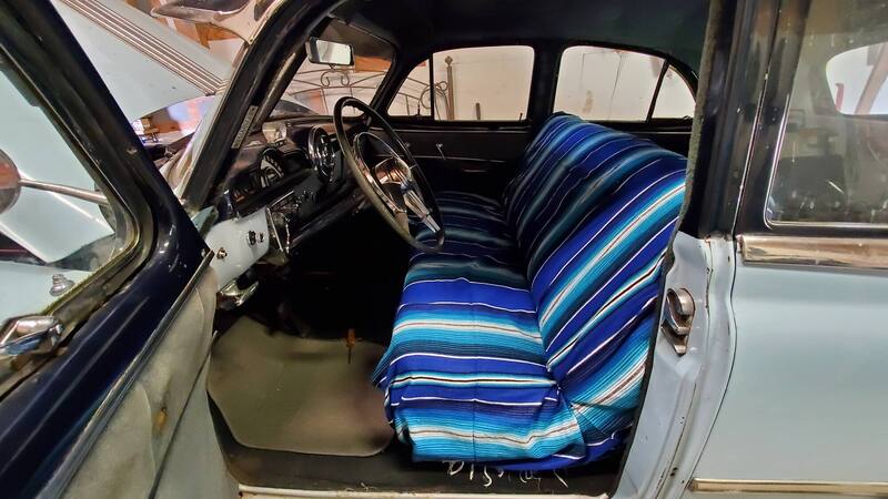

PhilA Posted June 27, 2020 Author Posted June 27, 2020 Washed and put in properly. Phil GrumpiusMaximus, Tickman, Asimo and 6 others 9
PhilA Posted June 28, 2020 Author Posted June 28, 2020 Ok, this is on pause for a little bit right now...
hairnet Posted June 28, 2020 Posted June 28, 2020 you liked the covers so much theyre on the chairs in the house and the boss beat you up?? hope the weathers not done the dirty on you
