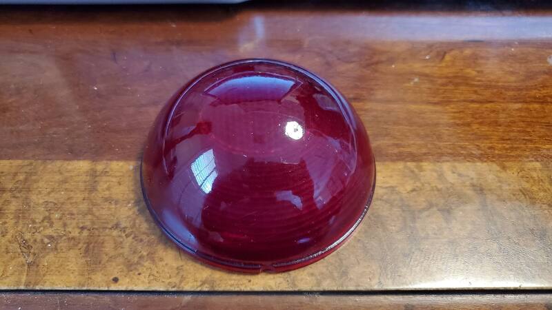

hairnet Posted March 26, 2020 Posted March 26, 2020 the first pic looks like its been cling filmed LightBulbFun 1
PhilA Posted March 26, 2020 Author Posted March 26, 2020 Clear coat on the passenger side lens. Second coat on the driver's side, which needs to be rubbed down a bit to get the lacquer to bridge the cracks. Phil paulplom, LightBulbFun, Skizzer and 2 others 5

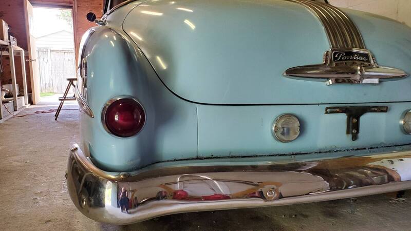

PhilA Posted March 27, 2020 Author Posted March 27, 2020 Fixed the lamp holder. Bueno. Phil egg, DeeJay, Skizzer and 5 others 8
PhilA Posted March 28, 2020 Author Posted March 28, 2020 18 minutes ago, Zelandeth said: Looks good! It even lights up evenly now because previous keeper had transposed L and R light buckets (they're slightly offset). Please note that the light, in reality, is deep red. Not mauve, as my camera decided. Phil LightBulbFun and cobblers 2
hairnet Posted March 28, 2020 Posted March 28, 2020 camera needs shouting at or threatening with replacement
LightBulbFun Posted March 28, 2020 Posted March 28, 2020 55 minutes ago, hairnet said: camera needs shouting at or threatening with replacement sadly deep red is something a lot of cameras struggle with as shown here on my Crompton military Ruby red 60W rough service lamp, (from what I understand used on submarines etc, at night so should the submarine have to surface, the crews eyes don't have to take so long to adjust to the darkness) its a very beautiful deep red colour (as the glass is made from very dark natural red glass) but the camera utterly fails to pick it up properly sadly paulplom 1

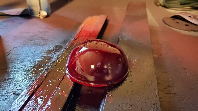

PhilA Posted March 29, 2020 Author Posted March 29, 2020 Final coat of red. Clear to follow, then flatting, cutting, polishing and wax. Phil LightBulbFun and Skizzer 2
