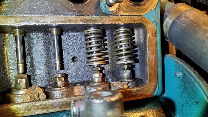

PhilA Posted December 27, 2019 Author Posted December 27, 2019 I cut down a toothbrush and fitted the head into a piece of dowel. Trimmed the bristles and checked for fitment- success. It's clamped now so the glue can fully set overnight. The guides should clean up, I'll lap the seats and reassemble. So far so good Phil paulplom, somewhatfoolish and LightBulbFun 3
PhilA Posted December 27, 2019 Author Posted December 27, 2019 Glue alone didn't work, so I drilled a 1/16" hole through the top of the stick to hold the brush on, and hammered a pin through to hold it in place. This proved successful and the guides cleaned up, with the brush and brake cleaner flushing through into cloth below. Started to lap the valves in. Ran out of time but it's starting to look good already. Phil scdan4, spartacus, adw1977 and 4 others 7
PhilA Posted December 31, 2019 Author Posted December 31, 2019 Got this far with the valves. Engine needs to be rotated to bring the followers off the cam to do the rest. Phil LightBulbFun, RayMK, LabRat and 9 others 11 1
DeeJay Posted January 1, 2020 Posted January 1, 2020 Now you have to polish the rest to match the valves. PhilA 1

PhilA Posted January 11, 2020 Author Posted January 11, 2020 Yup, been past the one outside Buffalo earlier this year Valve arrived though. I'll be getting that fitted up tomorrow if all goes well. Phil LightBulbFun and Skizzer 2
PhilA Posted January 11, 2020 Author Posted January 11, 2020 Had a few minutes, lapped the new valve into the seat, cleaned and fitted #1 intake and exhaust and set the clearances to 13 thou'. Phil Skizzer and LightBulbFun 2
PhilA Posted January 12, 2020 Author Posted January 12, 2020 Feeling rough as arses today so didn't get much done. #6 intake and exhaust put together and clearances set. I may film the rigamarole it is putting it together. Phil LightBulbFun and paulplom 2
