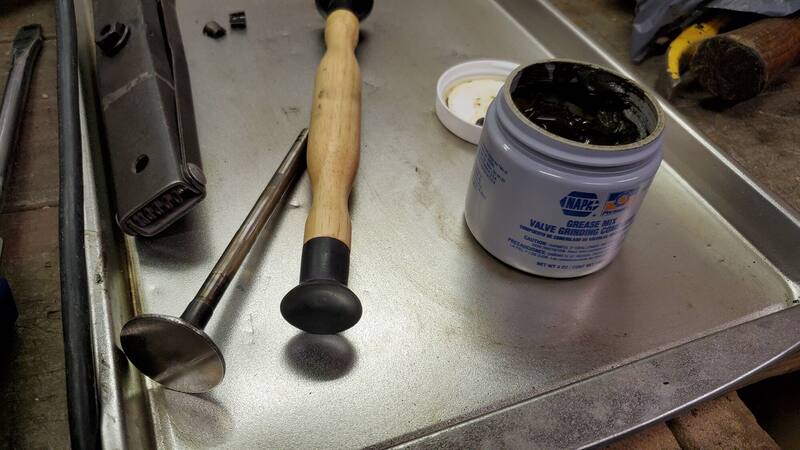

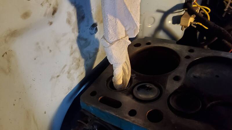

PhilA Posted December 15, 2019 Author Posted December 15, 2019 Today started with valve tool. Needed a little adjustment to fit but works nicely. Fought with this valve. It took 40 minutes to remove from the guide. Once it was out, the guide was inspected. Dirty but otherwise good. Wrapped some cloth around a screwdriver and gave it a clean out. Polished the valve. That's gotta be worth at least 5 horsepower. Grabbed my valve tool and carborundum paste. Not the most wieldy position to be in. Does give an idea of scale though. I'm 5'7". Pulled the second exhaust valve but whoever put these valves in didn't lap them to the seat. It was sealing around maybe 1/8th of its circumference. I'm guessing that's the valve that would "wheeze". Packed it up for today. Exhausting work. Phil purplebargeken, Jim Bell, LightBulbFun and 7 others 8 2
Zelandeth Posted December 15, 2019 Posted December 15, 2019 That first valve isn't bent is it? Guessing it's just an illusion due to the photograph.
PhilA Posted December 16, 2019 Author Posted December 16, 2019 7 minutes ago, Zelandeth said: That first valve isn't bent is it? Guessing it's just an illusion due to the photograph. That's the camera doing that- first thing I did was put it against a straight edge and check it was true. Phil paulplom 1
PhilA Posted December 17, 2019 Author Posted December 17, 2019 Thinking of, I was reading up and a method for checking the stems had been suggested- get a length of 90-degree angle metal, deburr the ends and sit the valve in the crook of the V. Rotate it and measure the position of the stem with a dial gauge- the action of having the entire stem in the groove will amplify any bend against the dial gauge. --Phil Jim Bell 1
