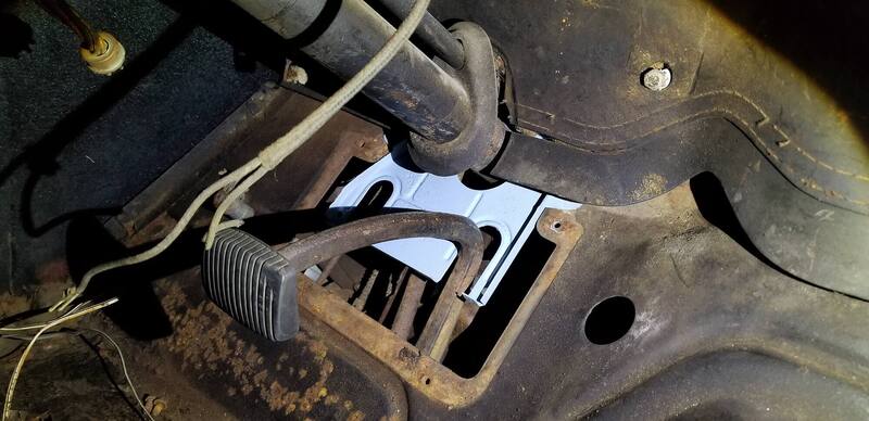

PhilA Posted June 12, 2019 Author Posted June 12, 2019 First plate in place. Correctly. Sound deadening fitted. Top halves in place. Viewed from engine bay. Everything cleaned up and painted will look nice. Phil tooSavvy, Twiggy, LightBulbFun and 10 others 13
PhilA Posted June 12, 2019 Author Posted June 12, 2019 Tonight's hugely inspirational update is brought to you by 88¢ of bolts. I also found a piece specific to "H" VIN cars- clutch pedal blanking plate. Cleaned that up and threw a bit of paint onto it, can fit that up onto the toe-board. I pulled my back out last night so updates may be slow... Phil
PhilA Posted June 13, 2019 Author Posted June 13, 2019 I hadn't thought to offer the blue up against the car. That's not a bad color match for something off the shelf at Wal-Mart. Said plate fits into the first piece of the assembly right there. All fitted in and held down correctly. No squeaks, clanks, rattles. Very good! Phil Tickman, scdan4, Skizzer and 2 others 5
