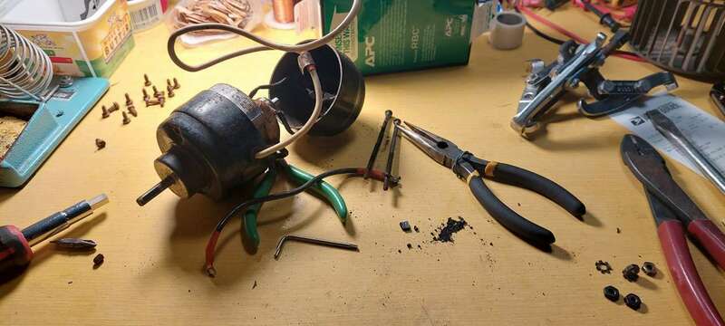

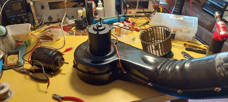

PhilA Posted January 27, 2023 Author Posted January 27, 2023 I now wish I hadn't taken the heater fan out. The motor has a brush that disintegrated and it's all overheated and... Dead Ordered a replacement. It'll be here Tuesday. mk2_craig, Mrs6C and Low Horatio gearbox 3

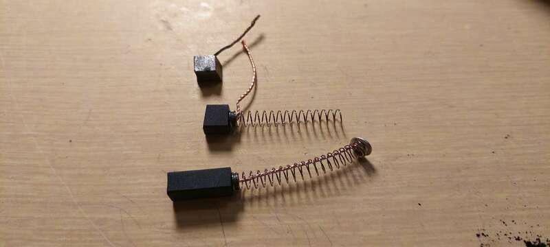

PhilA Posted January 29, 2023 Author Posted January 29, 2023 Bought some brushes, modified them to fit. That got it running again. It won't last but should be ok until the new motor comes in. Filled the transmission up with new oil. $60 at Tractor Supply. Seems to be better, will give a full report once I've done some miles on it. Phil Joey spud, Dyslexic Viking, Dan_ZTT and 9 others 12

PhilA Posted January 31, 2023 Author Posted January 31, 2023 New fan motor. Blows nicely now and it's almost silent. The old motor is kaput. mercedade, Dyslexic Viking, somewhatfoolish and 4 others 7

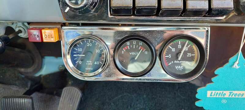

PhilA Posted April 17, 2023 Author Posted April 17, 2023 A suitable tachometer has been obtained. Better than the one I have in it which is starting to get flaky and has the redline less than half way across the sweep. LightBulbFun, GrumpiusMaximus, Dyslexic Viking and 2 others 5
PhilA Posted April 17, 2023 Author Posted April 17, 2023 Need to paint the bezel black but that works. Phil Mrs6C, mercedade, GrumpiusMaximus and 6 others 9

PhilA Posted April 19, 2023 Author Posted April 19, 2023 1 hour ago, Noel Tidybeard said: but will look thrice or fource times betterer I think I'll un-peen the bezel from the tach. I want to mark the orange and red areas on the face anyway. I'll paint it black at that time. Phil
PhilA Posted April 19, 2023 Author Posted April 19, 2023 That'll do Mrs6C, Tickman, GrumpiusMaximus and 5 others 8
Zelandeth Posted April 19, 2023 Posted April 19, 2023 One of the few cars where a HGV rev counter would fit the scale better! PhilA 1
PhilA Posted April 19, 2023 Author Posted April 19, 2023 3 minutes ago, Zelandeth said: One of the few cars where a HGV rev counter would fit the scale better! Trying to find ones that work both off a set of points and also the alternator W terminal is difficult though. I just need 0-4000 and this fit the bill perfectly.
