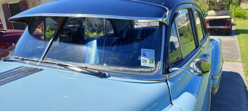

PhilA Posted August 28, 2022 Author Posted August 28, 2022 Four years ago today, I bought this car. How time has slipped by. Datsuncog, hairnet, Dan_ZTT and 5 others 8

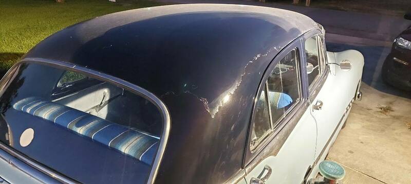

PhilA Posted September 25, 2022 Author Posted September 25, 2022 Car was looking a bit sad. Started to polish it up. It's come up okay. Got this far, needs some more detail work and the chrome polishing. Too hot to continue now, the polish dries before I can buff it off. mercedade, Fumbler, Dyslexic Viking and 9 others 12

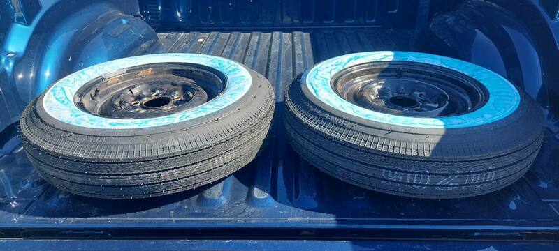

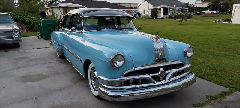

PhilA Posted September 27, 2022 Author Posted September 27, 2022 Bought a pair of new tires. Fitted and balanced, now with 100% more tread. Scrubbed up and bolted on. Set to 26psi. MoT get! hairnet, RayMK, GrumpiusMaximus and 10 others 13

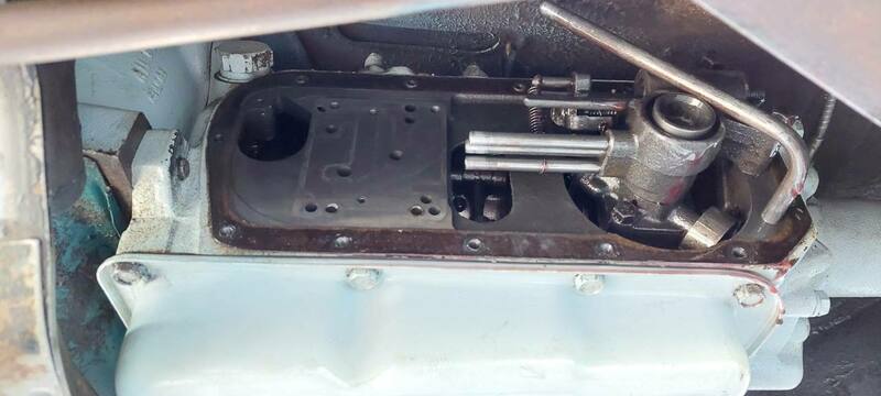

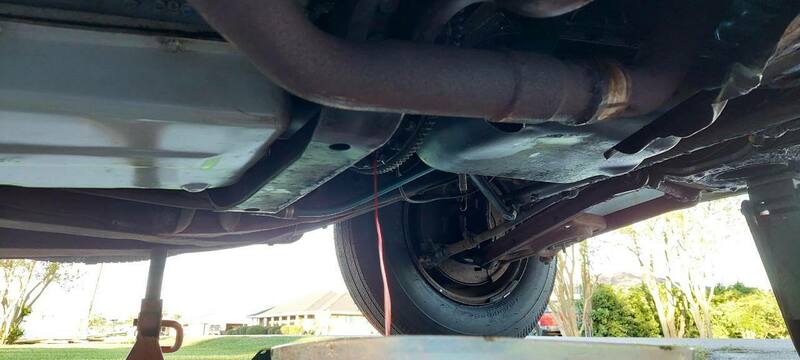

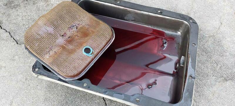

PhilA Posted September 29, 2022 Author Posted September 29, 2022 Managed to get the torus drain bolt undone. In true fashion, hammered a smaller socket over it and got it to turn that way. Draining it down completely is possible this way. With it emptied as much as possible, I dropped the lower pan. Not bad, actually. The fluid was quite clean, not burned. A little friction material, and a few errant metal shavings from before the rebuild which must've been in oilways. They stuck to the magnet. Refilled with $115 of shiny new Valvoline ATF. Cold, it's a lot more delicate, changes gear almost imperceptibly. Hot, it's doing the sticky gears thing. I think I know what's causing it; I'll drain it down again and drop the valve block, I think I know what might be causing it. somewhatfoolish, danthecapriman, GrumpiusMaximus and 9 others 12
hairnet Posted September 29, 2022 Posted September 29, 2022 On 9/27/2022 at 7:57 PM, PhilA said: Bought a pair of new tires. Fitted and balanced, now with 100% more tread. Scrubbed up and bolted on. Set to 26psi. MoT get! inspeeeeeeeeeeeeeshun yall do they inspect everything or does he only do cars like here?
PhilA Posted September 29, 2022 Author Posted September 29, 2022 4 hours ago, hairnet said: inspeeeeeeeeeeeeeshun yall do they inspect everything or does he only do cars like here? It's a full test.
hairnet Posted September 29, 2022 Posted September 29, 2022 6 hours ago, PhilA said: It's a full test. no sir vans trucks etc - not list of stuff for a car
PhilA Posted September 29, 2022 Author Posted September 29, 2022 38 minutes ago, hairnet said: no sir vans trucks etc - not list of stuff for a car Oh. Everything up to 7.5T

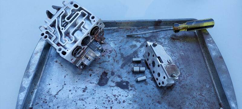

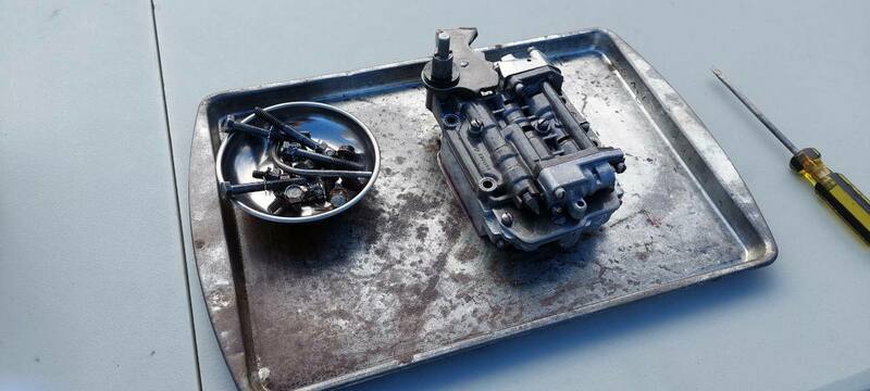

PhilA Posted September 30, 2022 Author Posted September 30, 2022 Pulled the valve block tonight, cleaned it out and took a look at the throttle modulator and modulator pistons. Took the burrs off but the 1-2 is worn to the point of getting stuck. Really I need a new block. Jenson Velcro, Rust Collector, GrumpiusMaximus and 1 other 2 2

PhilA Posted October 2, 2022 Author Posted October 2, 2022 Stuck the car up in the air again. Graded all the grease points then set about taking the gearbox to bits again. Fluid drained, side pan off and valve block removed. I was going to block the throttle valves off but instead decided to polish everything up because a few valves were a bit rough. Buttoned it back up again. Net result, nope. Same old nonsense. Gave up with that and washed the serapes instead, they came up nice again. danthecapriman, Dick Cheeseburger, Dyslexic Viking and 2 others 5

PhilA Posted October 9, 2022 Author Posted October 9, 2022 I sat down with a little light reading last night. Sat down with the service manual and tried to condense 6 pages of sequencing into a single page where all the data can be viewed at once. Then, I read something I had missed. So, the sequence of gears is as follows, with the front and rear gears either locked (L) or in gear reduction operation (O). 1st: O, O 2nd: L, O 3rd: O, L 4th: L, L So, with the gear selection valves at rest, it's in 1st. 2nd causes the first gearset to release the band and clamp the clutch. 3rd has to do a complex swap- it engages the rear gearset and at the same time operates an override valve which quickly dumps the front gearset into reduction again. That override feature is what I had missed, and it's important. Fourth is simple, it keeps the 3rd gear selection but removes the first gearset override valve, locking both gears solid for direct drive. So, if that override valve (called the Dual Transition Valve) gets stuck in the open position, it'll override any changes requested for the front gearset to change state. So, requested gears 1 and 2 are both the same as 1, and requested 3 and 4 are both the same as 3. The shift point between the gears occurs at the speed 2-3 would and with moderate violence due to the rear band just being slammed on and the softer engagement of the gear itself being down to the way the front gearset is engaged. That's exactly what it's doing. Replacing the pressure regulator has helped because the additional line pressure it creates correctly now appears to be enough to jiggle the dual transition valve out of where it gets stuck, and sometimes get 2 and 4 to engage correctly. I'll pull the valve block off again and investigate that valve, likely it's got a light score, burr or ridge that's causing that valve to get stuck when the block heats up and expands. LightBulbFun, Jenson Velcro, CaptainBoom and 4 others 7
hairnet Posted October 9, 2022 Posted October 9, 2022 48 minutes ago, PhilA said: I sat down with a little light reading last night. TLDR *boom
PhilA Posted October 9, 2022 Author Posted October 9, 2022 Took the valves out again. That's definitely the problem. I didn't go hog wild with it but the compensator backs onto the shuttle which pushes the valve via spring pressure into place. Then it's getting stuck. It got stuck when I tried it on the bench. Cold, it's super smooth. Hot it's still problematic but can be encouraged to shift by blipping the throttle. Rust Collector, Stanky, LightBulbFun and 6 others 9

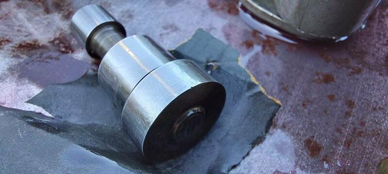

PhilA Posted October 10, 2022 Author Posted October 10, 2022 You! Yes you! Come here! Well, somebody's dropped that. (I think every damn part of this has been dropped at some point). Removed that and the burr. Improvement seen in that 4th changes by itself when it's hot now; 1-2 only if you lift off the throttle. It's late now, given up for tonight. However, that's a big improvement. I'll get to the bottom of it one way or another. It will gearbox properly. Stanky, mercedade, Asimo and 13 others 16
