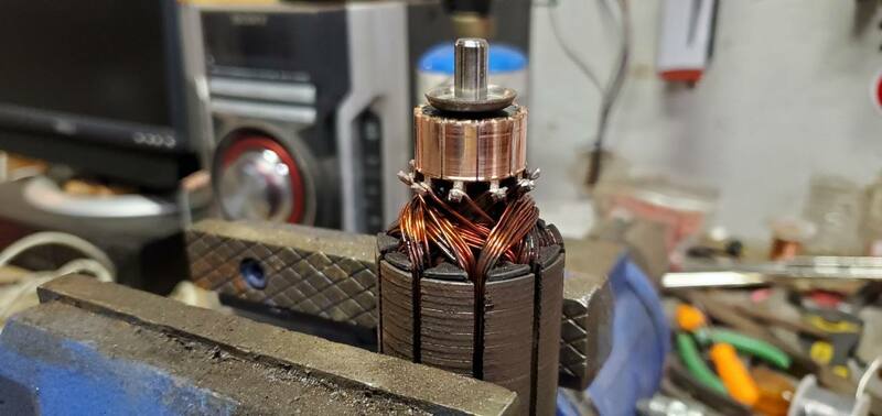

PhilA Posted March 8, 2021 Author Posted March 8, 2021 Curiosity got the better of me tonight. So I spun the commutator clean in the drill. Redid the solder joints. Oiled the bearings which were dry dry dry (think that was a big cause of problems) and gave it a brief bench test. Not overly bad, I'll redo the main feed wire and go from there. Phil GrumpiusMaximus, puddlethumper, Tickman and 3 others 6
somewhatfoolish Posted March 8, 2021 Posted March 8, 2021 The brushes being worn to nubs won't have helped with heat generation. PhilA 1
PhilA Posted March 8, 2021 Author Posted March 8, 2021 3 hours ago, somewhatfoolish said: The brushes being worn to nubs won't have helped with heat generation. The brushes can't have been much longer than that when they were new. They just don't fit in the holders any deeper. somewhatfoolish 1

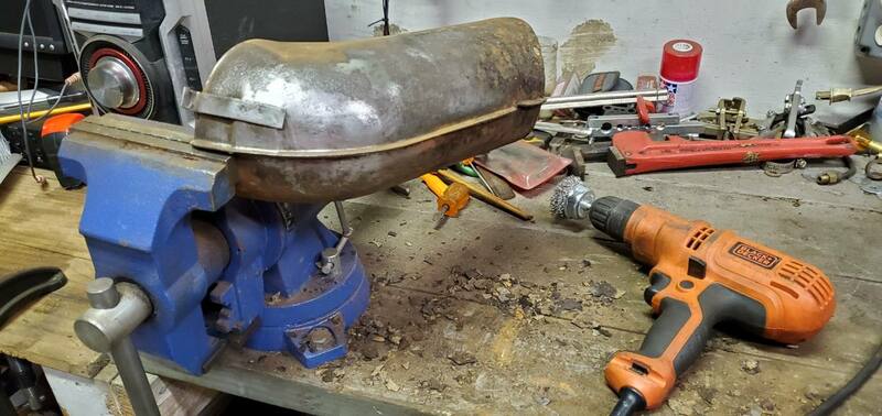

PhilA Posted March 9, 2021 Author Posted March 9, 2021 I cleaned a significant amount of Alabama out of the fan case and assembled it all together. Ran it for a while to see what it would do. 6V fully loaded it draws just over 5 Amps. It gets warm-ish but on 12V I need to measure how hot it gets. Between times I set about on the ducting sheet metal. This piece looks like someone jacked the car up on it. Many hammers later and it's looking a bit better. Certainly good enough to move air about, which is better than it was. Phil Skizzer, LightBulbFun, Coprolalia and 4 others 7

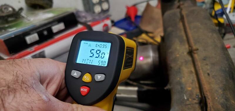

PhilA Posted March 9, 2021 Author Posted March 9, 2021 A small experiment tonight. Took the ambient temperature with the motor cold, at rest. Ran it 15 minutes at 6v. 15 degrees increase in temperature. Ran it a further 10 minutes at 12v. Not a huge increase, the hottest part by the brushes was 106 degrees so that's a fair bit off 370 for the melting point of solder. I'll pull it apart and check for any signs of distress. Phil Tickman, Skizzer, RayMK and 1 other 4

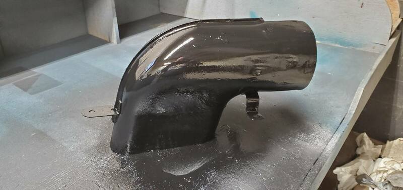

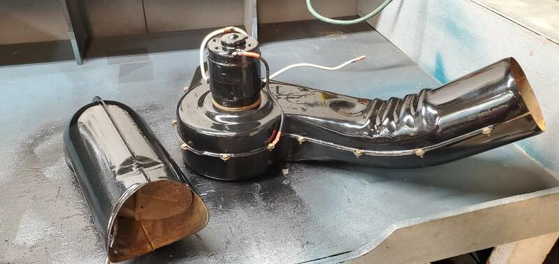

PhilA Posted March 11, 2021 Author Posted March 11, 2021 Hammer, chisel, underseal. Wire wheel. Paint. Progress is being made. I like gloss black. There's not much to say about cleaning up metalwork and putting paint on it, really. Phil somewhatfoolish, Tickman, RayMK and 6 others 9

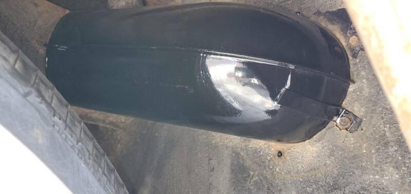

PhilA Posted March 12, 2021 Author Posted March 12, 2021 Pub, yeah right. Intake pipe up in the wheelarch. Floor heater duct and piping in place (was a pain because the pipe was bent to match where it had been crashed into before). Best view of the fan. It's in there. Phil GrumpiusMaximus and LightBulbFun 2

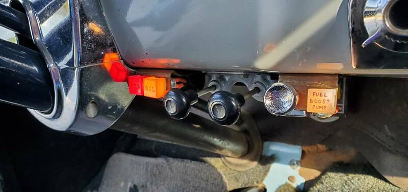

PhilA Posted March 13, 2021 Author Posted March 13, 2021 With the got weather coming in, fuel vaporization is a big problem with this car, so there's a draw-through pump up under the chassis near the tank. I had it connected to the starter button but in traffic that's awkward. So I added a pull switch and light. Means I can run the pump in traffic easily and clear any vapor lock without having to run it all the time. That'll work, and it's powered from the ignition circuit so I can't forget to turn it off. Phil Tickman, LightBulbFun, mk2_craig and 2 others 5
PhilA Posted March 13, 2021 Author Posted March 13, 2021 ...and an update to that, I tested it with the pump on full time. I drove from here to the grocery store at speed then left the car idling in the lot as I checked to see that it wasn't overpowering the pump intake, pipes or float. Everything was happy so I latched everything down and went for a higher speed run on highway 308. Hot damn. The car pulls hard at 60 with the pump on. Off it feels strained. I guess that's my answer, then. Phil LightBulbFun, GrumpiusMaximus, LabRat and 3 others 5 1
