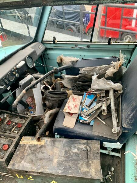

OldBlokeInACaravan Posted February 17, 2021 Posted February 17, 2021 I meant to tell you it's got a two handed handlebar control system, but surprisingly inside the car it has a single handlebar control so could be changed......ideal for me in the future as I am disabled and have problems with my hands at times....... Just hope the control I've found is not 'handed'! LightBulbFun and Mrs6C 2

OldBlokeInACaravan Posted February 18, 2021 Posted February 18, 2021 Here's some more pics, seems complete, minus the coil...... Need to sort out all the spares next..... mileage shows just over 26,400 possibly correct??Loving the old thing already.... R1152, Mrs6C, ETCHY and 2 others 5

LightBulbFun Posted February 18, 2021 Author Posted February 18, 2021 2 hours ago, OldBlokeInACaravan said: Updates on new Invacar.....up early this morning, it's had a good scrub with bleach and hot water and a good hose down! Before and after... More pics to follow 2 hours ago, OldBlokeInACaravan said: Here's some more pics, seems complete, minus the coil...... Need to sort out all the spares next..... mileage shows just over 26,400 possibly correct??Loving the old thing already.... ah Awesome stuff! she is looking good! Looks like theres a nice stash of parts in there which is always very handy! will be interesting to see whats what as you go through it (I already spot a couple exhausts there, hopefully those are in good shape ) are you able to grab a picture/tell me whats marked on the carburettor? I notice that she has been fitted with an engine from a much earlier Model 70 at some point in her life (note the cartridge oil filter rather than the spin on type) and so im curious if this early engine has a 32ICS3 carb or a 32ICS10 carb? (it could also be a Solex carb too, but I have never seen a Model 70 fitted with one) Part number for an ignition coil is Bosch 0221119027 and heres a Lucas equivalent I think (they are from the Parts stash I got with REV so I assume they are compatible with a Model 70!) lucas 17M12 is their PN i think BTW when looking at the photographs I just noticed another difference between AC and Invacar Model 70's the "Passenger carrying is forbidden" plaque, on an AC they are always black text on a white background, but an invacar they are white text on a black background here is TPA's for example (and on later AC's they moved the plaque to where the Dash changer would have gone, under the courtesy light, but on Invacars they kept them in the same place throughout production) 2 hours ago, R1152 said: Wow... what's with those old batteries?! those will be the Batteries for the Stanley Argsons 12 minutes ago, Dick Longbridge said: LBFs could do with the same treatment! Looks 100 times better already. Yeah I really do feel bad about that and wish I could do something about it! tho the good thing about Model 70's and being fibreglass, is they can look like utter shit, but clean right up really well with just some scrubbing etc cuz it all just falls off the fibreglass bodywork! and fibreglass is not really affected by dirt and grime in the same way some fancy paint job steel body work car is Dick Cheeseburger 1
R1152 Posted February 18, 2021 Posted February 18, 2021 22 minutes ago, LightBulbFun said: those will be the Batteries for the Stanley Argsons Lead/acid or NiFe?
OldBlokeInACaravan Posted February 18, 2021 Posted February 18, 2021 3 hours ago, R1152 said: Wow... what's with those old batteries?! They came with the old Argsons I've bought!! LightBulbFun 1

LightBulbFun Posted February 18, 2021 Author Posted February 18, 2021 3 hours ago, R1152 said: Lead/acid or NiFe? Lead acid R1152 1

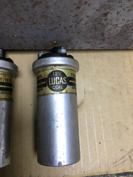

OldBlokeInACaravan Posted February 19, 2021 Posted February 19, 2021 That is a serious top tip. Thank you! Weather has been gawd awful today, not a lot done apart from the battery and the coil ordered, had left the existing battery charging overnight but not even a dashboard light, so only fit for the tip! Will get the pics of the carb tomorrow weather permitting!! LightBulbFun 1
LightBulbFun Posted February 19, 2021 Author Posted February 19, 2021 50 minutes ago, OldBlokeInACaravan said: That is a serious too tip. Thank you! Weather has been gawd awful today, not a lot done a part from the battery and the coil ordered, had left the battery chartering overnight on the existing one, but not even a dashboard light, so only fit for the tip! Will get the pics of the carb tomorrow weather permitting!! No problem happy to help! I look forward to seeing your Model 70 return to the road I would not be so quick to write off the battery, pretty much all the electrics goes through 2 fuses in a fuse holder, mounted to the front bulkhead under the dashboard (plus a 3rd fuse in the engine bay to do with the Dynastarter charging) these are your good old Lucas Glass fuses, 25A and 35A in the case of the cabin fuses (note these are Lucas fuses, so DONT put regular 25A and 35A glass fuses in there as they are not the same) as such you will probably need to take the fuses out clean them up and and fuse holder contacts scrubbed up as well before things actually work (something I need to do on REV as at the last FoD Gathering I had to give them a spray with some electrical cleaner and spin the fuses in the their holders to get things working) OldBlokeInACaravan 1
