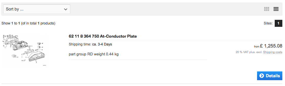

Given that BMW want £1300 for an E34 SI board* any E28 stuff is going to be mental money.
*You read that right. £1300......for just the circuit board.
