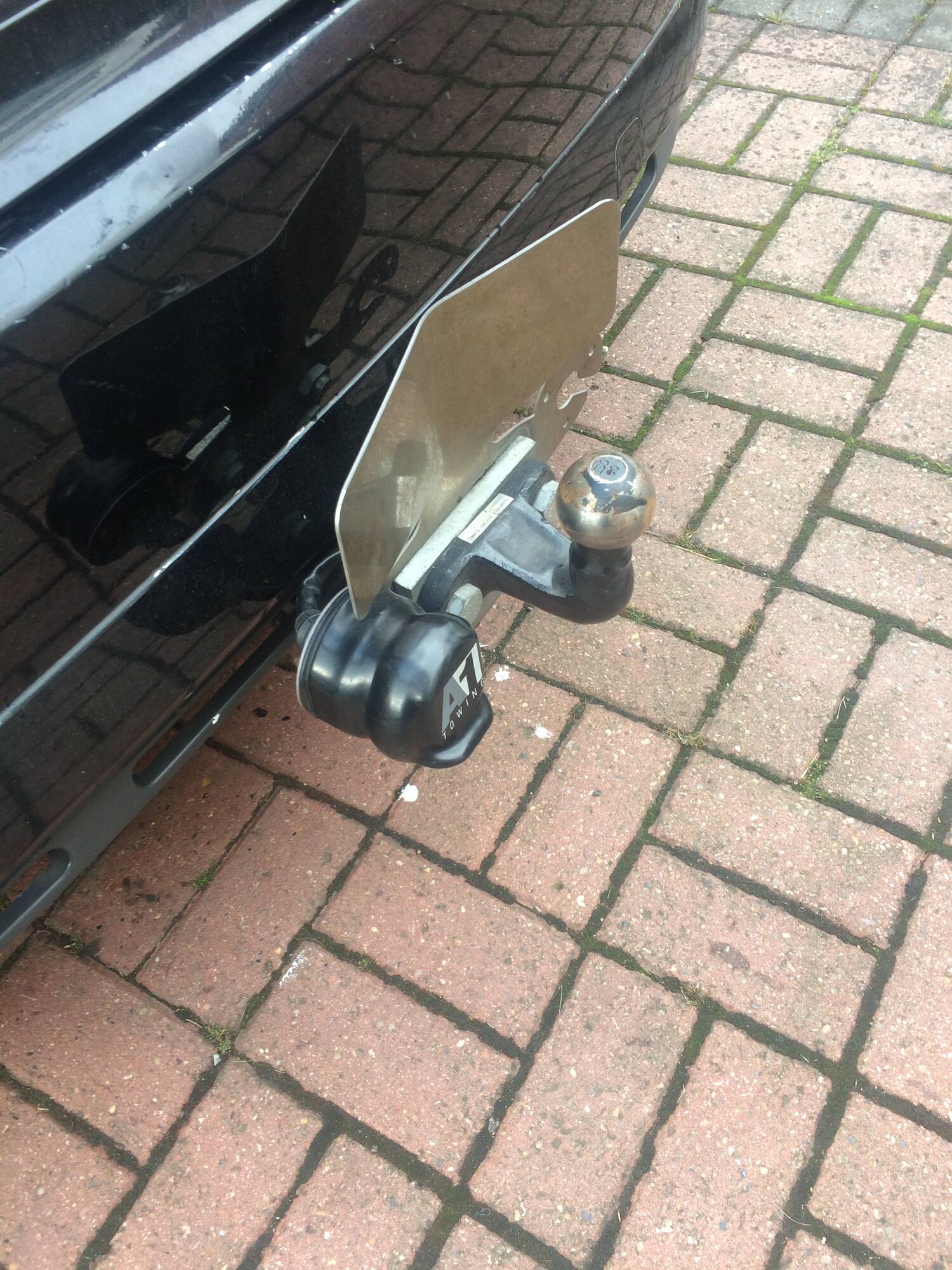

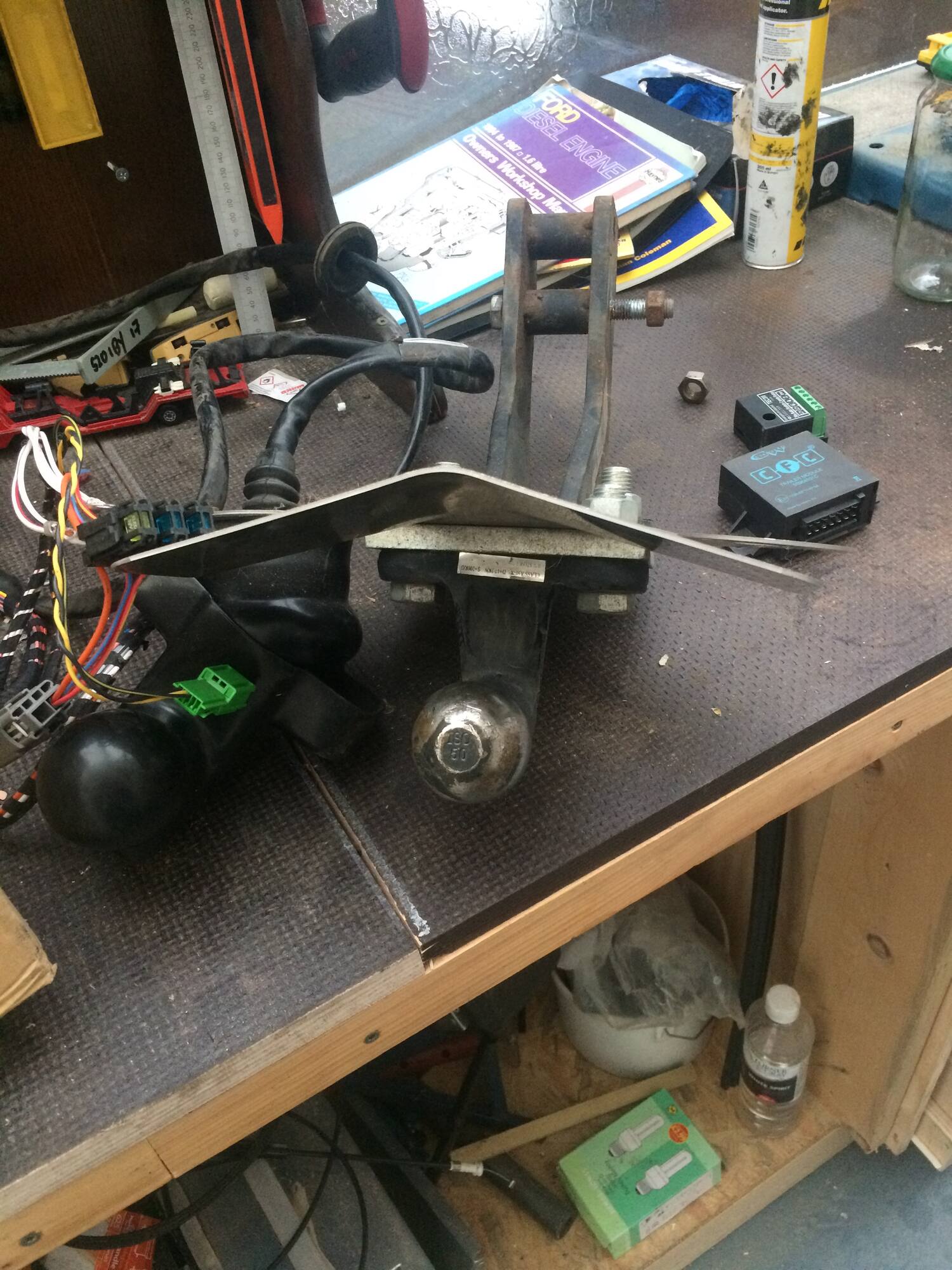

Picked up a towbar this evening for the Mondeo, the bar is already bolted on, just got to wire all this clobber on...
Ready to clog up the highways and byeways of the U.K. Just need to swap the 13 pin plug for a 7 pin one as on the in-laws trailer. Then I can really bollocks the DMF up!

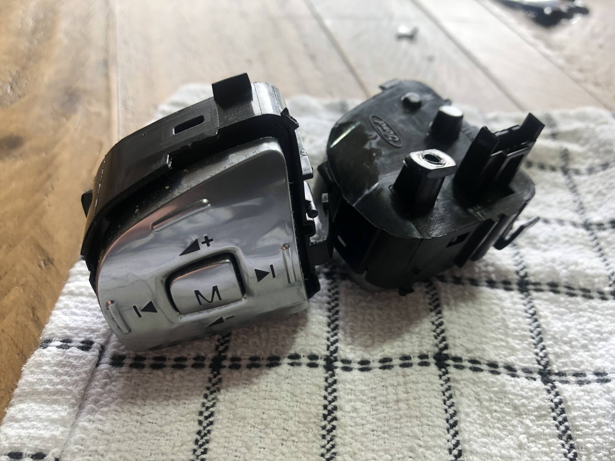

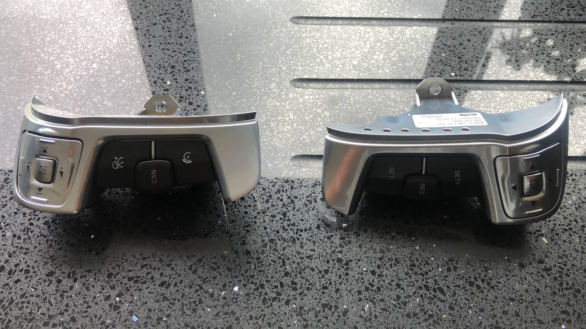

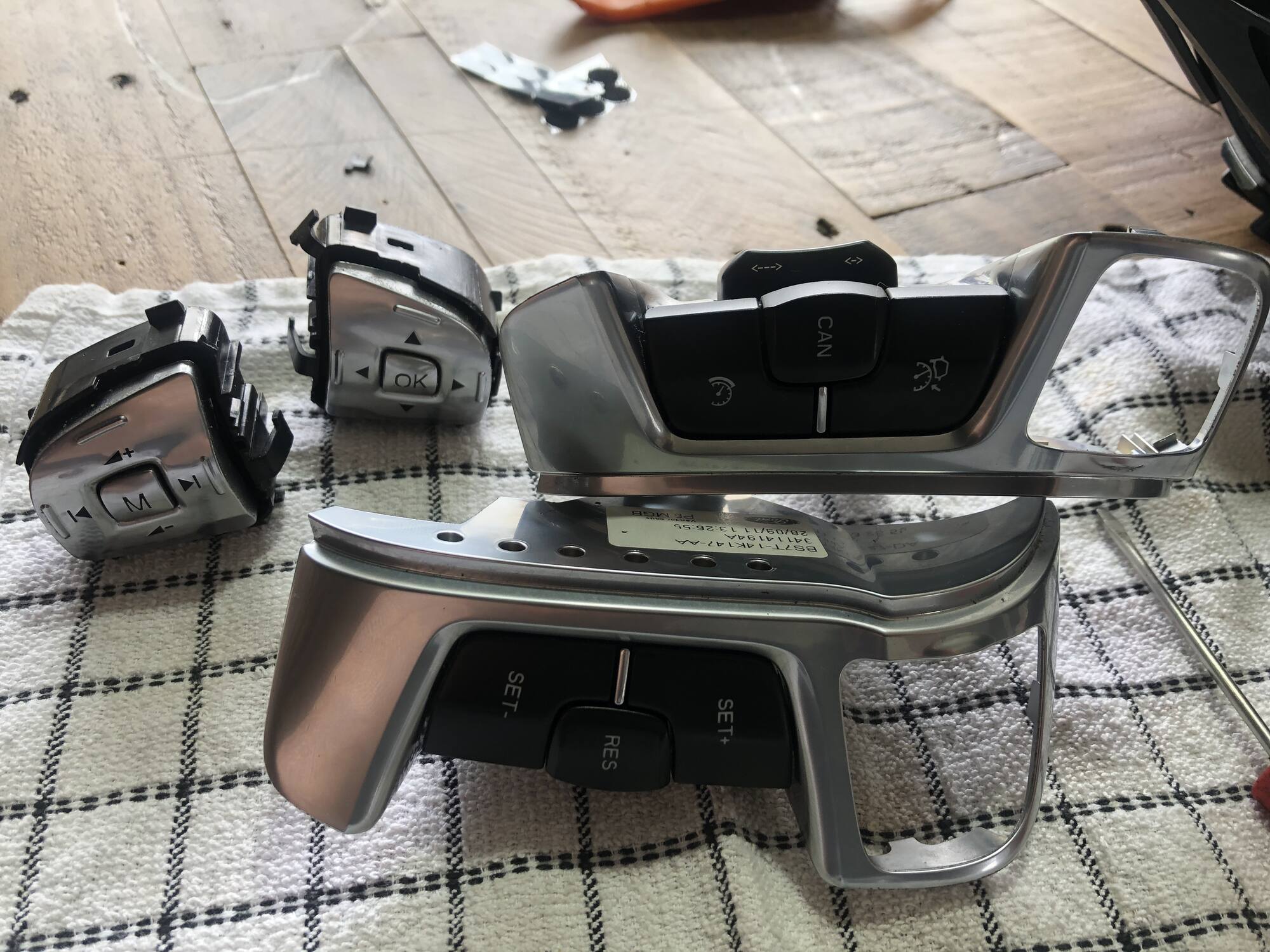

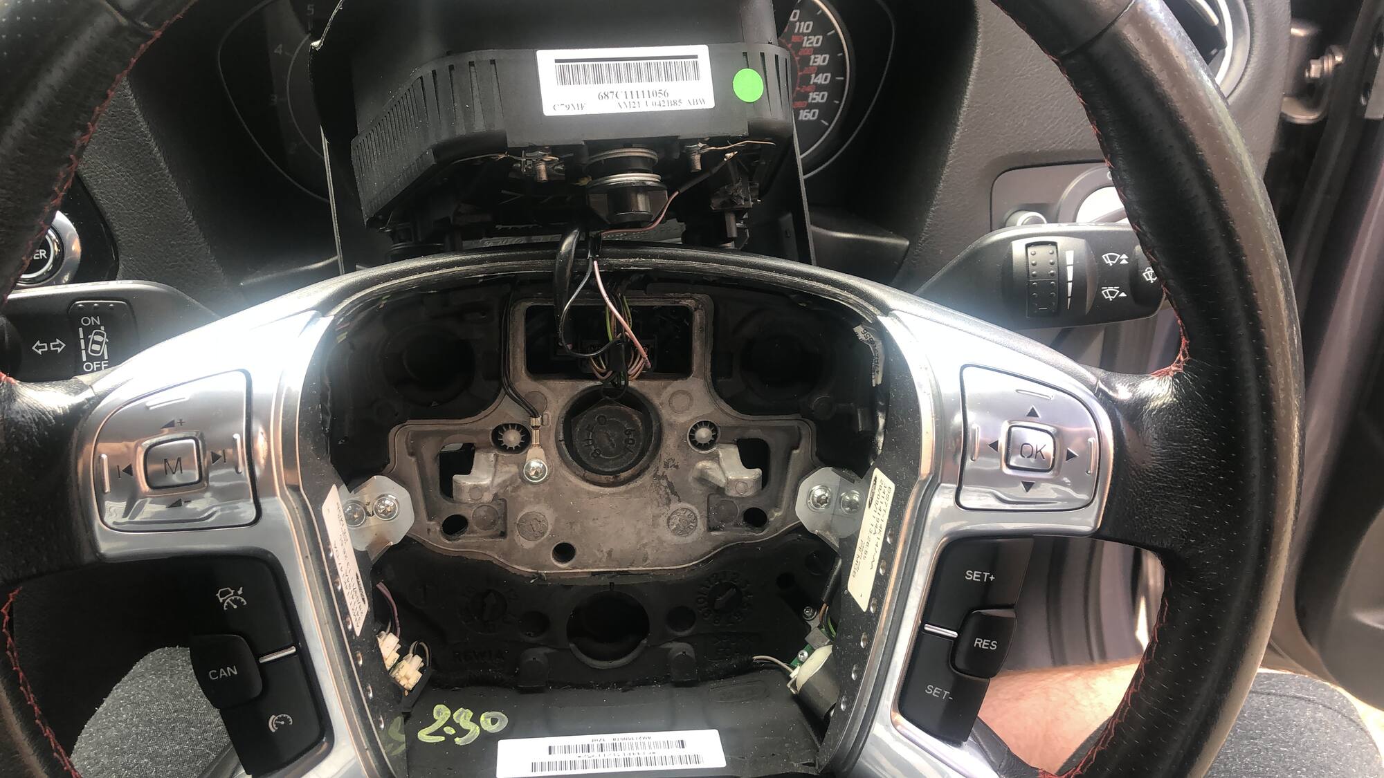

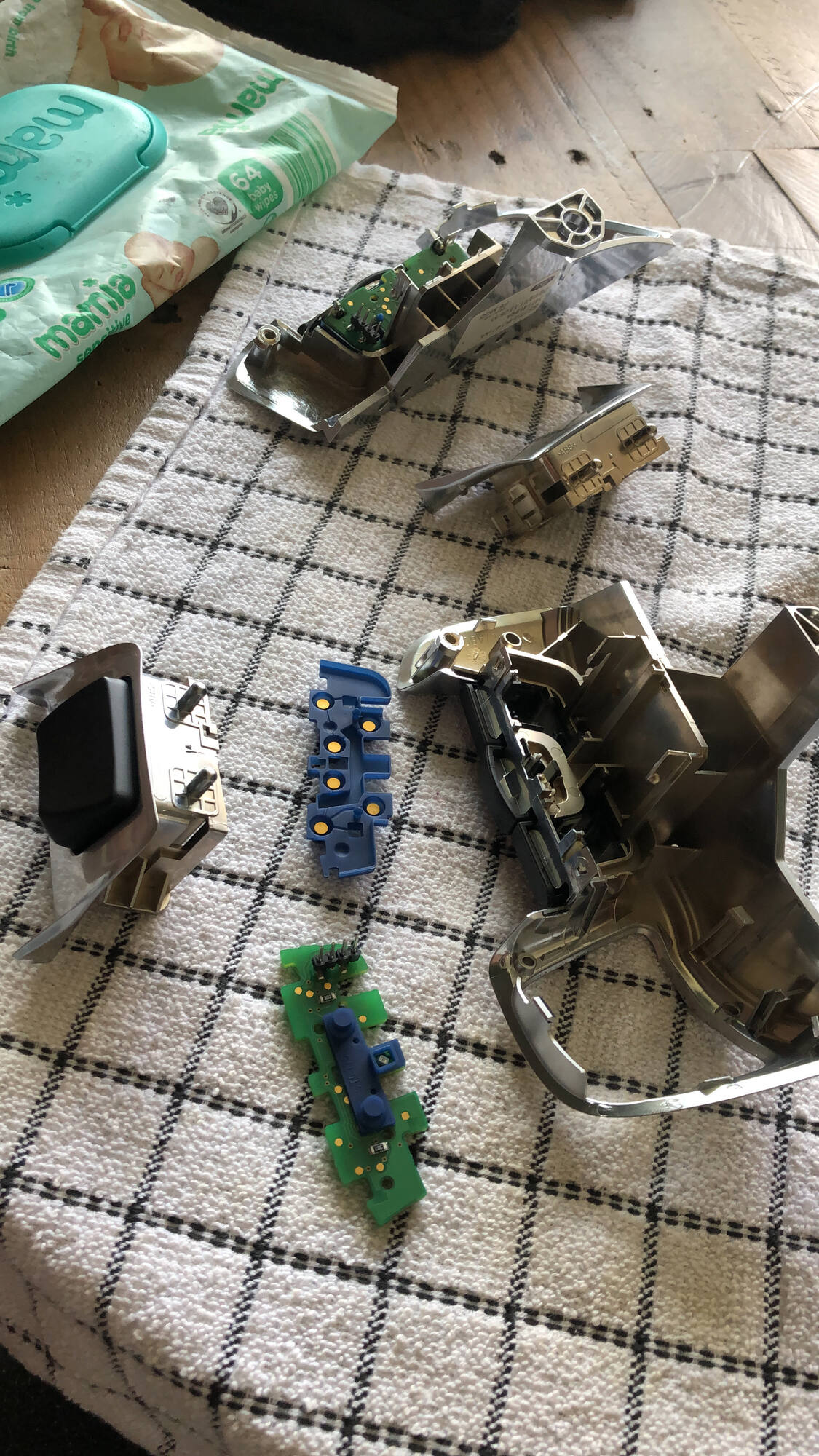

Finally contact cleaned the switches on my steering wheel. ACC went from intermittent to not working at all, and the volume/track switch was also acting up.
It was just shit getting inside. All stripped down, cleaned up and working again.
Removing the airbag is the worst thing on these.
2 minutes ago, sierraman said:
I just sprayed contact cleaner down the gaps on mine and it worked.
Yeah, that works. But I wanted to be as thorough as I could.

You can buy 13-pin to 7-pin adaptors on eBay for a couple of quid.  Just remember to take it out when you're not towing as they seem to knock out the car's rear fogs for some reason (or at least it did on my old Movano - which I finally discovered for myself after taking most of an afternoon trying to trace the fault :roll: ).
