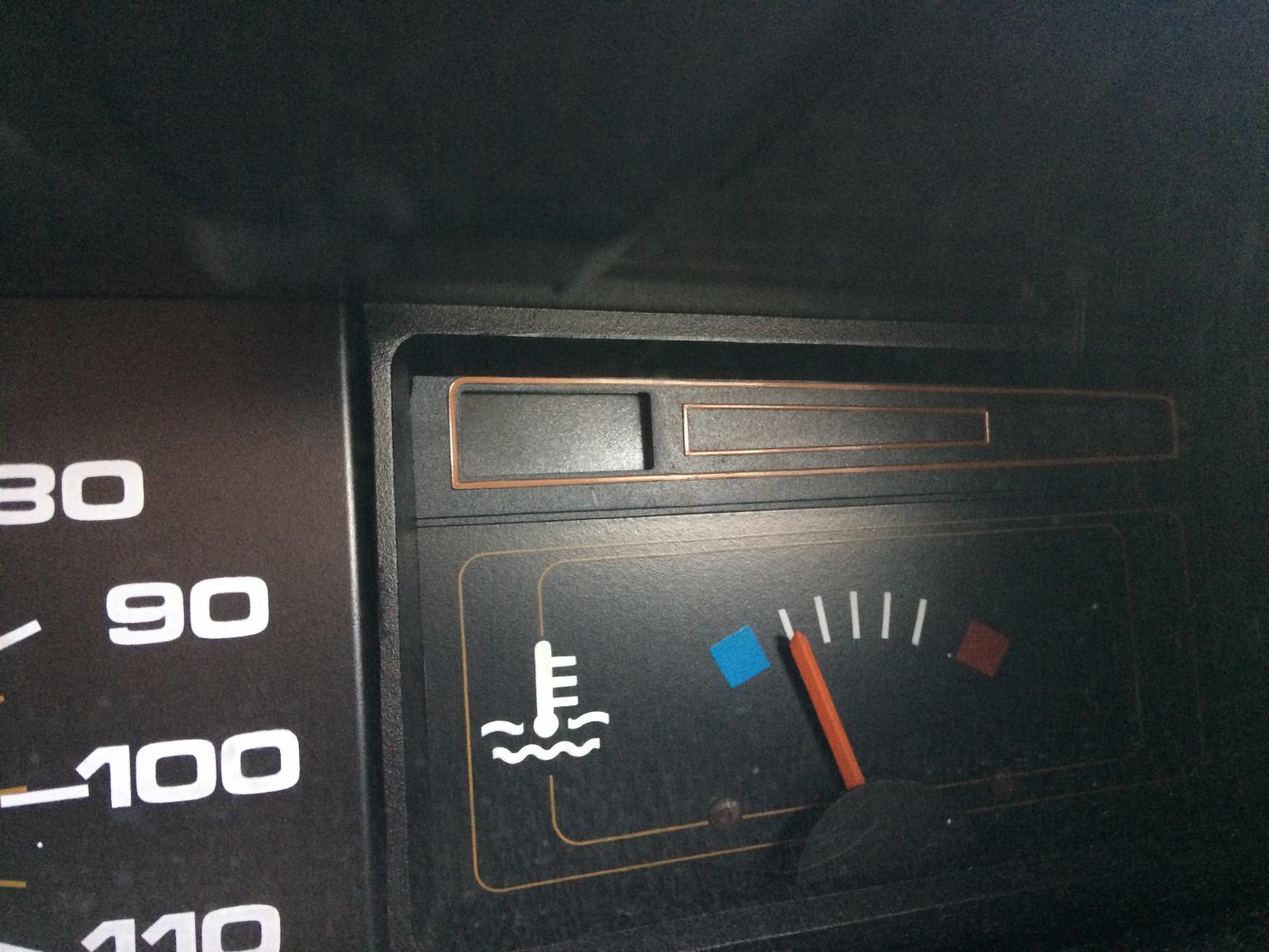

jon.k Posted February 16, 2018 Author Posted February 16, 2018 A quick question for the 305 and xud lovers out there. Just picked my 305 up (pics later) after it’s had a replacement engine. Runs great but can anyone tell me where the temp gauge should be under normal driving? It’s hovering below the quarter mark but there are no temp markings as such, and it is bouncing around a bit. I will check it’s got enough coolant on my break and I have a new rad coming in the post from Cyprus (!), but I thought I’d check what was normal.
artdjones Posted February 16, 2018 Posted February 16, 2018 They don't tend to run very hot but it doesn't usually move around.Does the heater work well? Might be worth looking at the sensor which is on the thermostat housing.On the front of the head at the right when you are standing in front of the car.
jon.k Posted February 16, 2018 Author Posted February 16, 2018 The heater seemed pretty warm but when I change the radiator I will change the temp sensor too. Last time I did that I managed to snap a bolt on the thermostat housing! It’s good to know it shouldn’t move around, thanks for that. It seems to hunt around between two of the eighth markings. In that case I will use it sparingly until I have the new radiator and sensor in. Thank you.
artdjones Posted February 16, 2018 Posted February 16, 2018 I probably would change the thermostat as well.You're right about the bolts.The shanks are very long and are going through aluminium so it's worth using a bit of heat/penetrating oil.
puddlethumper Posted February 16, 2018 Posted February 16, 2018 Mine usually sits slightly left of vertical on the second mark. How's it going apart from that ? Did you get the hoses you were after ?
jon.k Posted February 16, 2018 Author Posted February 16, 2018 Thanks Puddle jumper, mine has been sitting between the second and third divisions, so it goes one above the one in the photo then I think the fan kicks in and it goes down as into the photo. Perhaps that’s that’s ok? I’d never studied the temperature gauge so closely until my last engine got cooked!I got all the hoses I need, and Ian kirkwood in the pug club bought the remaining spares from around Europe if you need any. I’m excited about the NOS radiator too. Then we can organise the 305 meet at DSparesand tyres’ hideout. The Moog, chodweaver, holbeck and 2 others 5
dozeydustman Posted February 17, 2018 Posted February 17, 2018 When I was insured on mum's ZX and later on had my 306 (both XU diseasel) the temp gauge never seemed to hit the half way mark. On long motorway blasts the needle was barely off the bottom of the gauge. Don't think you have anything to worry about.
puddlethumper Posted February 17, 2018 Posted February 17, 2018 Temperature is spot on. Yea, have to get together sometime.It's a shame FOAD is so far away, then we could have the red,white and the blue. I'd deffo have a pic of that.Three 305 vans together is not likely to happen very often if at all.
mk2_craig Posted February 17, 2018 Posted February 17, 2018 How did you get on with changing the reg mark on the 306? I was going to suggest that approaching your nearest coach operator often results in a willing buyer, many love the dateless NI plates so as to disguise the age of their older motors.
jon.k Posted February 17, 2018 Author Posted February 17, 2018 Well I took it for two pretty heavy tip runs today and it didn’t go above the second white line so I’d agree that itlooks good. I think the problem is that I bought the van off an old boy mechanic who drove it for a mile a day to his garage, and he told me that the temperature gauge never moved because it has a big radiator. I think it maybe didn’t move because it was not working, hence the cooked engine on the first long journey. So I was surprised to see the gauge move at all with the new engine. After the old engine siezed I couldn’t work out what had happened to the water because there was no steam, no high temp on the gauge or anything. We found out wjere the water had gone when the mechanic started up the new engine and sprayed a massive trail of dirty coolant out of the exhaust and up the wall of his garage. Minging. So pleased to be back on the road, it’s such a nice car to drive. puddlethumper 1
