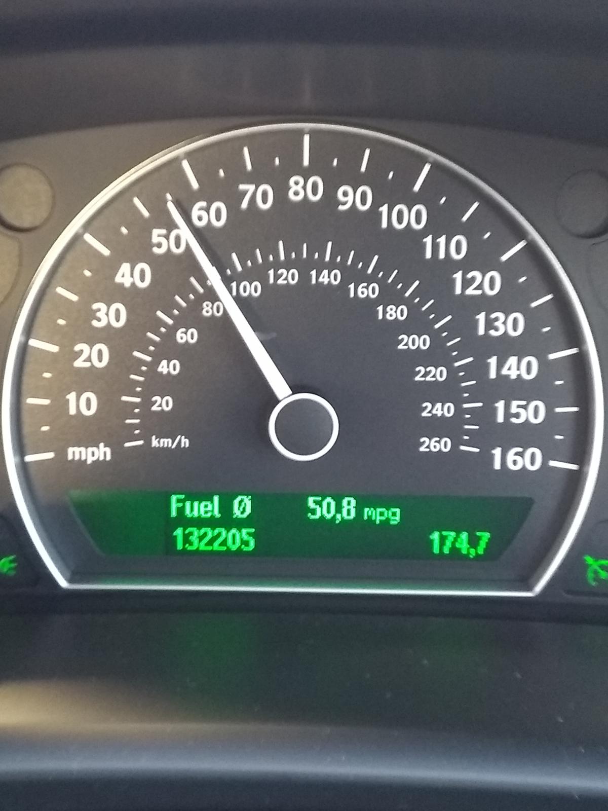

Managing to get over 50mpg at a steady speed but 40's in normal use. Pleased with that.

Not a bad result today although I realise it might be a bit optimistic. If it's anywhere near the truth then it's the most economical car I've owned (not factoring in any modern diesel repairs!).
