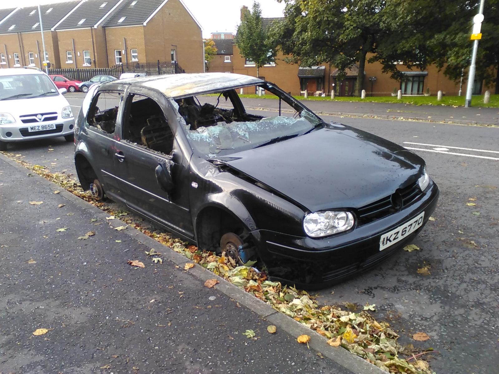

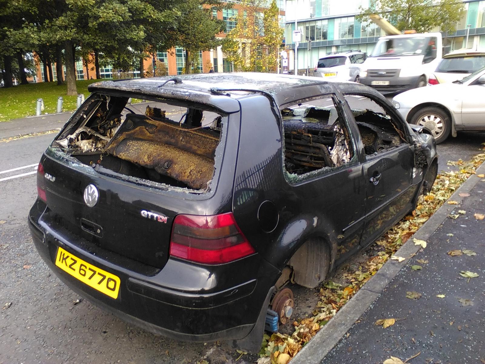

My friend on UKSaabs has the same answer for any fault on any VW, which he claims he can cure for seven quid. Yes, the cost of a gallon of petrol and a box of matches.
Does he live in Belfast?
FIXT
