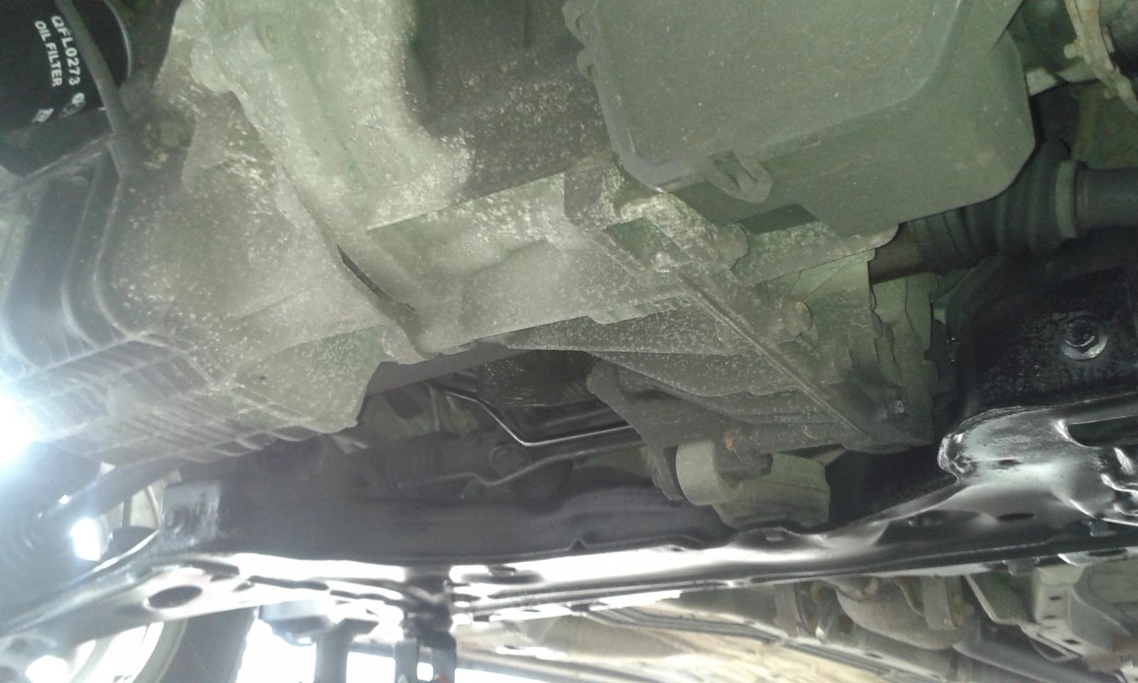

anyone changed a mk1 pas rack in a petrol car ?  cant find much online about it for rhd cars

seen a picture , back of the subframe is dropped down which gives good access to the rack , access to front of rack is good as well
I’d get a garage to fit it. Real ball ache it’d be on the driveway on your back. I had one that clonked like you say yours did, it had no play in the rack though.
