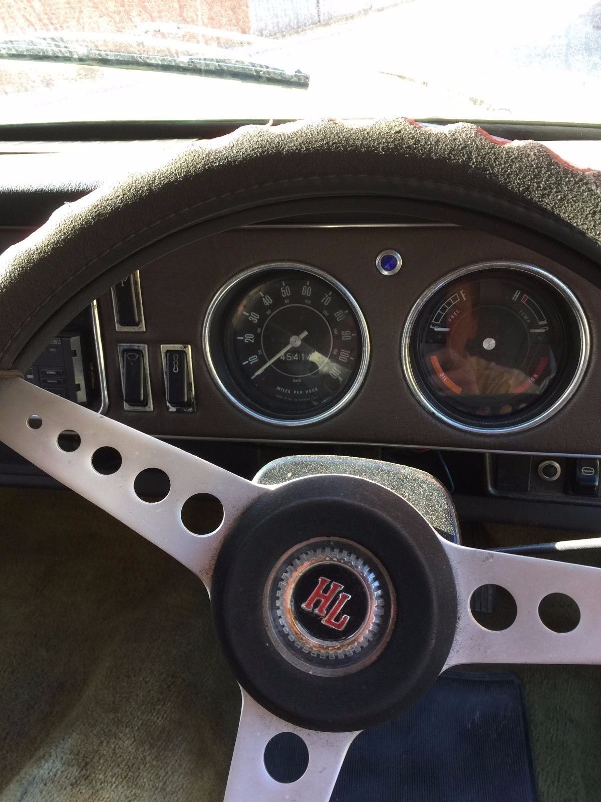

Any chance of an interior shot?
Here's one I had to hand, showing vinyl dash and HL 3 spoke wheel :)

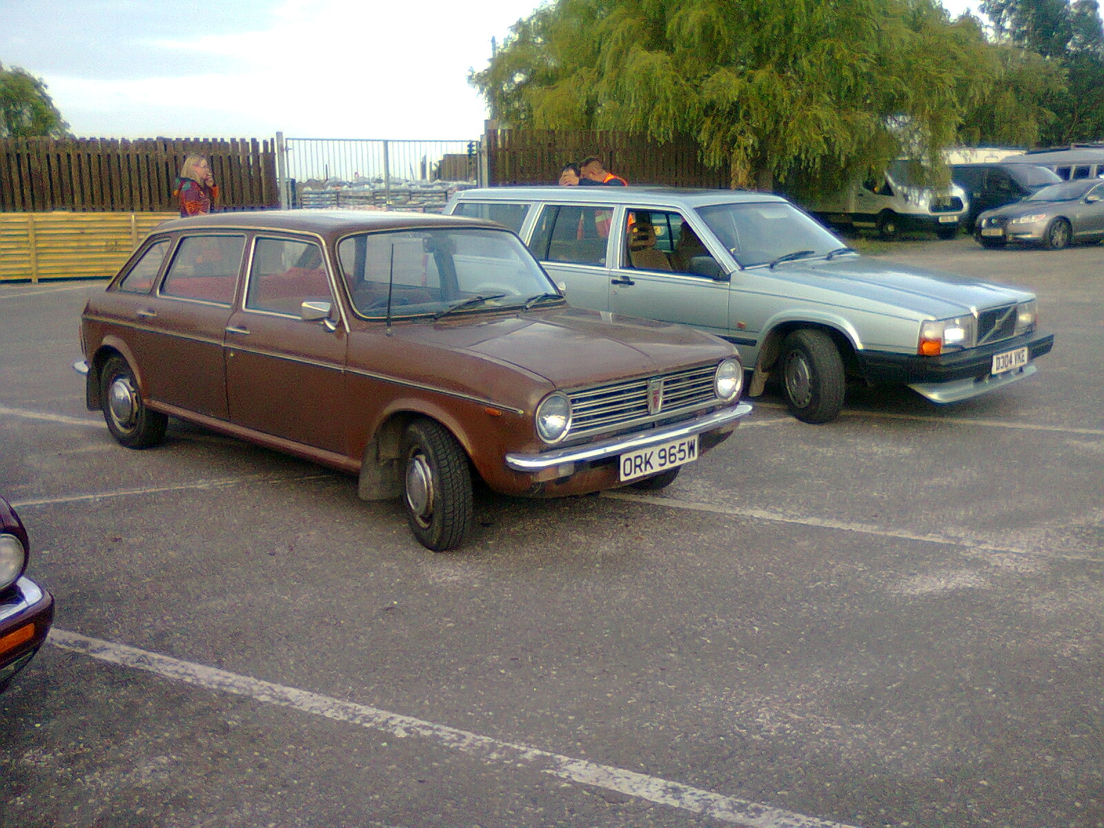

brown. My dad rated the Maxi very highly,as did my Grandad,i have an ace "autoshite in the 80s" pic of me aged around 2 strapped into the back of a brown Maxi that probably wasnt roadworthy 30 years ago! #taxinpost
Now that you have to share! ;)
