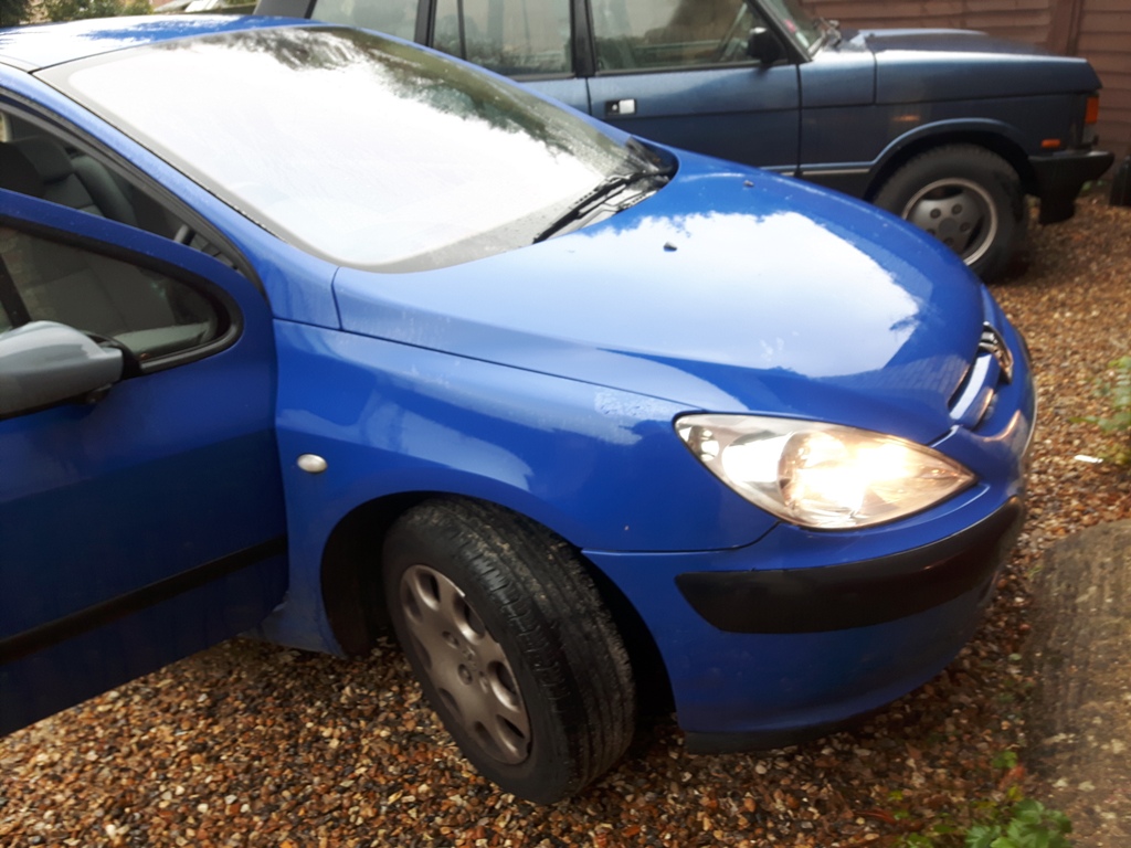

refixed the front bumper and front wings
Paintwork isnt bad at all, some dings and scratches on it but ok at 10 paces

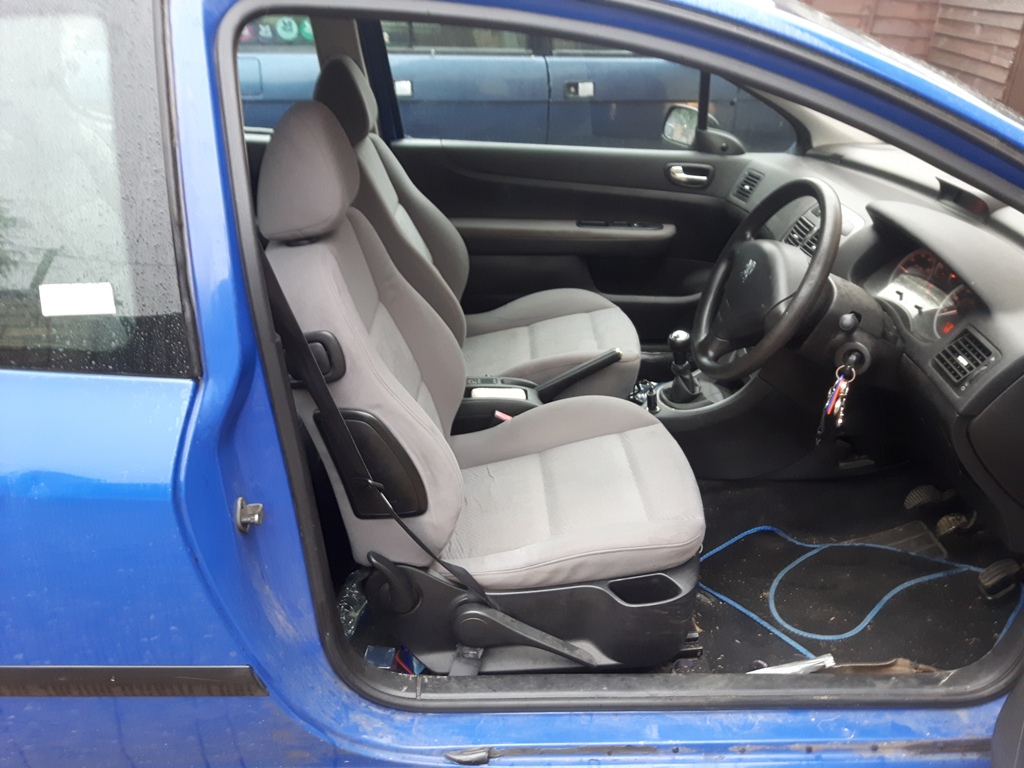

Interior is all there
Passenger airbag light comes on sometimes

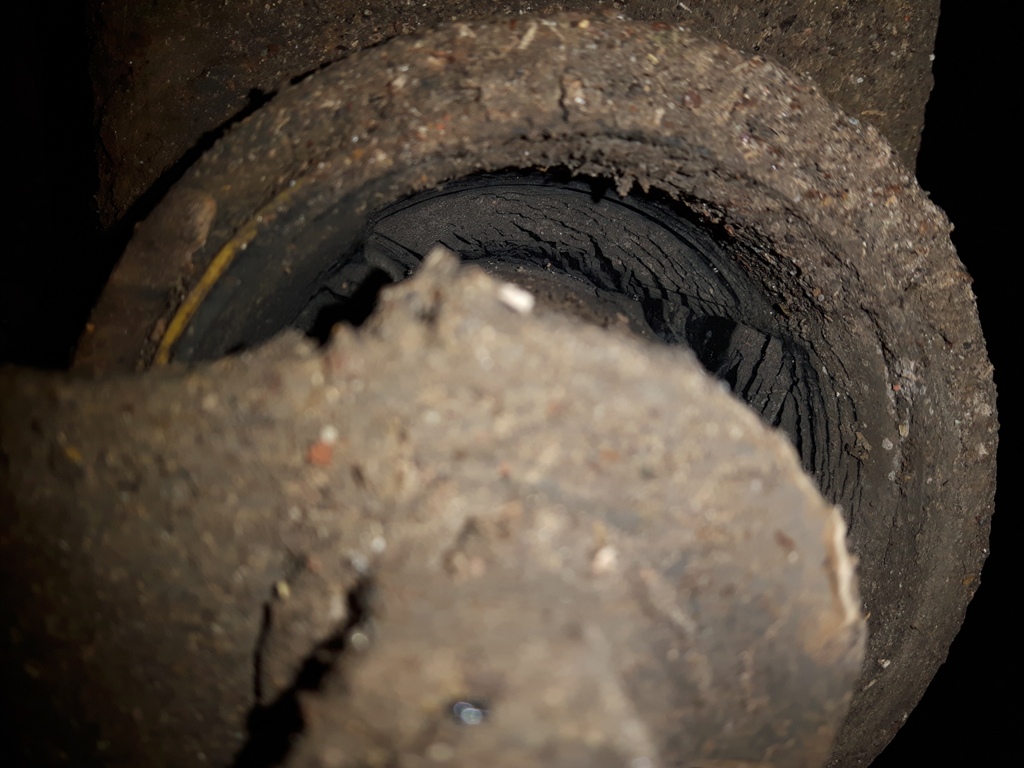

this is what the rear trailing arm bushes look like, might need some attention for mot

It's a nice colour! These are basically the same as the C4 and as some may know my old VTS did over 197000 miles and it still had the original rear trailing arm bushes etc. I know the VTS has a beefed up torsion bar, but still they do seem to last better than previous gen Pugs/Citroens.

The rear suspension lasting better than old PSA stuff is down to the use of a cheap and cheerful torsion beam in place of the ingenious old trailing arm/torsion bar setup, meaning no trailing arm bearings to fail.

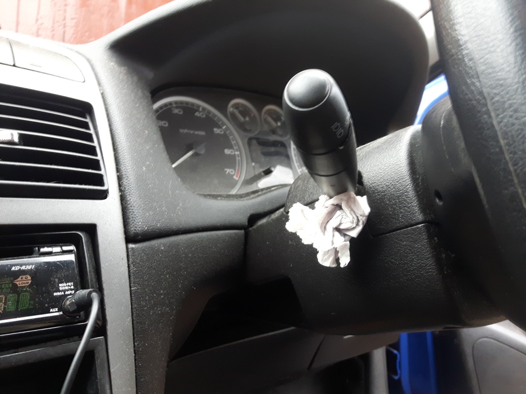

Is bog roll in the indicator stalk a bit like 20p in the handbrake?
having a think about emissions last night, like you do!
The car has not seen a decent engine service in the time that I owned it, probably not with 83c did either.
New air filter will not hurt the emissions readout before you start down lambda sensors etc
Yeah, I had spotted the screws on the air filter housing looked like they hadn't been undone for a long while, I'll have a look at the weekend.
it sorts the left indicator coming on randomly. :D
so rather than preventing something from working like 20p in the handbrake it fixes something.
Not entirely sure why it should be an mot fail though as it does work but doesnt always self cancel
Cool so its a fix. Good idea really and cheap to replace. One sheet does plenty :)
also ideal if you find yourself cut short and have to take a dump at the top of a Motorway embankment
Indicator stalks replaced, all bulbs replaced, air filter replaced, filled up with cataclean, cleaned interior with the door open, light on, battery flat.
Dead.
Will not restart, even with a massive pajero battery.
Diagnostics have been applied all afternoon to no avail.
Shit.
