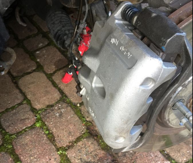

AMC Rebel Posted February 19, 2018 Author Posted February 19, 2018 Finally got around to changing the sticking caliper - easier than I expected and so far, so good - Heidel_Kakao and oldcars 2
dieselnutjob Posted February 20, 2018 Posted February 20, 2018 Whoever wrote the workshop manual for the X350 diesel is a f*!"$ idiot. To get to the diesel pump belt it says that you have to remove the bulkhead panel behind the engine. The problem is that there are coolant lines and aircon lines that go through this and so you have to degas the AC and drain the coolant. I went to a local garage and have the AC degassed and then go home and started tearing the car apart. If you look at this pic you can see the big gap in the foreground of the pic is where the cabin heater filter box was. This box came out in a few minutes with only four bolts and then you can easily get to that rear belt from the side. Removing the bulkhead panel is totally unnecessary. AMC Rebel 1
3VOM Posted February 20, 2018 Posted February 20, 2018 Finally got around to changing the sticking caliper - easier than I expected and so far, so good - AS1.JPG Worryingly, I read that as fixing the sticking caliper and, at first glance, you appear to have jacked up the car, removed the wheel and got the WD40 out..... AMC Rebel and oldcars 2
AMC Rebel Posted February 20, 2018 Author Posted February 20, 2018 Worryingly, I read that as fixing the sticking caliper and, at first glance, you appear to have jacked up the car, removed the wheel and got the WD40 out..... That "specialist fast release penetrant" WD40 wouldn't free off a sledge stuck on a near vertical ice slope. Lacquer Peel 1
Asimo Posted February 20, 2018 Posted February 20, 2018 That "specialist fast release penetrant" WD40 wouldn't free off a sledge stuck on a near vertical ice slope.Agreed. Glad to know it wasn't just my technique.
