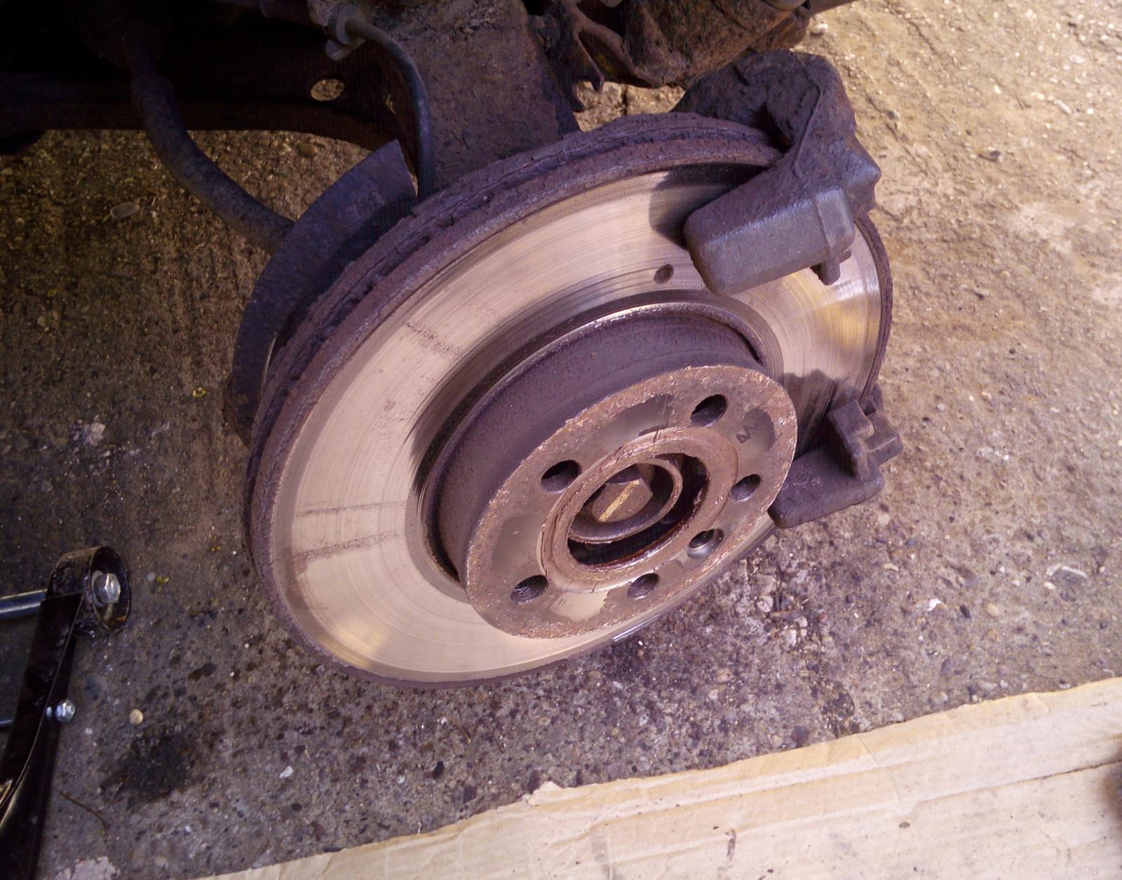

Just changing the front brakes on my sharan, well trying to. I'm working very slowly. Just got the pads off on the front o/s. The disc won't come off. Silly question but do I have to remove one of those caliper supports in the photo? Can't see any other way but those bolts are big and tight! If anyone can help then I can proceed and probably save some head scratching.

Many vehicles, yes the caliper mount has to come off. Some not, but that looks to me like you will have to unbolt it. Hammering only helps free the disc from the hub, it won't make space where there isn't any!
Most likely.  It is sometimes possible to wiggle the disk out without unbolting the caliper bracket, but that one looks like it needs to come off.  Visualise tilting it enough for the rear face of the disk to slip over the bit of hub visible in the middle: not going to happen.
Incidentally, why does the disk need to come off at all?  That one appears to have a slight lip, but it doesn't look scored or anything.  I'd probably leave it where it is.
Aaah. I've changed the discs on my old Leon which I assumed was a similar strut and I'm sure I didn't have to remove the bracket - just the caliper.
Ok, that's what I thought. Never had that on a car before. The bolts are 27mm, very rusty and not a lot of room behind. Might have to aim for just getting the one wheel done today. I wish I had power tools.
It's a bit rusty on one edge on the inside. The brakes are a bit under par so bought new pads and discs. The pads that came off had plenty of meat on them but were worn on the same edge at the back. At this rate might just change the pads then. Will see how I go.

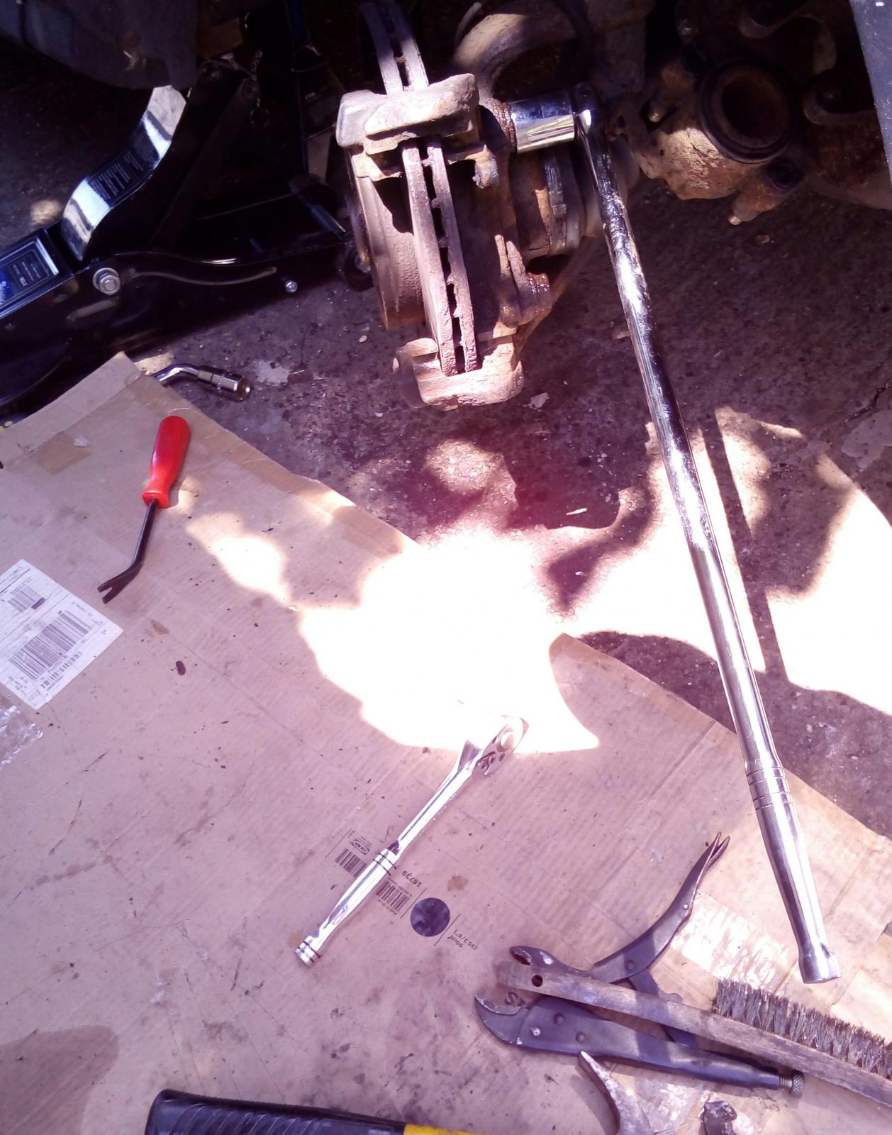

Turn the steering so the carrier points 'out' put a big ring spanner on the carrier bolts & stamp on it.
You need to take the caliper carrier bolts out, they'll be tight and rusty so put the 12 sided sockets away and get the 6 sided jobs out.
I've got an extension bar and my sockets are 6 sided. Pointing the wheel out will help - why didn't I think of that! Put it all back together now on that wheel. At least I know my way round them.

Sometimes an axle stand can support an extension bar so it doesn't fall off the bolt as you stamp.

Oh yeah, soak it in WD40 or similar several times before trying to undo them. I've never seen any without threadlock on, so I'd make sure you have some before the job too.

Turn the wheels to give yourself more access, 6 sided socket and breaker bar normally does it for me.

You may need an extension tube on the breaker bar.
I has a 4ft ali tube that works everytime (except when it doesn't) for tasks like this.
I've got some plusgas ready for those bolts. The 27mm socket doesn't fit until you've scraped some of the rust off first.
You won't need plusgas, they're big bolts but they'll come out OK. If you can't get a breaker bar on just lay on the floor and boot the end of your ratchet.
Plus gas on a bolt head ain't never going to do fuck all. It's in your head!
I broke a snap on breaker bar with a 4 ft tube.

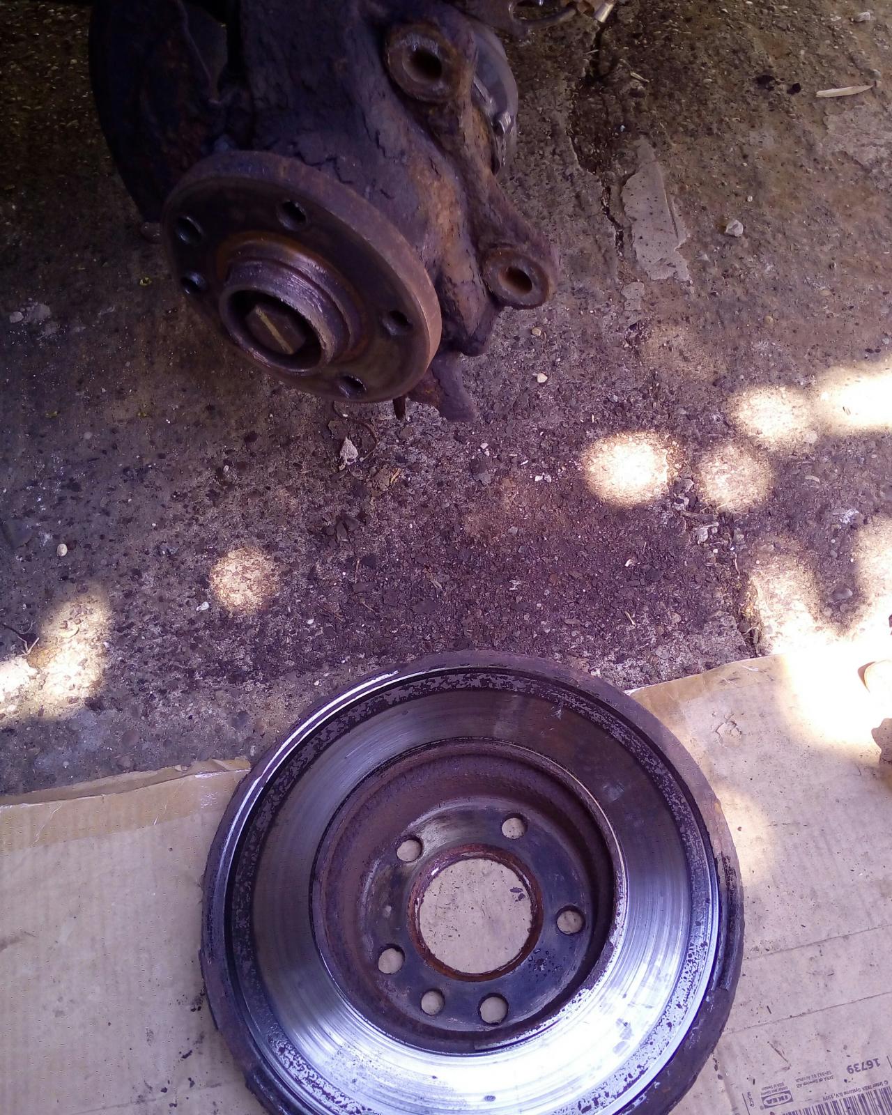

Not to be beaten by this i'm back in the searing heat having another go. This is where I am now.
