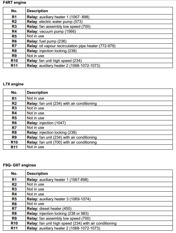

Looks to be one Fan, with 2 control relays. Both circuits go through that 60A fuse, with the engine ECU controlling both relay coils. One relay puts it through a resistor pack to slow the fan down. The other connects the other side of the resistor pack to connect the fan directly to power and thus full speed . Maybe this resistor has broken and is shorting against the chassis somewhere? Replacing the fuse earlier may have kicked the fans in full as it was cooking itself.
Here is the engine fuse box and relay locations: (Note the F4RT is your engine in the relay section)

I'd pull the low speed fan relay and replace the fuse to see if that fixes the problem for now. Obviously it'll get pretty hot before the fan kicks in at full speed. Also try and locate the cooling resistor (mine, being the V6 is the only one without it) and see if one of the terminals is shorting to the body.

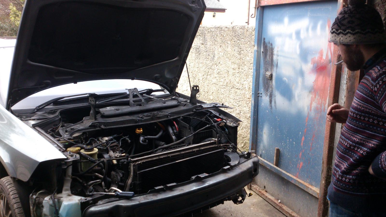

Driving home from work yesterday, this spat its dummy out.
In the outside lane of a dual carriageway, I accellerated , well tried to, and the car was having none of it. Oddly no blackpool illuminations on the dash, no mechanical chacophany, smoke or pistons flying through the bonnet....
Limped it home, and noticed that there is now a noticable turbo whistle, which wasn't there before, so I'm assuming that there is a split intake hose somewhere. As the car runs, idles, and drives ok apart from the lack of omph.
The acceptable boost range before it throws a light is probably pretty large. Hopefully it's not the turbo on the way out either.
Check for splits and also check the wastegate arm hasn't come off. How old are/condition of the vac pipes?
I'm assuming as the turbo is merrily whistling away, that it's all present and correct, also there is no blue smoke so can also assume that it's not shat it's seals. Will have a poke about under the bonnet tomorrow and see what the situation is.
Probably blown a hose off or split one as you say.
Same symptoms as a friends Goona 125 Privilege that spat the turbot out, no EML either.
Took 4 hours to change including I/C cleanout.
