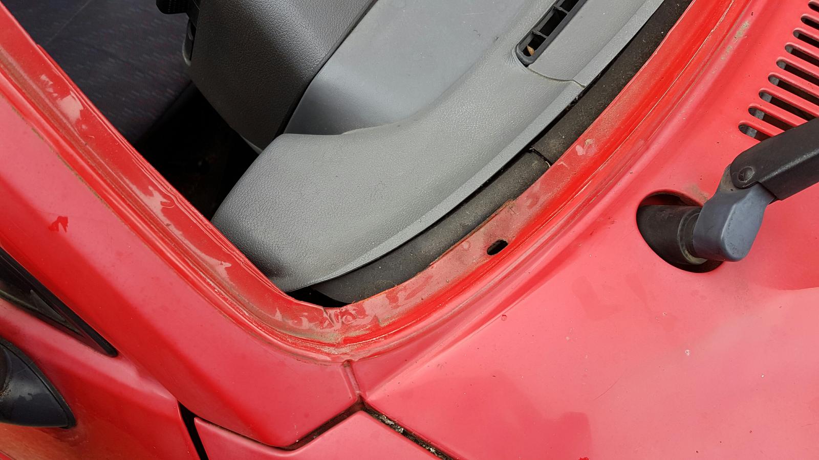

As I wrote in another thread the red Fiesta failed its test the other day on a stupid drain hole rotting out (one an inch above where it would be any use) and some scratches on the windscreen that have been there for years.
I'll do what I can to the hole if I done smash the welder up first and although I spoke to the tester about polishing the scratch out after a few posts on here I thought sod it and I've got them coming on Wednesday to put a new screen in.

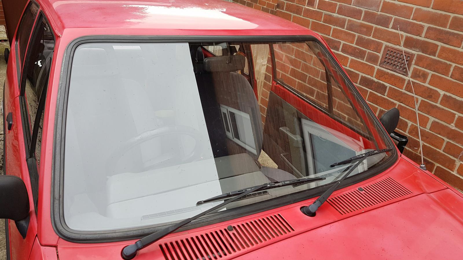

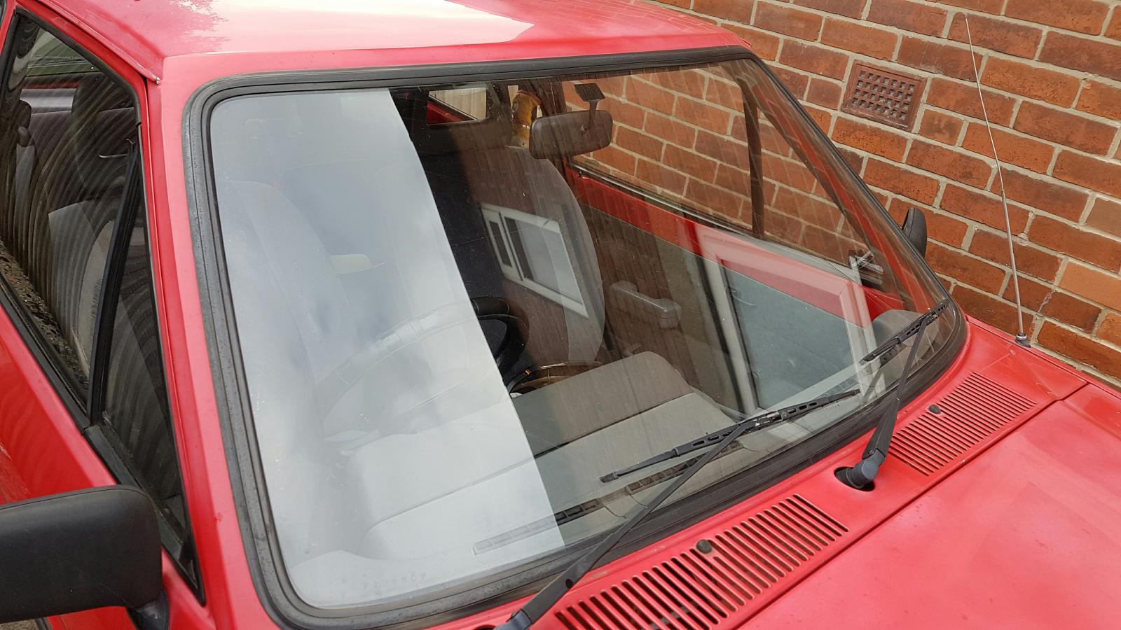

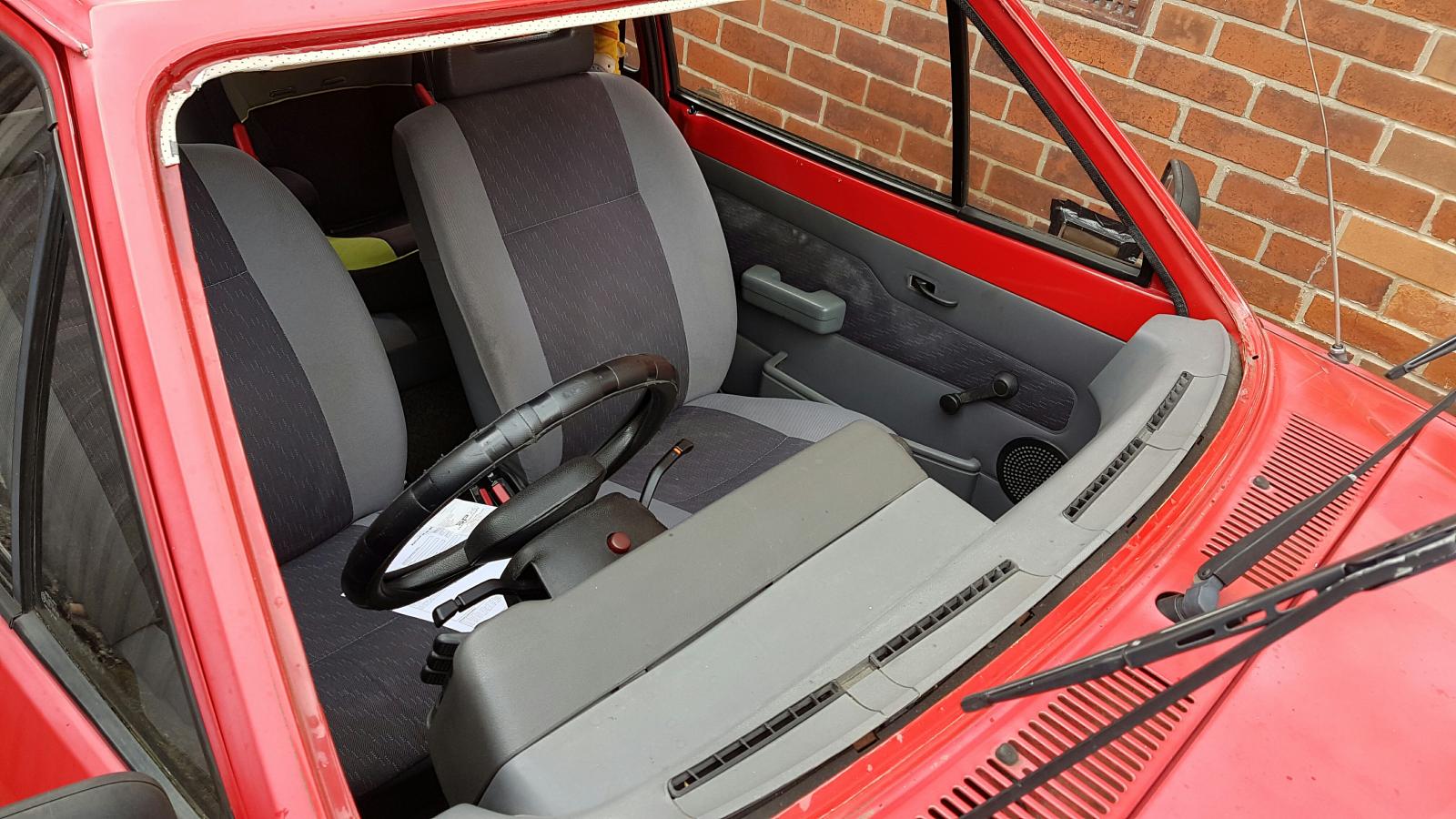

Windscreen changed this morning
Before
After
I know looks so different...

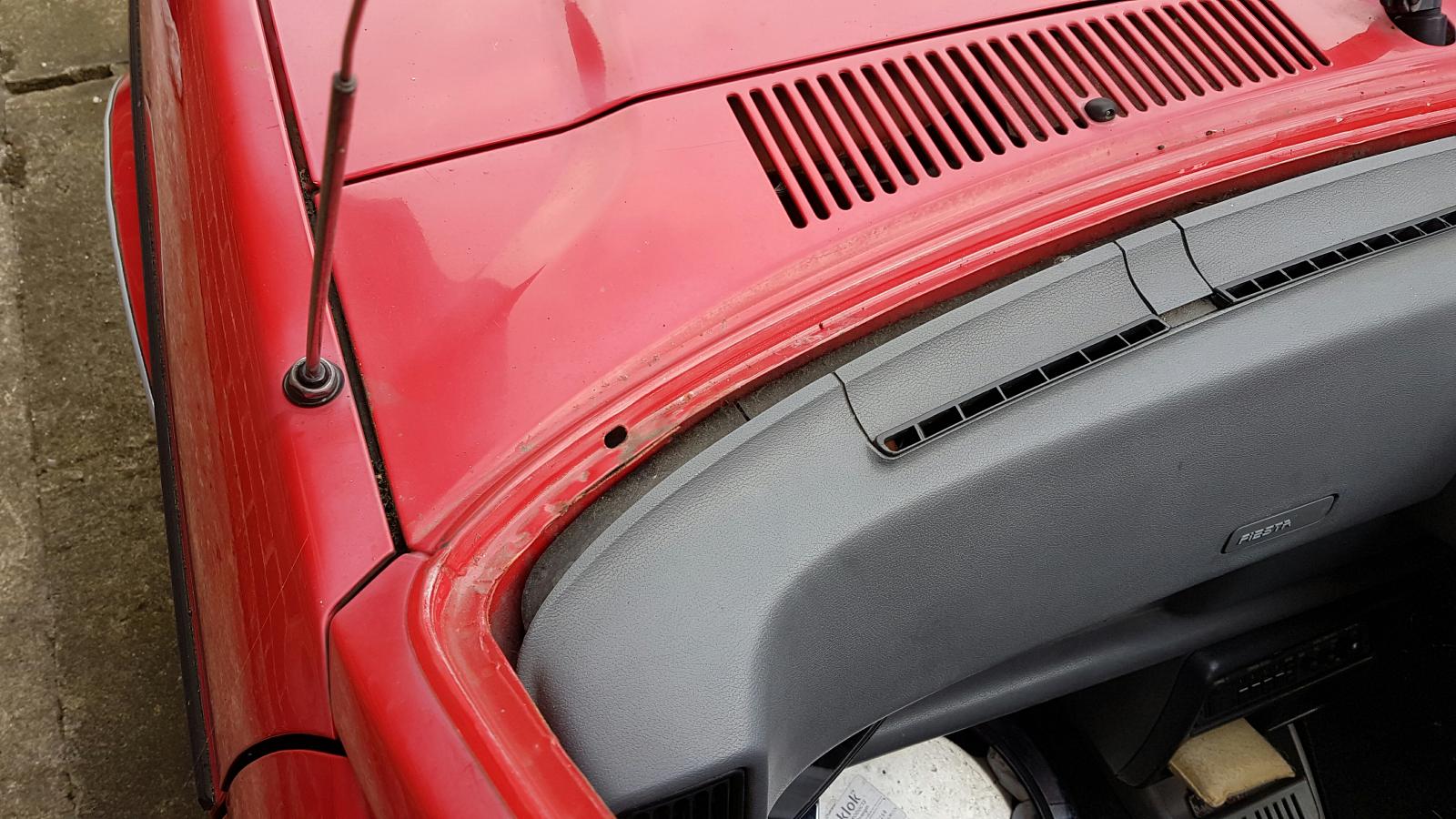

Good news when it was out though as not a bit of rust round the screen
Or either drain hole
They guy doing it was impressed commenting on how he's found them before in a mess so he must have been doing it a while.
Now it's time to start saving for the new inner and outer wings. While the parts aren't expensive and available the amount of welding is not small.
There's also the dilemma of the back arches. They've only gone on the lip and inside is still strong. So cut out good metal and put new arches on? Lot of work for such a small bit potentially doing more harm than good.

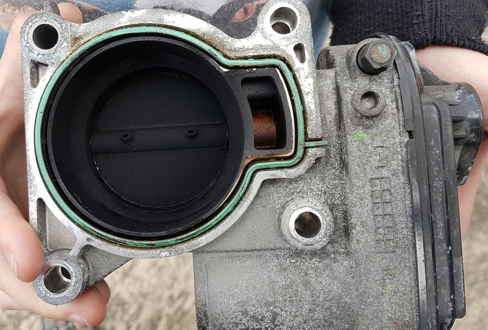

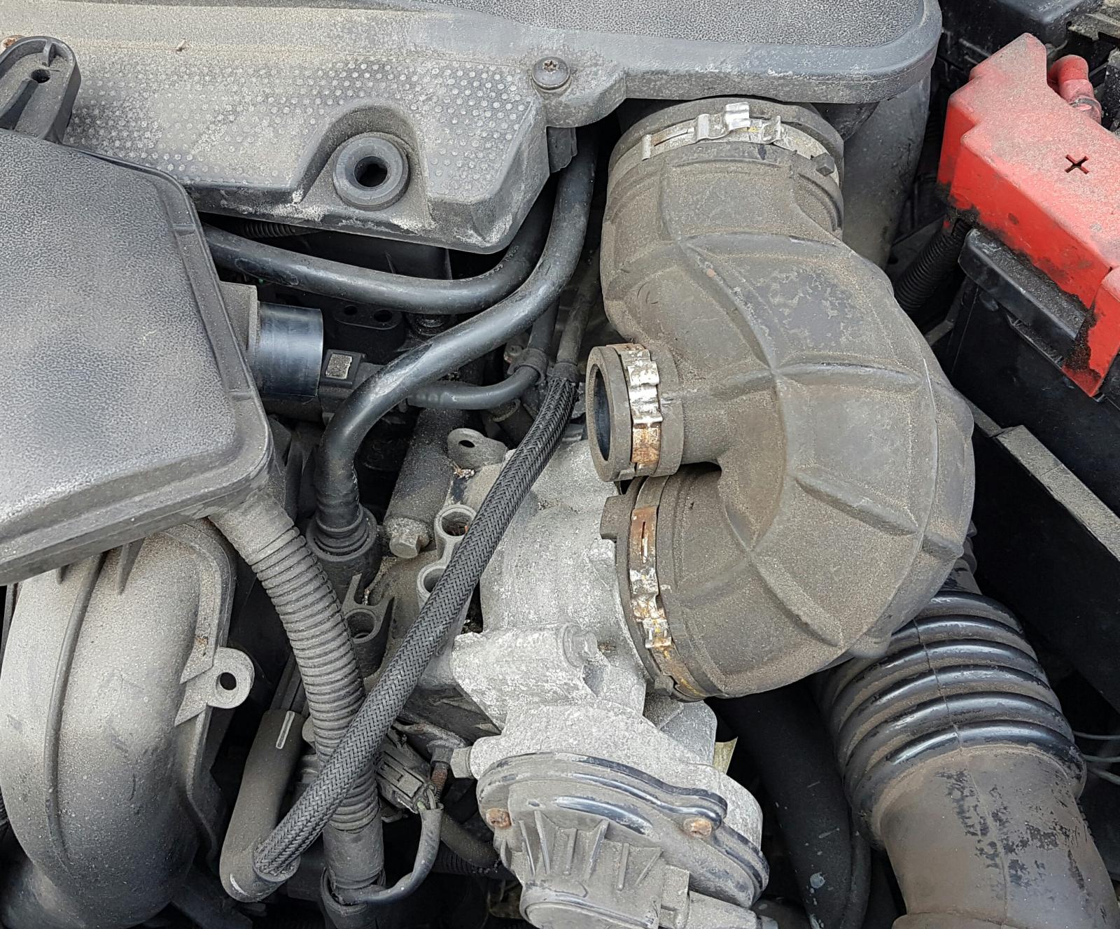

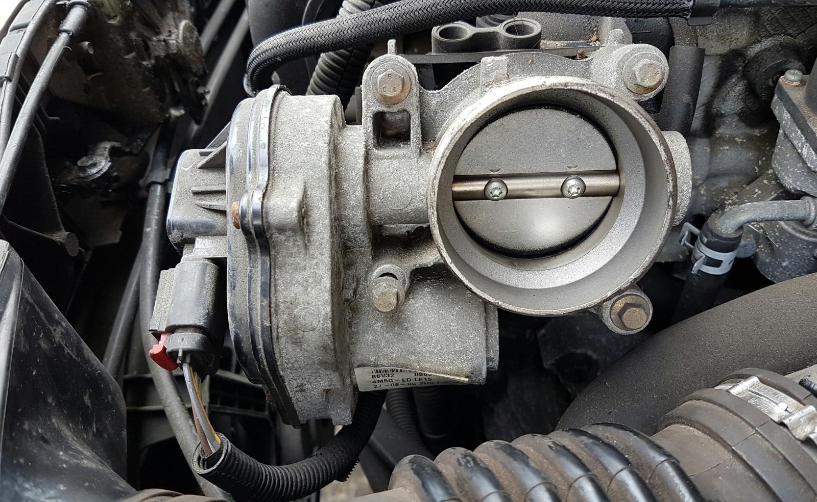

Thought I'd try and stop the ST over revving today so went to take the throttle body off
Internet says this has happened before and people have fixed it doing this.
Looked clean from the outside when I took the pipes off

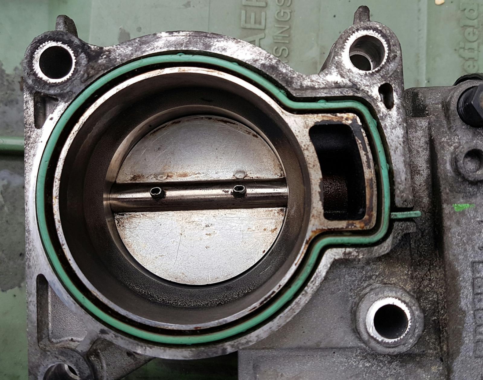

Other side was a bit different
Spent a bit of time and used Carb cleaner to get it looking ok
All went back together OK.
That's when the trouble started.
Now not only is is over revving but it's higher than before.
Tried to take it for a drive to see if that might help but instead I got it about 50 yards it started to judder and EAC fail came up on the dash.
Restarted OK but I took it back home. Didn't need to touch the accelerator as it was just moving itself. Push the clutch down to stop and the revs jump even higher to about 3000 and stay there.
I've left it on the drive with no idea what's wrong or how to fix it I'll go back and give it a try in an hour or so in case as Carb cleaner is affecting the engine? But really I'm clueless.
Some suggestions:
There is probably a throttle position sensor somewhere on the throttle body, this could have been knocked or something meaning it can't sense where the flap is.
Something might not be connected properly and be leaking air - any extra air getting in anywhere between the airflow meter and the engine causes problems.
Carb cleaner evaporates quickly and anything left would have burnt off immediately, so it's not likely to be that.
Would a throttle position sensor be thrown off if I've opened the flap while cleaning it?

Don't over complicate things so soon
Check for an air leak by spraying easy start/carb cleaner at the various hoses and joints whilst it's ticking over
Idle control valve would be the next item to investigate
