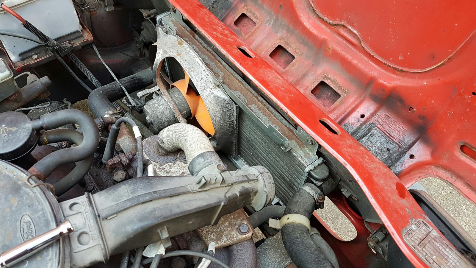

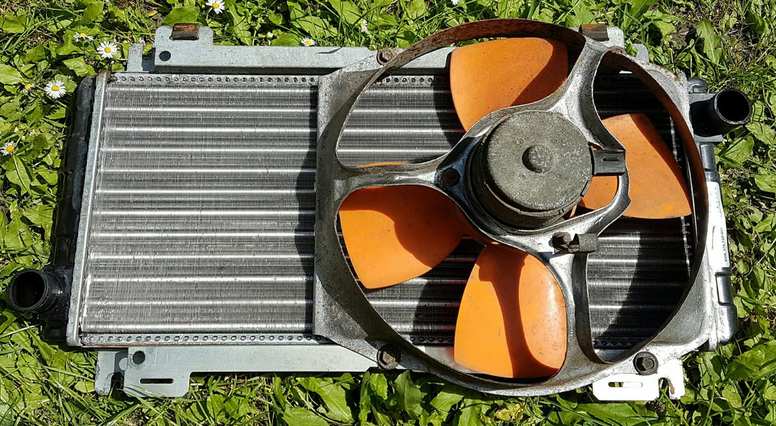

Thermostat was changed the other week and the old one checked, opened all OK. So is it a blocked radiator as I put some rad weld in it a few months ago as it's only 2 years old but got a small leak in the bottom
Looks OK off the car
Flushed it all out and only a small bit of brownish water came out, it didn't leak from the bottom.

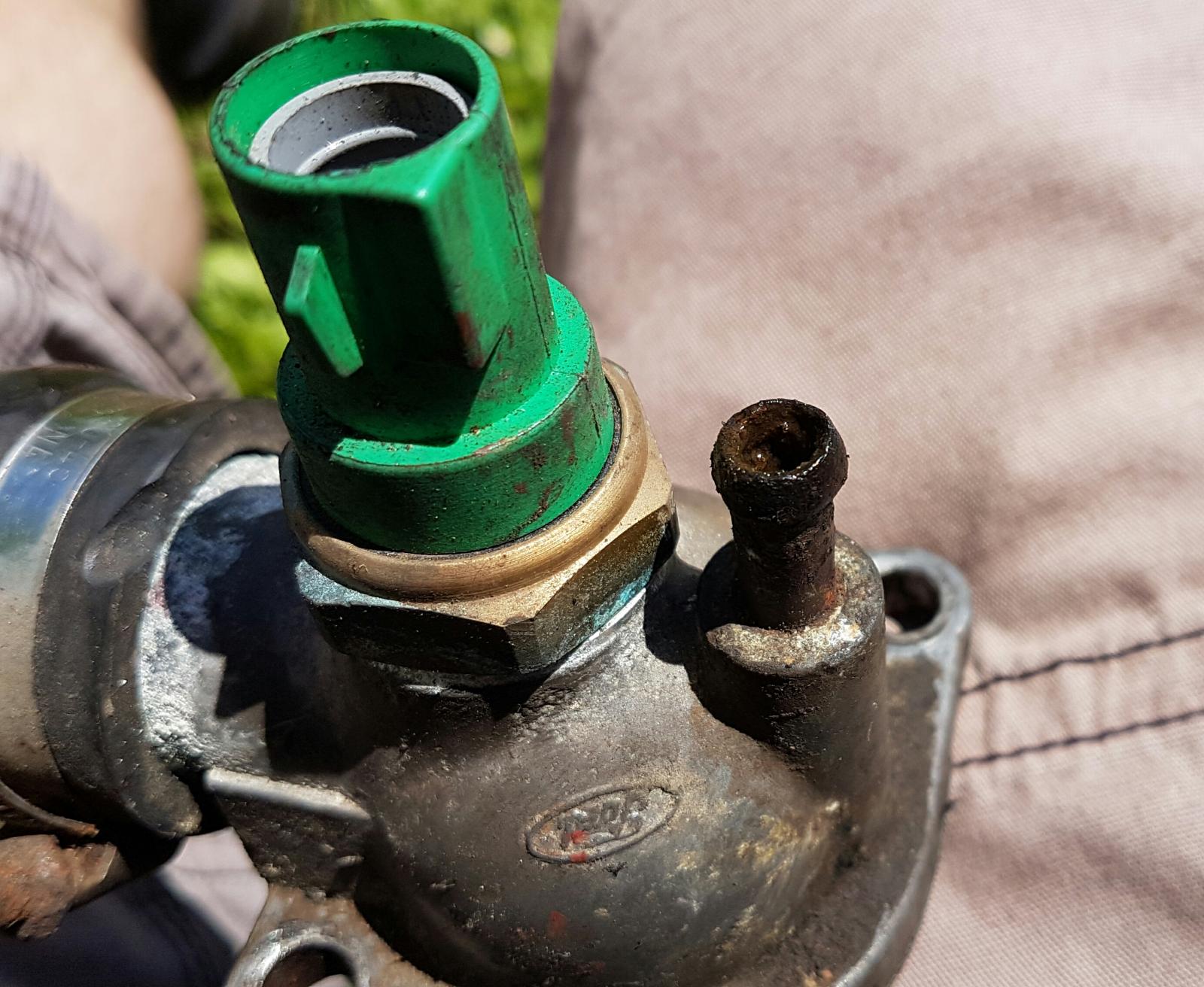

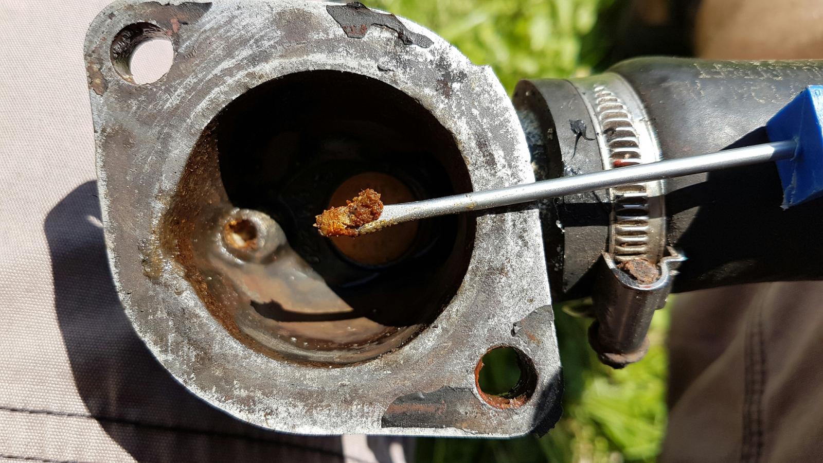

OK thermostat off. Thermostat cover had this little return tube totally blocked
Brown gritty stuff was removed and I cleaned the tube too, don't think it could have been causing that much trouble but I took the expansion tank off and cleaned that too.

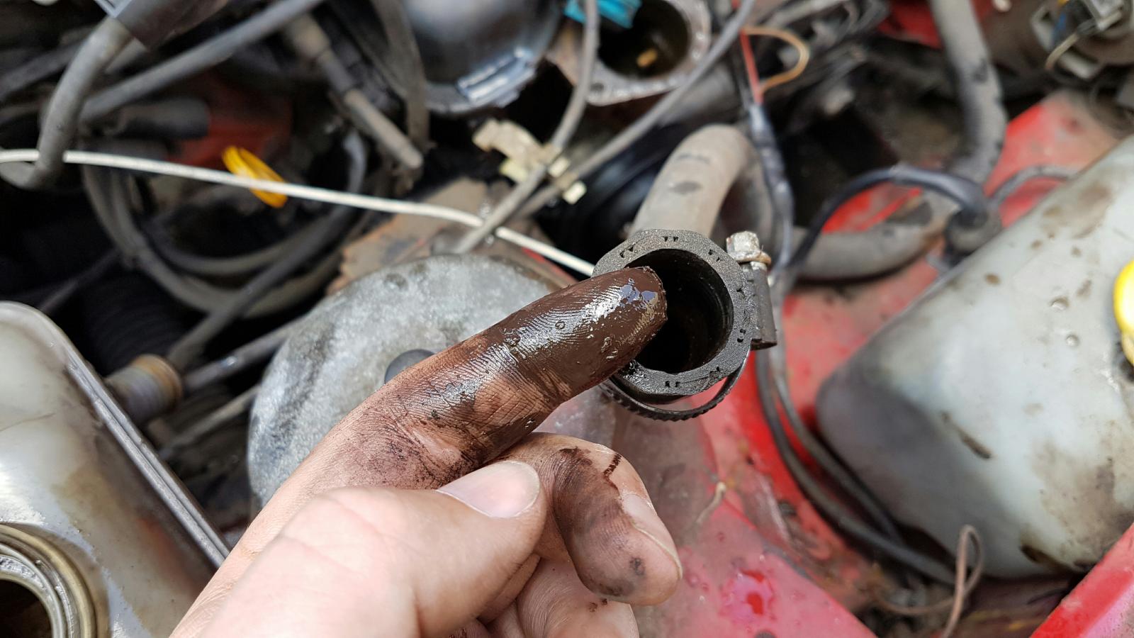

The hose from that to the engine though had this oily crap in it
Cleared it as best I could as the other end wouldn't come off and flushing the engine through was just coming out clean water.

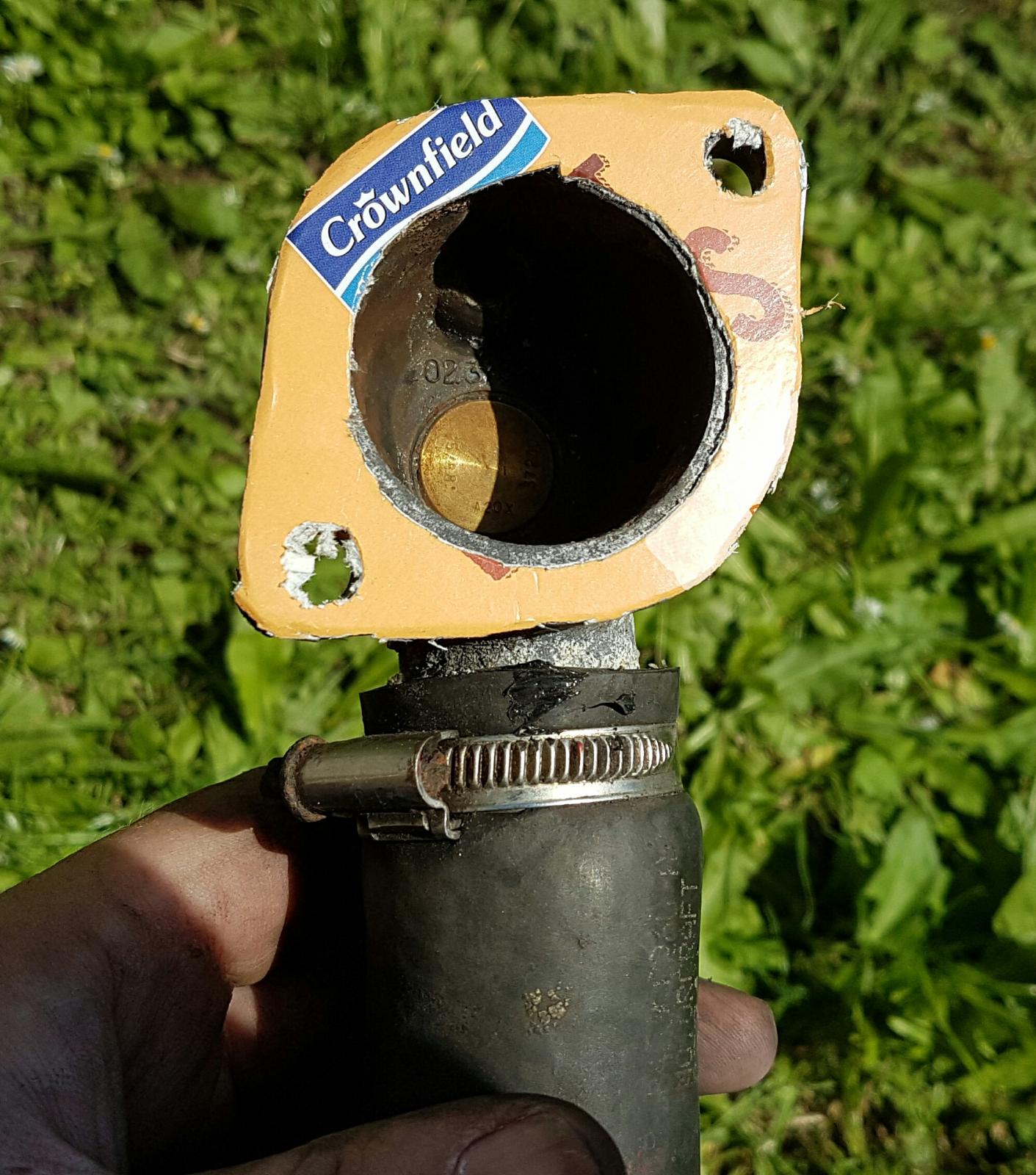

So expert gasket made
Sealed with some red crap and all put back together with no thermostat or antifreeze and taken for a longish drive, we'll long enough that it would get hot normally.

There's not too much to the cooling system on an ohv Fiesta. You could have some of that gunk in the heater matrix if the thermo housing was clogged with it, parts are still plentiful and cheap as chips though so no big deal if you have to replace stuff like rad and water pump or even the head gasket. I'd try the old dishwasher tablet in the expansion tank trick and see what happens.
From your symptoms I'd be inclined to think your heater tap has been blocked by the use of the radweld.
Does it heat up a lot when you give it the beans and then cool back to normal when driving normally? This would suggest narrowed waterways which you wouldn't detect with a flush as the water still appears to flow just fine.
I'd say the heater matrix is probably clogged up too tbh, this reminds me of my old F plate pop Plus, but mine had XR2 bumpers and XR pepperpots
What's a heater tap? If it is the rad weld that's narrowed the waterways can they be cleaned? Is that what the washing tablet in the tank will do?

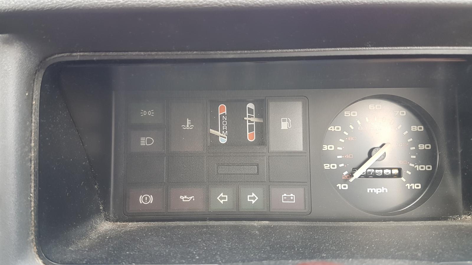

So with parts of the cooling system suspected to be partly blocked by radweld I thought I'd take the article out today for a drive still with no thermostat in.

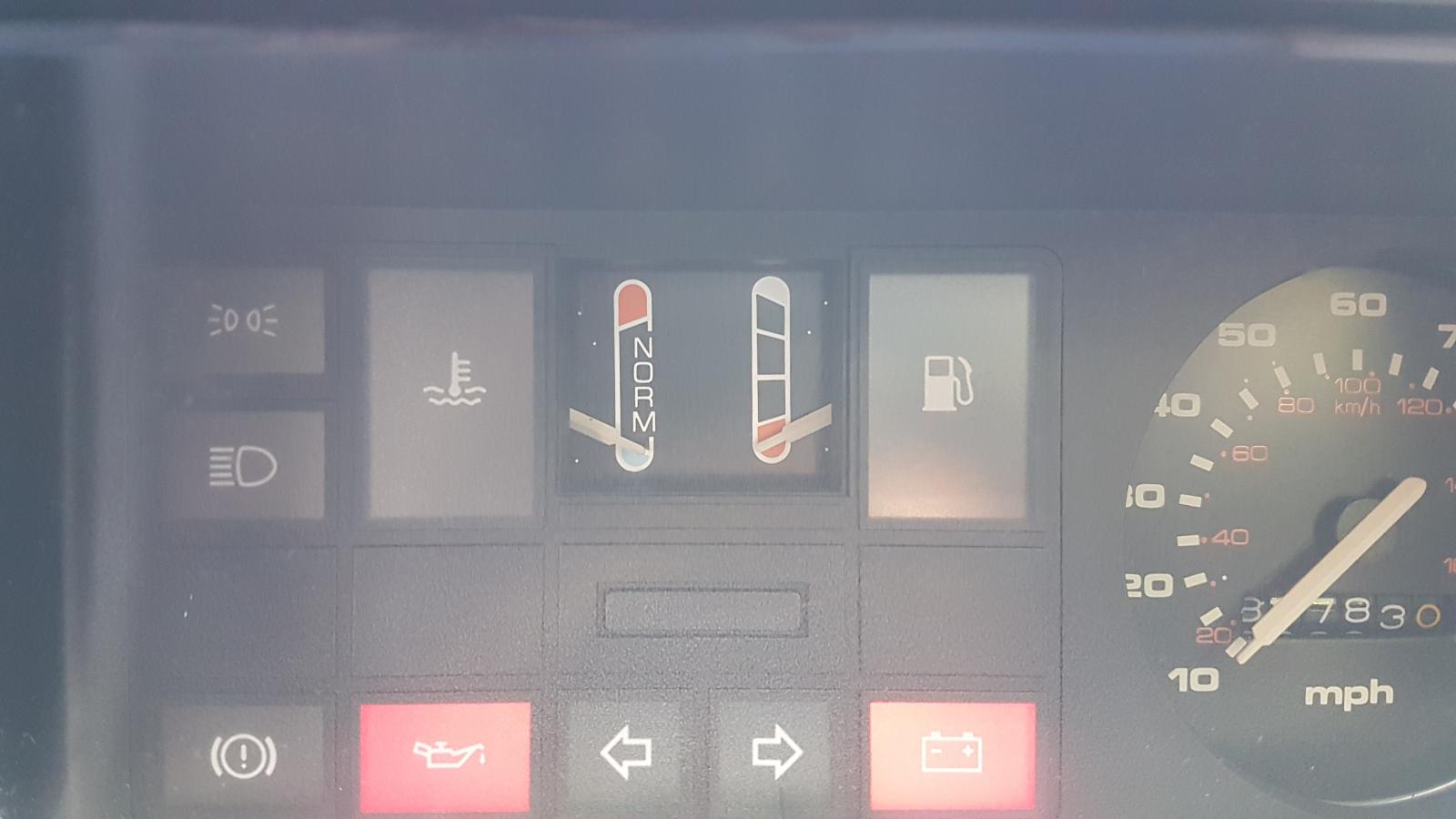

All going OK and the temp gauge only got as high as in the photo
As it was a tiny bit higher than last time I thought I'd check the heater. The twat blew hot!

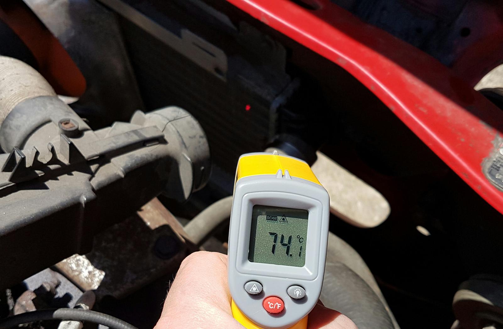

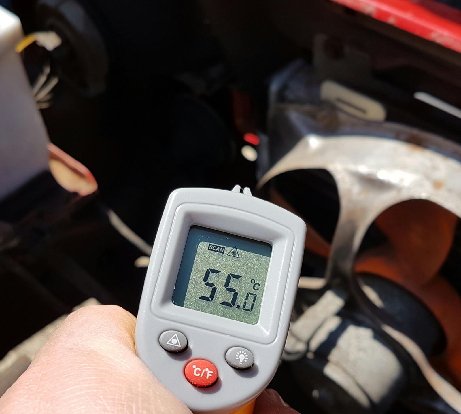

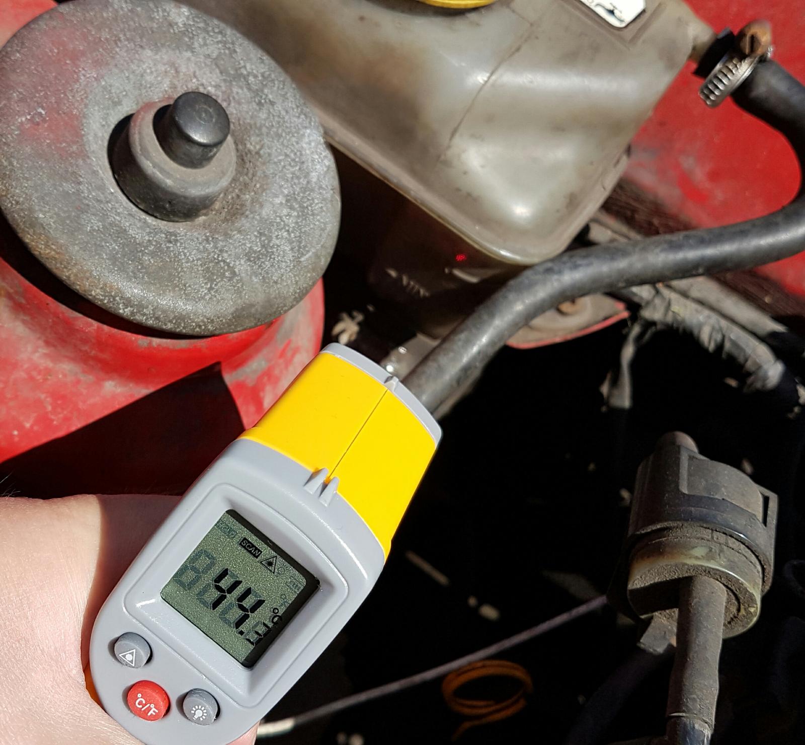

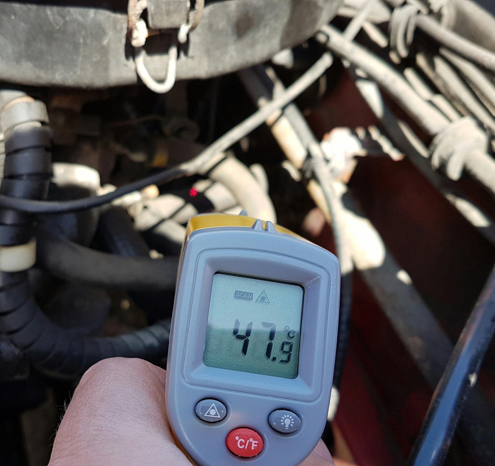

So I got it home and used the thermometer thing and everything looks all ok
In the header tank
Into the radiator
And out
Into the heater
And out
It didn't look like it had used any water
So what the chuff is wrong with it?? Why was the heater not working? Air lock? Blocked?
I don't think it's the head gasket or water pump.
Next step will be to put the thermostat back in and some anti freeze and go from there.

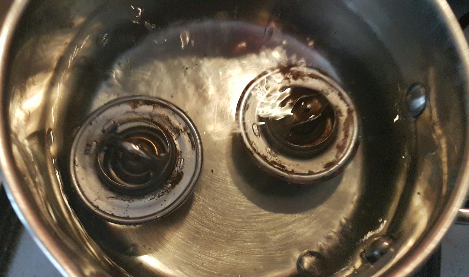

Check test
And both the new and the old* ones work ok
So back in went one of them. The water in the thermostat housing was clear so I'm convinced that it isn't hgf and must either have been blocked up somewhere or had an air lock.
