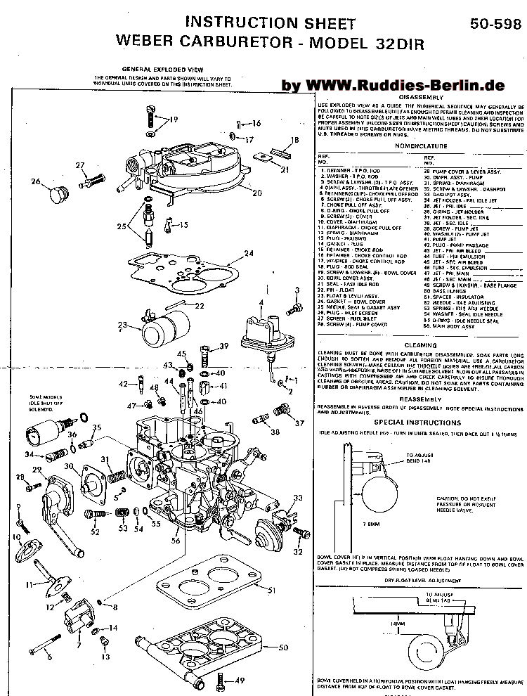

pshome Posted October 9, 2018 Posted October 9, 2018 This 32DIR diagram shows an idle adjustment needle (52).Is that the one?
SiC Posted October 10, 2018 Posted October 10, 2018 Site looks down. Here is a cached copy from archive.org. Archive of the page here: https://web.archive.org/web/20180223103525/https://www.ruddies-berlin.de/weber32DIR.htm
Junkman Posted October 10, 2018 Author Posted October 10, 2018 I have 52 as well, but the one I pointed out is in addition to it and not shown in those diagrams.

Eddie Honda Posted October 10, 2018 Posted October 10, 2018 As Herr Junkman is still asking stoopid questions, I assume that he hasn't telephoned da man. In the meantime, now I am back at my desktop PC, I have found da man's old Lotus Word Pro rebuild files on the Weber 32DIR (specifically for Volvo 300 B14), converted them to PDF and stapled the individual files back together to make the full guide. Hopefully the huge quantity of pictures with wordz and pointy arrowz might shed some light on the matter. Credit to Mac/Mollusk (Apologies to JM if he has contacted da man and/or he wasn't in.)Macs 32DIR Rebuild article.pdf RobT 1
Mally Posted October 10, 2018 Posted October 10, 2018 That's brilliant.Even I can almost understand it.
Junkman Posted October 10, 2018 Author Posted October 10, 2018 I don't understand a single word, but my carby is a 93 and has the setup shown on page 30, second from top.Hence I can't adjust it.
pshome Posted October 10, 2018 Posted October 10, 2018 So there are indeed two idle adjustment screws and you deal with them as described:For type 93, idle speed is initially set to 600rpm by screw B with screw A having been screwed fully in. The final correct idle speed is then set by (A).Idle mixture is set by screw C. (note different position to that used on type 83).Hence, i would proceed like this:- Screw A fully in- Screw B set so engine runs at 600 rpm- turn idle mixture screw C clockwise until the engine runs rough.- turn idle mixture screw C counter-clockwise 1/2 to 3/4 of a full turn, so that the engine again runs smoother.- set rpm to desired normal idle speed using A Eddie Honda and alf892 2

Junkman Posted October 11, 2018 Author Posted October 11, 2018 So there are indeed two idle adjustment screws and you deal with them as described: For type 93, idle speed is initially set to 600rpm by screw B with screw A having been screwed fully in. The final correct idle speed is then set by (A).Idle mixture is set by screw C. (note different position to that used on type 83). Hence, i would proceed like this: - Screw A fully in- Screw B set so engine runs at 600 rpm- turn idle mixture screw C clockwise until the engine runs rough.- turn idle mixture screw C counter-clockwise 1/2 to 3/4 of a full turn, so that the engine again runs smoother.- set rpm to desired normal idle speed using A When will you arrive? RobT, Dave_Q, They_all_do_that_sir and 1 other 4

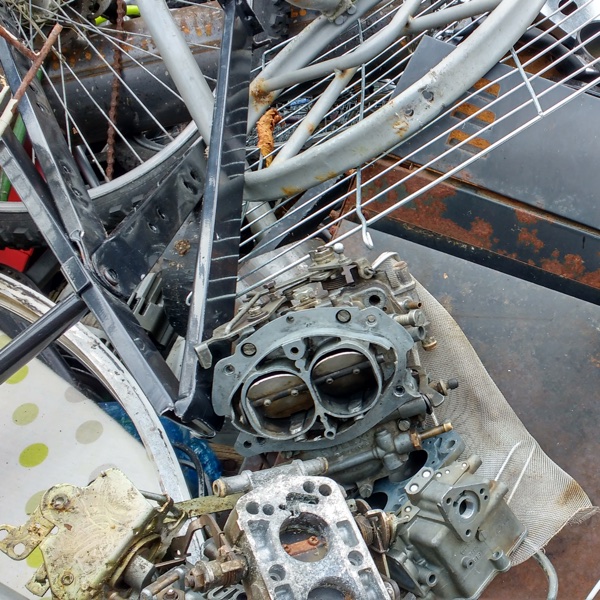

pshome Posted October 11, 2018 Posted October 11, 2018 So long, Solex solex.jpgtake revenge and sell it on leboncoin Junkman and Lacquer Peel 2
