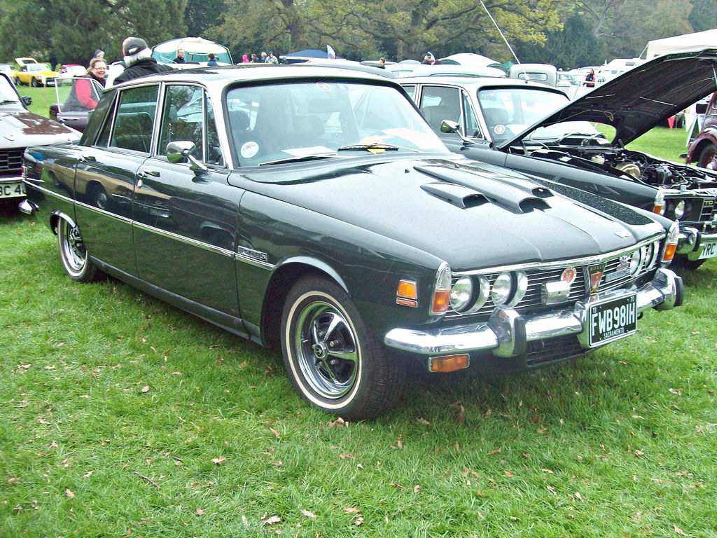

Junkman Posted September 30, 2018 Author Posted September 30, 2018 Keep the dashpots of Rover V8 SUs WARM????What on earth has that clot not understood? pshome 1
Squire_Dawson Posted September 30, 2018 Posted September 30, 2018 SOMETHING must be DONE. Why don't you rebuild the Solex, eh?
Conrad D. Conelrad Posted September 30, 2018 Posted September 30, 2018 Keep the dashpots of Rover V8 SUs WARM????What on earth has that clot not understood? That is actually an improvised carb cooler. The windscreen washer has been re-routed to soak the socks. Car was vapour locking in Morocco. https://www.pistonheads.com/gassing/topic.asp?h=0&f=47&t=1142169&i=60 Junkman, RobT, chaseracer and 5 others 8
Squire_Dawson Posted September 30, 2018 Posted September 30, 2018 So Rover could really have used one of those bonnet scoops, which were purely decorative on other cars.
