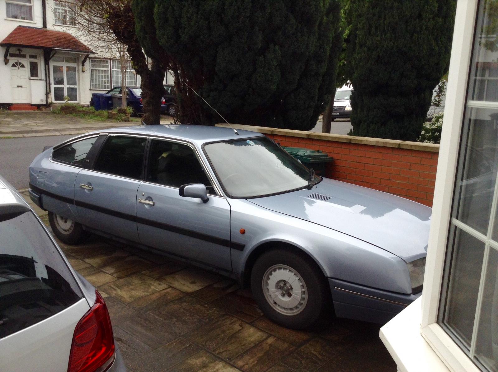

Zelandeth Posted June 6, 2018 Posted June 6, 2018 I'd love a shot of a CX, especially an early one. Citroen have shown that there's massive potential in the system...the CX shows that from a comfort perspective - with the Xantia Activa firmer, but seeming to totally disregard any regard for physics where cornering is concerned. It's something that has to be experienced to really be understood fully I think... getting into anything after the Activa these days feels like an ocean liner if taken around a corner of roundabout at anything over walking pace... Lacquer Peel 1

Tadhg Tiogar Posted June 7, 2018 Posted June 7, 2018 .....I do reckon that everyone should have a shot of one though...like it or not, it's worth experiencing.I count myself incredibly lucky to have stumbled unexpectedly into owning mine.It took me three years to find a CX that didn't sell before I could get my hands on it.
