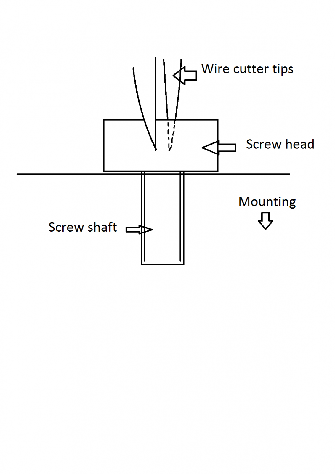

chodweaver Posted May 17, 2017 Posted May 17, 2017 ^ They look nice but I don't see them having much more to offer than a small pair of Vise-Grips/Molewrenches. And those lock on rather than relying on your ability to keep these tight enough on the offending screw with pressure from just one hand At 1min 43 seconds, I decided I didn't need to see any more infomercial footage of a pair of overpriced pliers undoing some completely not tight and slightly mangled screw and bolt heads. Am I missing something? ETA Sorry for the thread hijack. If the screw is metal and the threaded hole is metal, have you got some PlusGas on it yet? Is the head countersunk? Can you get some evil pliers on it? My favourite for small screw and bolt heads where they've rounded off either internally or externally and the head is exposed is to get my biggest Snap On wire cutters on it, with some serious pressure, so that the cutter blades actually make grooves down the outside of the head. The width of the handles on the cutters gives more leverage than the screwdriver handle and this often shifts it where nothing else will. Looks utterly daft. Worked like a charm more times than I can remember

Snipes Posted May 18, 2017 Posted May 18, 2017 ^ They look nice but I don't see them having much more to offer than a small pair of Vise-Grips/Molewrenches. And those lock on rather than relying on your ability to keep these tight enough on the offending screw with pressure from just one hand At 1min 43 seconds, I decided I didn't need to see any more infomercial footage of a pair of overpriced pliers undoing some completely not tight and slightly mangled screw and bolt heads. Am I missing something? ETA Sorry for the thread hijack. If the screw is metal and the threaded hole is metal, have you got some PlusGas on it yet? Is the head countersunk? Can you get some evil pliers on it? My favourite for small screw and bolt heads where they've rounded off either internally or externally and the head is exposed is to get my biggest Snap On wire cutters on it, with some serious pressure, so that the cutter blades actually make grooves down the outside of the head. The width of the handles on the cutters gives more leverage than the screwdriver handle and this often shifts it where nothing else will. Looks utterly daft. Worked like a charm more times than I can remember Wire cutters as screw extractors.pngTut tut twisting your cutters Luke that. That's how they break! twosmoke300 1

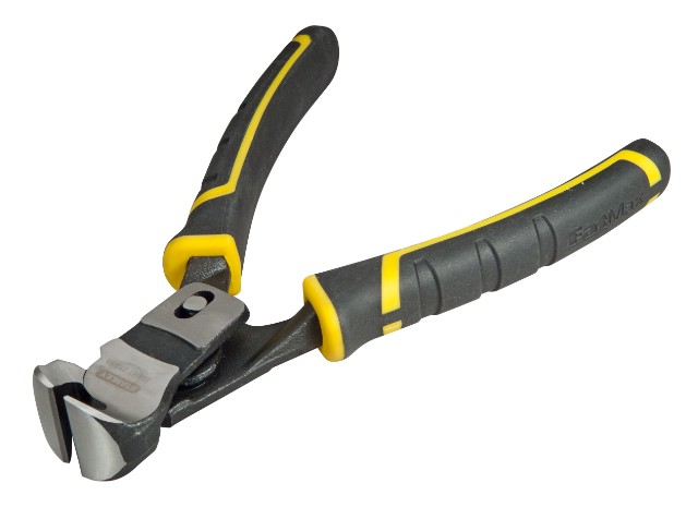

Bren Posted May 18, 2017 Author Posted May 18, 2017 These got it undone. chodweaver, Stanky and SiC 3
