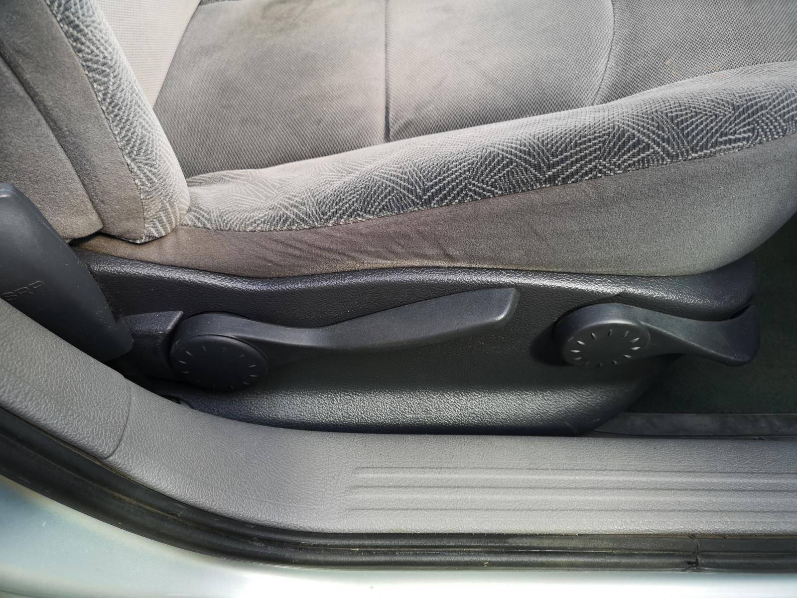

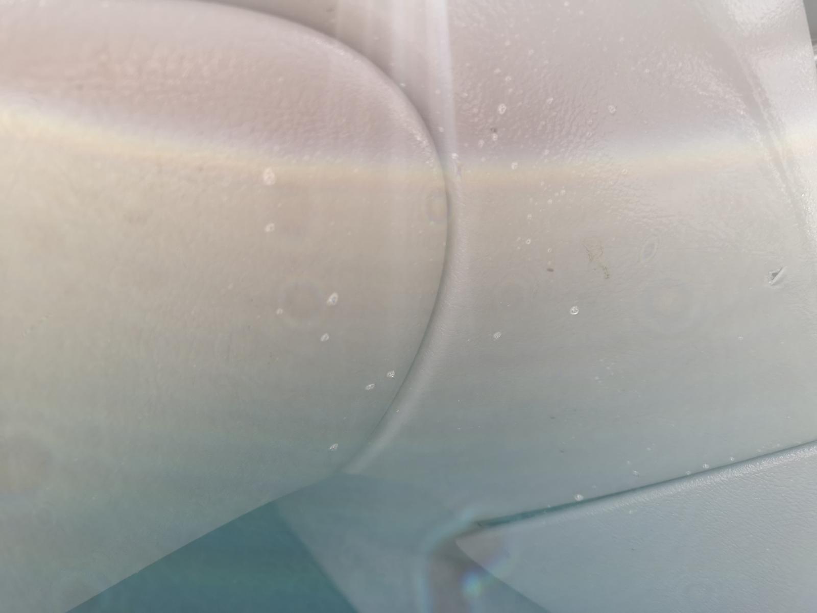

beko1987 Posted August 25, 2018 Author Posted August 25, 2018 I had a flush of wanting to do something today, and the children were out/going out, so I pulled the Gooner around into the workshop opened the doors And got the vacuum out Charlie helped for a bit before he went out And I spent a few hours mucking the thing out etc. Also got busy with the g101 and some cloths and scrubbed the plastics down which I've never really done before All good stuff, and it smells less like a toilet inside now! Buoyed with this success, I had a look at the non working horn. Steering wheel cowling off, I had the indicator stalk off, as a common fix apparently is the contacts under there.. These were fine, and fixed nothing. I then dug out the stalk I saved from the old gooner which I have never really fitted as I prefer non cancelling indicators, again, nothing... It then started to rain so I packed up, but I have 2 choices now: Choice 1 is taking the bumper off and look at the horns themselves. I did peek at the bottom one, after jacking up the corner and pulling the splash guard back, and it looked fine, the connector was dry and it all looked quite clean. I did wonder if it was happening with water being splashed up etc, then I remembered it's not rained properly for months here, and the bit of rain we have had I've not really driven in! Choice 2 is to take the steering wheel and bastard airbag off, and have a look at the clock spring, again another common issue, although apparently unlike the xantia, it doesn't break up internally, but the floating contacts flatten out over time, which might explain why it does sometimes work... TBH I do have an option 3 which is once the windscreen is replaced, if it randomly starts to work get it MOT'd 3 months early and then just worry about it next year! I've reached a bit of a plateu with this now. It's still being a car fine, averaging 54mpg, its a comfy, warm and dry place to sit, however the clutch is still very infrequently not coming fully up (although I can count on one hand how many times its happened, so not fully full of doom about that yet), and the engine sounds quite rattly from the belt area especially when cold. If the MOT ran out in April I would be OK as I get my bonus from work in March, so could just buy another car, but the MOT is out in Jan. So the windscreen is getting replaced after payday because it's got a fucking big crack now, and I noticed today that the rain is getting into the crack, and it wont last 5 minutes when it gets frosty. Once thats done, and the horn works it'll just be driven! Back brakes squeal when reversing quite frequently, usually as I reverse onto mums drive or my parking space after a 40 minute drive home from work. As this only happens when going backwards, which I rarely do, I'm ignoring it for now. The discs are not the cleanest, but it brakes good and straight, so it'll be fine! When it starts doing it going forward I'll worry Everything is OK on it, brakes are good, tyres are good, lights are good etc, so it should pass the test OK. Then when I get my bonus, I'll either buy another car, or put the money in an envelope and give it to my mum and see how long the gooner lasts. Either way, it's going full bangernomics unless something silly fails, although if I get the horn working I'll give it an oil change, it's been about 10k since the last one. Jim Bell, Shep Shepherd, Split_Pin and 2 others 5

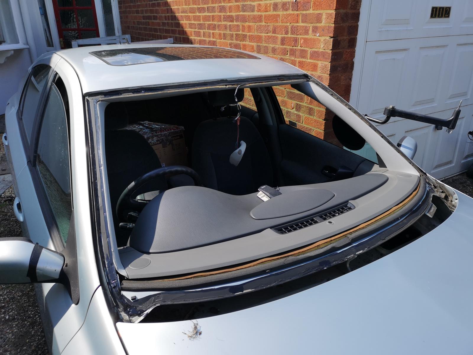

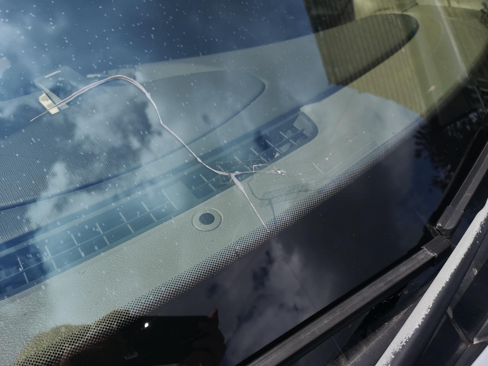

beko1987 Posted August 31, 2018 Author Posted August 31, 2018 Today I said goodbye to And hello to a hole Mum says it's finished now, and the chap let me grab the birds nest of shit out that was under the scuttle. I also tipped some magic potion in Because although I've seen no visible smoke when I've caned it to check, the back corner by the exhaust is black, I've been wafting a bit too much I think! egg and Jim Bell 2
Guest Hooli Posted August 31, 2018 Posted August 31, 2018 You can't even get rid of it like that... Stolen from another thread Kiltox and jumpingjehovahs 2

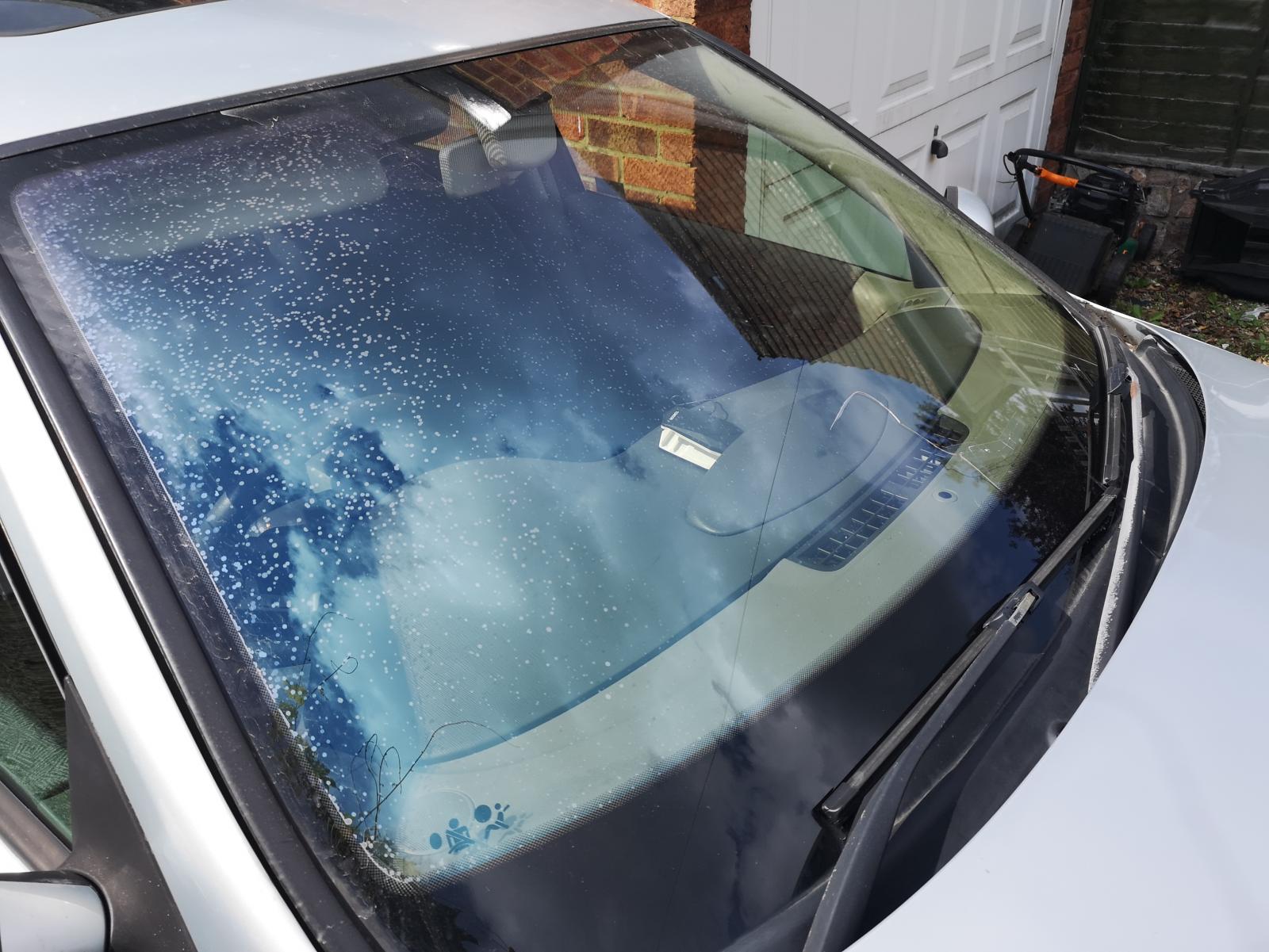

beko1987 Posted August 31, 2018 Author Posted August 31, 2018 I've never had a new windscreen in a car, nor a particularly non scratched to fuck windscreen Its very weird! Kiltox, Lacquer Peel, oldcars and 1 other 4
SiC Posted August 31, 2018 Posted August 31, 2018 Have you put new wipers on? Don't want your shiny new screen with wipers that have dirt in them!
beko1987 Posted August 31, 2018 Author Posted August 31, 2018 Not yet, they work fine but then I did buy them when I had the blue gooner...
Kiltox Posted August 31, 2018 Posted August 31, 2018 Get new wipers! Good ones too! Nothing like a new windscreen scdan4 and oldcars 2
