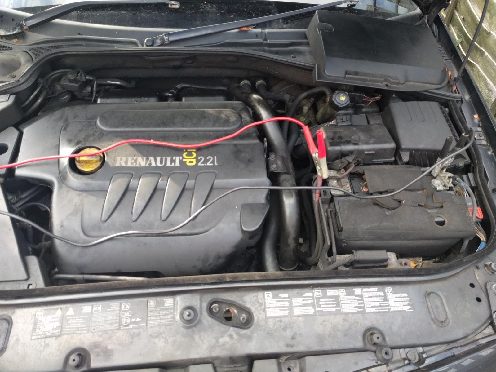

Dunno if this is just due to a flat battery at some point, but I cleared those (infact I got out of the car just incase the app maker built an Easter egg into the app and the air bags went off...
No don't worry, there isn't anything in there like that!
Then read the engine again and got these two codes up as stored
These won't clear, so they can stay! Still no dash lights so that's fine, I won't prod the beast too much yet!
They may have been triggered by clearing the codes, as it make clear the calibration of the throttle body. Once either ignition cycled or just driven, it'll probably fix those itself.

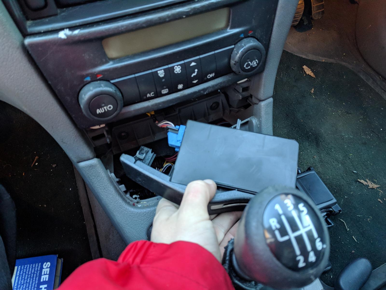

So, todays jobs. Number one was to swap the identical heater controls.
Identical....Ah buggar
FY51
YT55

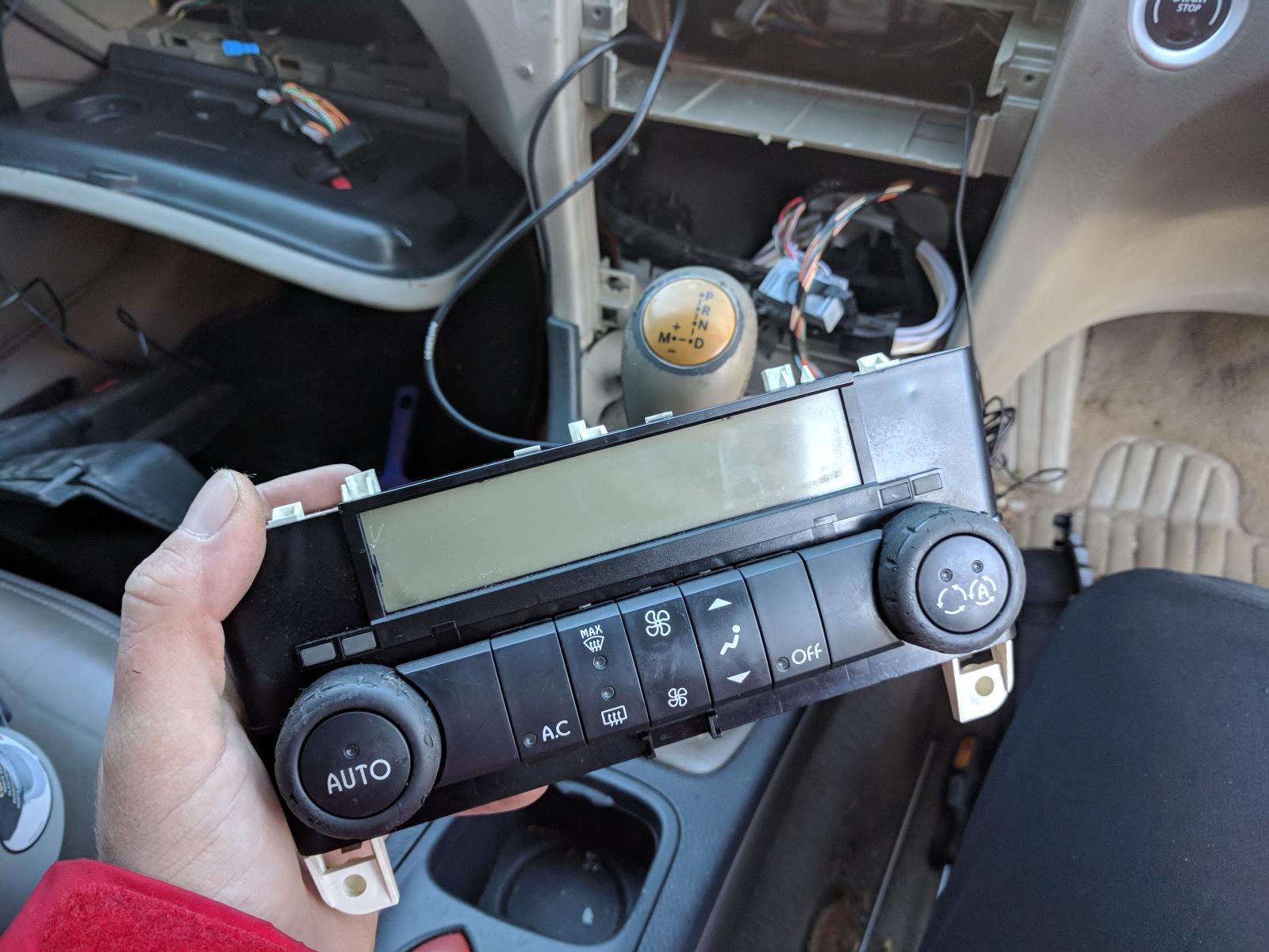

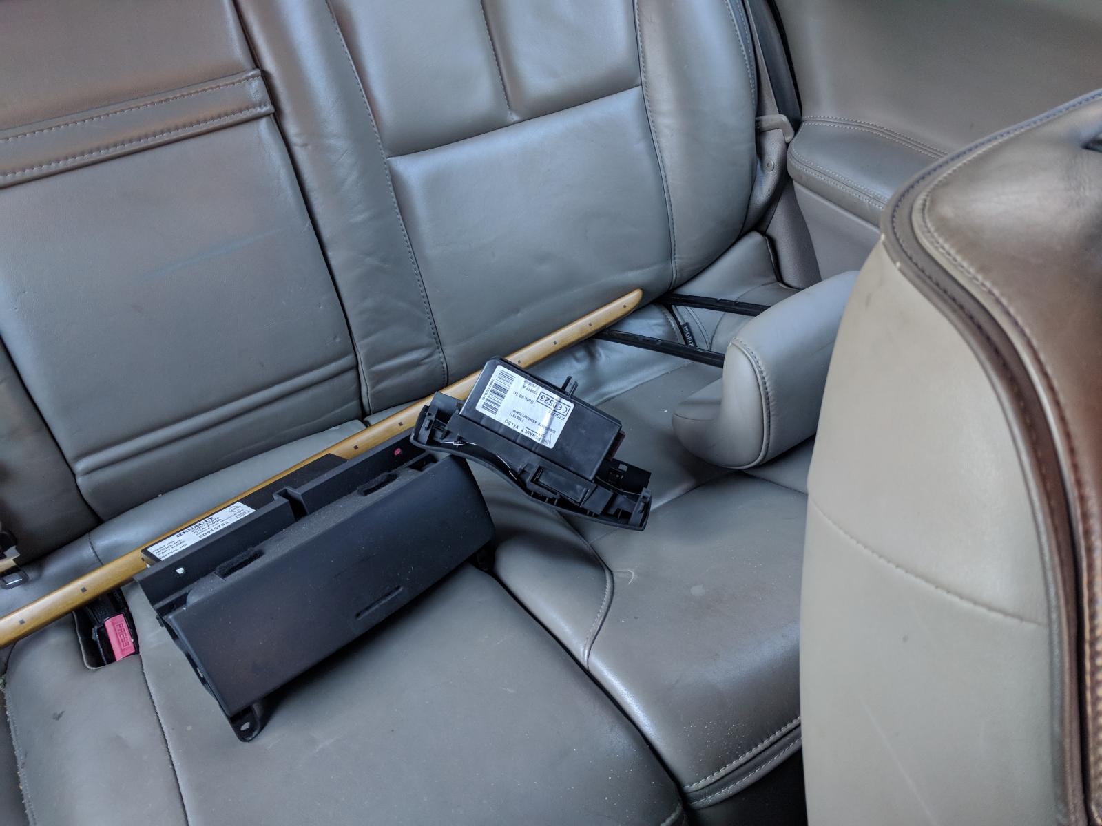

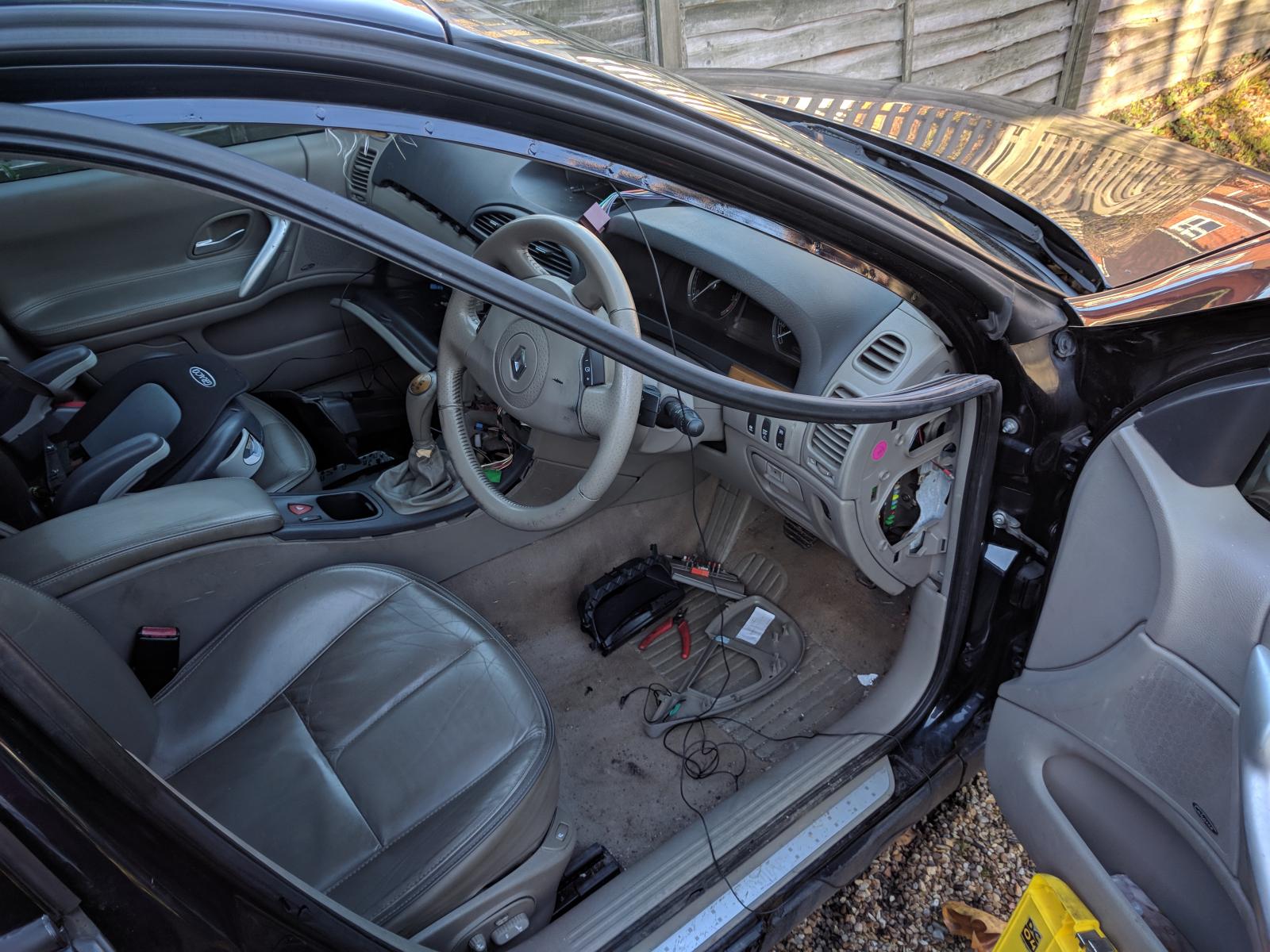

Still, maybe the internals are the same, so out came the dash from the scrap gooner
onto the back seat
And here we go
Luckily the dash on FV51 has been apart before, so everything almost fell off with a light tug

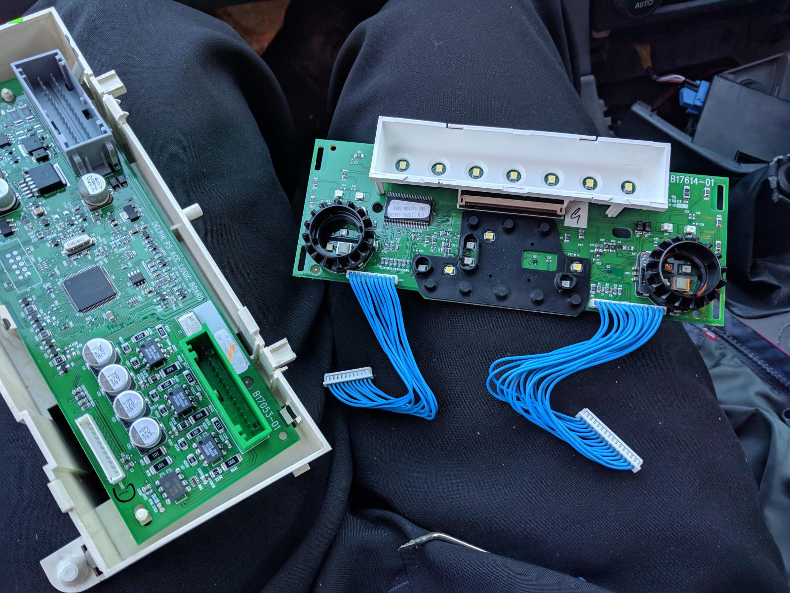

Just need to plug the other one in and... ah, different sized connectors!

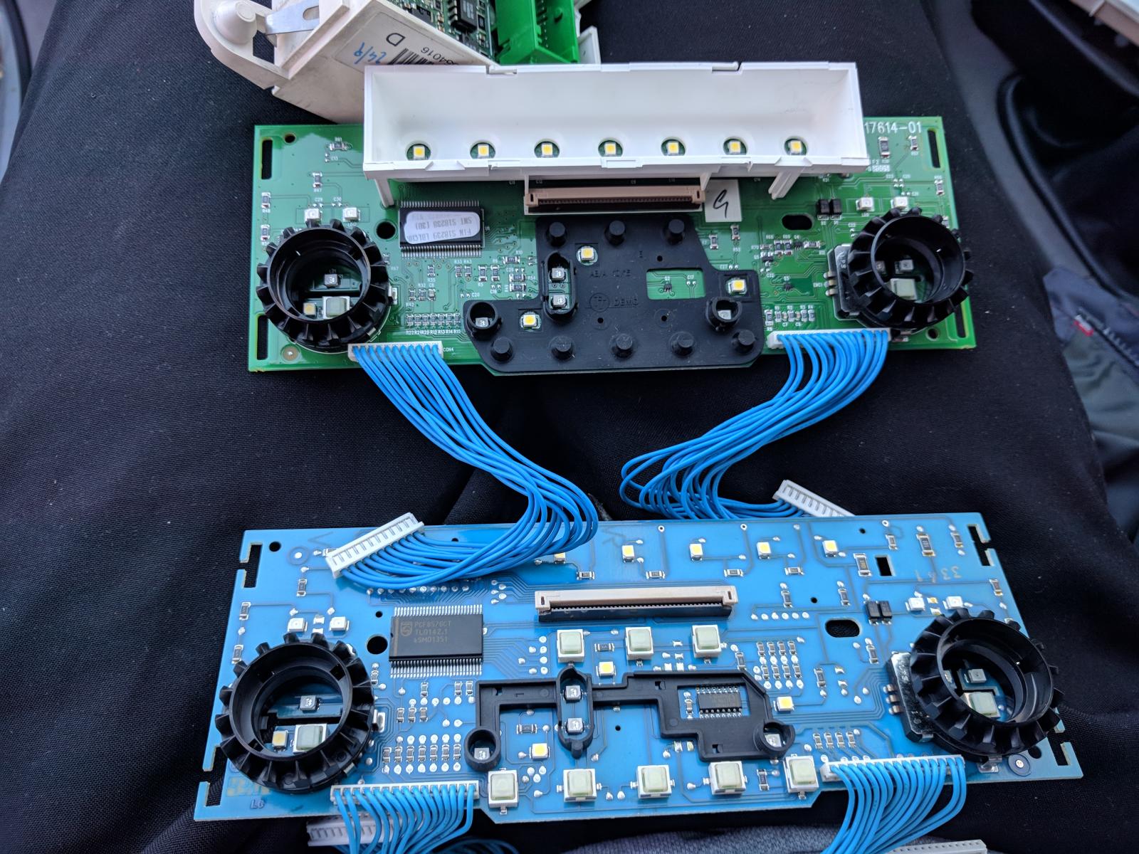

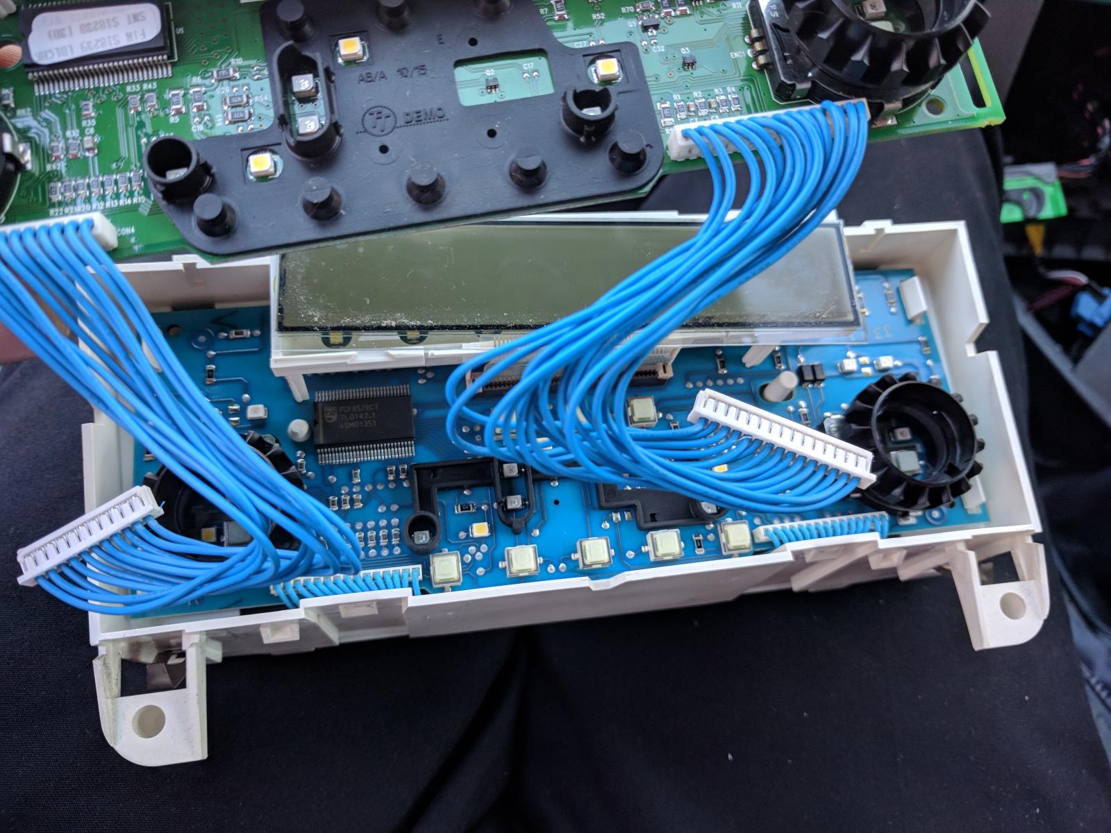

Mmmm,. maybe the internals are identical, so off with the front

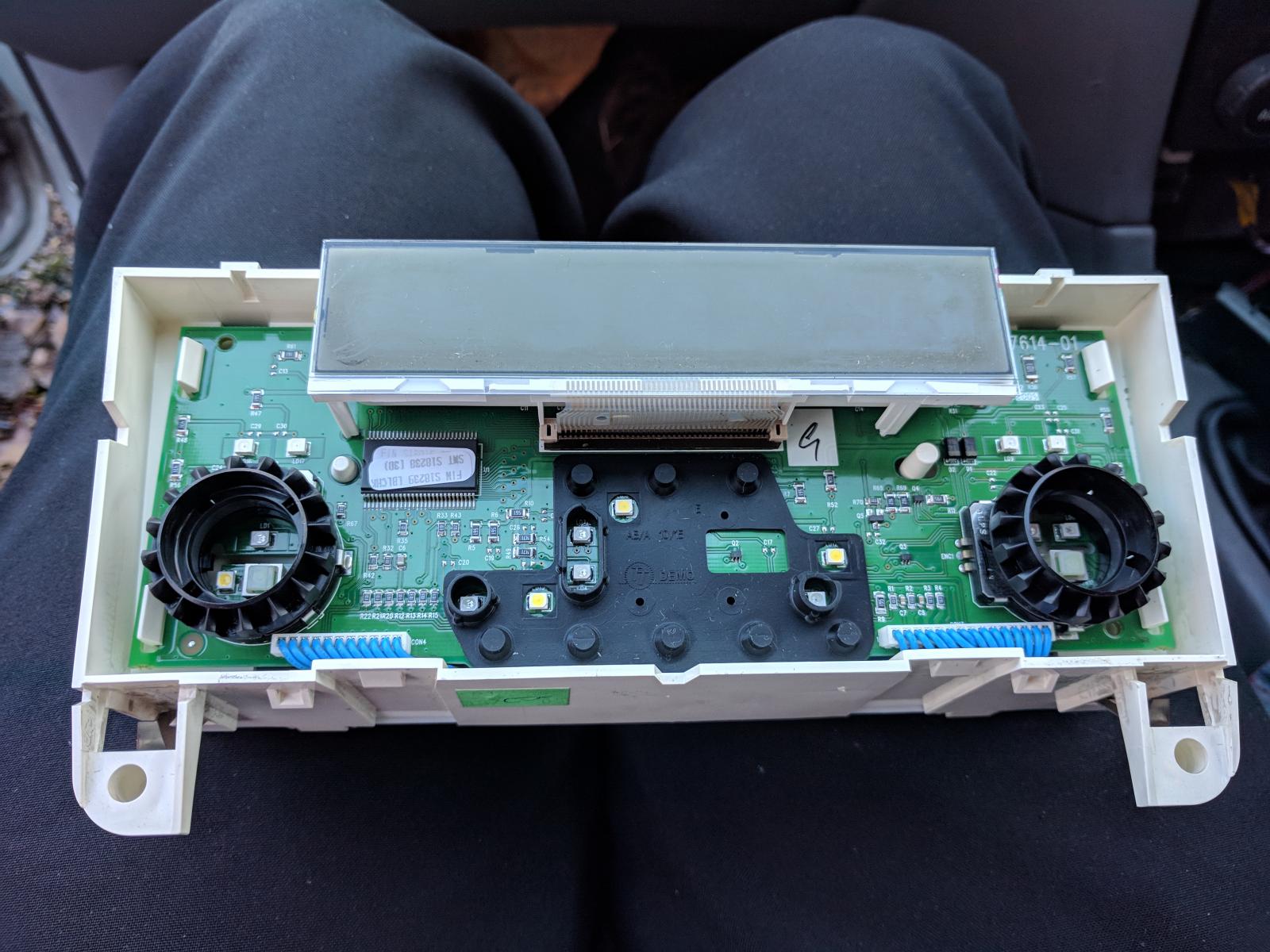

We want this board, so off with the back and unplug it
Apart with the non lit one, and yes, there is a similarity!
So out with both boards
And all we have to do is plug the blue one into the green and Nope! One connector is a different size

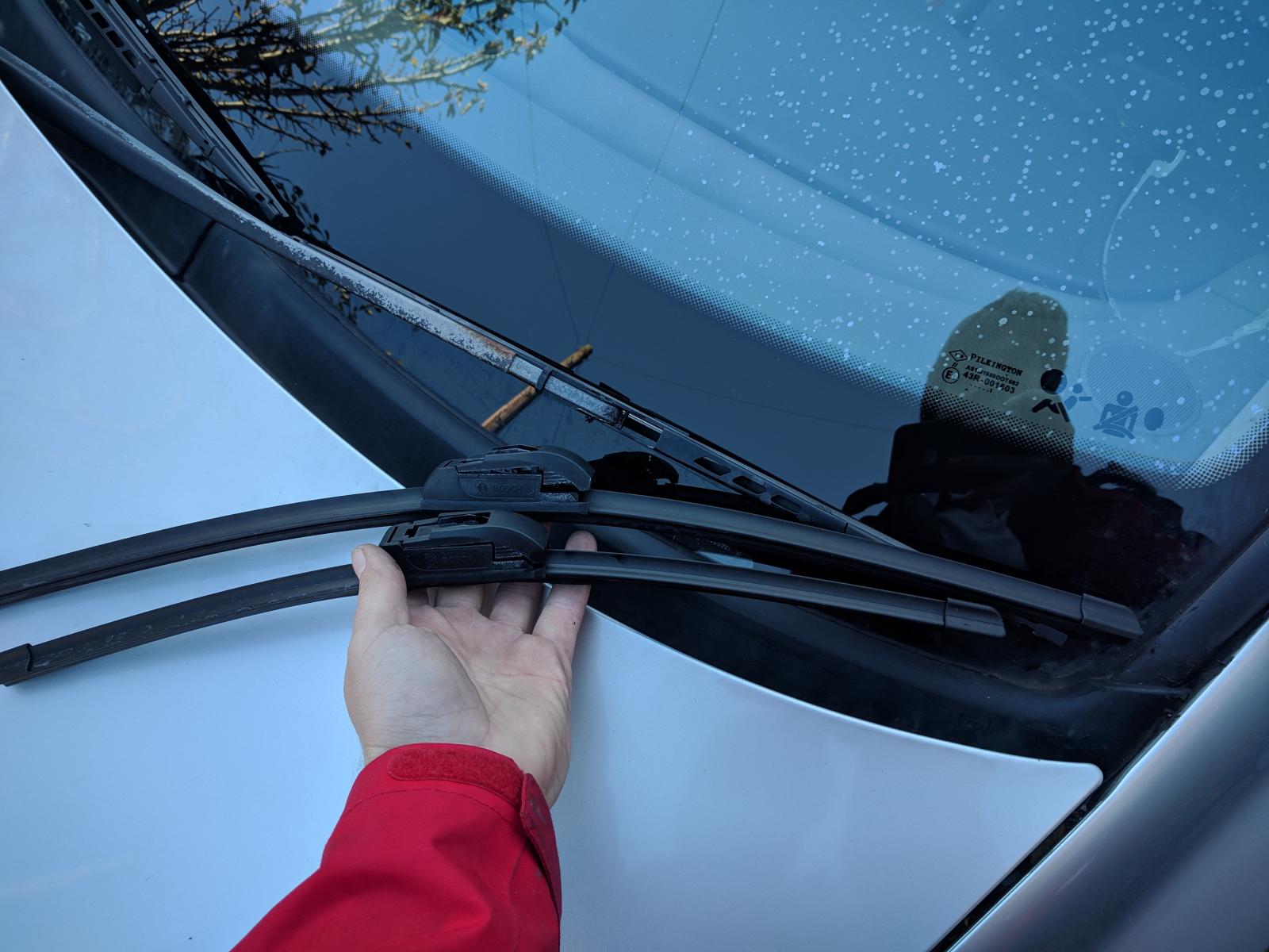

Then had the nearly new blades from YT55 off and fitted to FV51, although the blades fitted are not too bad, so will keep them as a spare pair. The shite on the screen doesnt help it much.

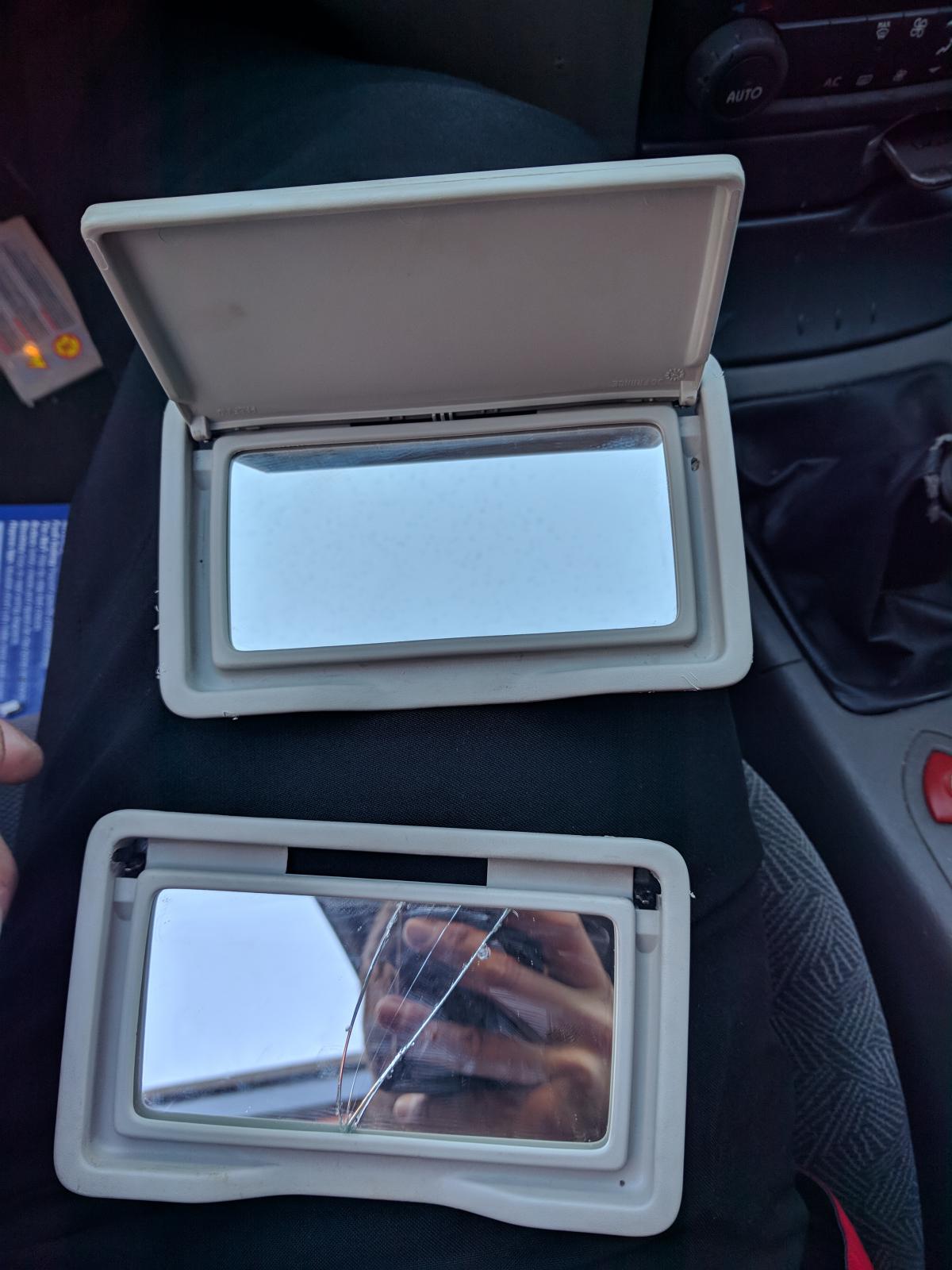

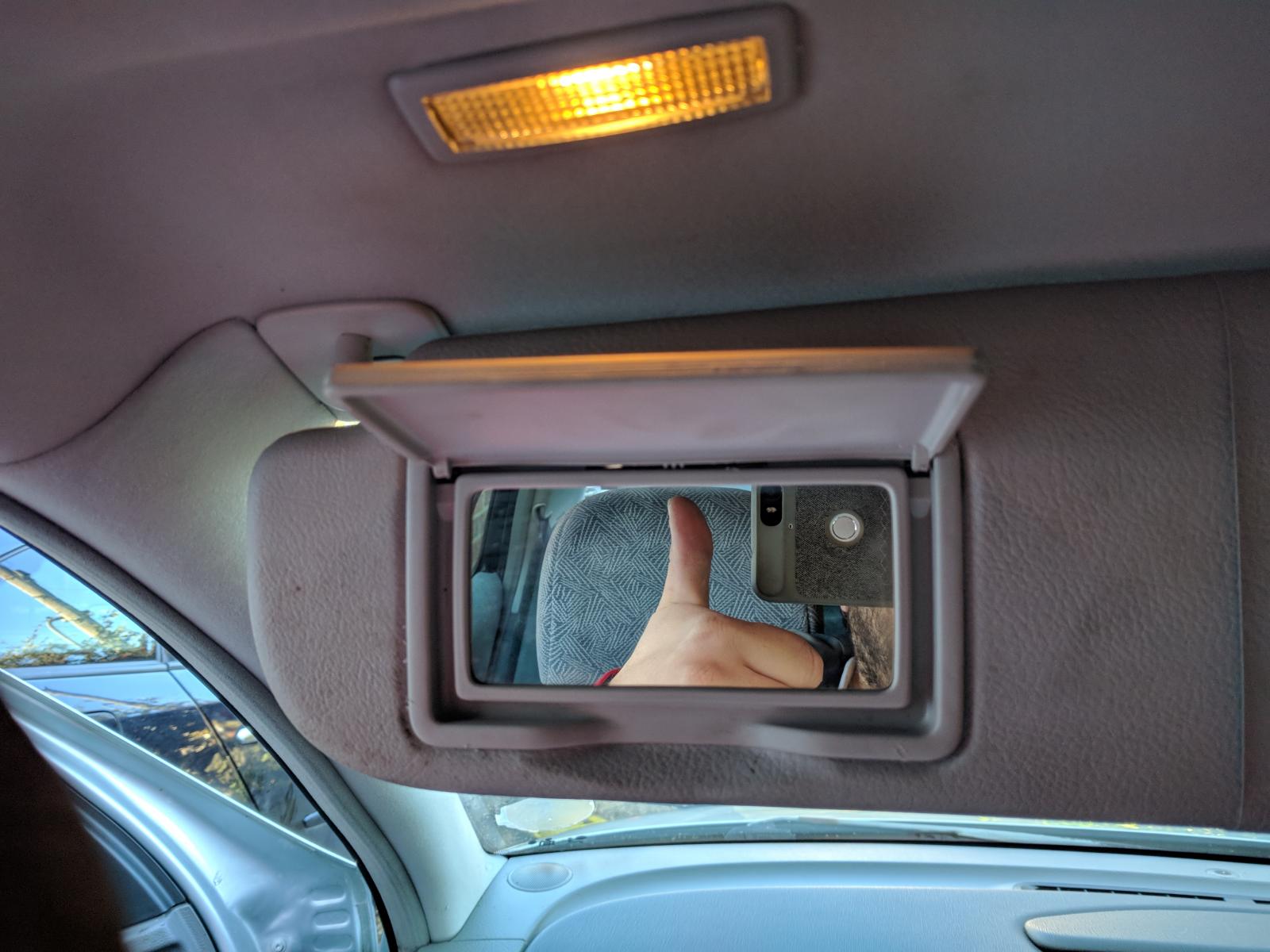

What's next? Well, the super important matter of... THE MISSING LENS AND GENERAL NOT WORKING-NESS OF THE PASSENGER VANITY MIRROR LIGHT... Mainly because if I didn't fix it now it would cost me a tenner for the part on ebay.
Naked and dead

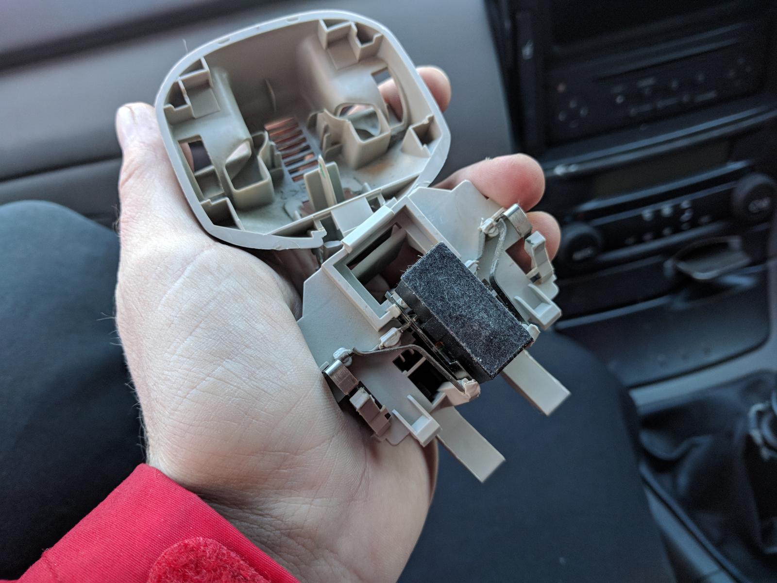

The contact for the switch that's pressed when you open the mirror cover just needed a slight re-profiling with my fingers to provide the perfect contact. Unfortunatly I snapped the mirror glass, but no fear!
Huzzah! Something I will NEVER use is fixed!
The drivers one works fine, however the flap on the glass sticks on that too, so will swap that round soon, will probably just swap the whole flipping visor, it's easier (as I found out near the end of the passenger side!

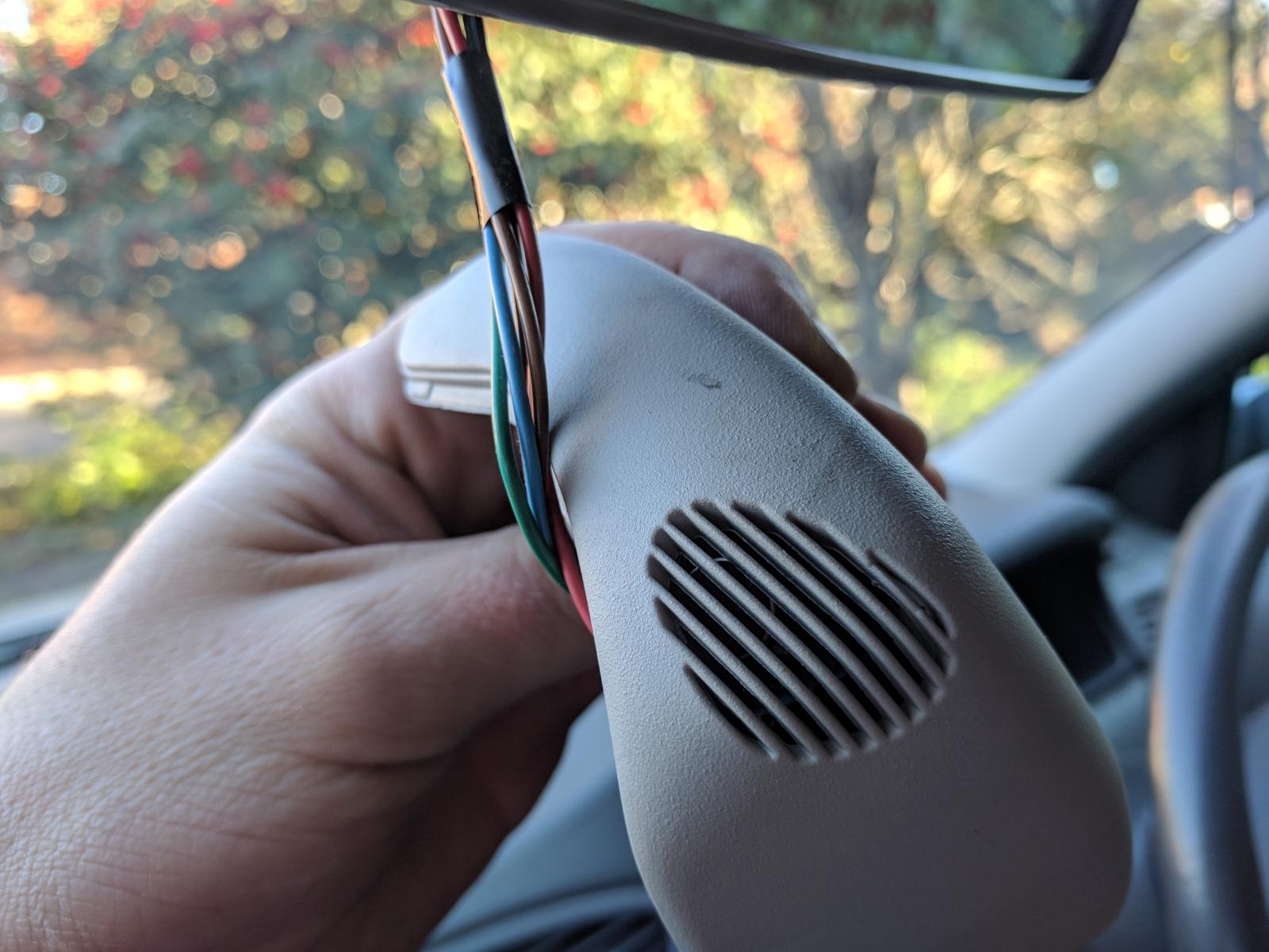

I then found myself with a few minutes before I needed to be back, so gave the phone mic some thought. I removed the bit of trim that holds the sun visors at the centre, as it had a grille looking thing
Alas it has a thing already inside. Asking on the facebook gooner group, I got about 19 different answers as to what it is, and I agree with one of them, it's the factory phone mic for the optional car kit.

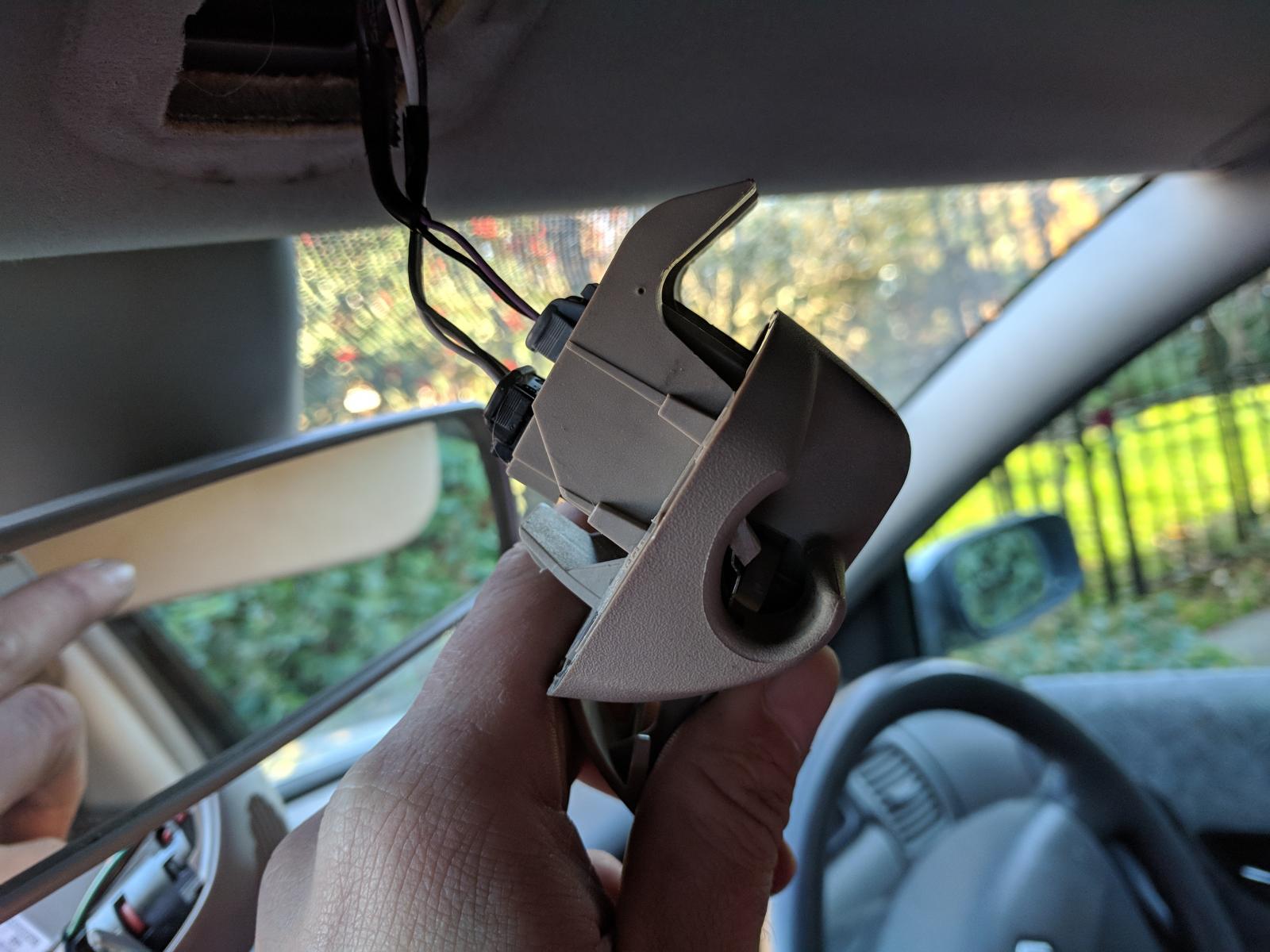

But because at the time I did not know this, I had the rear view mirror surround down
And after blowing all the shite out of the climate control sensor fan, worked out that if I dismantled the mic end so just the internals were left, it sits nicely against the grille on the other side
However, the rear view mirror surround won't clip back on, then I ran out of time so had to leave it. If the first part is indeed a microphone, I'll sack off the rear view mirror idea and pop the microphone where it should go, and sack off the factory original.

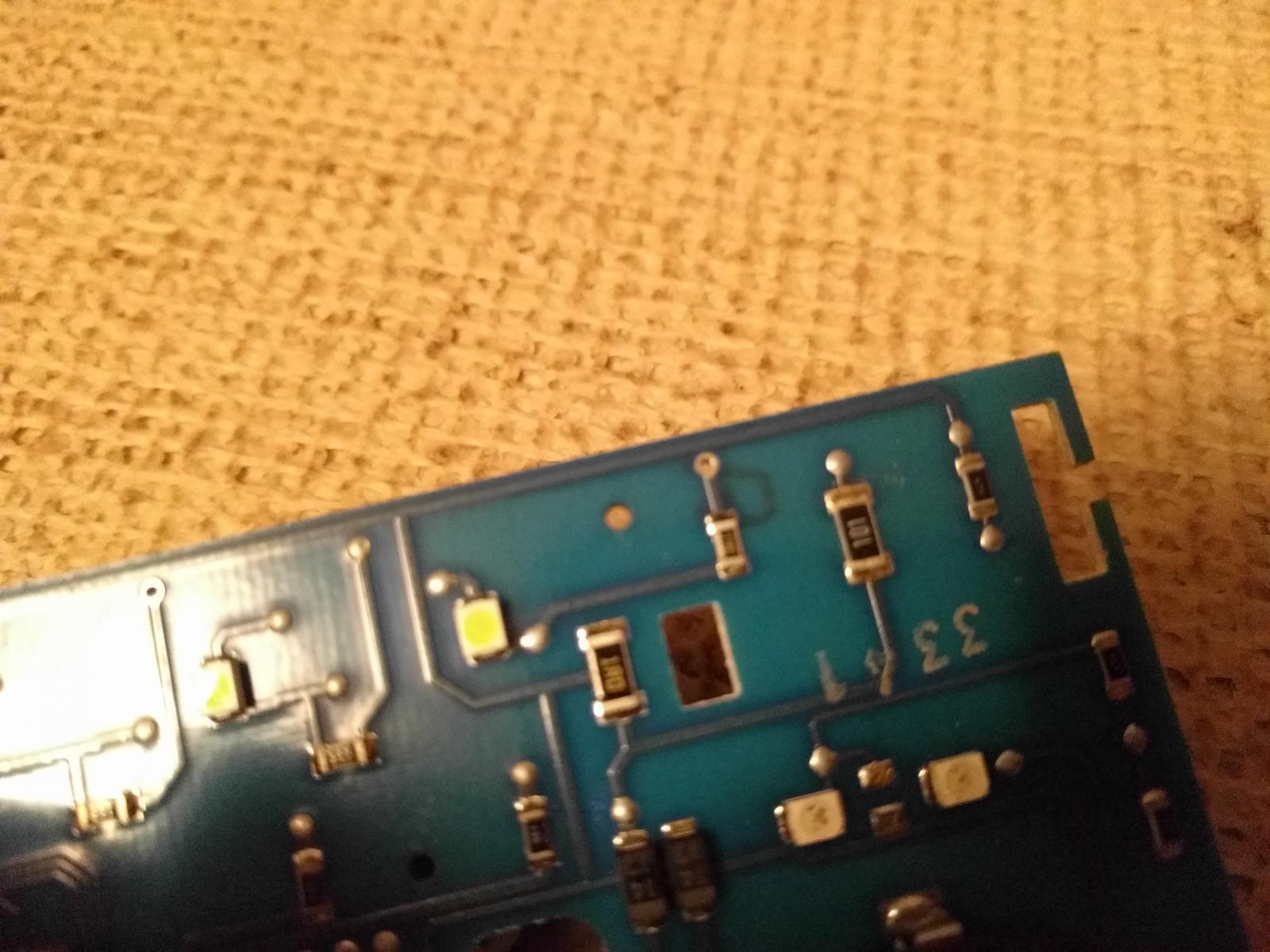

RE the non lit heaters, I'm going to try this tonight, need to get the soldering iron out for a Miele Hoover I must fix, will give it a go! Looks like it might be a dry solder joint
http://www.renaultforums.co.uk/105-laguna/519-renault-laguna-ii-interiors-climate-illumination-auto-climate-version-4.html
Maybe, I'll wait until I've looked at all other options first.
The heaters lit up after I hit a pothole on the m40! Then went off again, came back on with a tap for a while then went off again, so dry solder joint it is! Will look at that some time

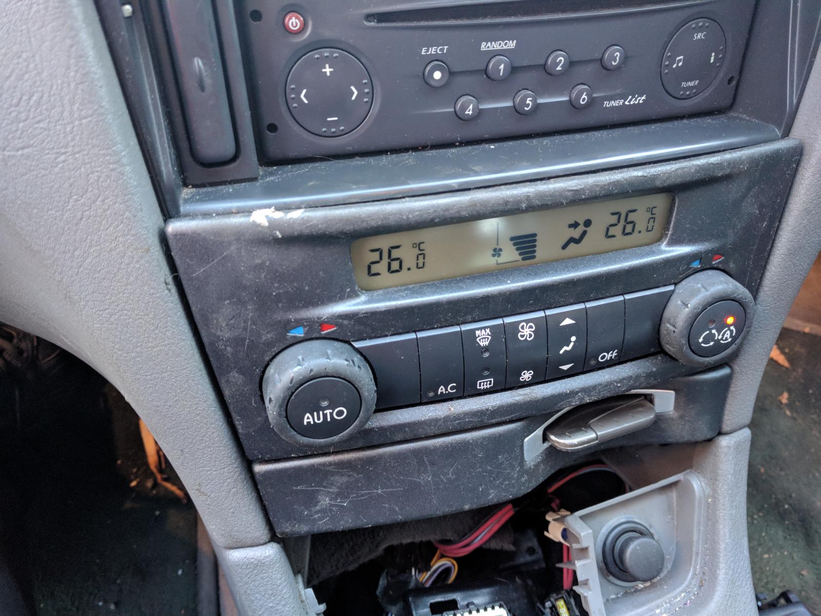

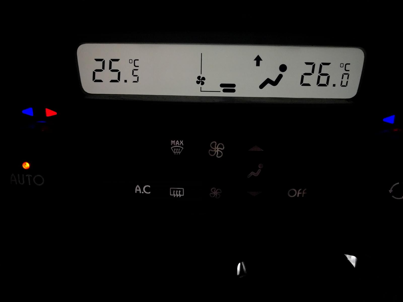

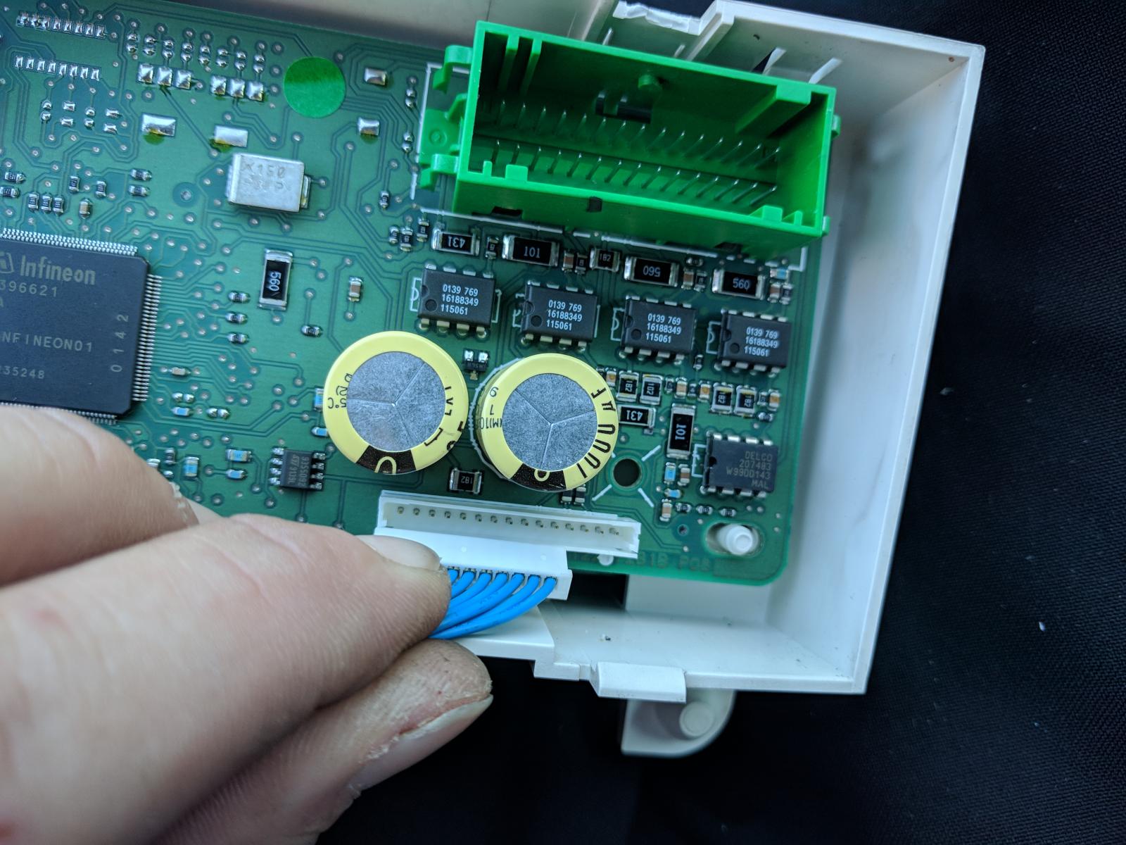

So grabbed the heater controls, and gave chip 101 a stroke with a soldering iron...
Stroked it too hard though as it fell off the board, oops
However using some precision* tools I got it back on

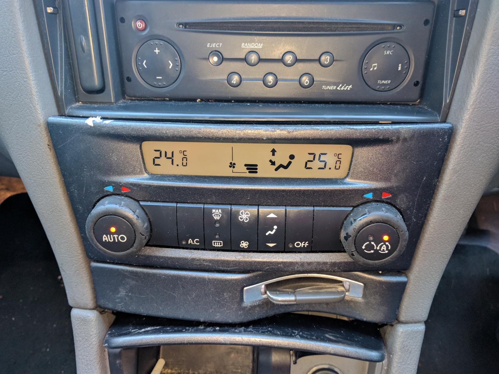

Gave the glass led display a good clean with a baby wipe and a microfiber to buff, and....
Huzzah! I no longer have to blindly push buttons until I feel heat or the windscreen demists! If it goes again I'll just bridge the connections...
*chuckles at the number of jobs done has gone down in thread title*
Thanks! Think I'll change it daily to reflect the jobs done vs jobs tried, just whilst I Potter about sorting the silly fiddly stuff whilst I have a whole spare car to raid. My stepmum said I have a brake light out on one side, will enlist my mother to help and go bulb replacing tomorrow, and re-stock my depleted bulb kits with everything bar main beam bulbs as I can't get those from yt55!
If you bridge it, you'll pop all the LEDs. Its there to limit the amount of current flowing into the LEDs. Nothing to stop you soldering a thru hole 100 Ohm resistor (its value) on though instead if you did loose it. You also could have got away with just soldering each side with a fresh blob of solder on rather than trying to wipe and heat the whole part.
I didn't mean to take it off, just gently warm the edges... Then oops
Yeah, that's no chip, that's just a boggo resistor. As such it's unlikely to stop working, but it sounds like it had a dry joint. I'd be surprised if it suffers again so quickly.
I've just spent ages trying to work out the difference between the two AC control panels from the front - the point that you noticed they weren't the same. I'm stumped! What was the giveaway?
Good job. Expert electronics repairs (autoshite) ltd
I know there's chaps who work on tiny circuitry for a living on here, am bracing myself for the outcry and piss taking!
There was a few...
The front fascia is different. On the ph2 it goes down far and incorporates the keycard holder. On the ph1 it doesn't, the keycard holder is seperate.
Then the green plugs are a different size
Then one plug on the 2 circuit boards are different, and I didn't feel confident just seeing if it would work and all the pins were needed, as I like being warm so put it back together and moved on
I've inhaled SMD resistors before. When they get to 0201 size, they get a bit awkward to work with. A deep breath and they're gone!

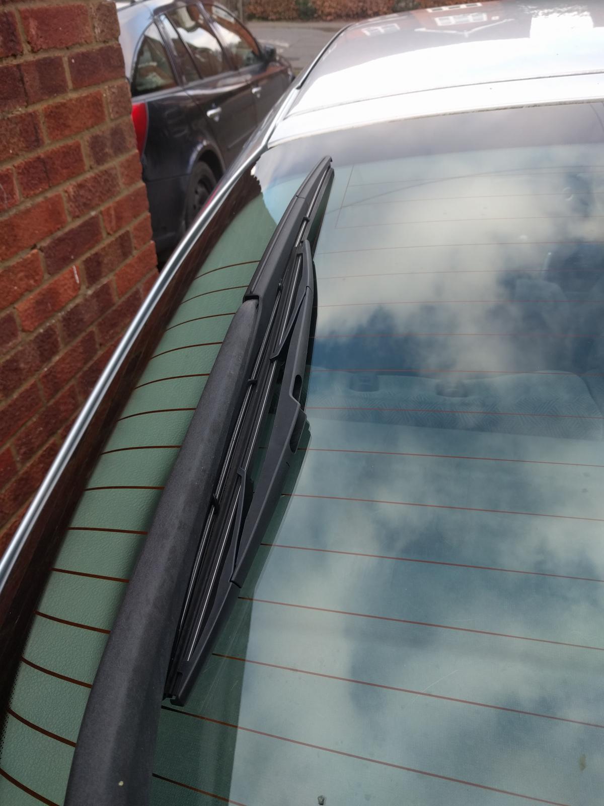

Rear wiper came off YT55 as a mate at work needs a new rear one for his astra, and it's similar enough, and won't fit FV51
Luckily the rear blade on FV51 is perfect, so no worries there. Then it was time to wake up YT55

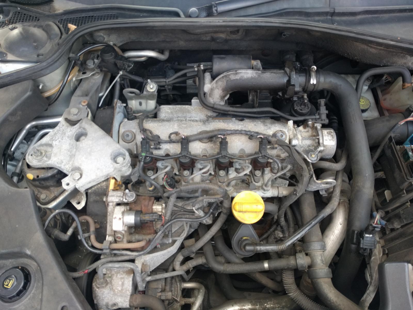

Took an engine bay shot whilst I waited, the 1.9 looks easier to work on, might have to investigate that damp patch at the top though
It's 300% less oily than YT55 is under all the covers

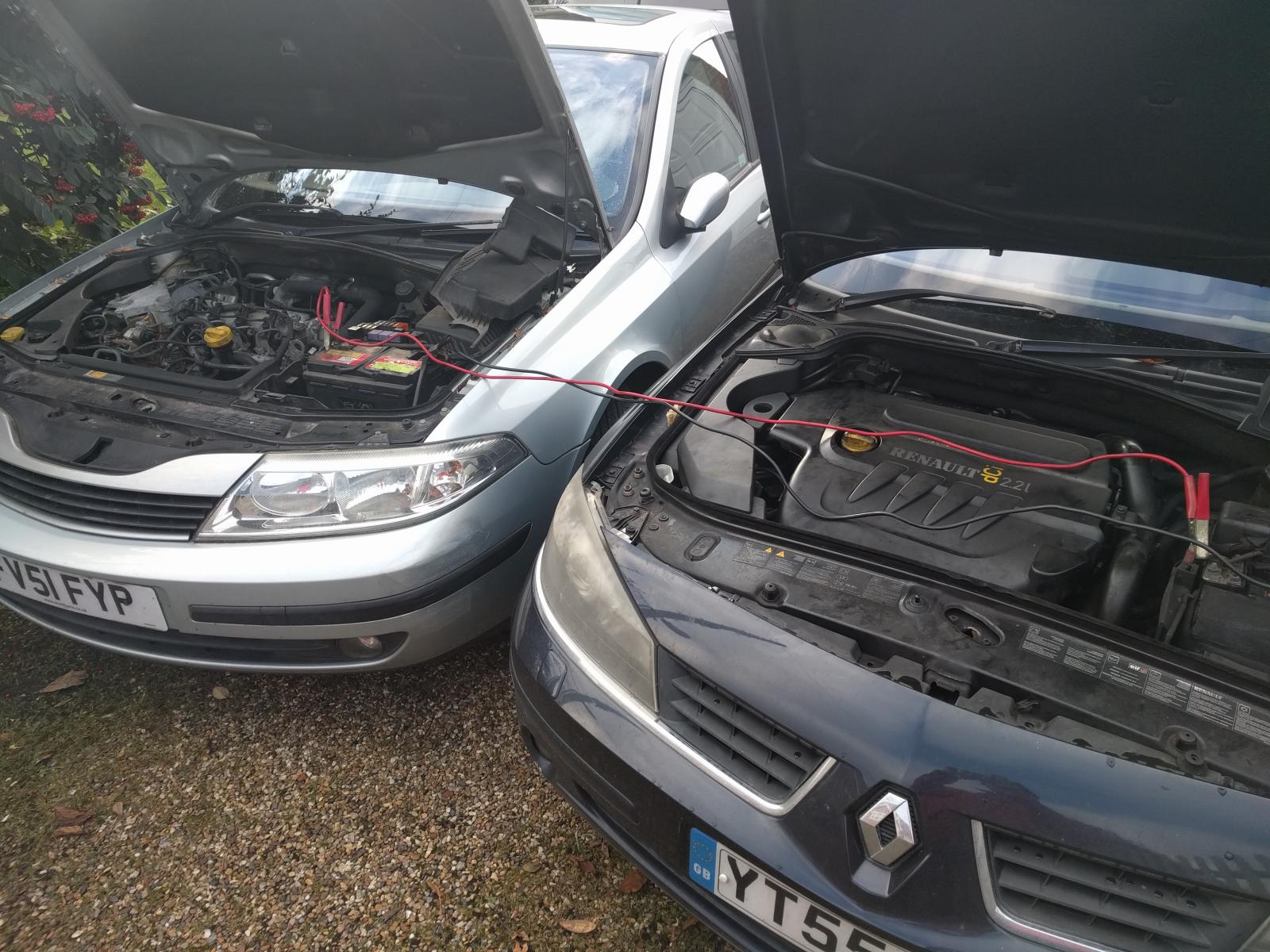

YT55 wouldn't start still, so I extracted my USB extension lead

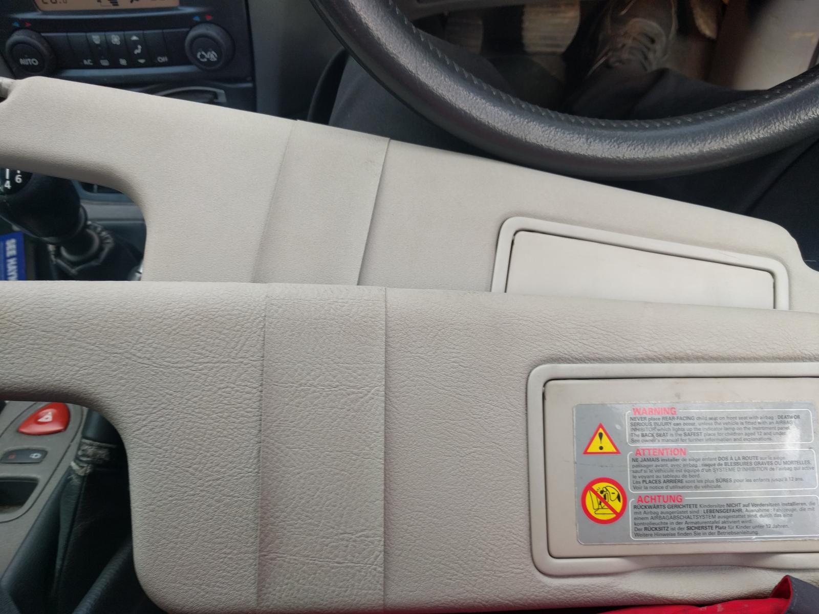

And grabbed the drivers sun visor to replace the stiff one in FV51
YT55 grumbled into life now, so I unhooked it, moved FV51 back and YT55 forward, then extracted my DAB aerial that runs all alone the passenger side, and removed the rear trim 24V6Turbo wanted, and cut my first seatbelt up, which was fun! (had to remove the belt to remove the trim and sod unbolting it...)

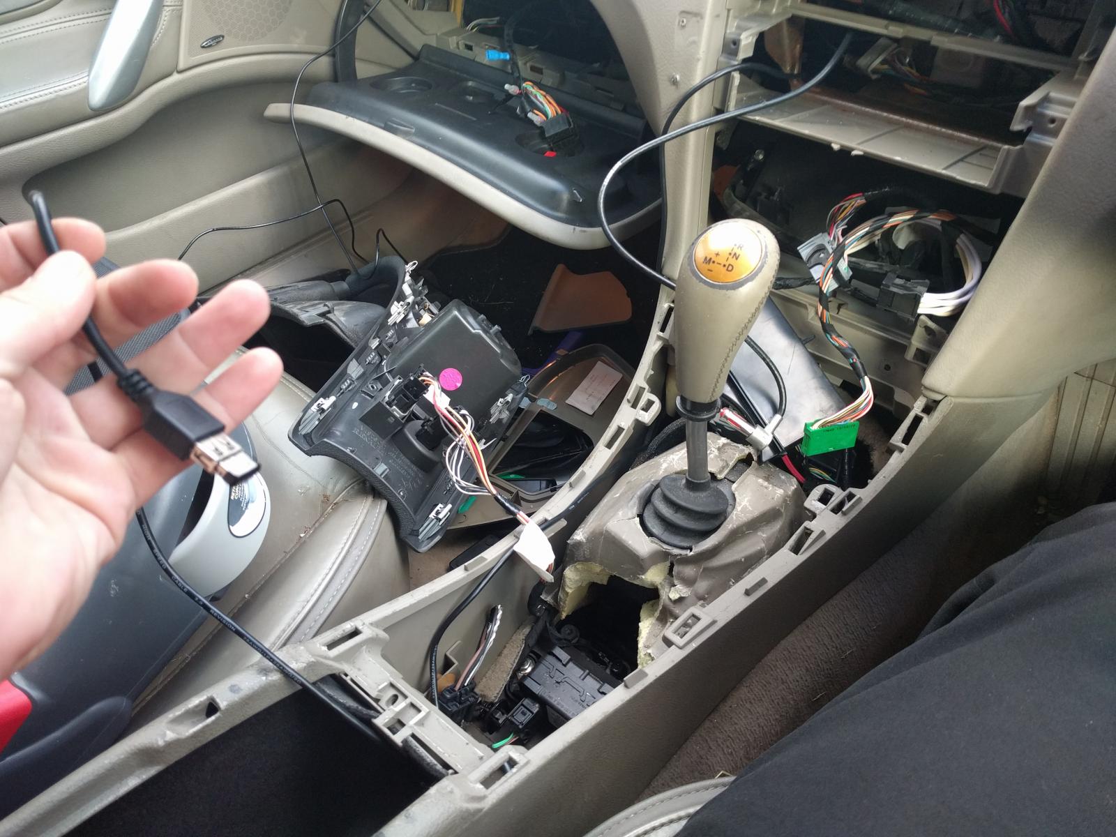

That done, I proceeded to remove the glovebox in FV51 to start running the DAB aerial back in, and found some treasure!

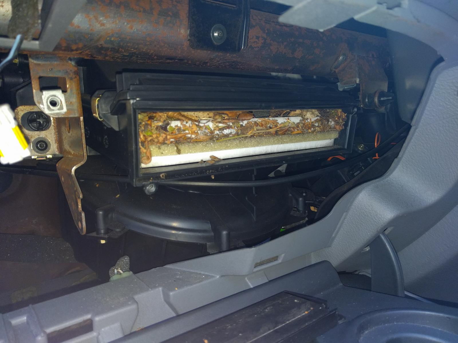

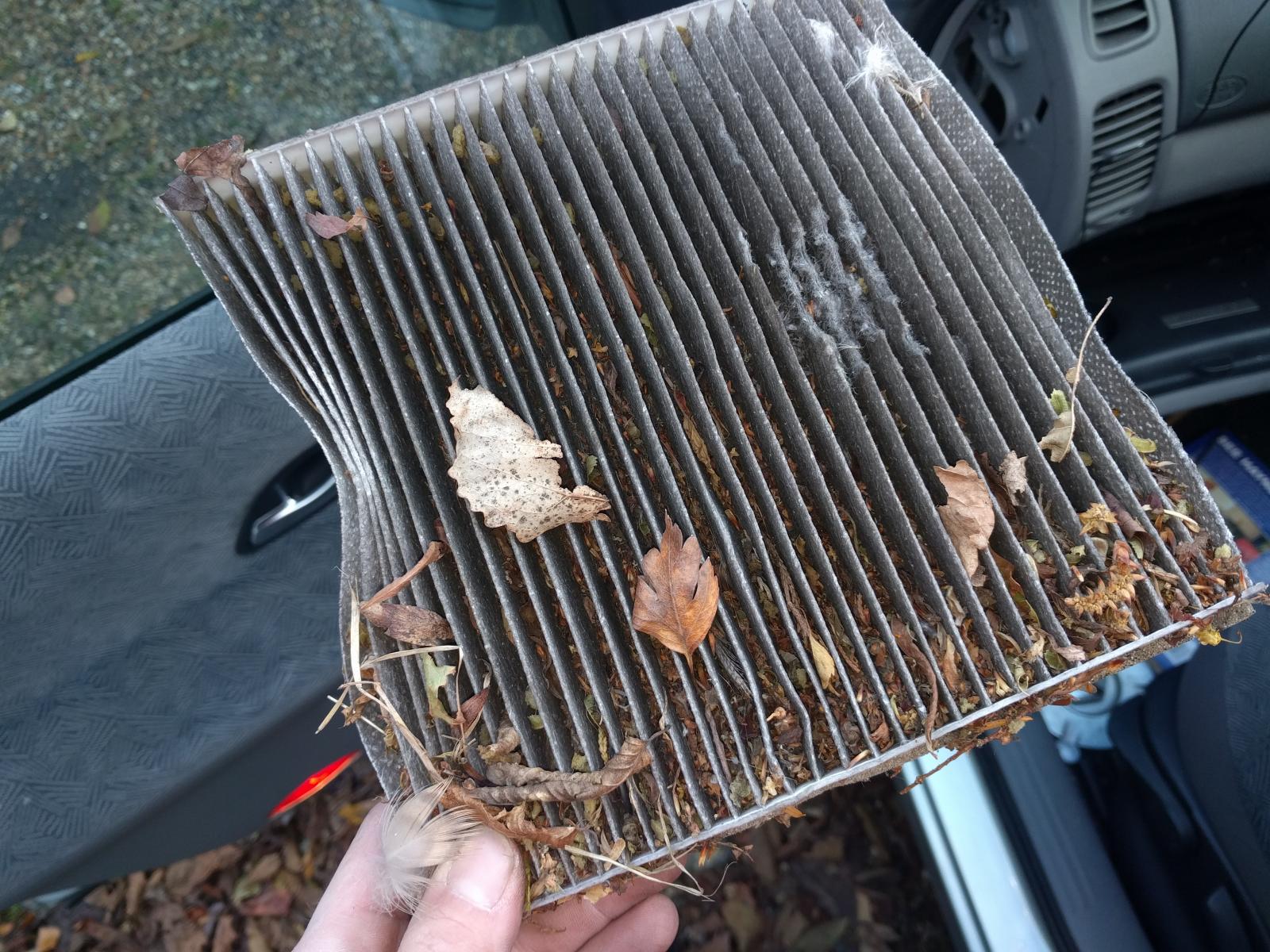

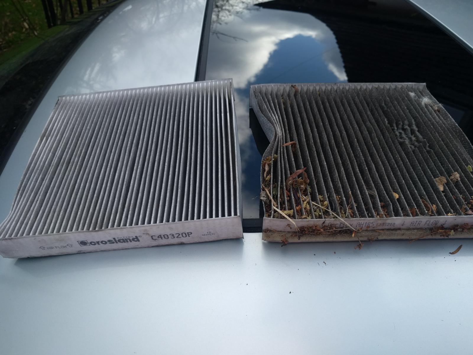

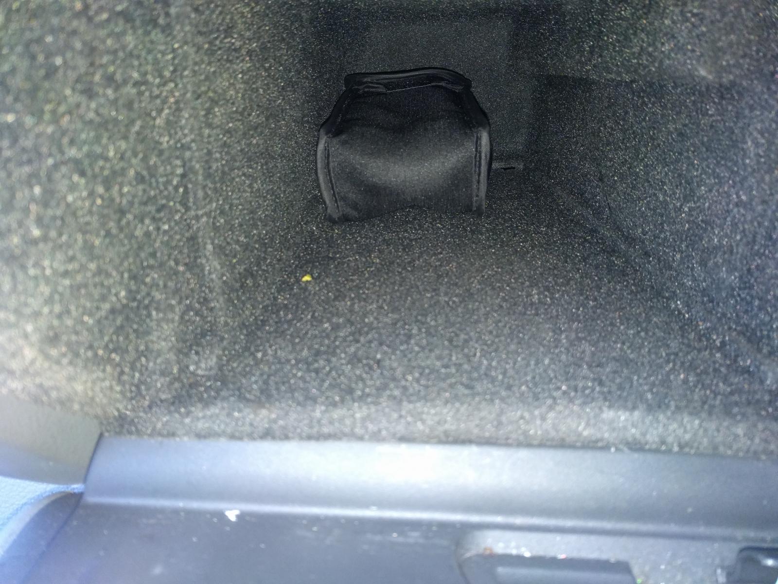

Thought I would have a quick shufty of the cabin filter whilst it was there, and I'm glad I did!
Blimey
YT55 revealed a much better one, so I fitted that!

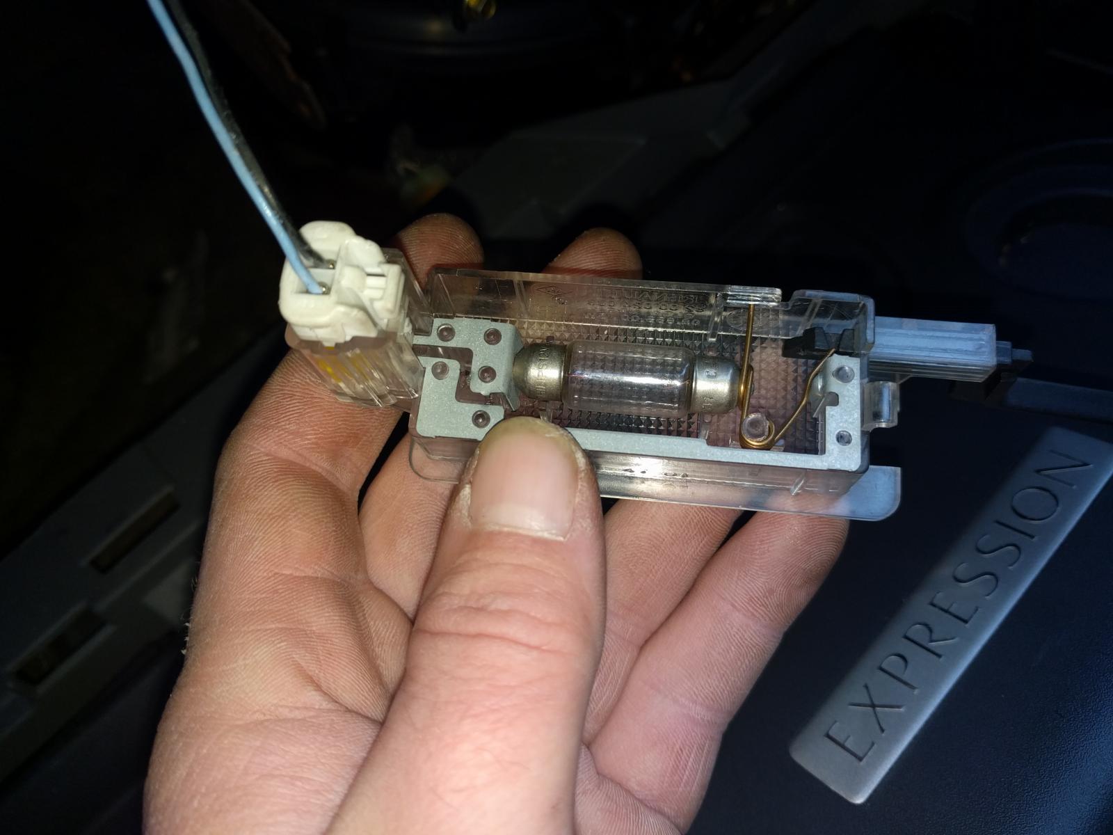

I also noted that the glovebox light did not work, so a quick re-profile of the contact spring and it was good to go, I also replaced the bulb in the rear roof light

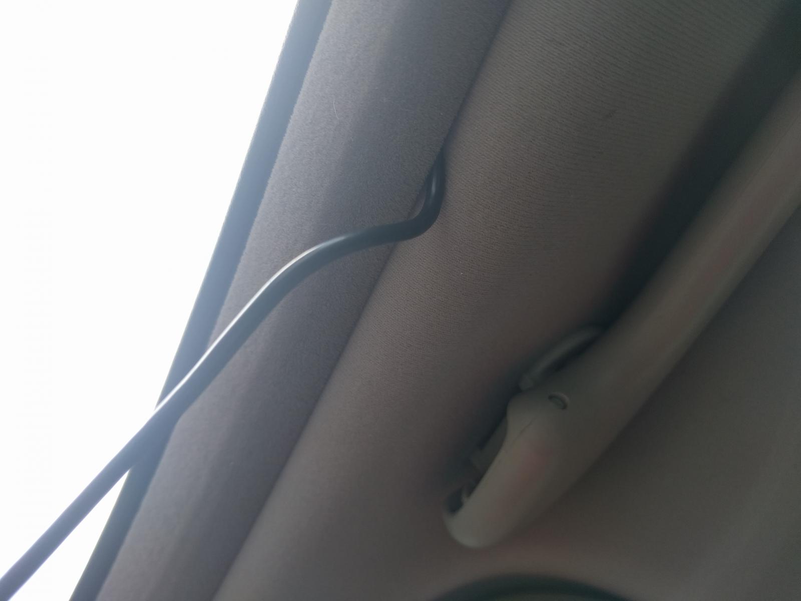

The DAB aerial is just tucked in the edge of the door seals, and just behind the pillar covers, nice and simple!

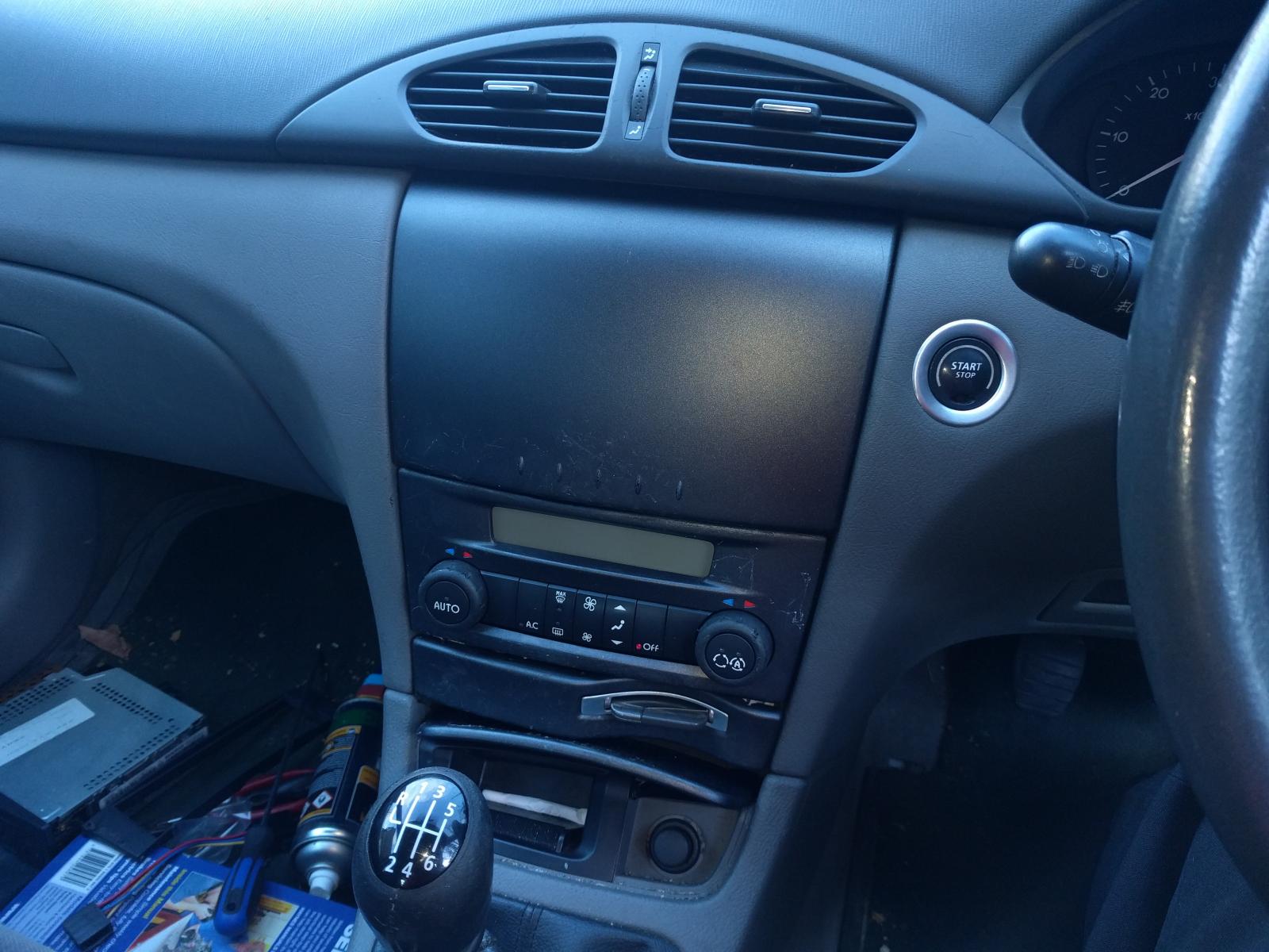

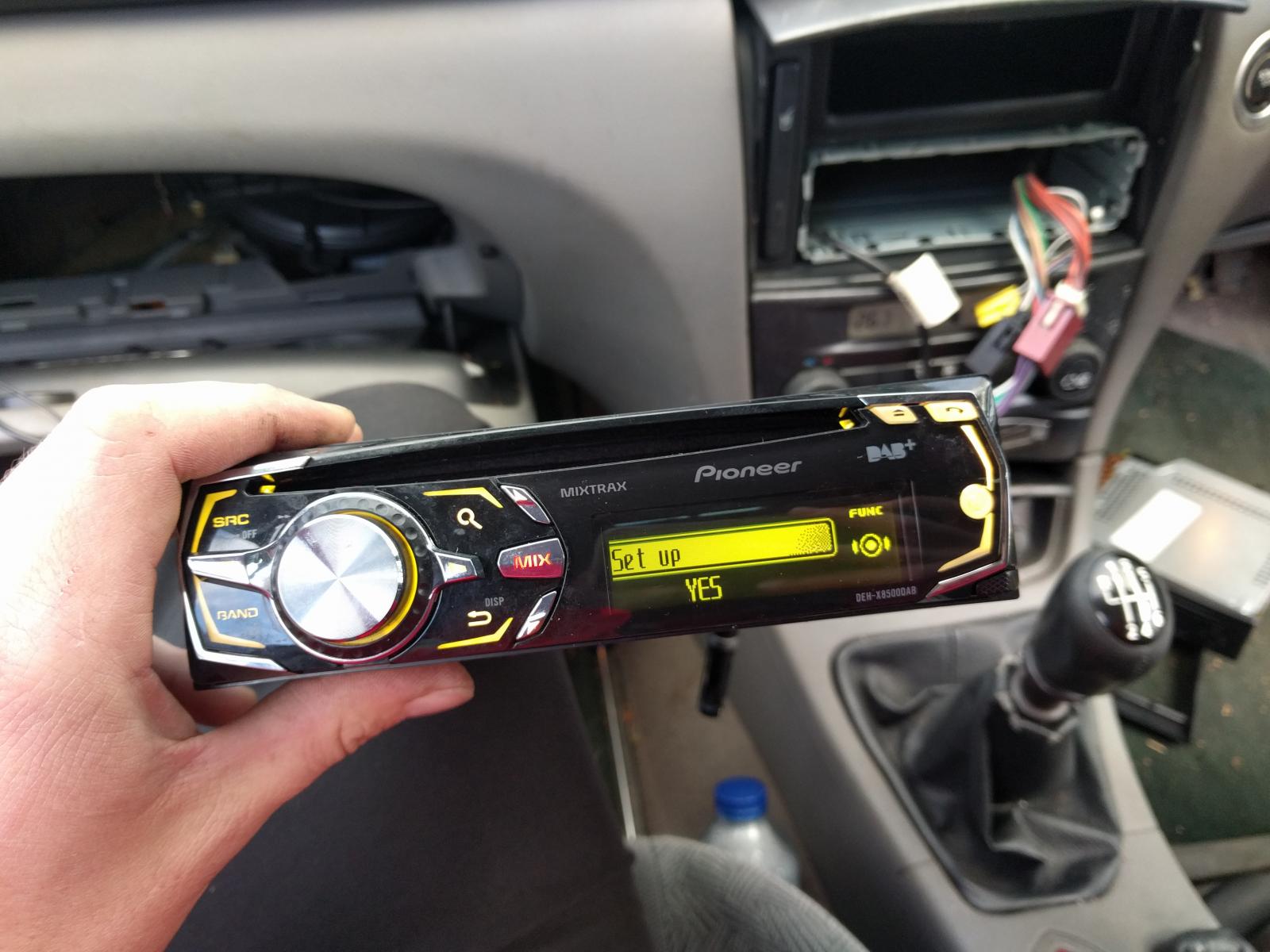

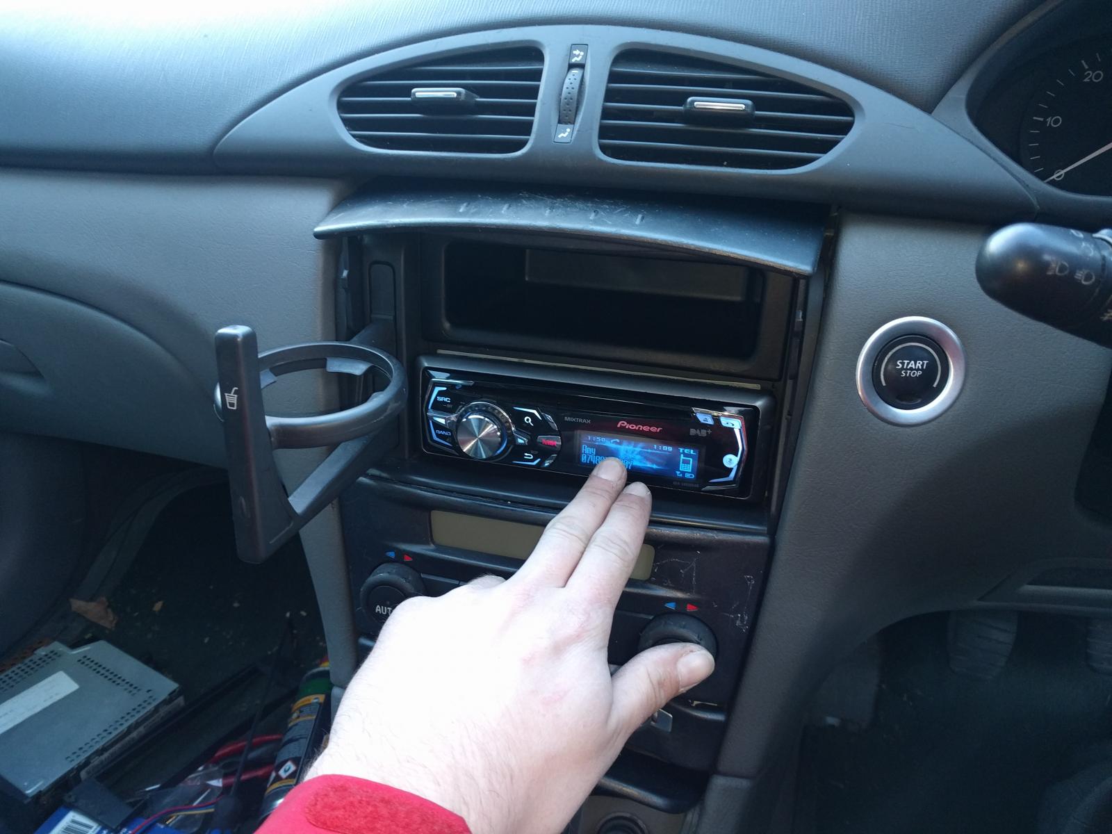

I then removed the CD from the player, and got 2 small screwdrivers to pop the clips and removed the Renault original
Plugged my Pioneer in to double check before I went too far and YES, it works, but NO, I do not want to set it up now
Because I needed to unplug it all again to fit the holding cage. Fitted it nicely, ran the USB lead into the glovebox this time rather than under the centre arm rest, and upon a quick test drive noticed a horrible sound from my speaker...

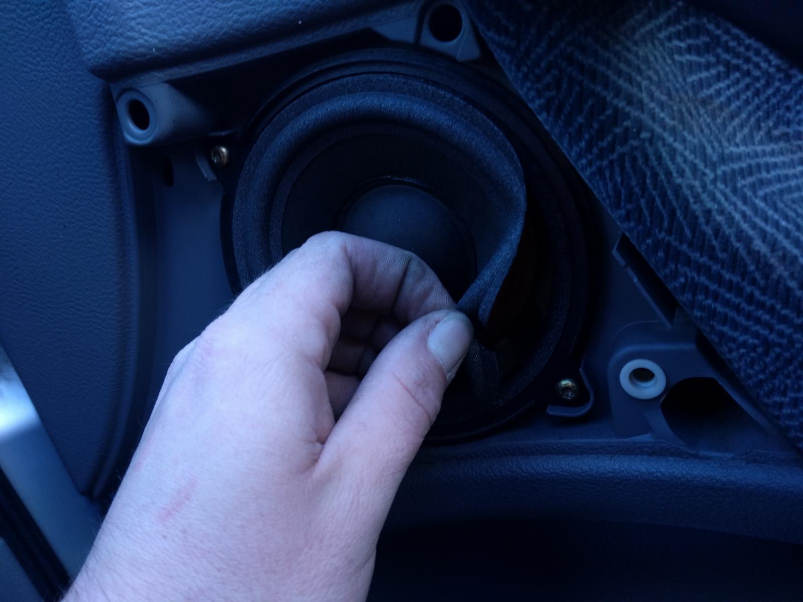

So replaced that! Another one isn't too happy either, so I might just replace all the speakers for now, I did have thoughts with YT55 of buying some cheap, better speakers anyway so I'll keep that thought for a while
Either way, it all works, I test called Amy to double check
And set the display and buttons to a nice pale blue, as it seems less glarey than the ice white it was before. But even if it is, I can simply hide it!
Job done for today, and I can keep the cupholder which is excellent, as I like it!
