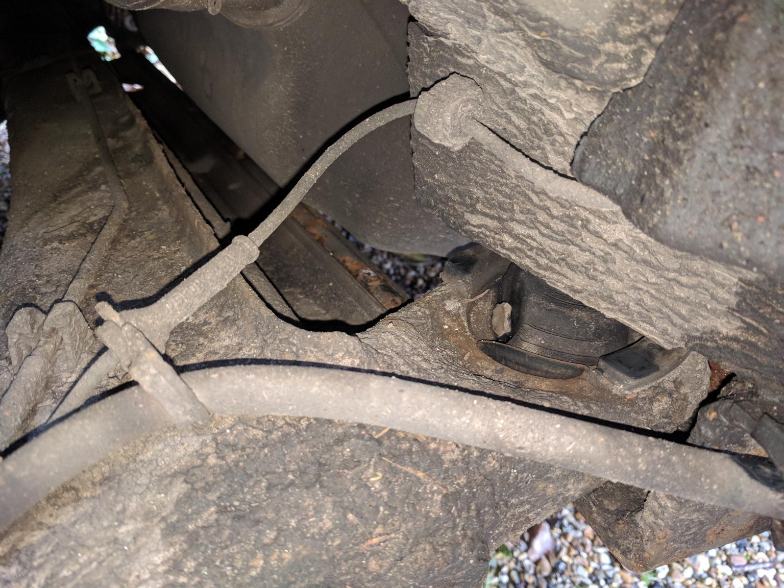

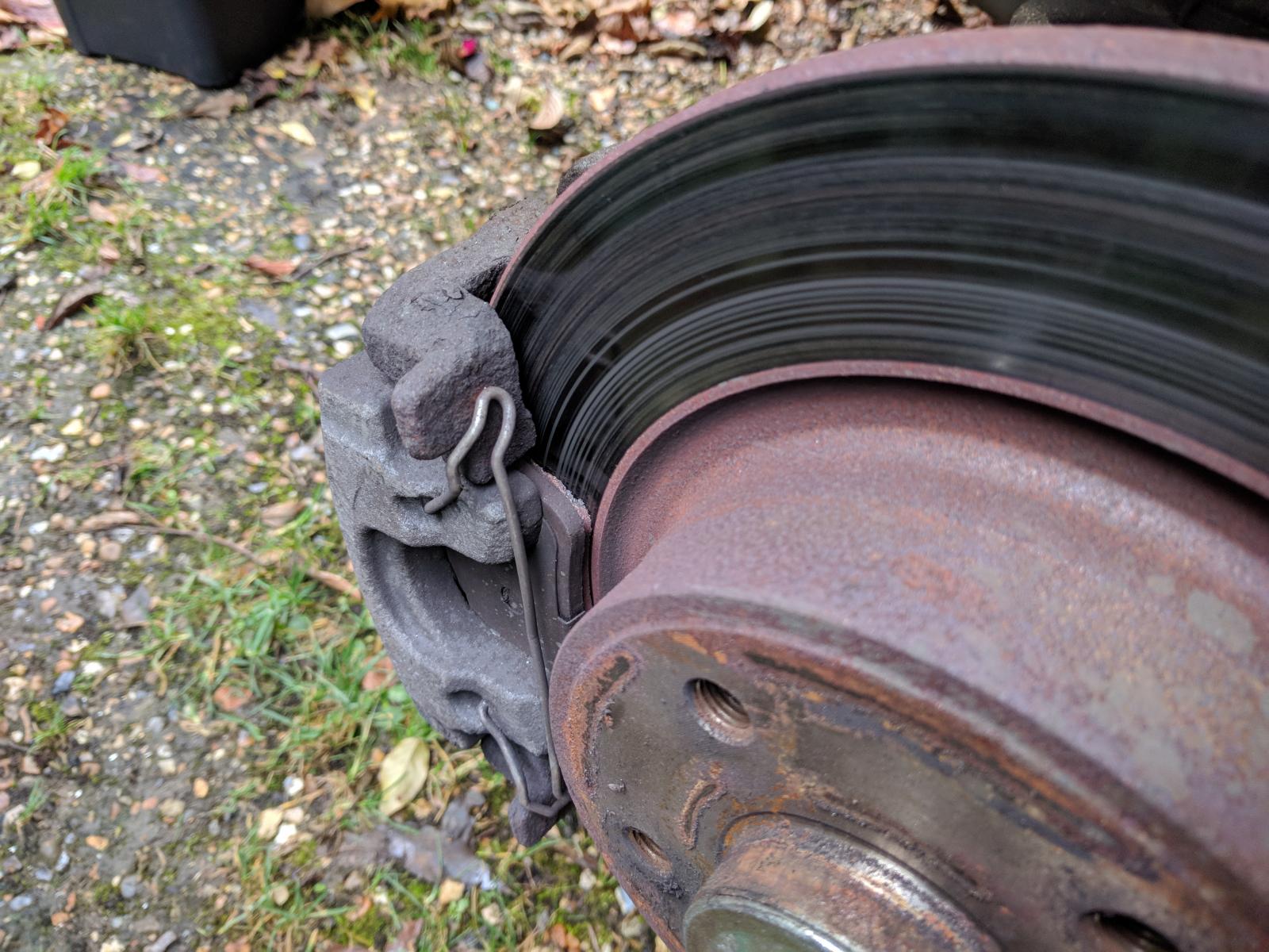

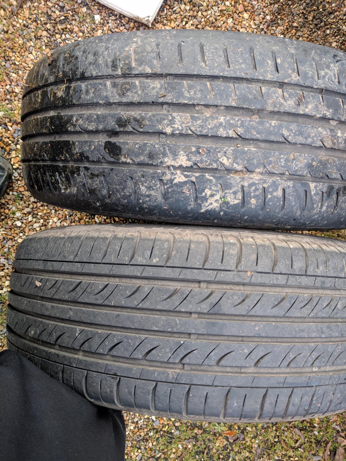

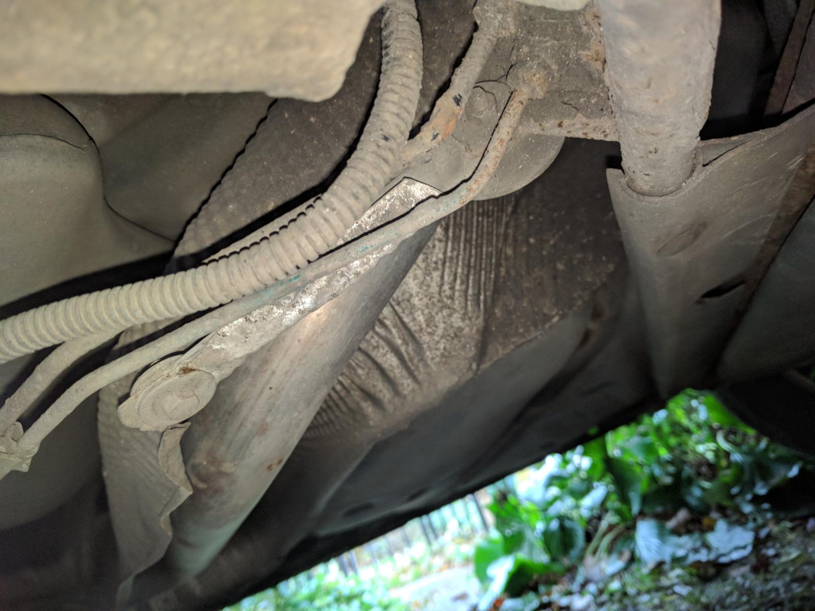

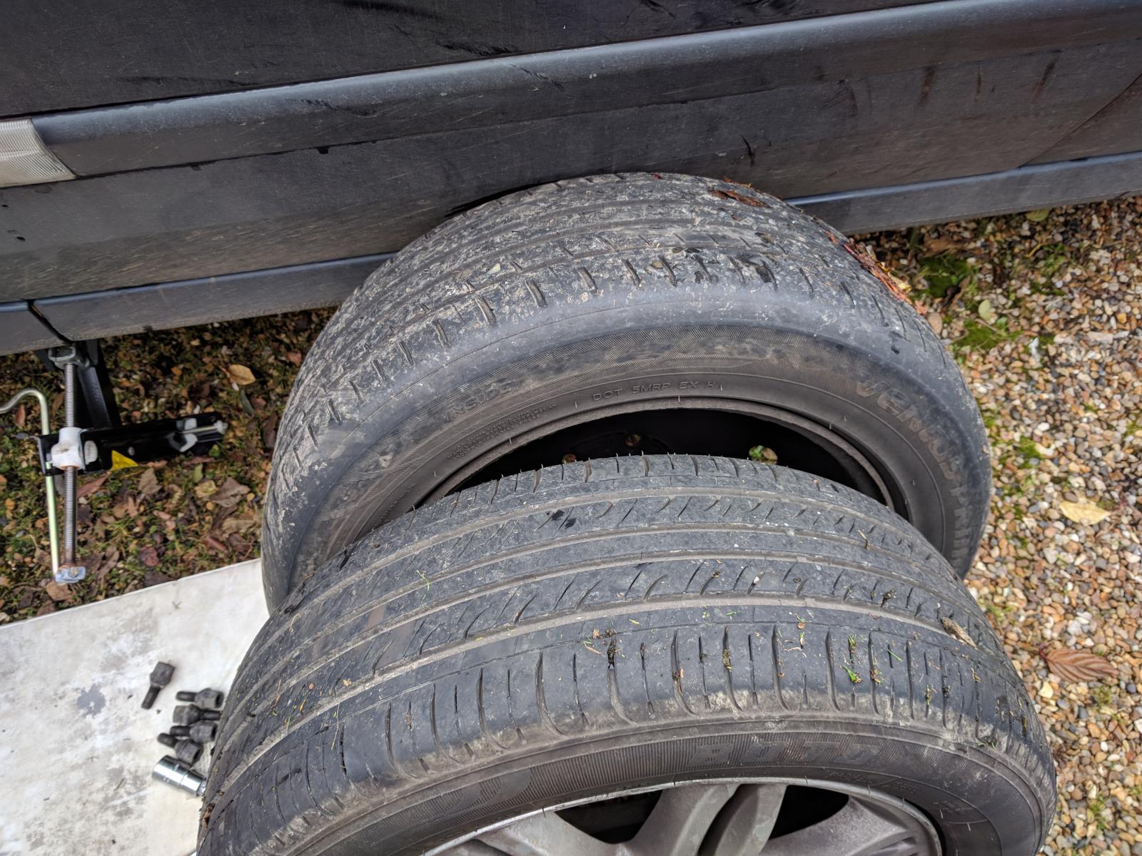

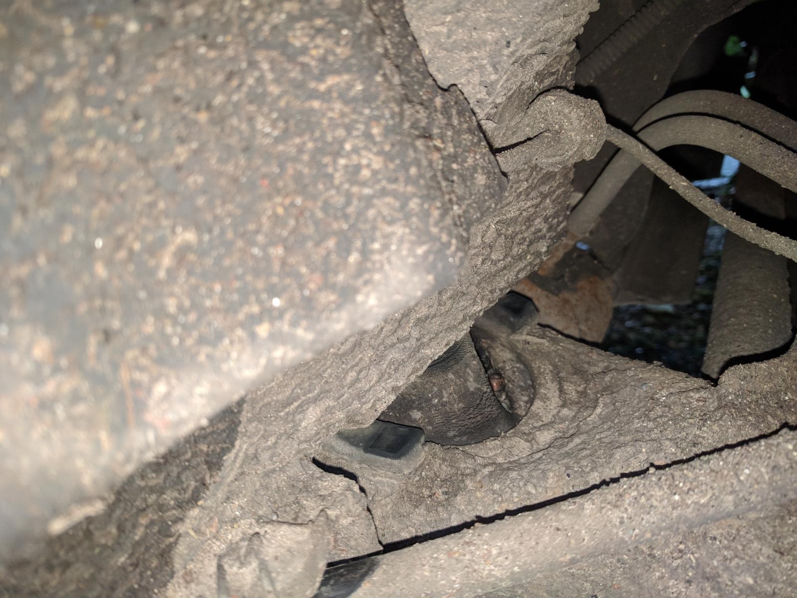

beko1987 Posted November 27, 2017 Author Posted November 27, 2017 So 3 jobs this lunchtime! First was swap the wheels over. This will confuse the hardcore renault lickers, ph2 initiale alloys on a ph1 expressionRear pads are very low, so a job for the listIt had new genuine rear bushes 4 years ago and this one looks fineI then shuffled them about, after having to jump start the old oneThis is the only crust on a brake pipe I could see from a glance in my work clothes, will have a proper look soon. Someone on the renault facebook group is jumping up and down about it being an MOT fail, I hope he's not correct...The other Bush seems fineThen the jack from the new one snapped it's handle, so I got the car off it with my proper jack, and robbed the jack from the old carDone, ok tyres once more!Then I moved onto the jerky driver's window and inoperable wing mirrors, and upon removing the mirror switch it wasn't plugged in, the plus was nearly falling into the door, so I fished it outHowever the French balance was restored by the other window switch pack not fixing the jerky window, and now the rears don't work either (we had one down yesterday, still not touched the front passenger one yet as that's broken). Still, at least I can have a fag with the window dropped an inch!Hoping to get the stereo stripped out of the blue one tomorrow and maybe even fitted, depends how long it takes, and swap the heater controls as the one in the new one doesn't light up.I then went up the road to check all was ok and it seems to be, so will see what the drive home is like. The brakes need bleeding too, their a bit soft, will get the rear pads changed first though. Lacquer Peel, Dirk Diggler, Shep Shepherd and 4 others 7

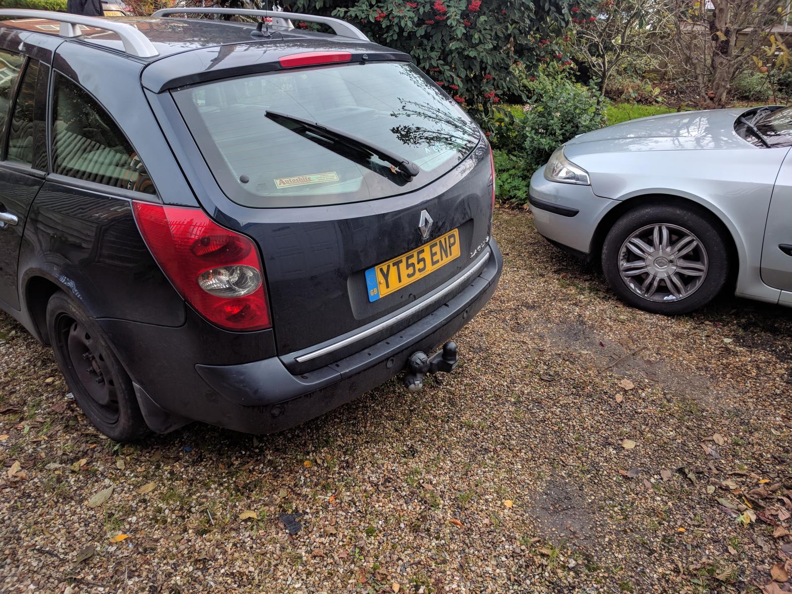

beko1987 Posted November 27, 2017 Author Posted November 27, 2017 Already sold the towbar pending it's removal.Only got one fitted mudflap anyway on the old one, but the one that isnt fitted is in the boot, may have a look at it.The door handles on the old one are well scratched up, so won't bother swapping those

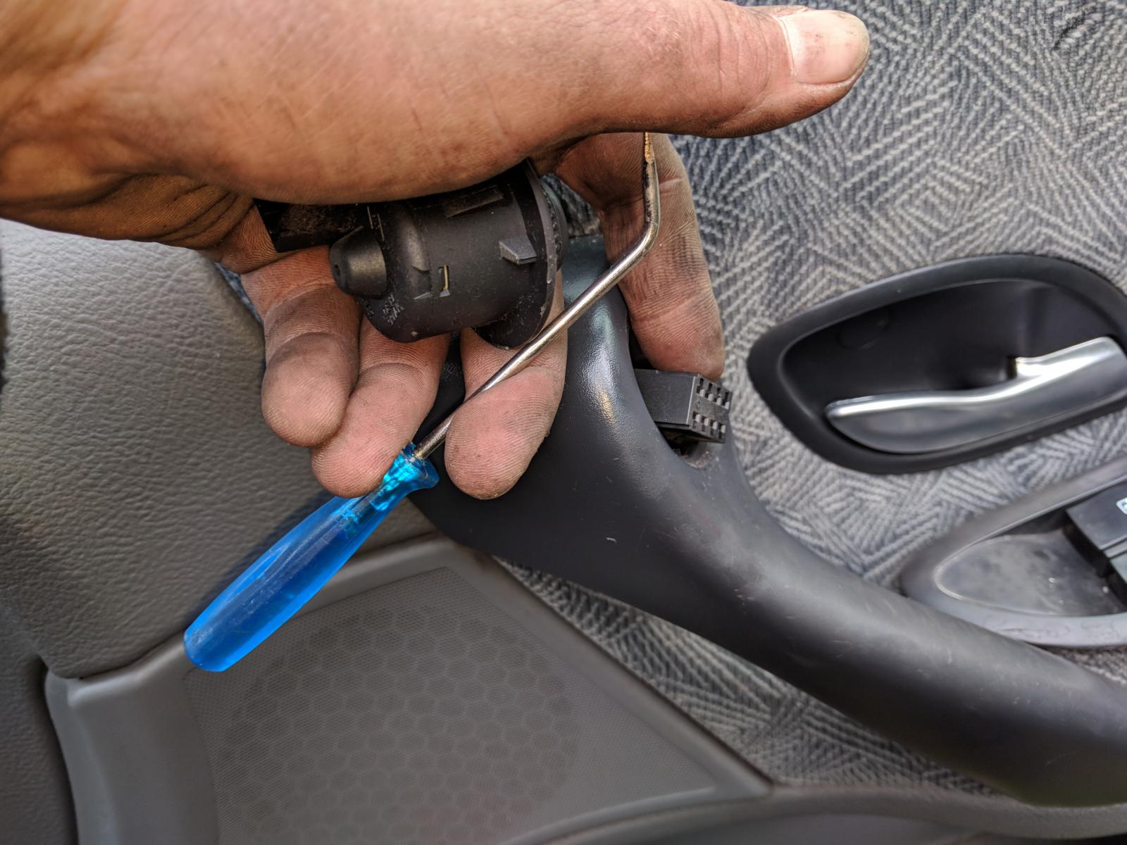

Guest Hooli Posted November 27, 2017 Posted November 27, 2017 Jerky window? as in it only goes down an inch or so, stops then moves another inch? TADTS! it's the one touch window needing resetting. Wind it right down & keep holding the button down for about 3 secs. It'll work then & your one touch window will function.
beko1987 Posted November 27, 2017 Author Posted November 27, 2017 Jerky window? as in it only goes down an inch or so, stops then moves another inch? TADTS! it's the one touch window needing resetting. Wind it right down & keep holding the button down for about 3 secs. It'll work then & your one touch window will function.Yep, that's the one, but resetting it does nothing, I've tried (very used to doing it when the battery dies on the blue one)
Guest Hooli Posted November 27, 2017 Posted November 27, 2017 Fucked then Dunno mate, I thought they'd detect the end of travel on the motor or something. No idea if it doesn't work. Oh I'd keep the spare window switches if you can, they are a very common failure as you can tell by the hundreds on them on ebay at £15-20. beko1987 1

beko1987 Posted November 27, 2017 Author Posted November 27, 2017 Fucked then Dunno mate, I thought they'd detect the end of travel on the motor or something. No idea if it doesn't work. Oh I'd keep the spare window switches if you can, they are a very common failure as you can tell by the hundreds on them on ebay at £15-20.I need to swap the front passenger window regulator apparently (it makes grindy noises, not touched it yet) and if at the end of it I don't want to kill myself I'll have the drivers one swapped too! Not sure why the rear ones don't work, but franky I don't care, the glass isn't sellotaped up to the door so it's better than the other one! (someone already wants the two mechanisms so can't swap those) Will keep the window switches, good idea! 3 of the buttons light up in the new car, so that's nice!
Guest Hooli Posted November 27, 2017 Posted November 27, 2017 Window mechs are a doddle, the trick is to get the window at the right height when you start. Otherwise you can't get the clips off, which are around the back of the glass as you reach in & slide along the glass to unclip. That isn't explained well in the HBOL so took me 5mins of swearing to work out. beko1987 1

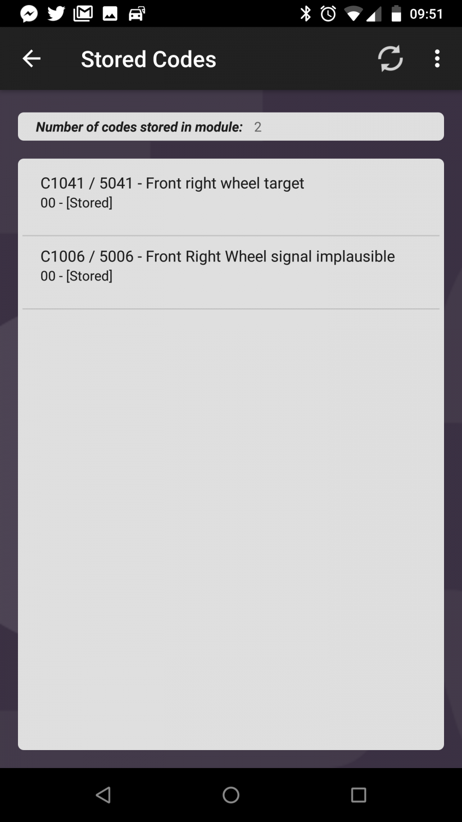

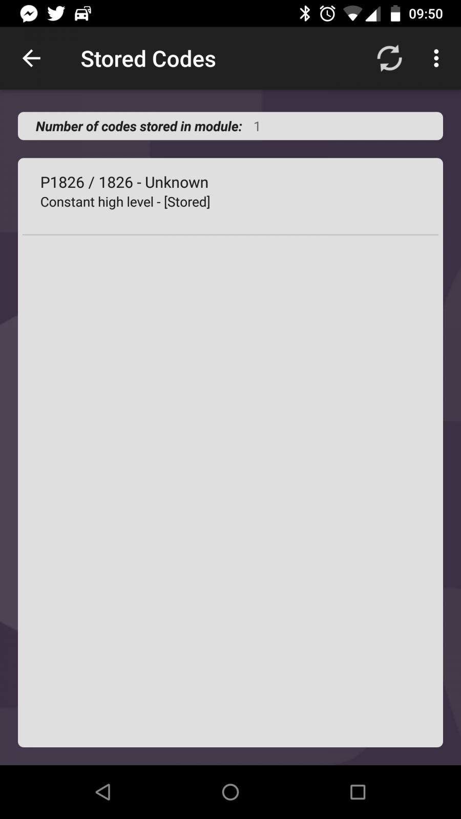

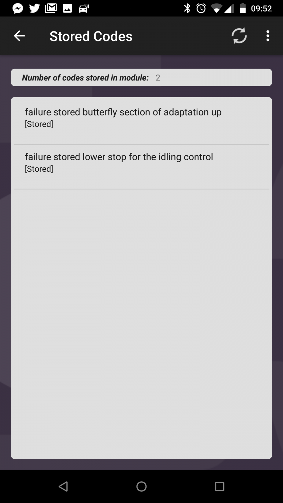

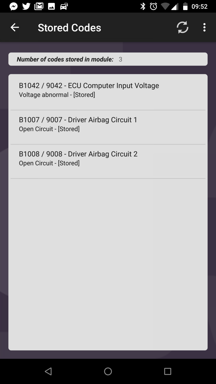

beko1987 Posted November 28, 2017 Author Posted November 28, 2017 Gave it a bit of a prod with oh no renault this morning. The engine has the same code as the old car! Cleared that, then onto the abs Interesting. Cleared those too, with the mot in Jan, and no lights on the dashboard I'm not going to go poking around for now! Then the airbags Dunno if this is just due to a flat battery at some point, but I cleared those (infact I got out of the car just incase the app maker built an Easter egg into the app and the air bags went off... Then read the engine again and got these two codes up as stored These won't clear, so they can stay! Still no dash lights so that's fine, I won't prod the beast too much yet!
