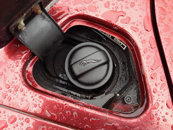

Conrad D. Conelrad Posted March 14, 2017 Posted March 14, 2017 First thing's first, let's give it a check over for rust. It looks pretty good underneath. I removed this inner wing inspection flap, and found that area to also be rust free. Excellent! No rust to worry about. That said, there was a little room for cosmetic improvement. With the help of some spray paint Junkman found in his basement, I set about the wheel centres. The red paint someone had painted them with was household gloss, although the colour match was almost exact. Well done, I guess [simultaneous clapping and shrugging motion]. Speaking of wheels, did we mention how many new tyres it came with? Five. I can't remember ever having a car where the spare tyre wasn't a lake dredge special. Next thing. There's a minor fault with the cruise control, in that it doesn't work. When engaged, the car just slowly accelerates. Someone on the internet suggested this was caused by dried out solder joints in the control box, so I removed said control box and meticulously reflowed each and every solder joint on the board. Did that fix it? You bet! No, it did not. But I can worry about that later, because I have something more pressing to deal with. The other day I took a nice photo of the dash for the Dash at Night thread, in which it was noticed that the ABS light was missing. Probably just a dead bulb, we decided. Since a few others were out too, it couldn't hurt to pull the cluster and construct a bulb testing device. A handful of new bulbs later, and here's our ABS light! So glad to see it, since that's an MOT issue! Now, you're probably wondering, did the light go out when it was supposed to? You bet! No, it did not. dome, Ghosty, nacho man and 24 others 27

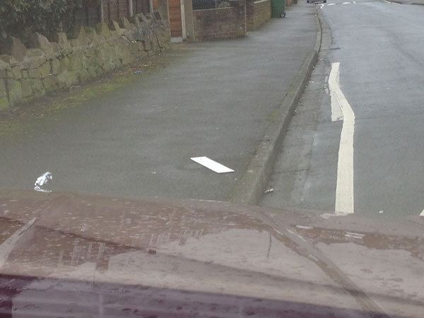

Conrad D. Conelrad Posted March 23, 2017 Posted March 23, 2017 I was absolutely messed up with a cold between Thursday and Tuesday, so I've not not nearly as much done as I'd have liked. In fact, it's gone backwards, if anything. I was quite confident I could make a basic repair patch for that bit of the wings, but as I probe them for good metal they're crumbling more and more. I'm scared to poke any further... After putting some petrol in it, I noticed the front numberplate had gone AWOL. A nervous re-tracing of my route followed, with me no doubt looking shady as shit kerb crawling through residential areas with no plate on the car. Until, ah, this looks like something. So much for the expensive sticky pads I bought. In fairness, although I scrubbed the bumper as clean as possible, it does have a slightly slick feel to it so they probably stood no chance. It's screwed on now. New genuine Jaguar parts fitted. To finish today's terrible, boring update: I bought some degreaser to clean the Rover's engine, and buoyed by the success, thought it'd be just wonderful to dress up the Jag's engine bay a bit. Well, despite my extreme care to avoid anything electrical, it turns out the Jaguar is less tolerant of moisture based shenanigans and it is now refusing to start. Magnificent Rustbucket, Skizzer and Junkman 3

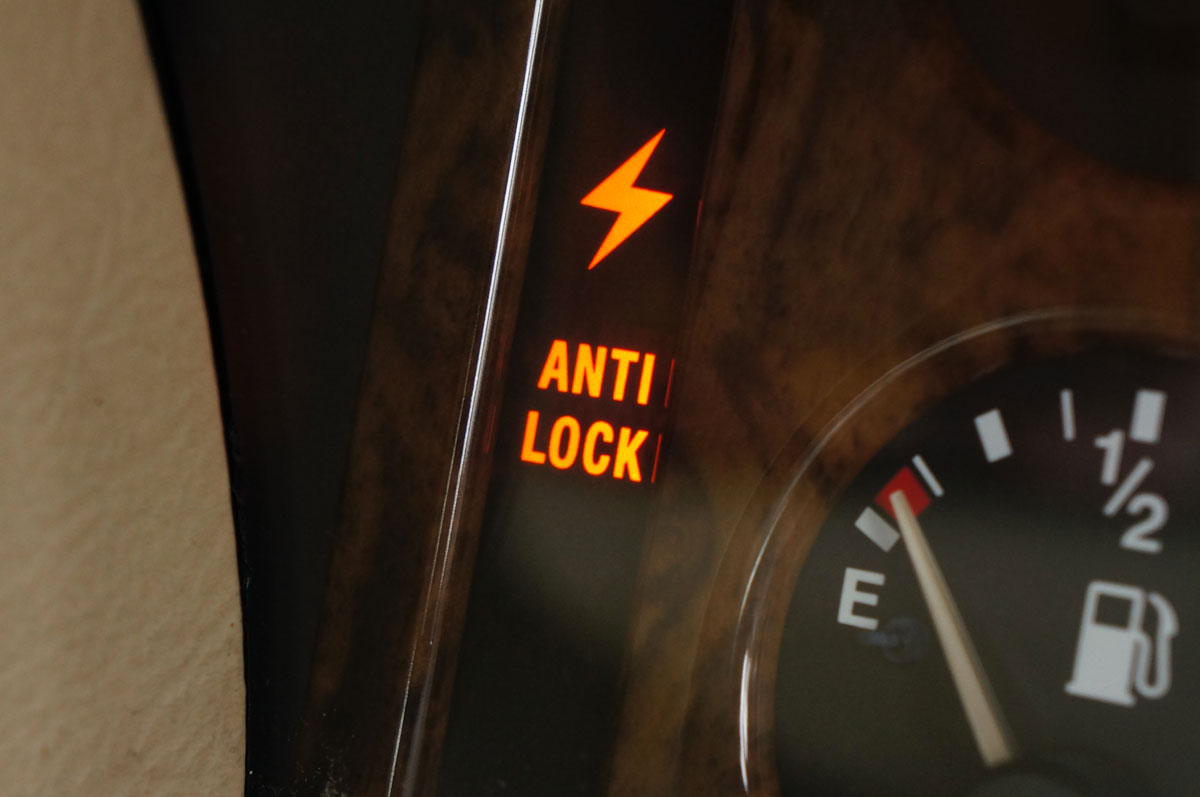

Conrad D. Conelrad Posted April 21, 2017 Posted April 21, 2017 YAY! The ABS light has gone out legitimately! New ABS computer module (tenner including postage from eBay) has sorted it! So only the steering rack leak to deal with now, and I can chance an MOT. I'm feeling pretty optimistic about it at the moment... Magnificent Rustbucket, eddyramrod, Vince70 and 4 others 7
