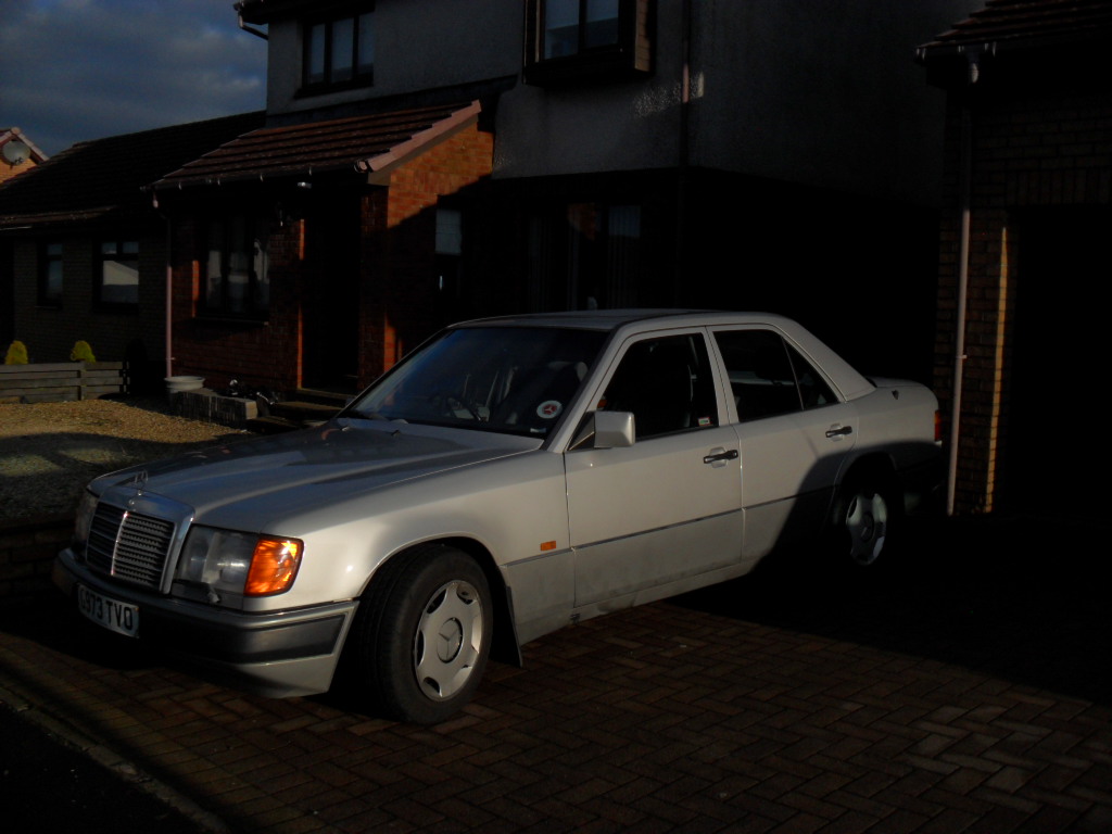

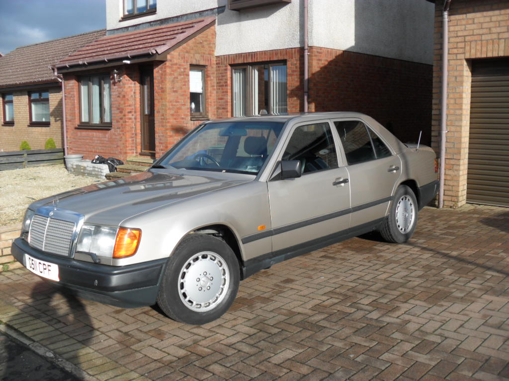

With the MOT due and lots of clunking/whining noises coming from the lotto w124 it was about time for a change. So the ex Dave Chaserace and was it Dollywobbler? W124 has been retired from service after 18 month and 12000miles .of wafting around. Only one FTP caused by dirty plugs and my lazyness for not investigating a slight misfire until in stopped running completly.
Spot the difference.Entre stage left the ex Jerzy Working(?) Borneidentity W124.
This weeks grand plan is to keep first one for spares and come summer if its still in big bits sort it up. All plans subject to change of course.

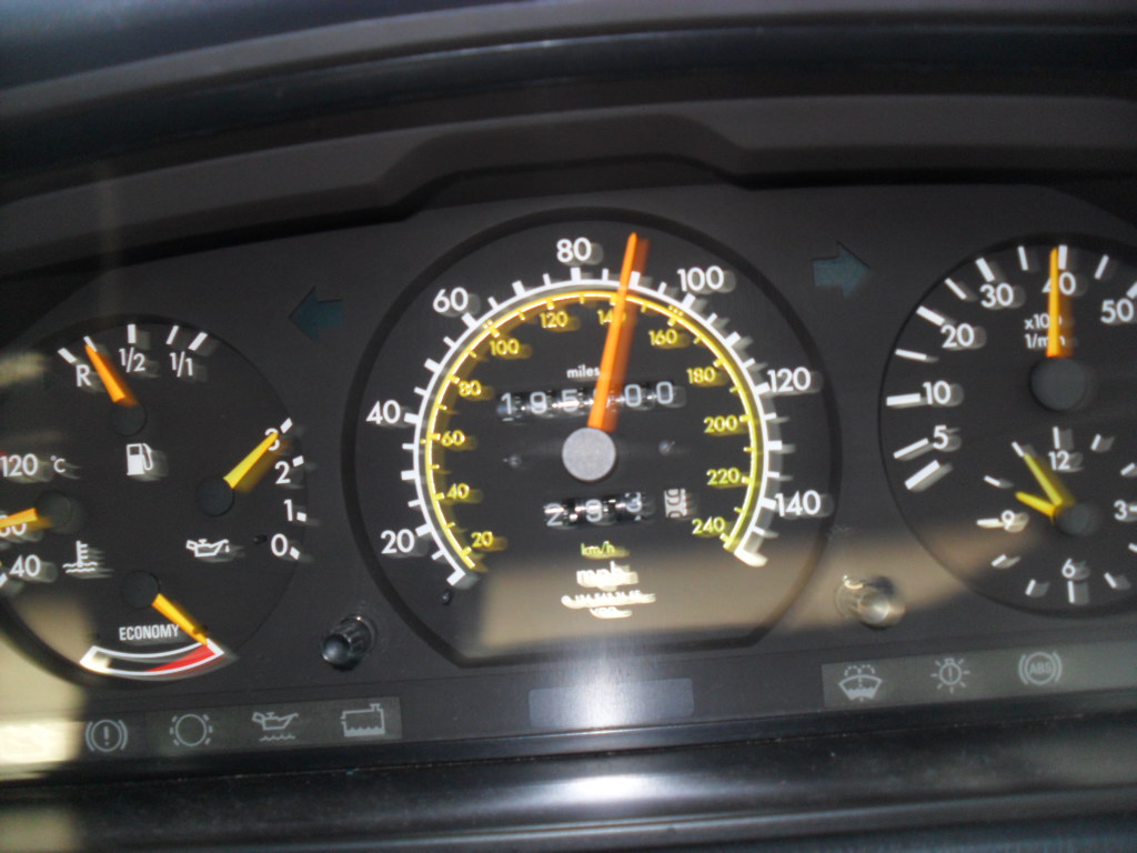

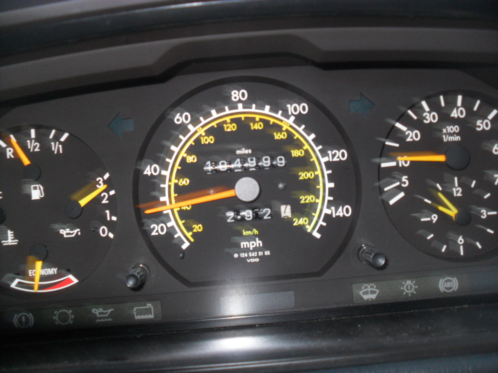

Just catching up with this one. I think it's pretty much four years to the day since I bought TVO. Has it managed to join the 200k club?
No DW it didnt make the 200000ml club. On its way to its retirement home it turned 195000 so I gave it a wee blast to celebrate, on a bit of private road of course.
