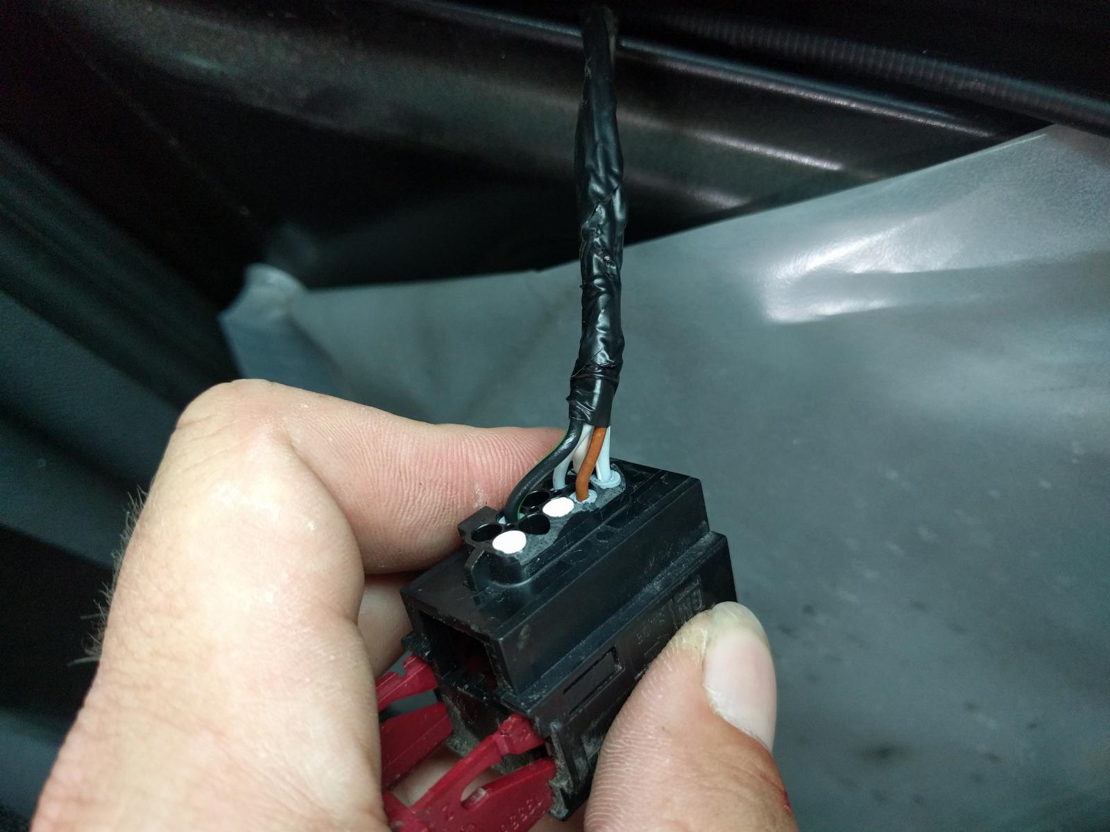

So, the car has decided to have an issue. I've been ignoring the probably broken wires on the rear door, and today it didn't unlock whilst Amy was at the hospital. Luckily I am off work today, so I could go and fetch Charlie.
Back home now, and the vauxhall forums are ranging from a pile of shit to idiots, so I'm asking on here!
I've got the door card off, but cannot open either of the passenger doors. Have had the battery on and off, and read to connect 12v to the door lock wires which does something.
Fuck it, game for anything but nowhere does it say what wire to probe.
Anyone any ideas? These are the wires. I can get the diagrams for the big connector plug for the door, but that's no help. I think it needs a circuit throughout the whole central locking mech and it's not getting it
On my 75 the actuator broke and as there is no lock to put a key in the door would not open. It is that sort of issue?
Dunno, don't think so, as we've been having the symptoms of broken wiring for a while now. The rear drivers door opens with the key, as does the drivers door but not the boot, or the passenger side. I need at least the front passenger door to open to get at the broken loom to fix it.
As you say is does point to that if its one side. Mate had an Audi A4 and the wiring had chaffed in the rubber gator from the car body to the door. Wonder it that is the cause?
That's what happens apparently. It's been mentioned on here before but I've just forgotten to do it! HOWEVER, FINALLY, on page 437 of a thread, someone said to remove the SPEAKER, and therei s the multiplug, which I can pull back in, then very bastard fiddly bodge the wires together enough to get the door open, then fix it properly!
Amy's gone out in the gooner to collect Eva, so will have a look when she's back. Have that feeling about the job that it's going to be an ARSE!
Guest Hooli
Hang on, you're using a goona2 as a backup to a vauxhall? that's is the essence of autoshite!
Door looms will be shot. Don't probe anything at all unless you are sure it's not CAN wiring.
It's frustrating!
Performing keyhole surgery via the speaker hole. 3 wires are fully snapped, 3 are breaking up but still connected. I've joined up the 3 broken wires temporarily, made sure nothing is touching, and nothing. The indicators flash so the module is getting some signal, but the deadlocks are not releasing.
The drivers side front and back are open (the back door randomly opened...) but the passenger side and boot have nothing.
Currently having a fag and writing this with all 4 big plugs removed in the boot fusebox (via the back seats) which apparently drains and resets something, but I'm not hopeful...

If the REC disconnect/reconnect (the 'fuse box' in the back) doesn't allow doors to cycle to unlock then repair/replace the looms. Carefully. With no probing unless you know exactly what you are doing.

I stepped it up a bit earlier, ripping bits of trim out I found where the door loom to the dodgy door dives out of the car... So I cut the rubber gaitor off (will worry about that later and had the whole loom inside the car! Properly cut the wires down and crimped them together and...... NOTHING, just the indicator flash but no motor noise...
It's sat now with the battery off, which shall remain off for the next hour, in the last gasp hope of resetting the central locking module which I presume has shit itself with the shorting wires. If this does not sort it, I shall be driving it to work tomorrow so Amy can have the laguna which has 4 YES 4 bastard working doors (although only 2 working windows but we'll ignore that)

Yes, multifunction with a dodgy CIM module... All I have done so far is connect the broken wires back up with the battery off and unplugged and replugged some multiblocks in, and checked both 10a central locking fuses
