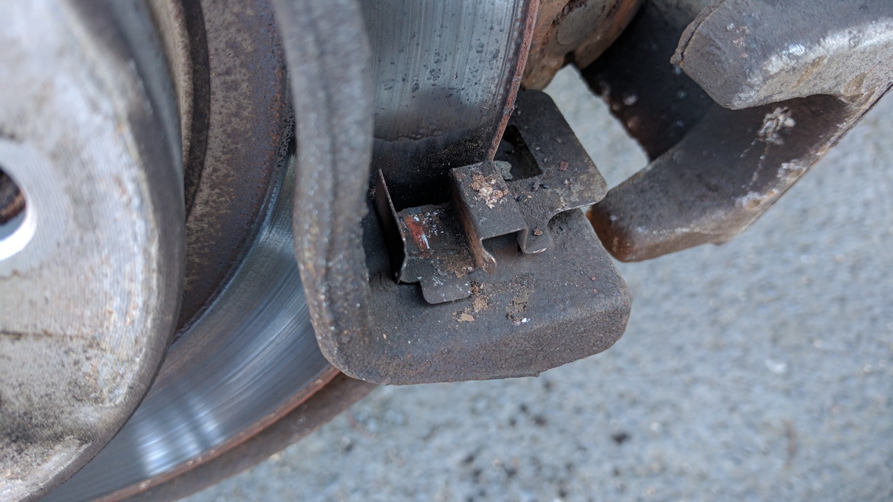

"sssssh, can you hear that squealing?" Amy said to me thus afternoon as we drove to the car boot...
"oh yea, shut up a minute" as I wound each window down in turn, a bit worried as it was the same sort of noise the xantia made 3 days before it shat its aux belt...
"what the fuck are you doing" she shouted as I gently eased the handbrake up at 50,which made the noise stop...
"seems the rear brakes are squealing" I said. "oh is that what it is? I did wonder, look, it goes away when I brake" WHUMP emergency stop...
Sure enough we got to the car boot and the rear passenger wheel was too hot to touch. Driving back home it was fine though, so I've caught it early I think...
7pm I had a look!
There was a lingering burning smell still
Eventually, after breaking what is probably the original fugging vauxhall locate, the carrier came off to reveal the pads, whose life can probably be measured in weeks took some levering out!
The sliders looked just as grim
Using some Tardis and the last of my wire brush I cleaned them up
Much better! The sliders eventually gave up and pulled free too
And cleaned up nicely
And with a bit of lube went back in lovely!
I put all that back together, and wound the post on back, which gave a nice crack of corrosion as it started, and it all moves very well now!
Ill get some pads ordered and some more little wire brushes and do the drivers side and replace the pads I think pretty soon! The discs look OK, their not scored or owt.

I've had the rear brakes apart on my wife's Zafira.  I don't understand why the rear calipers always seem to have pistons on threads that have to be rotated when the fronts don't?  On ours the seals were in a bad way even before I tried rotating them - in hindsight, I reckon removing the outer dust seals before rotating them might be an idea and greasing the whole lot up with rubber grease. Our pads were about the same as yours though.
This is what took the time to crack off. In the end I pulled the boots from the carrier, then put a 17mm on the inner bolt and twatted it, then held that and twatted the main bolts with a 13mm and they cracked eventually.
What is annoying is the handbrake cable holder gets in the way of the top bolt, so a socket nor the ring part of a spanner will fit on!
I think Lisbon Road means the main piston that you wind back with a special tool , not the slider pins
Oooh I see! I use my £12 ebay caliper rewind set for that!
