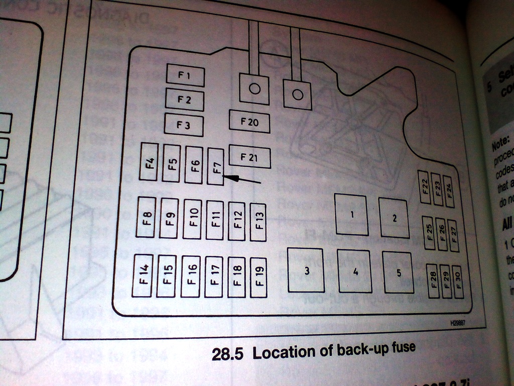

Is there a diagnostic port somewhere on the car? Readers are about £8 off the 'bay, suitable for 90's/noughties cars, they can tell you what the car thinks is wrong, and can cancel any registered faults.
If that car has the flashing LEDs on the ECU, you can clear the fault codes by removing the 7.5 amp no. 7 backup fuse for 30 seconds.

No OBD on this - the 'check engine' light means the flashing LED on the ECU has something to tell you. A feature unique to the 2/416 iirc.
saucedoctor: which fuse box is that in? I removed one of the underbonnet ones marked ECU and it didn't do anything.

Ghosty: The Haynes Book of Automotive Fault Code Lies doesn't give the fusebox location, but has this drawing:

From memory, the fuse box is in front of the driver's right knee.
It is, but there's one just above the battery too, that also has an ECU fuse in it.
