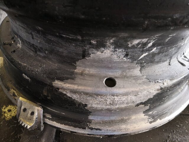

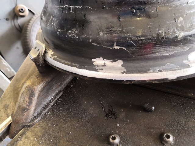

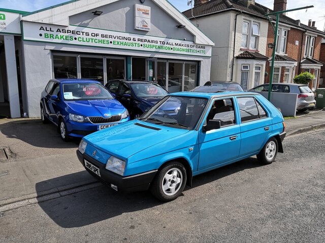

The Triumph had two slow punctures which was annoying and stopping me from using the car as I was too lazy to pump them back up. So I jacked the back of the car up and got the wheels off, then washed them down with soapy water to try and find the leaks. Not easy getting the offside rear wheel off with the car in this position but I managed. IMG_20190430_163016.thumb.jpg.a0aa295a5b6bc5c526863ab2a240d0fb.jpg
This showed the same problem on both wheels with bubbles coming from the base of the valves. Fairly common on old alloy wheels.  So I bunged them in the back of the Favorit and set off for my local friendly tyre fitter. I usually tend to do it this way if I need tyres because I don't like other people taking my wheels on and off. They're either too tight or I don't like where they're jacking it up or in the case of the Triumph they're awkward to refit as there's no central spigot and the wheels are held in place with special wheel nuts. But I digress...
They got the tyres off and the valve holes were indeed corroded and not entirely round. IMG_20190430_151507.thumb.jpg.4c3102da811f8115e79ad35399c46233.jpg
So they cleaned up the holes and spent a fair amount of time going all the way round both rims.IMG_20190430_151741.thumb.jpg.a3541b7b6ceb58a6ceb28bfaae5dc8d2.jpgIMG_20190430_152240.thumb.jpg.eb50b5432461cfdacc2650141ce42b9a.jpg
They had two buckets of gloop. One black one white. IMG_20190430_151715.thumb.jpg.e4f37c604a38715156e4dfd6f0511e47.jpgThe black a sealant for the valve, the white a lubricant for refitting. Also a neat little trick I wouldn't have thought of was to mark the tyres before removalIMG_20190430_163314.thumb.jpg.65842922ad9d8ab418d5e66c6463ca44.jpgso as not to have to rebalanced them. That's why they're professionals and I'm not.

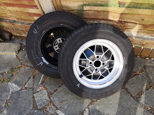

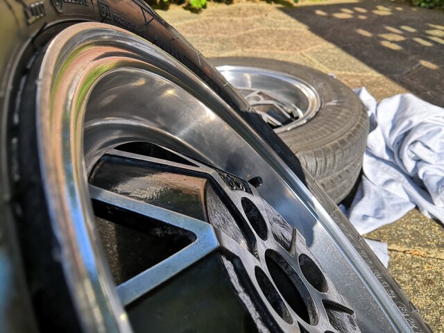

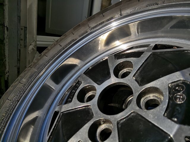

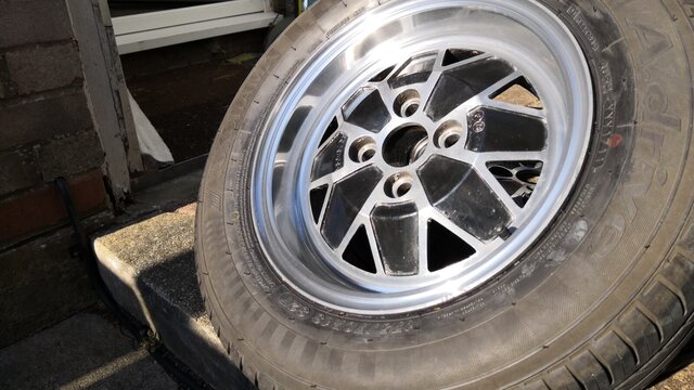

And whilst the Triumph wheels were off I thought I'd give them a bit of a polish. The car is definitely not a show car but the wheels need a polish occasionally. When new they were lacquered but that all fell off years ago. Now they're bare ally so they need the odd polish, though thankfully less so now it's garaged.
But they do come up lovely. Worthy of some pics on their own. IMG_20190430_171450.thumb.jpg.163709eb92b3b1ba128b12a5a50398c4.jpgIMG_20190430_171544.thumb.jpg.28bd64f004d533ec9f655d59cb1a0365.jpgIMG_20190430_171427.thumb.jpg.60859ebf5a76739838149b359c238ab9.jpgIMG_20190430_171608.thumb.jpg.bac81fc554c499cefda1c5944e685850.jpg

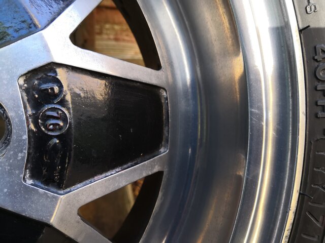

There's actually two types of Dolomite Sprint wheels. IMG_20190430_171931.thumb.jpg.86ee209c57fac322d28d81dc23e5f6b0.jpgIMG_20190430_172032.thumb.jpg.52990b8d7a8112e3f6466ffa722ce811.jpg
The date stamps here show 75 and 76. The lower one has a GKN makers mark. It also has slightly thicker polished bits in the middle and the outer rim is a different profile. I have one of the upper type and three of the lower but it doesn't really show unless I point it out.
I really should have cleaned the front ones too. IMG_20190503_163555.thumb.jpg.bdb8025691f962342edd51dc38e43bc8.jpgShoddy.

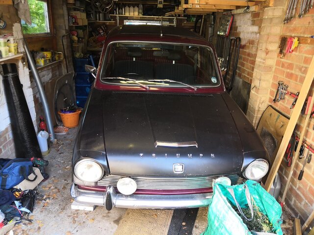

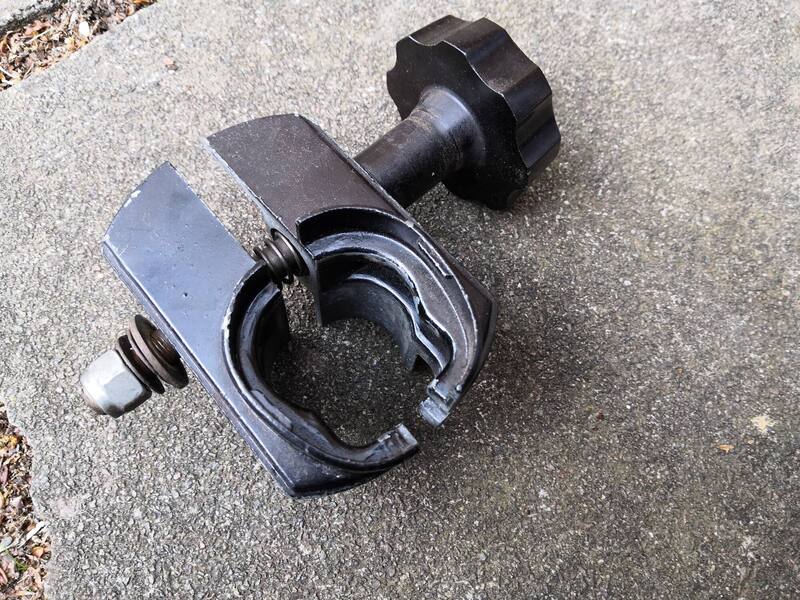

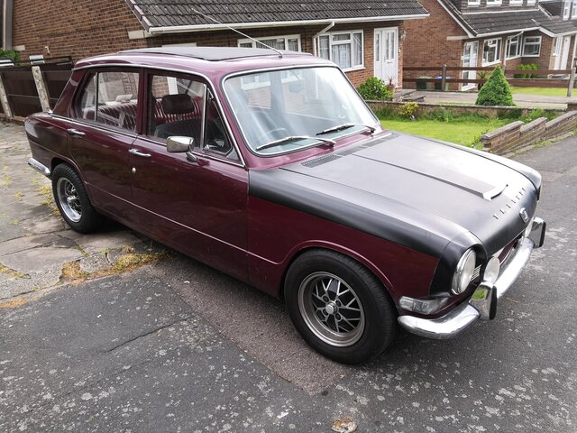

The Triumph has started feeling a bit wobbly at speed. Not on the bends, it's still great there but in a straight line it keeps changing direction slightly and wobbling the steering wheel was showing a fair amount of play so some investigation was needed. So I thought I'd take the rack out and check things out.
So first of all the column has to come out. That's an absolute doddle on these. Undo the pinchbolt where the column enters the UJ in the engine bay. Then back inside the car it has an adjustable column. Simply undo the big knurled knob all the way, push it up as far as it goes and there's a hexagonal hole at the top of the mounting bracket through which you can pull the pinch bolt out. Then lower the column again and the clamp holding the column simply falls apart leaving the column free. It takes less time to do it than it took me to write this.
This is the clamp. IMG_20190524_170245.thumb.jpg.687597ec86939ab3856b3d61c3297b36.jpg

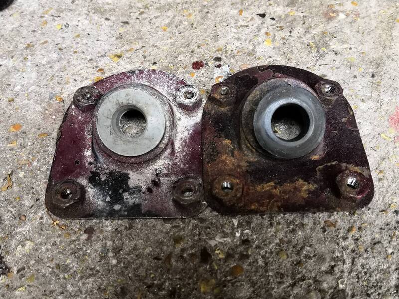

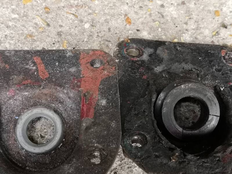

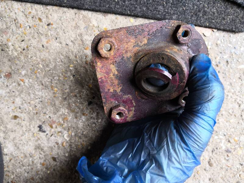

Once the column was out I could remove the bush in the bulkhead and the here the first problem was found. IMG_20190522_122946.thumb.jpg.2457b2245ac0d05253fdaafff300c6ba.jpg
I found another one in the garage and whilst the housing could do with a clean up the bush is in much better nick and a better design. Here you can see the hole is smaller. IMG_20190522_123600.thumb.jpg.5b6931711725e4bb46148de8e5f007e0.jpg
And it's a completely different design on the inside. IMG_20190522_123656.thumb.jpg.75eb90b3c52003cf40857eaf26ccec5a.jpg

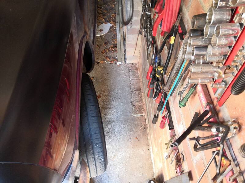

I really would like a bigger garage or proper workshop but you have to work with what you have. The rack slides out through a hole in the drivers side of the subframe so I had to leave as much room as possible on the offside IMG_20190523_163247.thumb.jpg.5049164ecdc984a519b1cad908dfeed0.jpgwhilst still having enough room to remove the nearside wheel. IMG_20190523_163148.thumb.jpg.ff01ceaad47aea20d3c9b59e241b685c.jpg

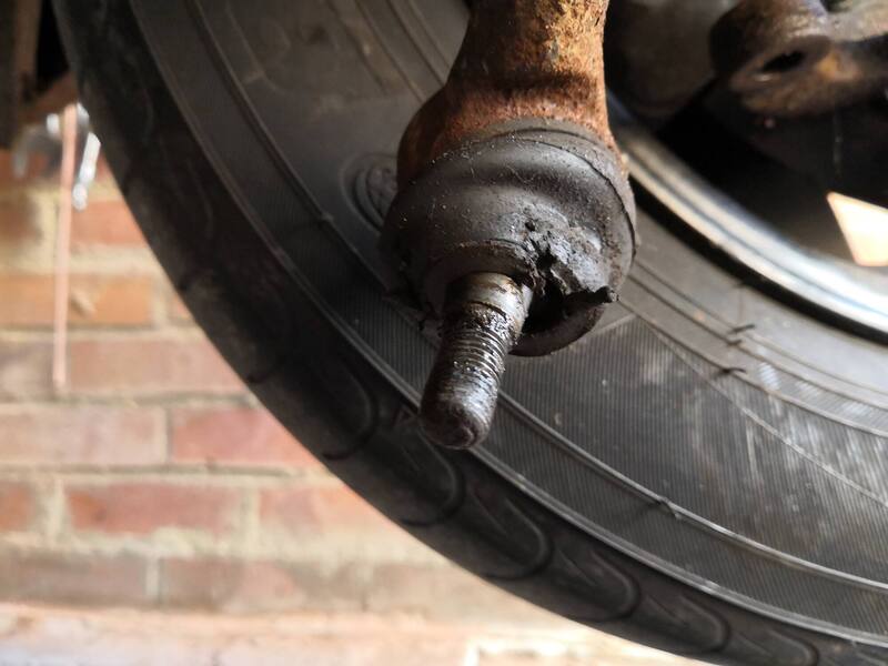

Though as it happens I managed to get the ball joint splitter on the track rod end without taking the wheel off, though I didn't know if this was possible until I got under there so I had to leave room just in case.
Track rod end gaiter was already shot. IMG_20190523_170256.thumb.jpg.4daf7e46736731cbbad51d8e10b3a8fc.jpgthough the joint itself feels OK, but I have new ones so I'll change them. The offside one does feel a bit loose.

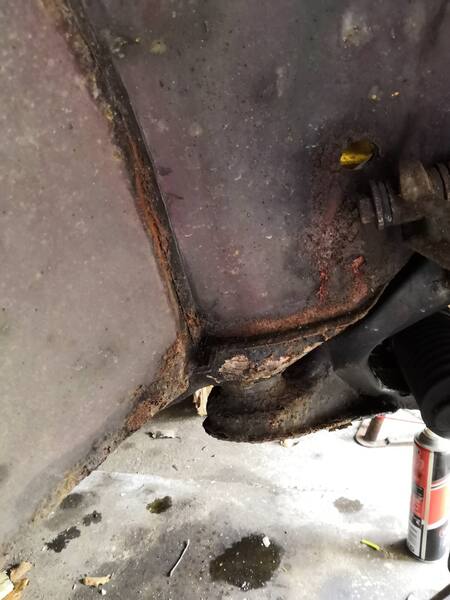

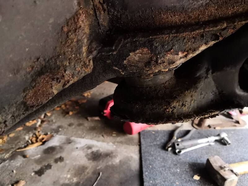

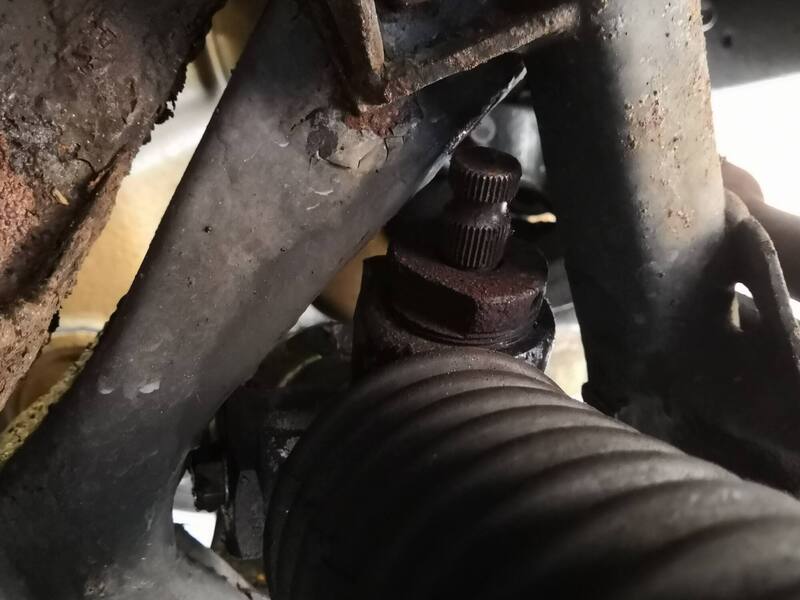

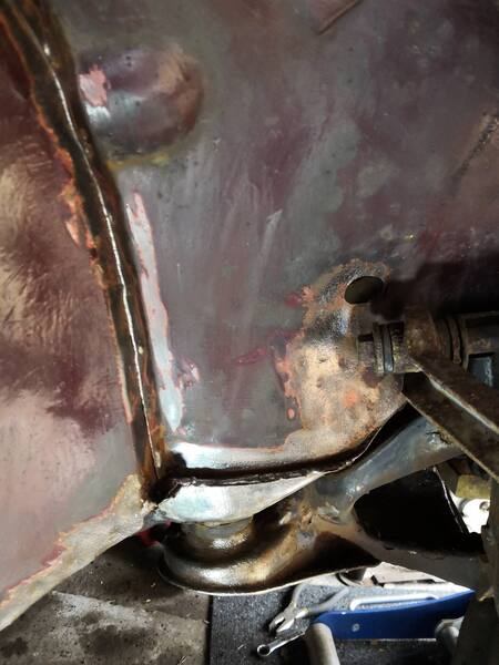

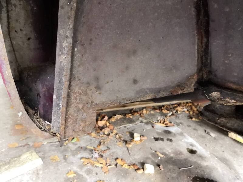

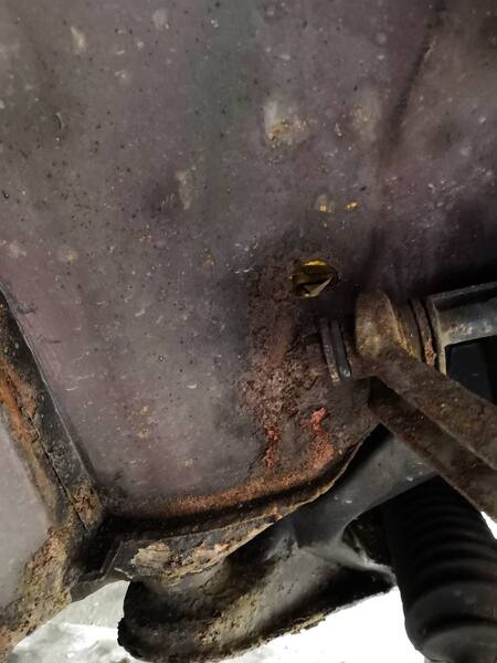

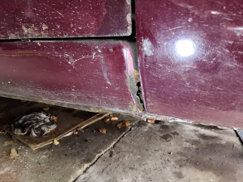

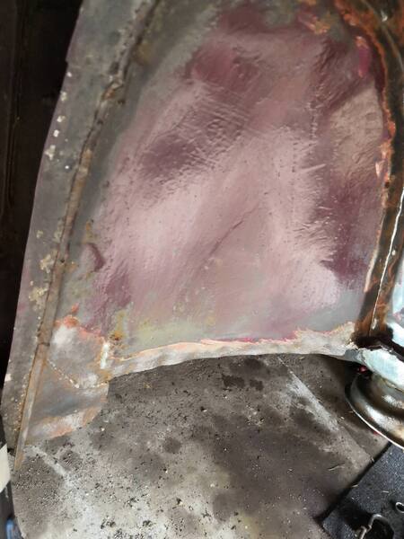

But whilst working on the offside I found some nasty rust. At least it could be nasty if I hadn't noticed it. As it is I think it's only surface rust at the mo. IMG_20190522_123014.thumb.jpg.8b6da849cc06c26459c8c609f993b996.jpgIMG_20190522_123539.thumb.jpg.515f4d7a8906d5cb8e3958e8e48fcac4.jpgIMG_20190524_153421.thumb.jpg.4442c02e7166b1e8cfda9ab4ac6cac0c.jpg
I know why this has happened. There's a small (intentional) hole in the inner wing and on the inside it's right under the brake master cylinder. This was leaking for a while and I had to keep topping it up. It's in a fiddly place and even with a funnel I'd spill it occasionally. I cleaned it up on the inside and repainted but some was obviously coming through that hole, you can see where it was running down then spreading along the seams. IMG_20190522_123037.thumb.jpg.779cc34b5d3a265b4aa21407986fa13a.jpgIMG_20190524_153409.thumb.jpg.1319ed0ade653096c8fd319fdac14fdc.jpgSo once I get the rack out the first thing I'll be doing is grinding this back then treating and painting it.

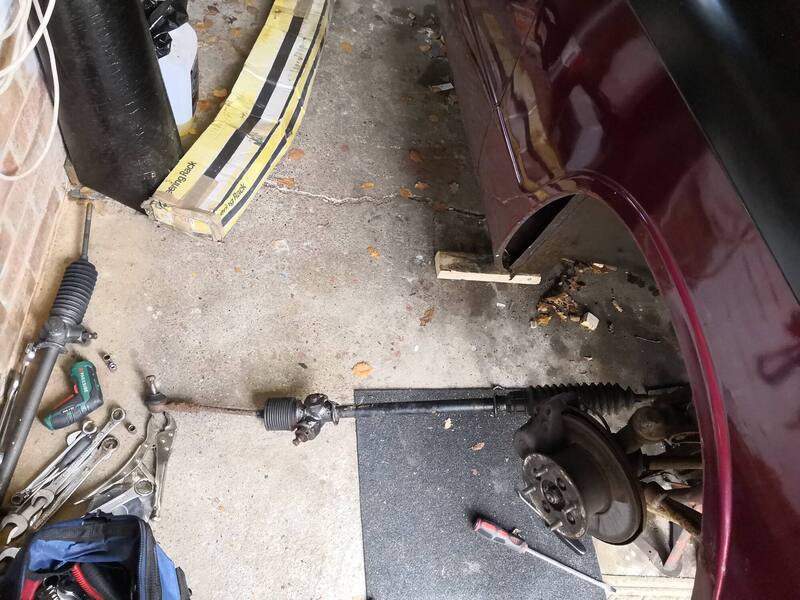

So I got the steering rack clamps off and the poly bushes I fitted about ten years ago are perfect. IMG_20190524_163017.thumb.jpg.86ba0361a016a657266a84769f483572.jpgAs they should be really but you never quite know until you look for yourself. So that's one less thing to worry about.
The rack is quite a tight fit. There's a tunnel shape in the sump that fits over it. That big gold thing is the sump, a massively heavy cast iron lump that contains the gearbox at the rear and the diff at the front with a shaft running through the middle in a tube. Unlike the BMC FWD's they all have their own oil supplies that are kept seperates by various seals. Anyway crap pic as things are in the way but you can just see the rack. IMG_20190524_161425.thumb.jpg.b35559e2c0877636c3b3d84e67c81748.jpg
The front engine mounts have to be slackened off to jack the engine up a bit to pull the rack out, but that's no real problem. The rack can then be swiveled to get the pinion bit out through this small triangularish hole in the subframe. IMG_20190524_162321.thumb.jpg.ca56c256659a75b4d782642e866a17f8.jpg
IMG_20190524_162339.thumb.jpg.c1881709ba227c006c4698fec51e5006.jpgThen it just slips out, fortunately with about a foot to spare. IMG_20190524_162502.thumb.jpg.6867effbf91b16305a780113bd66cde3.jpg
I have a brand new rack. IMG_20190523_163131.thumb.jpg.45be298e7399a0c0c0c2f855dc18176f.jpg
Unfortunately its for a different car! I bought it years ago from someone who though it was a 1300 rack but comparing the twoIMG_20190524_163648.thumb.jpg.e7ce5f048debf3ed25b00ac196bde939.jpgshows that whilst very similar the pinion comes out at a different angle and the track rods are slightly shorter. My guess is it's a Herald/Spitfire rack. I only paid £20 for it so if it is Spitfire I'm sure I can get my money back. Even better if it turns out to be for a TR I'll be able to charge £££. Anyway I've had a play with my rack and it seems fine. Stuck the track rod in a vice and wiggled the pinion and there doesn't seem to be any play. It's a bit looser than the new one but the tension can be adjusted with that big hexagonal thing on the pinion housing. So I'll adjust that and put fresh grease in and that'll do.

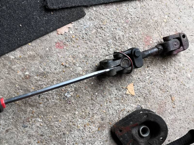

The UJ betwixt column and rack is also fine. IMG_20190522_124007.thumb.jpg.63ee2ee59c2c435bb736f26b3f7a6849.jpg
So I'm hoping the new bush and track rod ends will do the job.

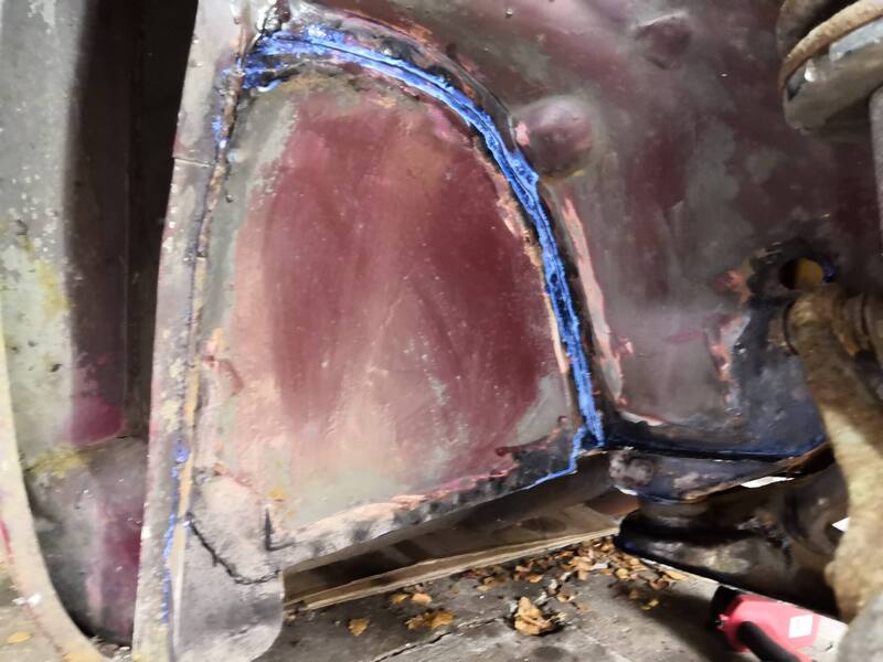

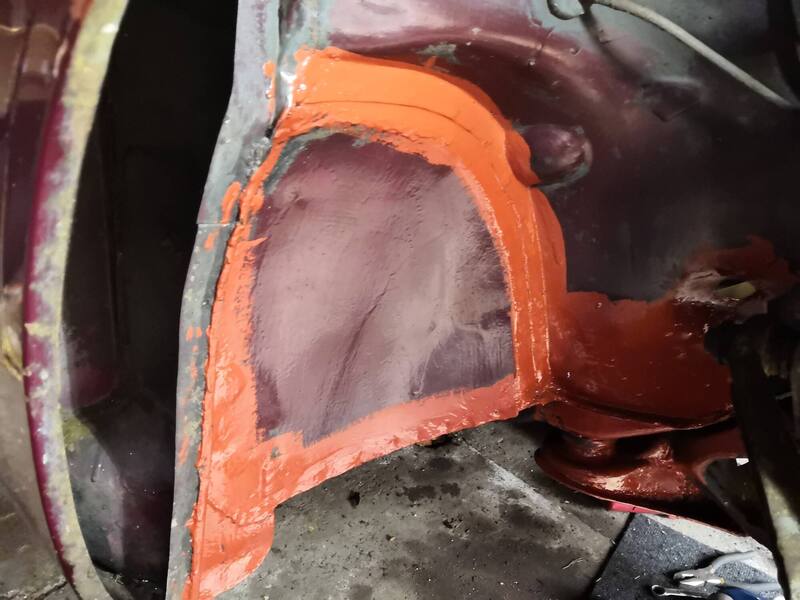

On the rust front, I cleaned up all the bubbly bits, and no holes. IMG_20190526_122755.thumb.jpg.9fed4350767813a8e2b8fe8b57dcf8f5.jpgIMG_20190526_122745.thumb.jpg.b2576d345bb089f01a100d5839ed695b.jpg
So that's a good result. Unfortunately whilst I was down there I noticed some bubbles where the sill goes under the front wing and had a little go with the wire wheel. IMG_20190526_122858.thumb.jpg.48bc89f7c3bdf671e4eae806c552177e.jpgThat's a bugger!
The bare metal was treated to Kurust rust converter yesterday. My camera does exaggerate some colours and this is a perfect example. IMG_20190526_125401.thumb.jpg.c33240f4693c3506c2c61629c456eea8.jpgThe stuff is milky white then turns any rust left a blue black but this pic makes it look like it glows in the dark. It doesn't unfortunately, that would be neat. It then got a coat of my trusty Bonda primerIMG_20190526_170105.thumb.jpg.41e8e2f3bd96eeb53e994927088026be.jpgwhich also allegedly has rust inhibiting properties. I've had this tin years and it is getting a bit low. I don't know if you can get it anymore. So this left me with this. IMG_20190526_165652.thumb.jpg.c6e88ca2f34609b65516250612706d82.jpgI made sure I worked it well in to the seams (as I did with the Kurust obvs) and this afternoon gave it a couple of coats of Triumph no.17 Damson. IMG_20190527_163451.thumb.jpg.63a75da19f5c3f7d82247c83a8a1bf25.jpgThere we go, good* as new*. I'll do the bit of subframe black before I put the rack back in but I had the rattle can in hand so I thought I may as well give it a bit of Damson too. Can't have too many coats of paint.

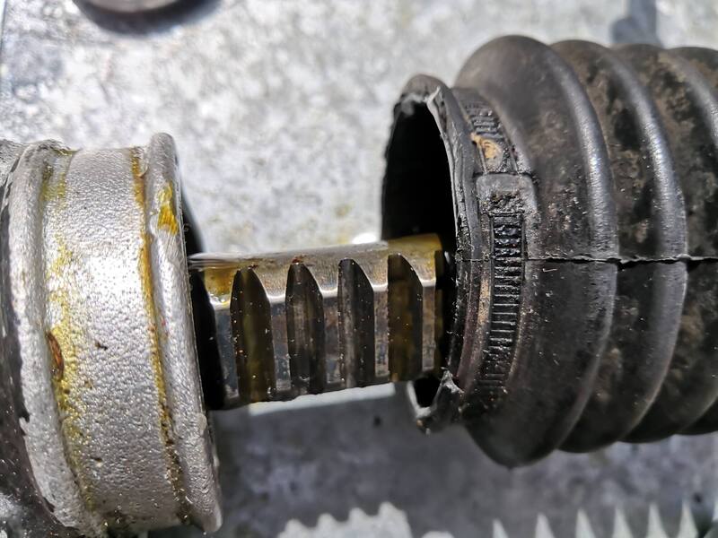

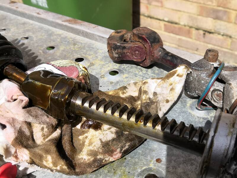

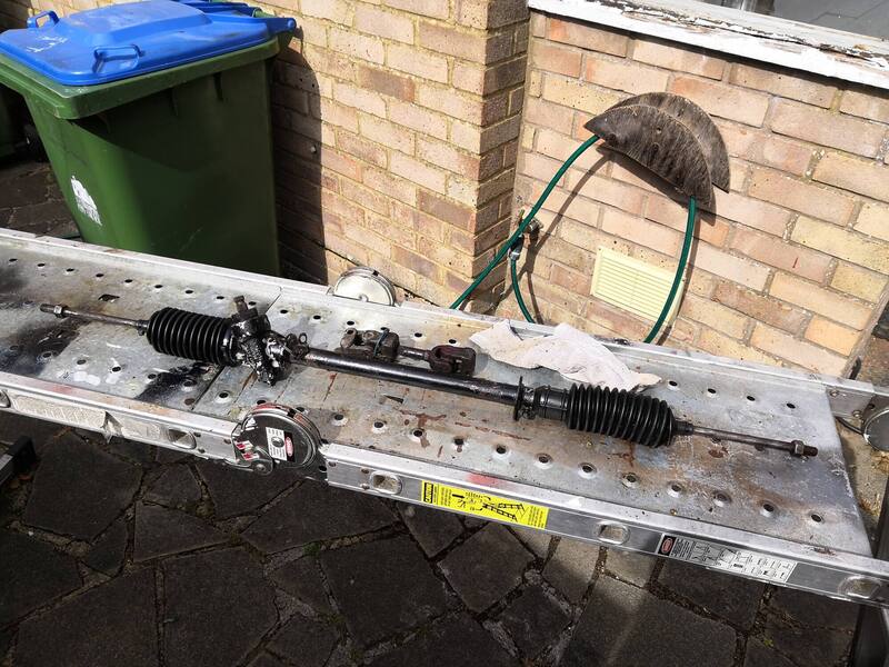

I took the gaiters off the rack and as expected it looks fine. IMG_20190527_145724.thumb.jpg.22884817efa36c3ead2a2ec91172728e.jpgThe only odd thing was the grease was more like a thick oil.IMG_20190527_150513.thumb.jpg.060f46637523602e85acd8d706c873e1.jpg I thought this was odd and even went back indoors and googled it and yes, as I thought it should be LM grease. It obviously just breaks down over time. As far as I know this could be the original rack, certainly never been changed since I've had the car. So most of the oil/grease was removed and replaced with fresh LM.
Reassembled and deagreased rack (there was grease everywhere by the time I'd finished). IMG_20190527_161721.thumb.jpg.2f62a20d9aaddd8365f549dbdaa4c59d.jpg

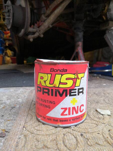

26 minutes ago, Yoss said:
.....a coat of my trusty Bonda primerIMG_20190526_170105.thumb.jpg.41e8e2f3bd96eeb53e994927088026be.jpgwhich also allegedly has rust inhibiting properties. I've had this tin years and it is getting a bit low. I don't know if you can get it anymore. ....
Still available, apparently.
  • Thanks 2
Brilliant. I reckon my tin is the best part of twenty years old and they haven't changed the label at all. I like that. Don't change things that don't need changing.
Let's hope the formulation hasn't changed.
Like paint stripper you mean. None of that works any more, not even the stuff that claims it does.
.....or Hammerite

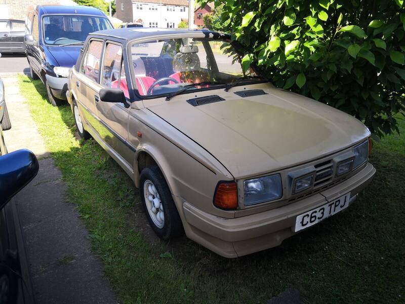

Last week a Felicia L&K popped up on Facebook. I don't use it so my wife opened negotiations and once in contact I took over mentioning I was a bit of a Skoda licker and included a picture of my Fav. The seller replied that he'd seen that car on Autoshite! Well that bodes well.
The idea was to replace my Felicia with this one if it was better than mine. Didn't quite turn out like that. It was better than mine in many ways and is certainly the best Felly for sale out there at the moment. It's an L&K for a start, a top of the range special edition from when they first came out.
But I decided to stick with what I have. It has comedy lacquer peel which gets worse almost by the day but is absolutely solid with no rust at all which makes it pretty much rare these days. Plus it's an SLXi which is top of the range of the face lift cars and has a few things the L&K doesn't (and vice versa) like power steering and ABS. The L&K has heated leather seats and door trims and a top tint windscreen - very tempting.

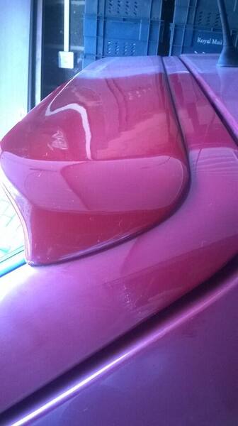

Plus mini spoiler over rear windscreen. 2.jpg.bb665212c9553318d422c1f8ac25dda8.jpgSome seem to have alloys and some don't.

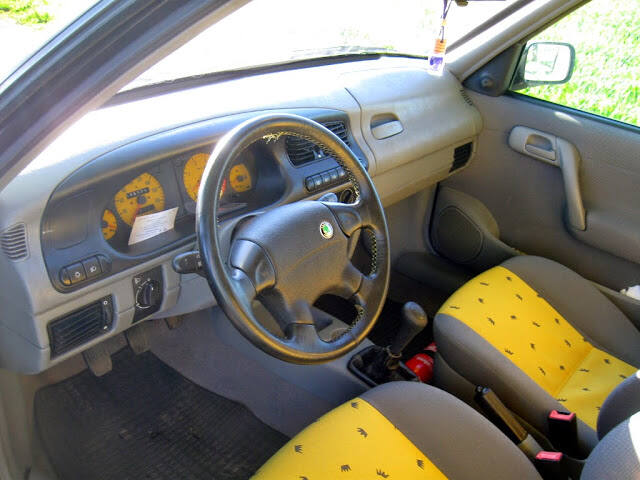

As far as I can tell they came in red with red inside and black with yellow. skoda-felicia-1-6-lx-servis-kn-sportline-2000-ojete-16910558.thumb.jpg.a22156fd87dcd8dc84e68e9487e04c03.jpgSpec seems to include colour coded mirrors, top tint screen and front fogs but not the little boot spoiler that the Mystery and Bohemia get, which you'd have thought would be a shoe in on a so called sport. The wheels are the same as the L&K.
Look at the lovely red seats. 9.thumb.jpg.783443baba9a50965c16a1530cca3ceb.jpg9.jpeg.8bc406e6363760f254cd0607eb746938.jpegAnd those seat belts! So want.
The yellow seems a little impractical. IMG_0796.jpg.37c10cf071bca8155f7dc3f26c31fdeb.jpg

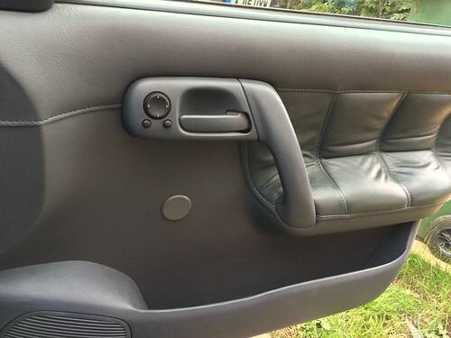

But my favourite is the Bohemia. Has most of the spec of the L&K but without the leather. Of the pre facelift cars it was only these and two that had colour coded bumpers and I think it transforms them. They look really neat and so much better than the facelift cars. IMG_20190606_182516.thumb.jpg.8ac5b231c33a884fa4a5d345f0174110.jpgIMG_20190606_182555.thumb.jpg.835881092fa2b3e22d807e2c1faf3942.jpgThough I don't know if red is the best colour. This blue one looks nice. skoda-felicia_key_3.thumb.jpg.8cf83bf22c443d8a94710bc027bec95f.jpgBut Atlantic green has to be the tops. 6595148491_337d480c7f_b.thumb.jpg.2c6baf1396b7c7852c110b4df502ca68.jpgThe boot spoiler. 15328443576_417db23ac5_b.thumb.jpg.9ea83e34f00f3d12a0a09e201f07f5bf.jpgAnd whilst it may not have the leather it does have nice velour. 15328443366_e631f39b47_b.thumb.jpg.ed01c9e43063b550ff90217519abec92.jpg

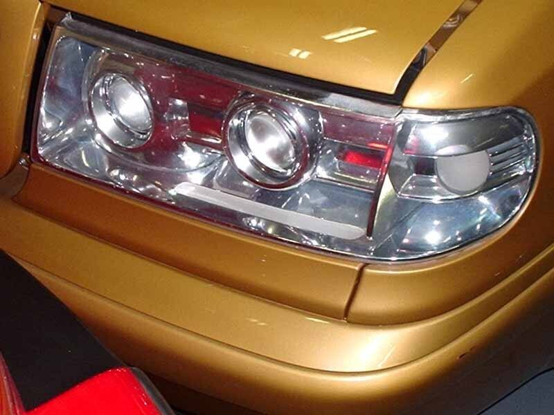

Projector headlamps. Shame these never made it to production. golden03.jpg.b7379a5363cb6257d3757faae40b34c4.jpg

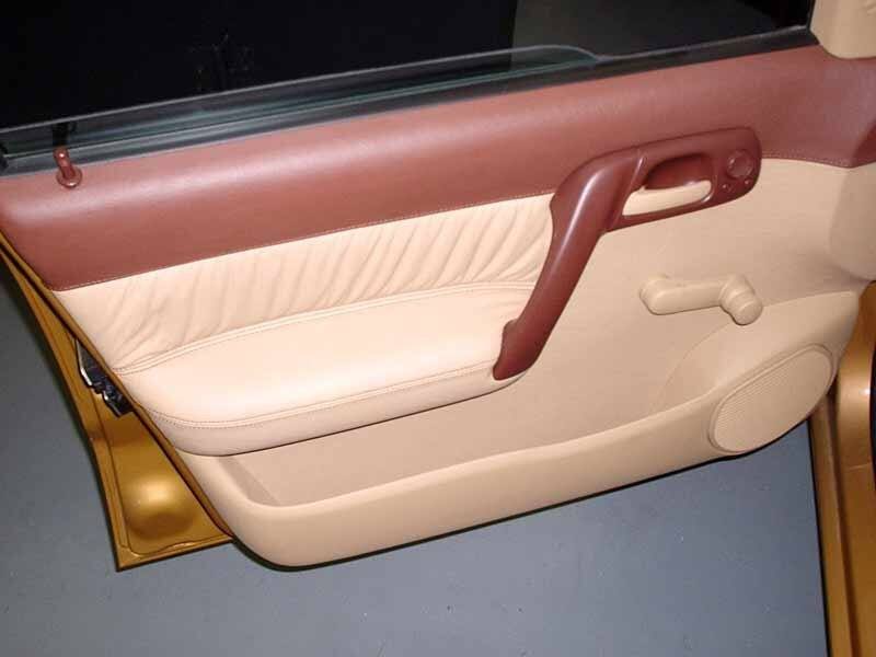

Leather door trims. golden08.jpg.440fdb040afbfe6251bf4ac6419f5845.jpgBut oddly no electric windows.
