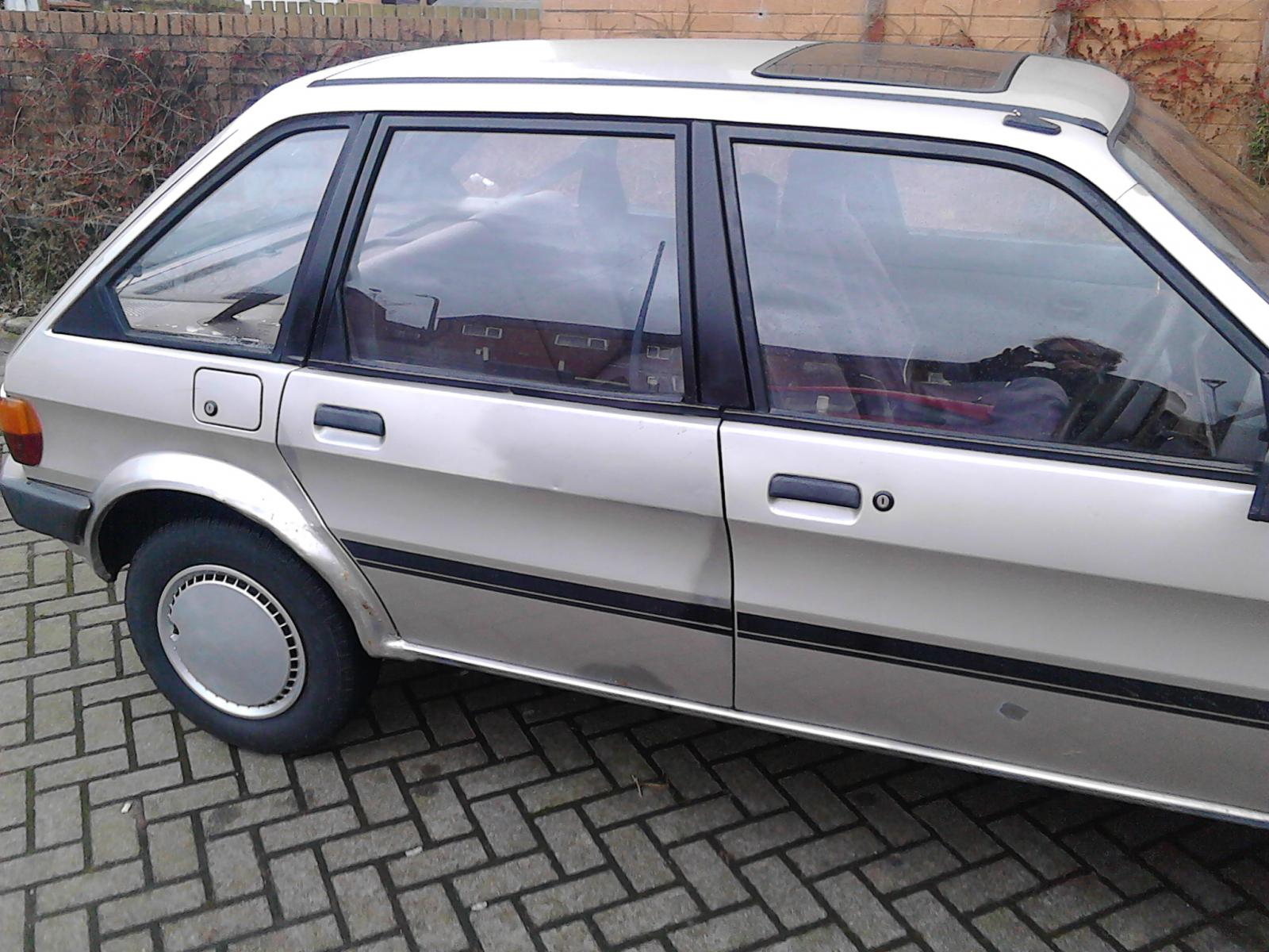

welding finished,pictures later,pretty solid old thing, :-D :-D

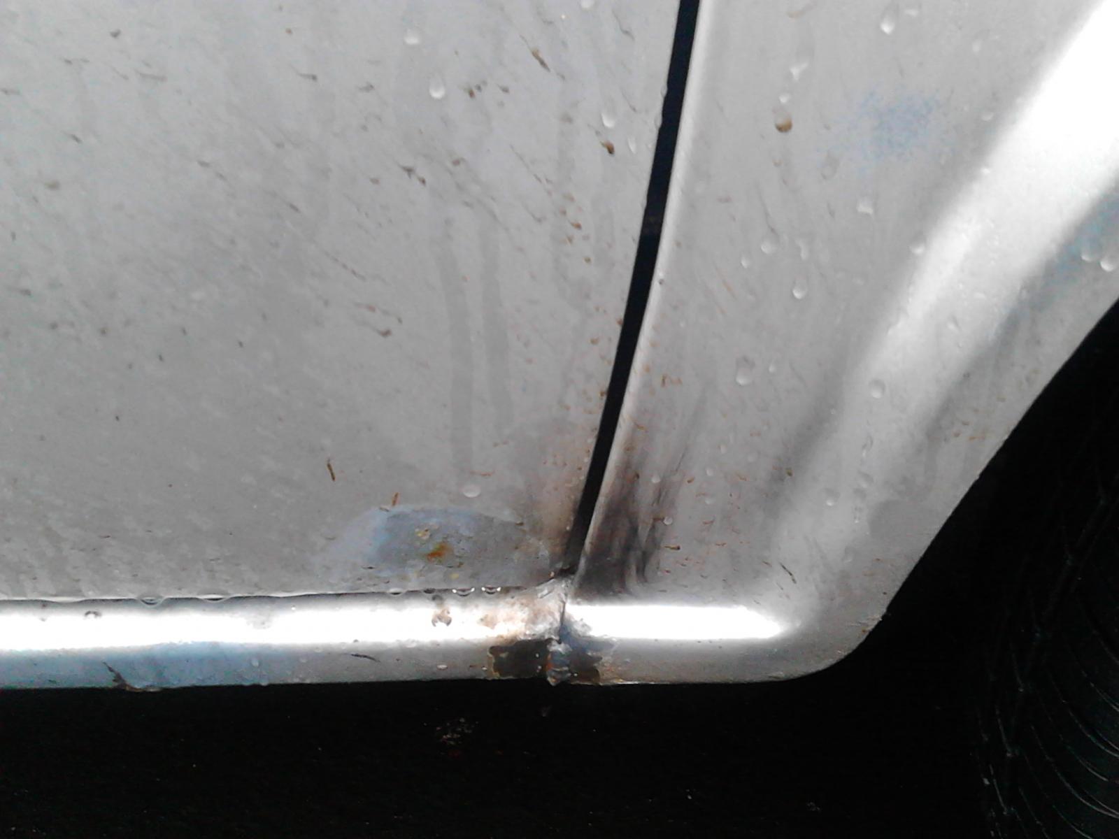

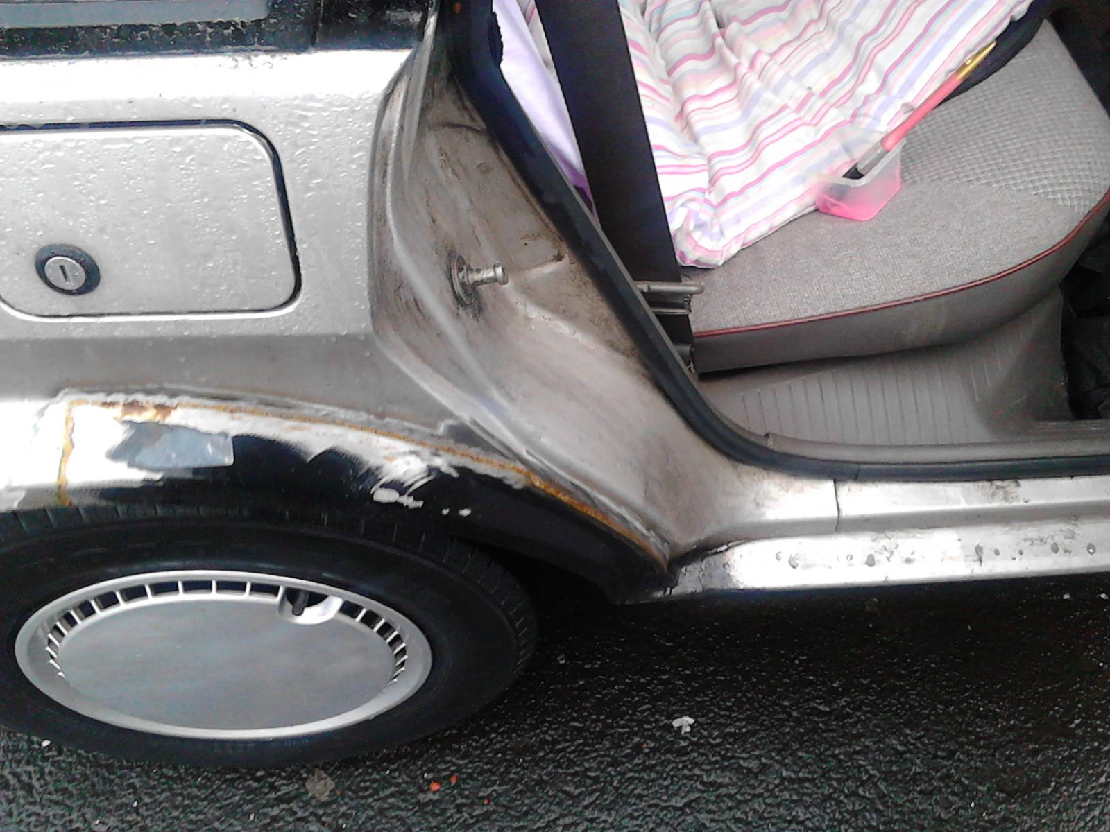

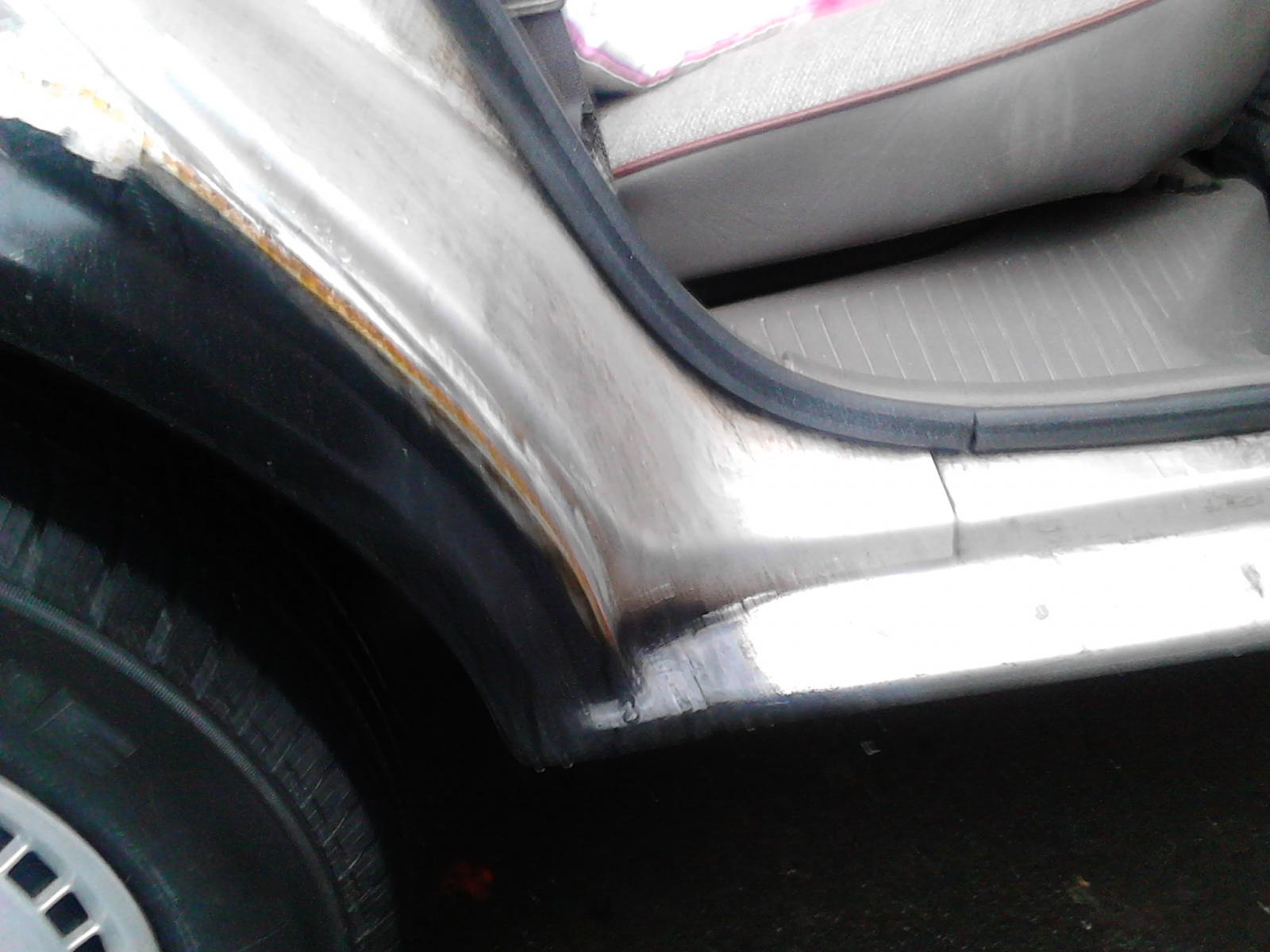

right not too bad of a job,lower inner wheelarch,sill was patched up as well,full of silver foil,than i had to cut out the wheelarch mig weld the panel in place,only wheelarch panels left are for plastic bumper models,ok they fit good,started raining,so had to quickly paint over with some jenolite,than i will paint over with aldis finest green metal paint,see pictures,just put blob on front wing,stop it moving,
found 5 holes on middle silencer,did a neat job on that aswell,big plate for 4 holed part,small plate on front part,try take pictures,sounds alot less sportier, :-D gave the underfloor a blast with schuzt underseal,painted w/arch,has started to rain again will sand down and try when dry,mig welding wire bought from amazon.cheap,..
 ,got some bosch h4 posh bulbs from amazon,90% brighter,side light bulbs\better than the yellow,wheelarch now painted in aldi finest metal paint,will be on the move soon...
