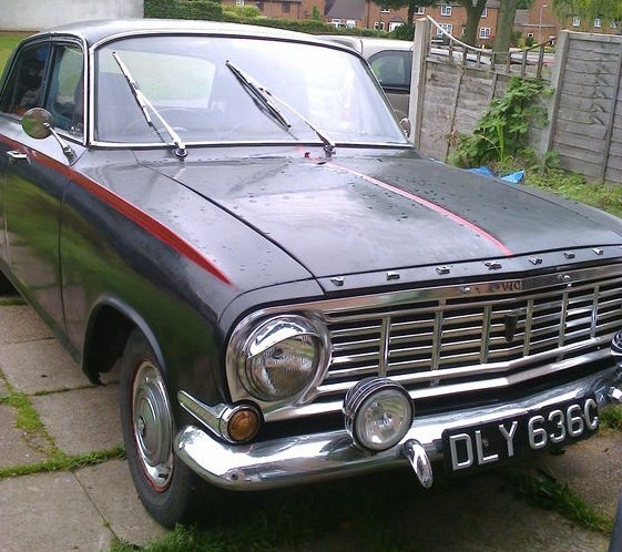

More front-end shiteness:
The VAUXHALL  letters on the bonnet were only fitted to 1500cc FBs, and these aren't even the right ones --- due to the angle at which they sit, they're probably off the back of a Chevette or something. I don't have a spare bonnet, so the holes will have to be welded and filled
Also, the factory painted black strips on the grille have been polished out, changing its appearance --- I will be reinstating them in due course
Oh, and the sidelight/indicator lenses have been painted amber, meaning the car has amber sidelights like US cars... I've obtained one clear lens from an autojumble, but may try stripping the amber paint off these with a solvent that doesn't harm plastic (Fairy Power Spray or similar)

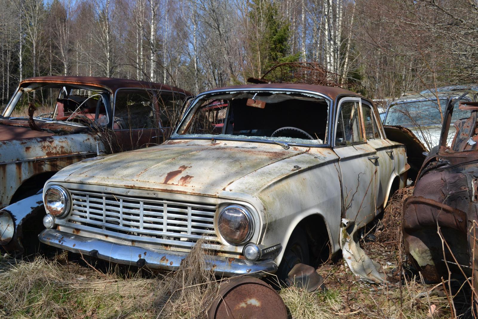

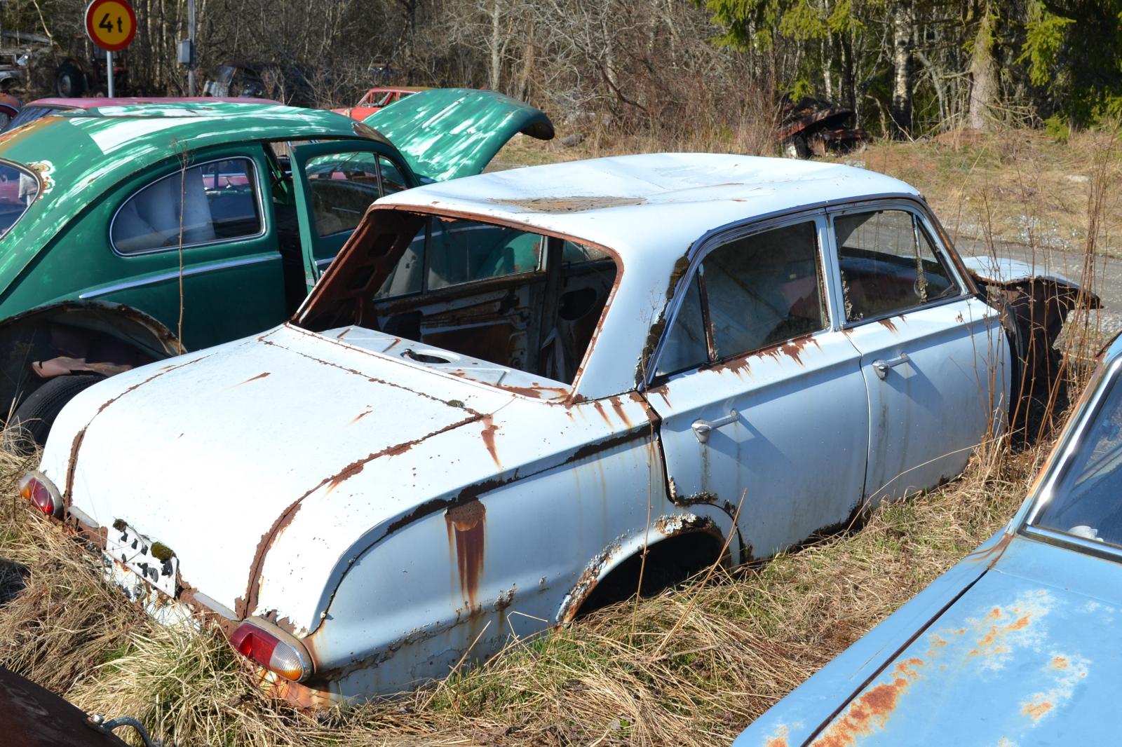

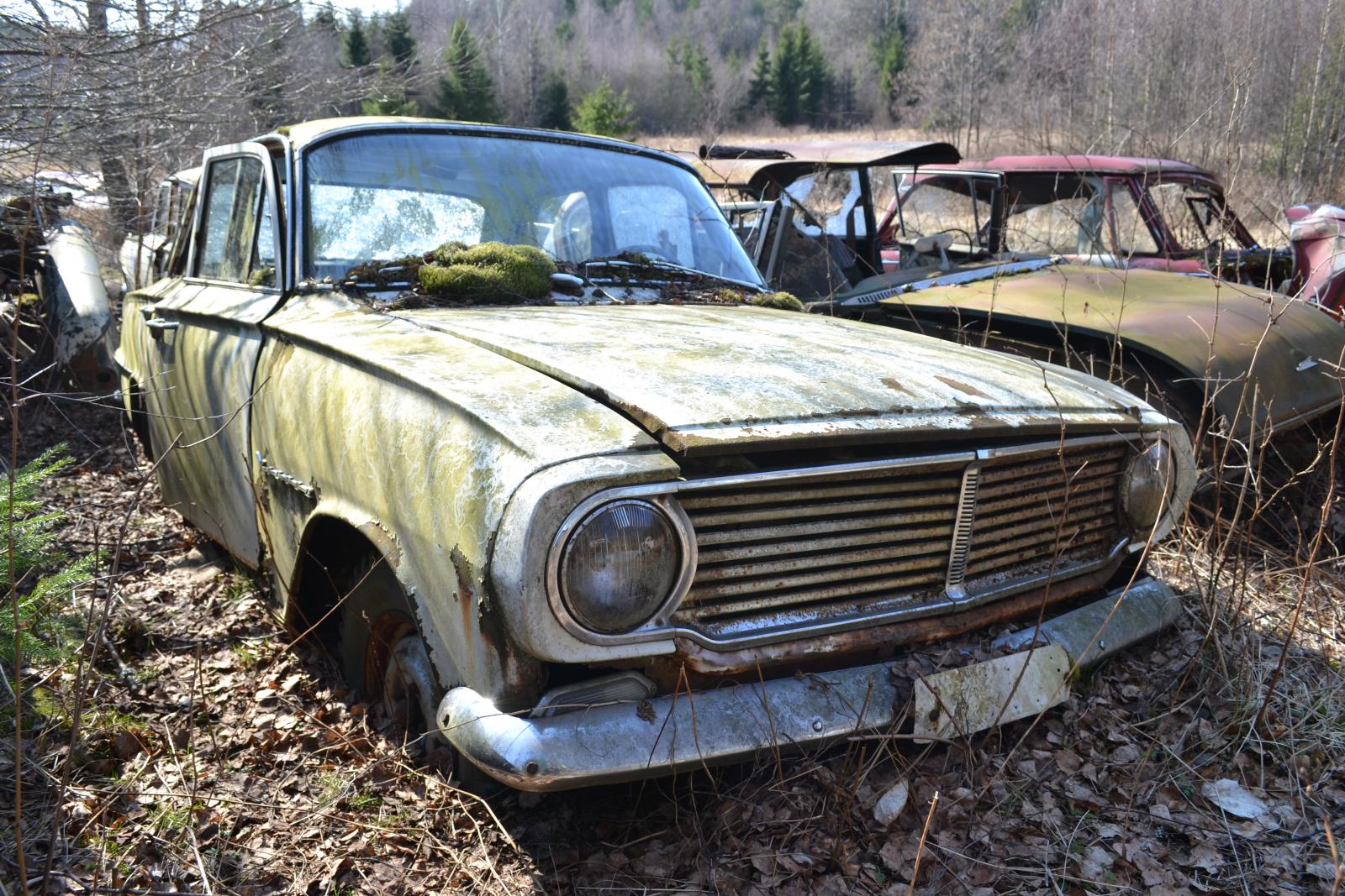

There's a load of these, at least six, up the car cemetery...if you need a new fuel filler flap or something. Bit of a trek mind!
Also one or two still knocking around. I think they sold quite well up this way

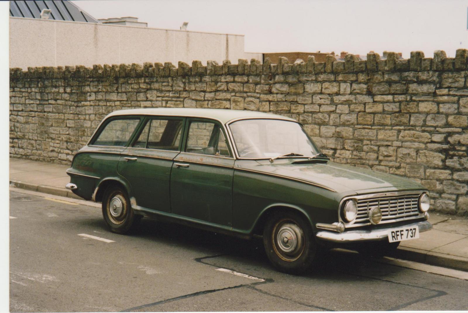

I knew I had a pic of my old one somewhere. I owned it either in the very late 1980s or early 1990s, I only bought it as it had a towbar fitted and I had nothing with a towbar at the time (I never towed with it). Bought it in Cornwall, drove it back to Barry in South Wales ran it around for a few months then realised I had no real use for it so sold it. A couple of years later it turned up in the cars rotting in a hedge bit of Classic Car Weekly.
It had already had the original registration robbed off it before I bought it and the paint was dreadful as it had been stored for years under a plastic sheet. Despite the reputation for Vauxhalls of this age to rot badly it was structurally sound.
There are or were at least two two-tone estates like this on the custom scene, with V8 engines --- this colour scheme seems to suit the estate particularly well

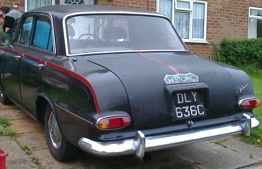

Rear end shite:
The "HISTORIC" sticker (home made!) was binned on my journey home when I bought the car... Unfortunately the chrome VAUXHALL badge above the number plate had been ruined by sanding, but I managed to find a NOS one online

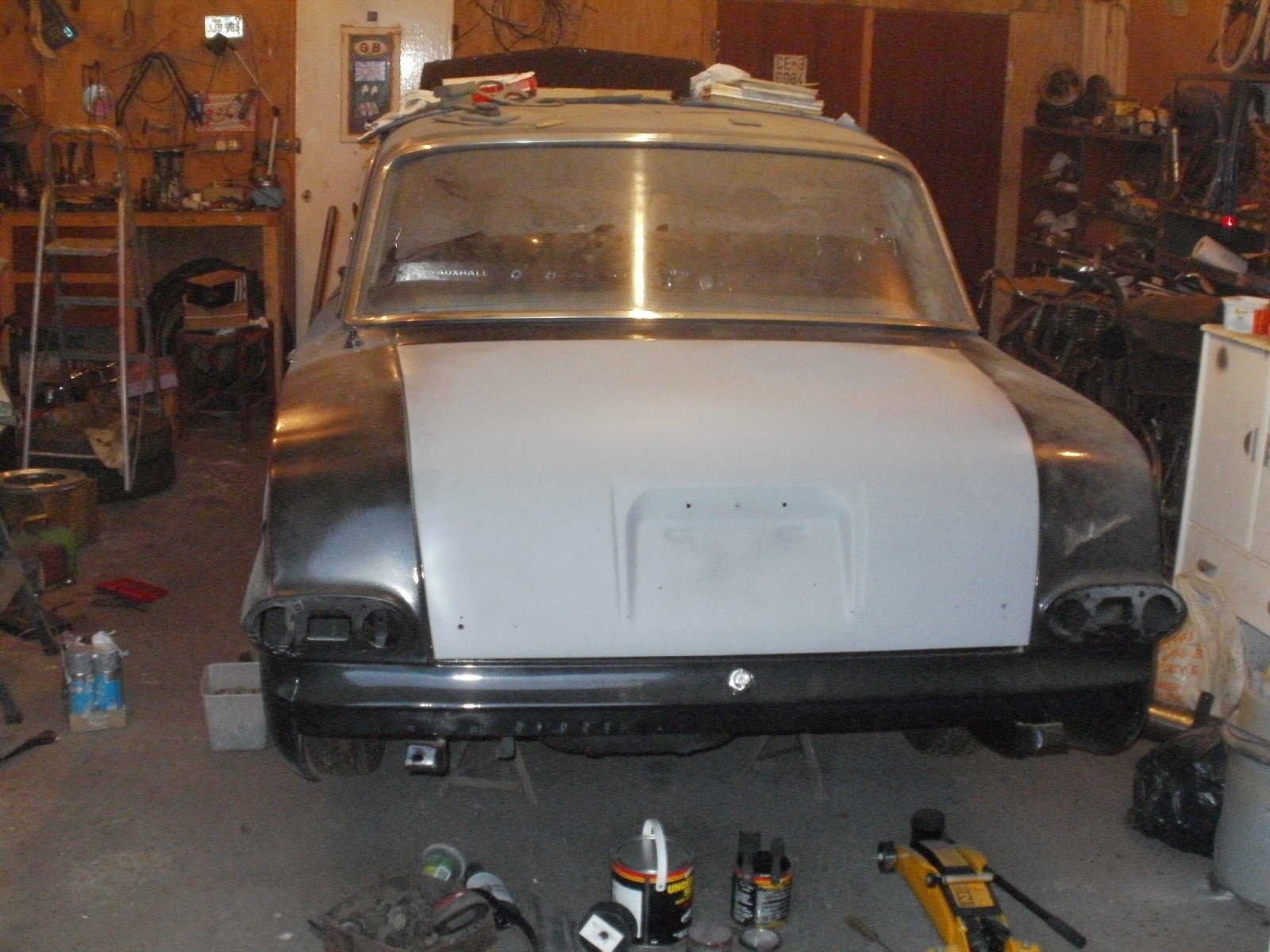

I've started to improve the paintwork at the arse end:
Bootlid stripped to bare metal (no welding needed, just a bit of careful derusting and a small amount of filler), etch primed ready for topcoat (will be keeping car black as inside the boot, under the bonnet and the door shuts were painted that colour and it would be an arse to strip and repaint them).
Not much progress for a while --- I tried to flat back the black and aerosol spray the panel underneath the bootlid and the one inbetween the lid and the rear window, but even after sanding back to original Vauxhall paint there was pickling and bubbling... So much for my "one panel at a time, on a shoestring" rolling restoration --- it needs to be done properly

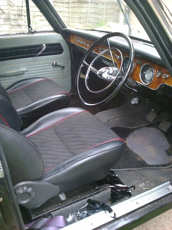

Interior shite: the black Victor had lost its original front seats when I bought it, but the slider frames had been welded onto some part-leather Mini Cooper seats:
They were actually quite comfortable, but they of course didn't match the rear seat (original but shagged-out green leather) so I put out feelers on another forum and was offered a front bench and rear seat in green vinyl from an FC Victor 101: the bench just about squeezes in between the door pillars, and luckily Vauxhall used the same spacing for the mountings on the FB and FC, so it bolted straight in. It's lower than the Mini seats, but I like it that way
The rear seat parts from the FC are wider than those of an FB, but I will be removing the covers from them and having them altered to fit my FB frames eventually. Luckily my original green door cards are in reasonable nick and almost match the FC seats in colour!
I sold the Mini seats on ebay, so got some of the money I spent on the FC seats back again
The 1600cc "facelift" FB Victors had a wooden dash panel on Deluxe models, but I don't think that suits the US-influenced lines of the car, so I've obtained an alloy dash panel from a standard/Super FB of the correct type --- 1500cc Victors had the switches etc. in slightly different positions. I'm also going to fit the silver-faced dials that go with the alloy dashes.   I do have TWO 1500 FB alloy dash panels for sale if anybody's interested
Visible in the picture are the welds on the replacement sills --- I'll tidy them up eventually, but they do seem to have been fitted carefully otherwise (I'm not sure what lies beneath them, though...), and although probably pattern panels don't look obvious when the doors are shut... Other than that, the car has had no welding as far as I'm aware (I need to check underneath the wings before returning the car to the road: a very vulnerable area which may have been plated in the past)
