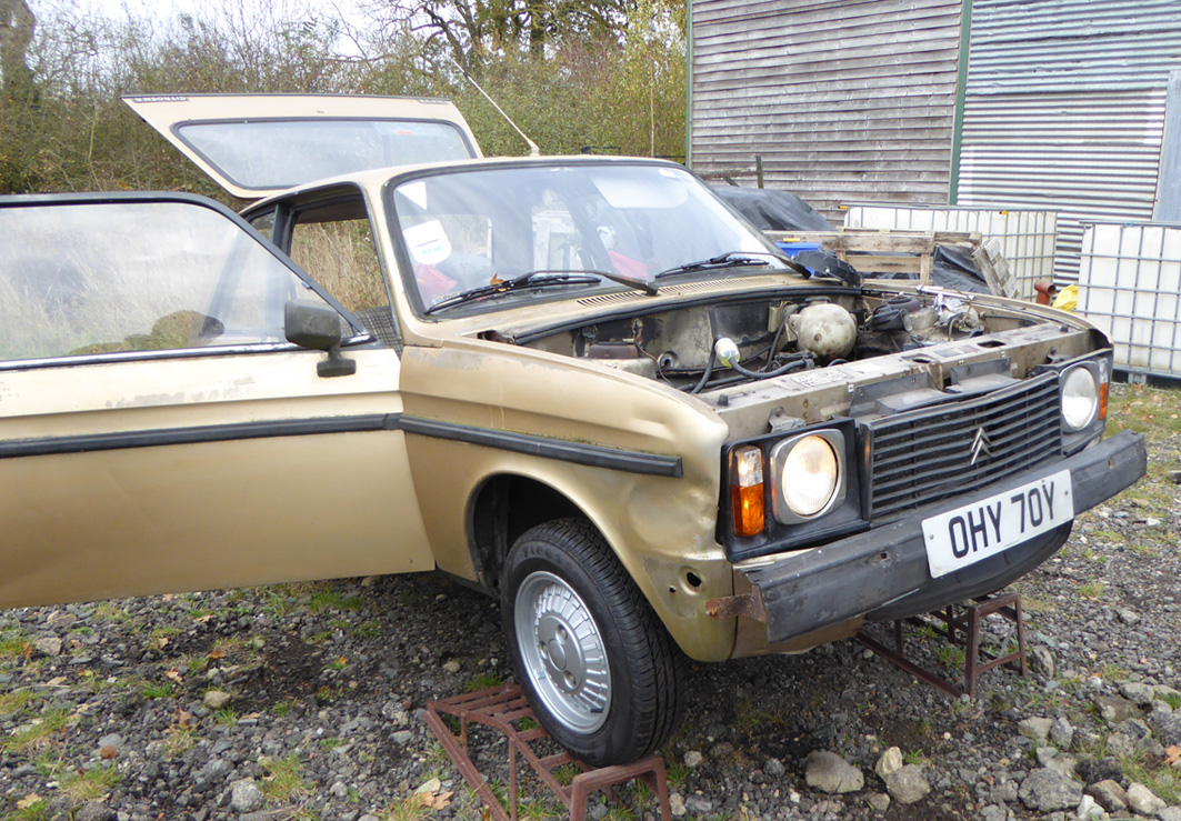

Please can I have some pictures of your dads LNA, is it on the road?.

When I said pictures I was thinking of the outside of the car, I did not expect you to have pictures of his carb.

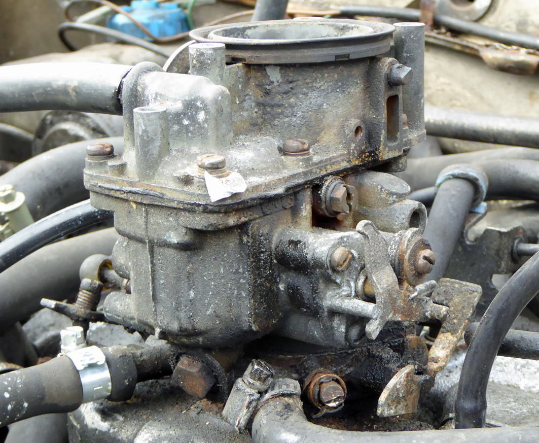

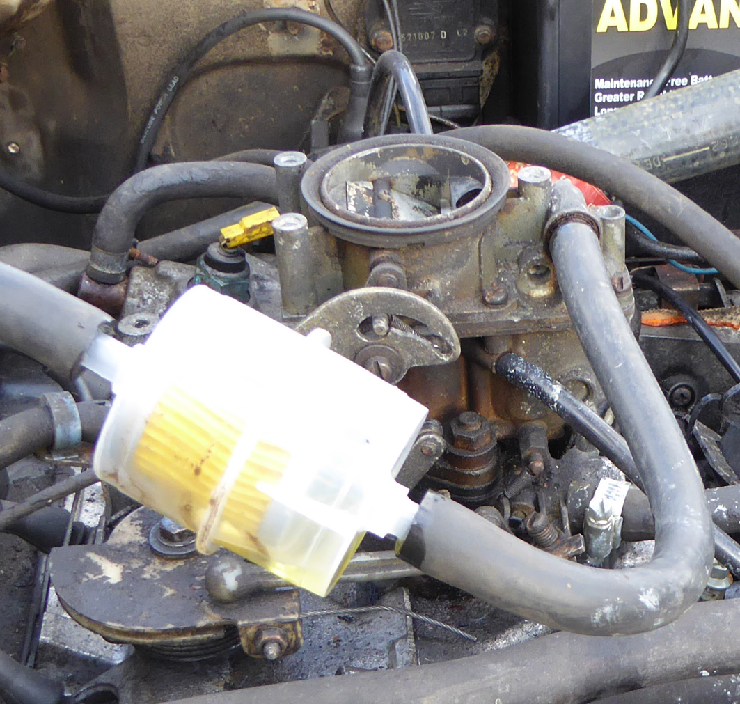

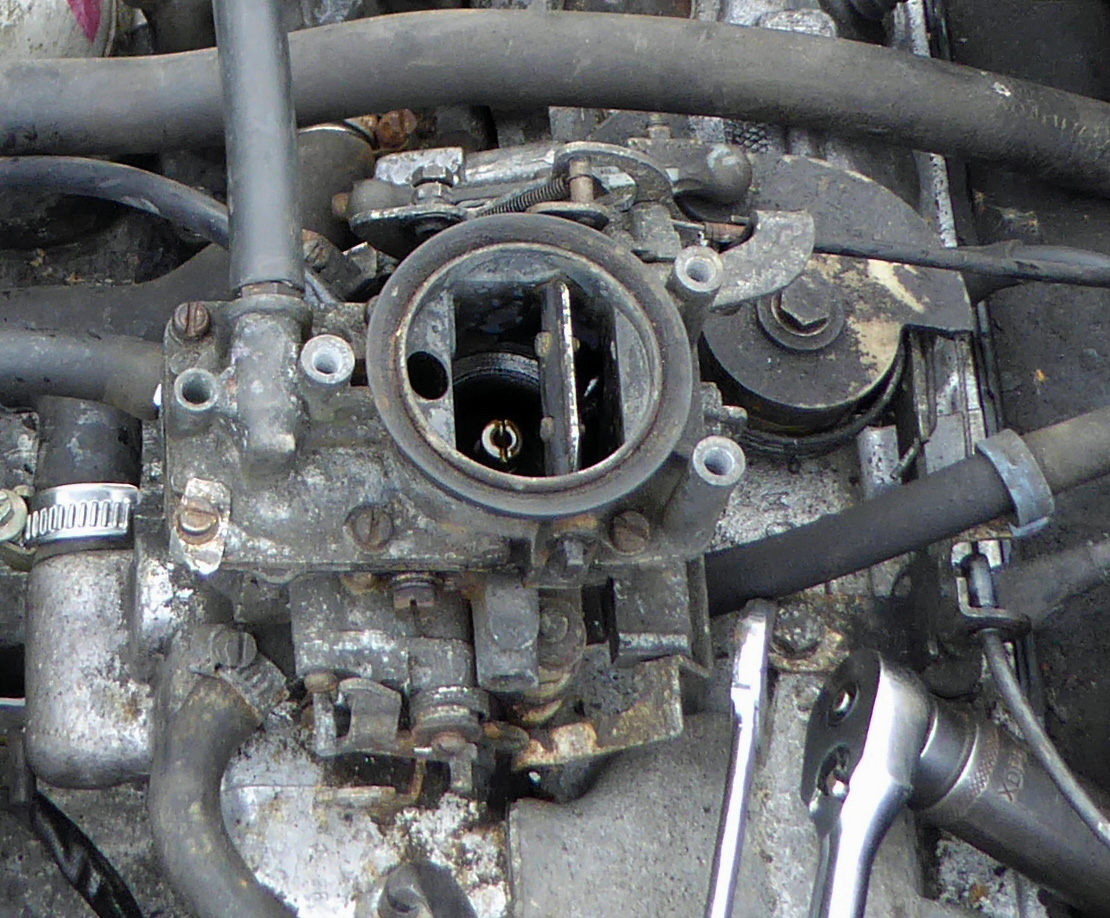

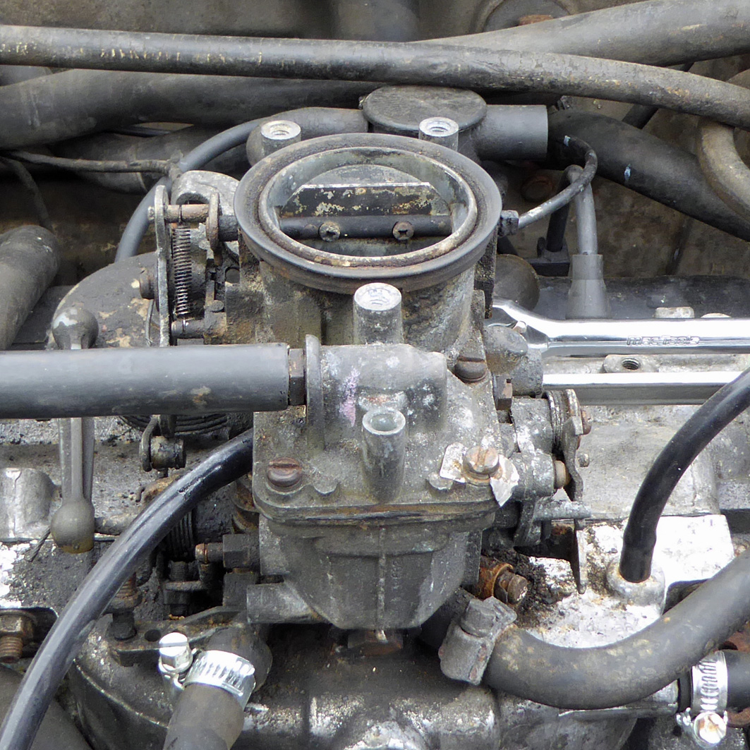

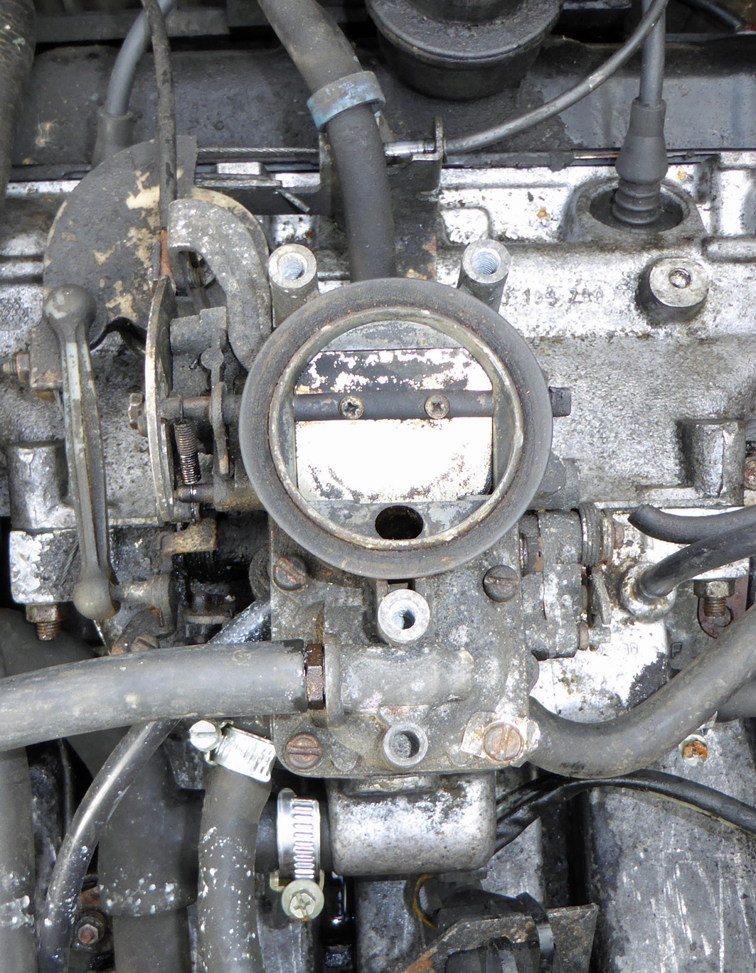

I would love to replace my carb especially with a new one, my only problem the tag is broken off mine and I don't know what the number is.
Ok, i will take some pictures tonight and send them over. Is there any way you can ID yours from a owners/workshop manual?
Tom
This is my carburettor.

I do have Visas, but this is for my 1983 Citroen LNA 11E Inca 1124cc.
