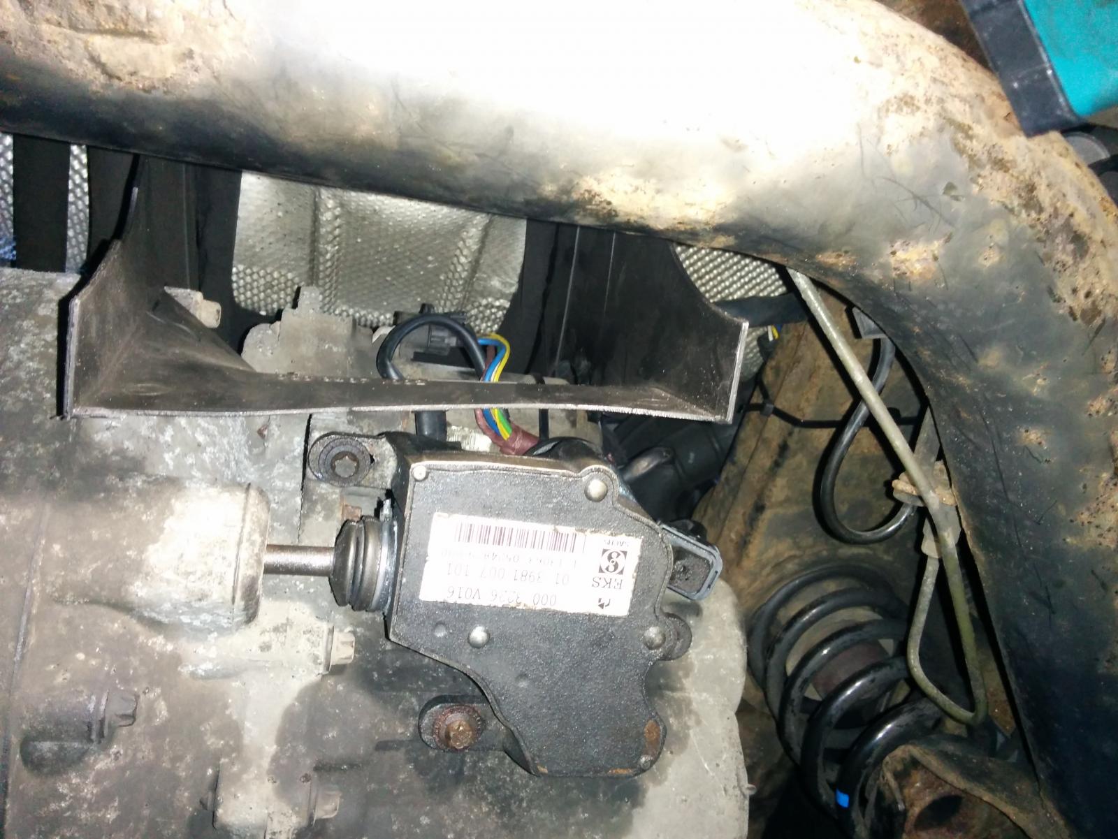

Firstly an oil change. I wish I warmed it up before I did this. Took 30minutes to suck the oil out because it was cold.
I then got on and stuck the car up on the ramps to remove and clean out the clutch acutator.
While removing the actuator I came across this big significant find ...
This is one of the wires to the gear shifting motor! It had rubbed through the plastic intercooler duct.
I chopped and resoldered the two halves back together.
Not the easiest job as the strands were heavily corroded. Sanded as much off as possible and used plenty of solder to get flux over it and finish cleaning the wire.
I rerouted the wires around the bottom of the duct, so they didn't chaff through again. I also zip tied the loom onto the shifter motor body to hopefully stop it wanting to rub elsewhere.
Finally got on and stripped the actuator apart. This is as much as you can remove. Lid is rivited on and not removable.
Gave it a really good spray with electrical cleaner to remove all the old crap inside (actually wasn't much) and then thoroughly sprayed it with white grease. Then put it all back together and strapped it back on the car.

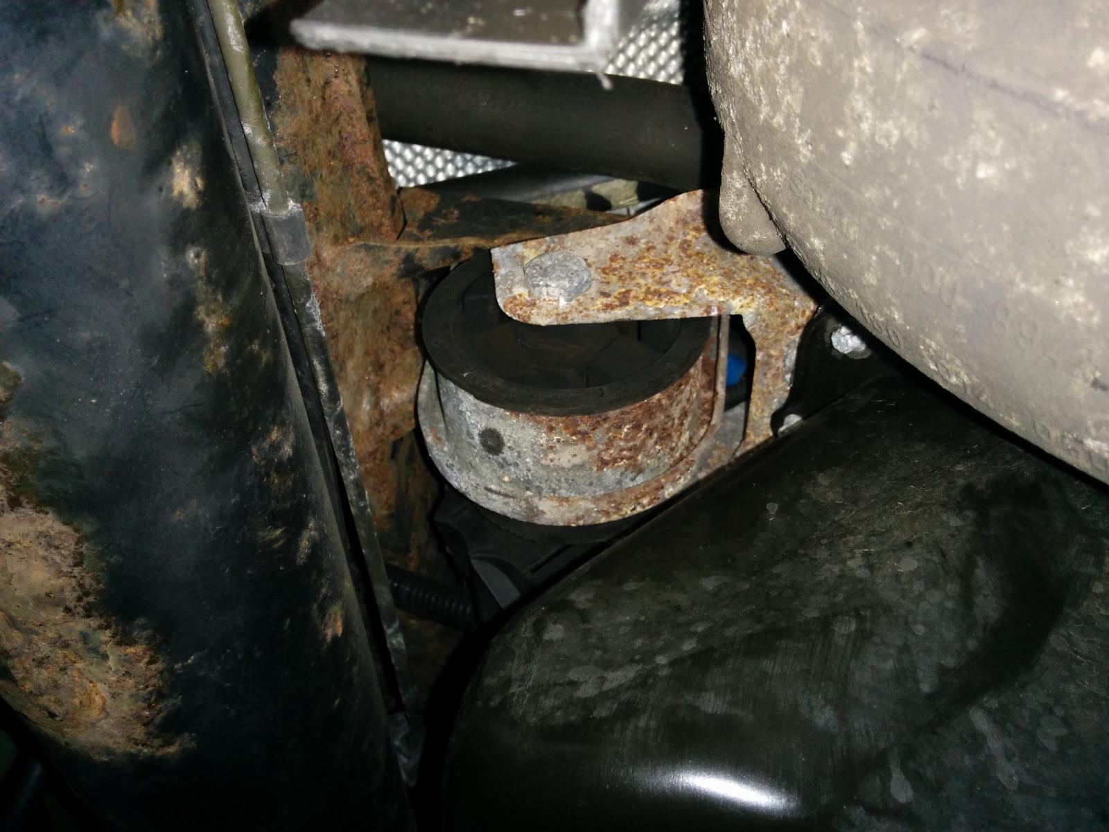

Then noticed the front Gearbox mount was looking a bit worse for wear...
Another job for the list!

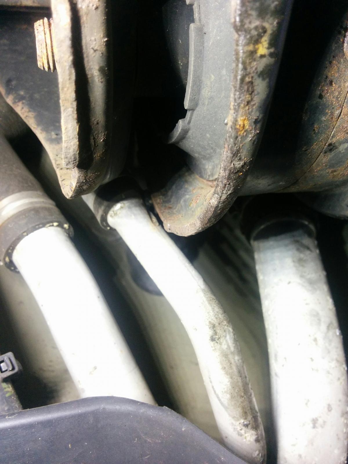

I know it's not a deal breaker if it works or not but also check the air con pipes for cracks while you have the car apart as the things crack for fun on the roadster and last for about 5 minutes normally.
Smart did make quite a few revisions on the plumbing but never really sorted the problem out.
On my friends car and most others these might as well of been a service item but I think myself it was the cars that got thrashed that broke them caused due to a bit of engine movement but if your anything like me I hate it when something is broken on a car.
I agree, I don't like buttons that don't work anymore! I can't see any of the usual cracked around the pipes to the compressor, so might be a very rare case of needing regassing. When I mentioned to the seller that the pipes don't look cracked and how the engine movement seems to do it, he did say maybe it was thanks to his more laid back driving style. I reckon it might be a combination of driving style, bad gear changes from badly adjusted clutch actuators and worn engine mounts.

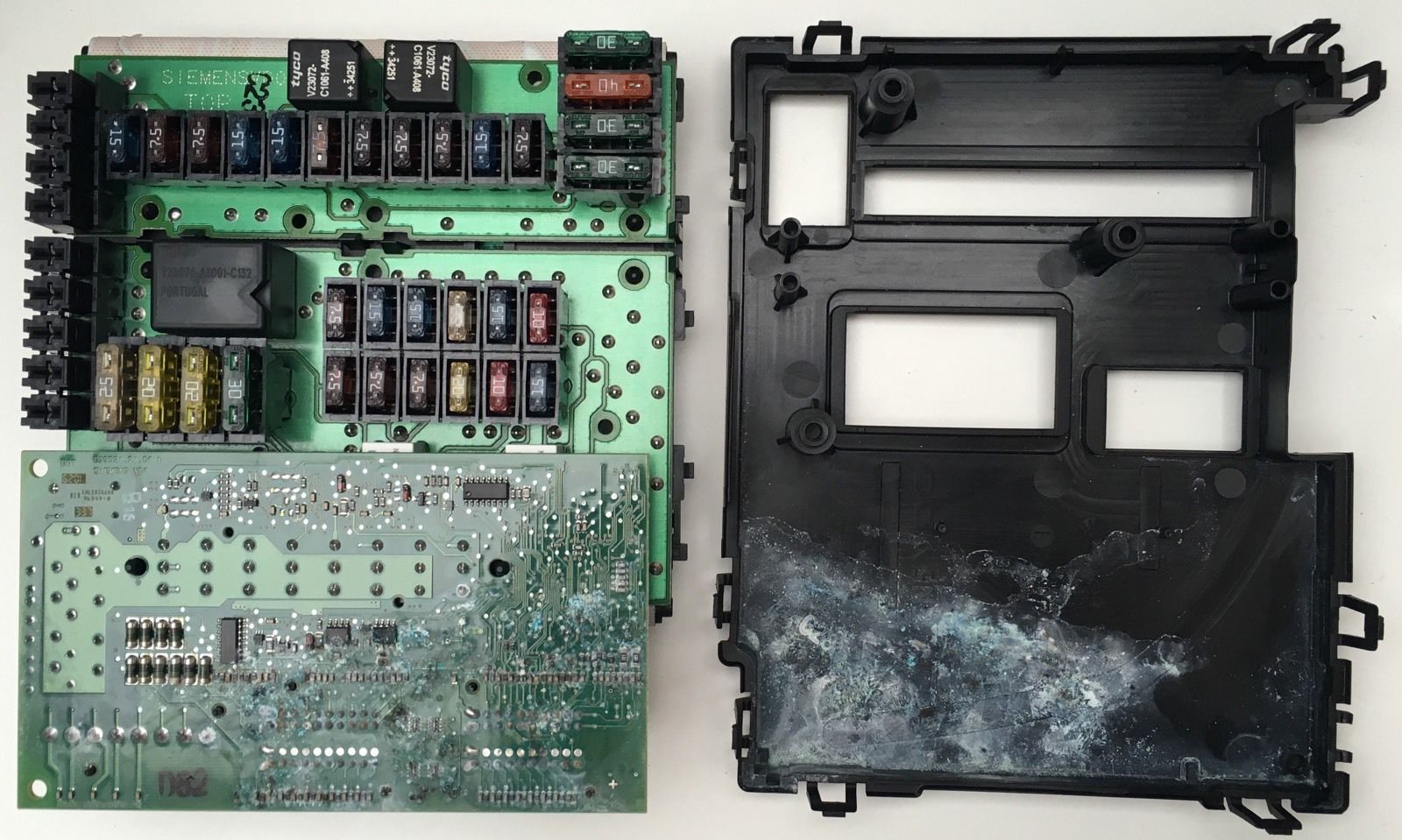

I reckon a lot of the bad rep is down to the badly fitted, inadequate seal they put on the tray below the wipers and above the body computer (SAM) out of the factory. Afaik if this is resealed properly then SAM failures are pretty much non existent. This is the large proportion of haywire on them.
A bit like the Laguna II and blocked sunroof drains soaking the body computer!

With the wet weather today, I've been fairly limited on what I can do. One of the biggest things I could check in the rain is...
Leaks! Many, many leaks. More leaks than a sieve. These are just a few highlights. The floor and foam underneath is sodden wet. I really need a dry day that I can pull it all out and give it a really good dry. I was hoping that I could start fixing the leaks today, but rain stopped me getting any further with leak repair.
Speaking of leaks, there is one thing that all Roadster owners fear more than leaks ... leaks onto the SAM (body computer).
This thing that lives under the steering wheel:
According to the seller, Mercedes declared this as faulty. Despite it not having any problem. Anyway, I thought I better pull it apart to check for corrosion:
Looks good to me! What does one that has been water damaged?
Definitely nothing like that. Admittedly that's a very bad case, but I can't see any damage on mine at all.
This is really good thing! As a replacement from Mercedes is around the £700 mark. Even a second-hand unit is a good £150-200. Also shows why you have to be careful when you let a dealer mechanic diagnose your car. It looks likes someone has been at the SAM before too, as a mounting screw was missing from the SAM and the side plastic mountings were missing all their trim tabs.
