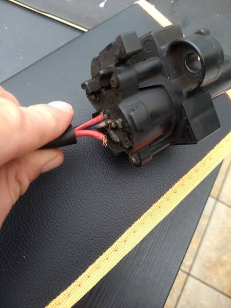

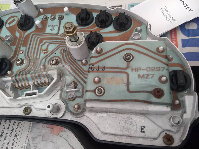

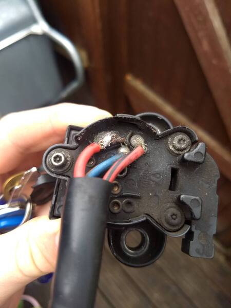

LostnotFound Posted July 23, 2019 Author Posted July 23, 2019 Back to proper stuff as the RAV4 is currently sitting there awaiting another bit of tinkering but nothing vital at the moment. Onto the VFR. Details of some of the issues and vain attempts at fixing it are below on the moribund ask a shiter section https://autoshite.com/topic/35603-automotive-electrics-for-dummies-help-please/ After ignoring advice based on hoping I hadn't been sold rubbish second hand parts it turns out Dave was correct and it was the clocks that are were the main problem. They suffer from two issues, one is the plastic mounting lugs snap when they are removed which limits the number of second hand ones knocking about. The second is the tracks on the flexible PCB degrade. I'd had no luck trying to rejoin them on the first set I have, so this time around I got more technical. I had had thoughts of soldering a jumper wire over the obviously knackered bit, however as there wasn't much space and the track was completely gone I went for the following option instead. One branch is held down under a washer, the other by the connection on the bulb. I now have back lighting and more importantly the full beam warning works as it should. The right indicator warning light flashes as it should, the left one doesn't. Google suggests that's only an advisory so I can now book an MOT and see if I can get another 12 months to get the rest of it back in some sort of presentable shape. In the medium term I am tempted by an Ebay special replacement dash to solve the issues once and for all. djim 1
LostnotFound Posted June 21, 2020 Author Posted June 21, 2020 I realise that I never update my thread so as I had a FTP thought it was time. Well the above fix held with a bit of modification to make it more permanent. So any need for a universal dash can be put back, probably until the same time as the remenenats of the fairing gives up and I have to try and fit aftermarket ones from a different bike.... So back to the FTP(ish) I might have over sold it. Headed out for a ride, nice shiny ex hairnet satnav mounted ready to point my way to adventure. Filled up at the local pay at pump, started up straightened the bars, and it cut out. Started again cut out as I tried to turn, noticed it was the whole dash bar the clock, bollox. Paddled over to a space and proceeded to wiggle the wire to see if there was a way to tape them that would at least get me back. A quick bit of wiggling and one of the wires came out the bottom of the ignition barrel. Well at least it's was obvious and was going to save me time over trying to chase a dodgy ground etc.... I managed to tape it back into the bottom of the switch which kept the power on as long as I didn't turn the bars far. A tad interesting as a ride back but beat pushing it for a mile. I love a faired bike when riding it whenever a bit cooler or raining and can't imagine putting up with a naked bike. Then whenever I have to take the nose sections off to get to any of it, I swear I'll never own a faired bike again. It's like trying to shove someones intestines in while you stitch them back up trying to get all the bits in and stuff lined up while you screw it on. Anyway I digress. Here is some shit soldering, everything now works as expected through the full range of motion, I just need some time to take it out for a run to check. Craig the Princess, Tickman, tobyd and 3 others 6

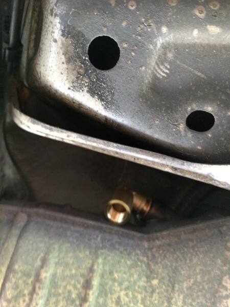

LostnotFound Posted February 25, 2021 Author Posted February 25, 2021 So, having gone almost a year without a 4 wheeled conveyance of my own I couldn't risk that ticking over to a full year and my Autoshite membership being revoked. The end of lockdown and the little one going up to 5 days at pre school meant a second car for the household was needed* as something to just trundle up and down to the local village an Aygo / C1 was the obvious choice. So when James put his C70 Convertible up in the for sale section it made perfect sense, who doesn't buy a 2.4 litre turbo drop top as a run around? A quick insurance quote showed it'd be less than a score more per year to insure and 300 quid a year in tax extra to drive something that you actually want to easily passes the man maths value for money test.... It only has a couple of niggles that were known issues when I picked it up. The first one of which has put its hand up and waved at me so I thought I'd better update this thread. The EML stayed off happily for a few weeks, but popped on, after pulling over to put up the roof as it'd started drizzling. I'm sure it was the cars way of scolding me for allowing a couple of drops of water to reach its seats. @Craig the Princess very kindly posted my codereader across having left it with him before lockdown, so this morning I chucked it on to check the code. as @juular had predicited it was... Firstly how swish is it to have a OBD socket in the arm rest, there's plenty of other chod that could learn from this rather than forcing you to crawl around while digging under the dash. If you're going to have the temerity to throw faults up at least let people read them in comfort. The expected low cat efficiency thingy. Which is good, at least it hadn't thrown any extras in for a laugh. Given everything James has done to try and cure it, I'm going to go down the o2 sensor spacer route. I'll stick a question in ask a shiter to see if anyone has done it before and has a recommended source. Craig the Princess, BeEP, jamescarruthers and 2 others 5
rainagain Posted February 25, 2021 Posted February 25, 2021 I fitted a decat pipe to a Punto I had a few years back. I used a right angle spacer for the post cat sensor and this kept the eml from coming on. Here’s a pic showing what it looked like LostnotFound 1
jamescarruthers Posted March 22, 2021 Posted March 22, 2021 On 2/25/2021 at 9:53 PM, LostnotFound said: So, having gone almost a year without a 4 wheeled conveyance of my own I couldn't risk that ticking over to a full year and my Autoshite membership being revoked. The end of lockdown and the little one going up to 5 days at pre school meant a second car for the household was needed* as something to just trundle up and down to the local village an Aygo / C1 was the obvious choice. So when James put his C70 Convertible up in the for sale section it made perfect sense, who doesn't buy a 2.4 litre turbo drop top as a run around? A quick insurance quote showed it'd be less than a score more per year to insure and 300 quid a year in tax extra to drive something that you actually want to easily passes the man maths value for money test.... It only has a couple of niggles that were known issues when I picked it up. The first one of which has put its hand up and waved at me so I thought I'd better update this thread. The EML stayed off happily for a few weeks, but popped on, after pulling over to put up the roof as it'd started drizzling. I'm sure it was the cars way of scolding me for allowing a couple of drops of water to reach its seats. @Craig the Princess very kindly posted my codereader across having left it with him before lockdown, so this morning I chucked it on to check the code. as @juular had predicited it was... Firstly how swish is it to have a OBD socket in the arm rest, there's plenty of other chod that could learn from this rather than forcing you to crawl around while digging under the dash. If you're going to have the temerity to throw faults up at least let people read them in comfort. The expected low cat efficiency thingy. Which is good, at least it hadn't thrown any extras in for a laugh. Given everything James has done to try and cure it, I'm going to go down the o2 sensor spacer route. I'll stick a question in ask a shiter to see if anyone has done it before and has a recommended source. I always found IPD in the USA good for identifying parts and then maybe bying elsewhere like eBay! So, for your car, they have these two oxygen sensor spacers listed: https://www.ipdusa.com/products/8656/Oxygen-Sensor-Spacer-IPD-109553 (fixed) https://www.ipdusa.com/products/12093/Adjustable-Oxygen-Sensor-Spacer-IPD-125604 (adjustable) eBay seems to have quite a few listed so you should be in luck. I hope you are having some roof down fun as the spring arrives! LostnotFound 1
LostnotFound Posted May 18, 2021 Author Posted May 18, 2021 So I did finally find a dry time to visit my parents tame flat drive and make the most of being able to get a cuppa now lockdown is a dim and distant memory.. As above there are two options, a right angled one, and a straight spacer. It was a 50 / 50 shot so of course. you can almost see in that photo, you can't screw the angled one in as it fouls the cat when you turn it. On the upside, despite not budging at the first attempt, a quick spray of Halfords 'shock and unlock' (other snake oil loosners are available and probably better) and the sensor came out, so when I get the new spacer I know it'll be relatively straight forward to fit as I only put it back in finger tight. I did use a o2 socket to get it off, which if anyone in the future does read this and is thinking of being tight, was well worth the investment. The only other niggle it's developed is the trigger button on the shifter is sticky and needs wiggling to come out when you put it in park. It's not a major issue at the moment but I need to sort it before it does completely stop working.
