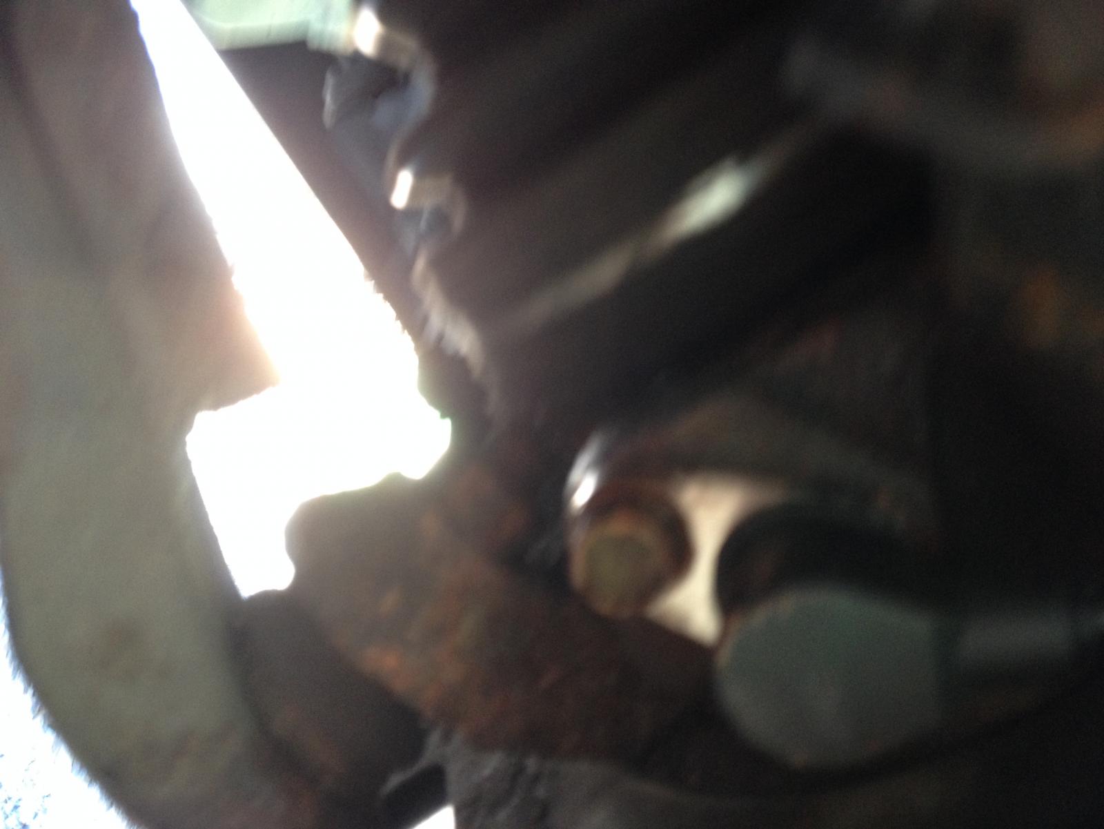

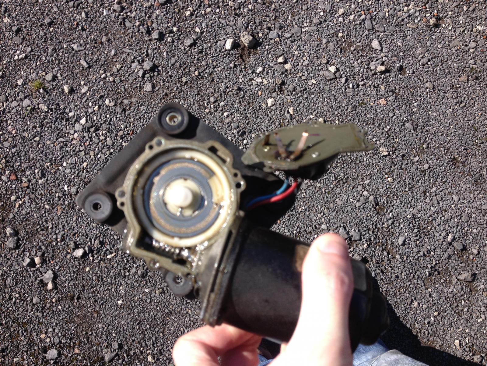

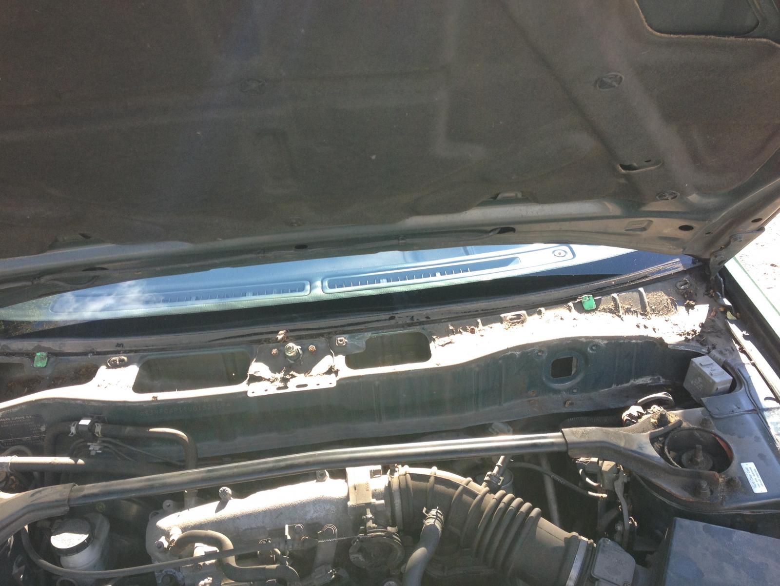

jonathan_dyane Posted October 2, 2016 Posted October 2, 2016 I am rather surprised to find that I seem to have become a massive Primera fan and I still can't believe what a well kept secret they are. I've driven a lot of cars and the balance of performance, handling economy and space that the Primera gives is nothing short of remarkable. With uncharacteristic enthusiasm I have found myself embarking on an improvement programme which I will do my best to detail below. Today's work: 1) The doors. I'm glad to say that being a London car seems to have preserved the underbody relatively well, it has unfortunately resulted in loads of dents. I managed to get a decent back door and tailgate and I have got the side door on. See photo 1. Unfortunately it isn't quite the right colour but it's close enough for me. 2) Wipers. Two main faults; inoperative self parking/intermittent wipe and what is apparently the scourge of Primera P11 wipers knackered spindles. One isn't two bad but the other was well fucked. Basically mild steel axles run in a nylon block and gradually chew through it. Happily I managed to find a piece of copper pipe on the road which as luck would have it was a good fit on the axle and I was able to drill out the nylon a bit more and tap the copper sleeve in. It's not 100% but it's a great improvement. In terms of the lack of parking I had read on the Primera owners club that this can be cured by drilling out some rivets to remove the endplate of the wiper motor and cleaning up the contact plate, bending out the contacts a tad and lightly regreasing. It only flipping worked! 3) ABS light on. I traced this to an open circuit drivers side front abs sensor. Curiously the last MOT had an advisory for frayed ABS wiring however this was not present; in fact the wiring is very neatly routed. I suspect that they put the advisory on to try to cover themselves for passing it with the ABS light on. Remarkably I found new pattern sensors on ebay for ITRO £20 and set about removing the old one. Of course it was seized solid and after some 'persuasion' the end snapped off flush. In the end I drilled a load of holes around the edge of it and managed to prise it out. New sensor in place (with copperslip) and no ABS light pshome, AMC Rebel, The Moog and 3 others 6

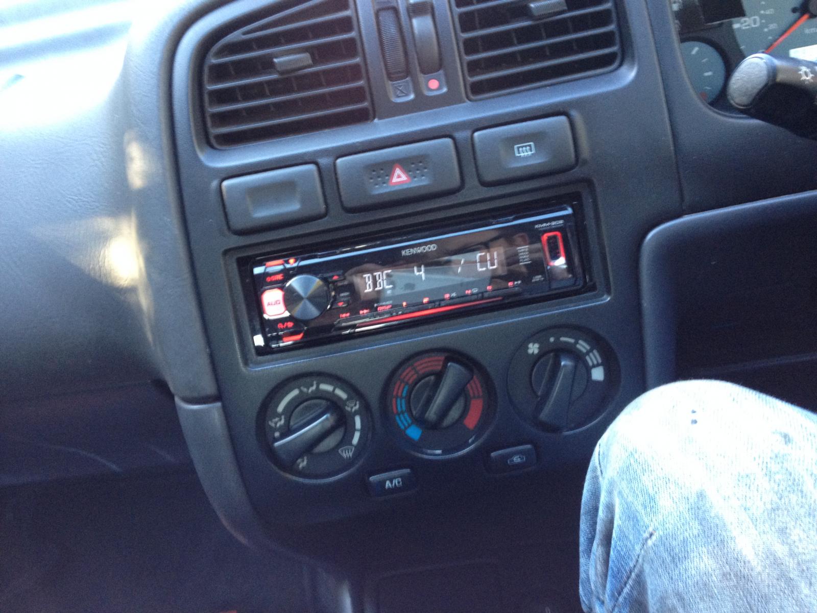

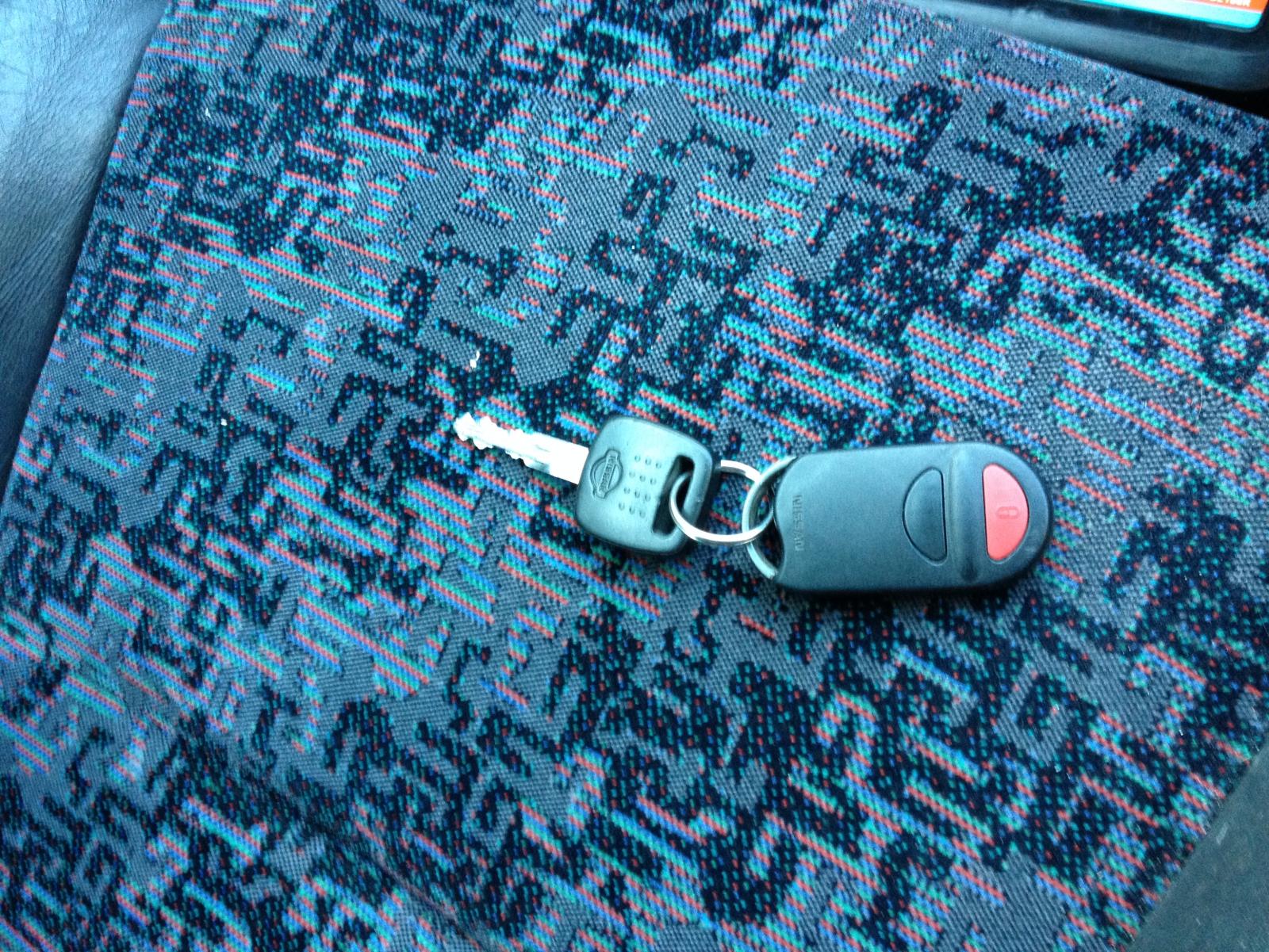

jonathan_dyane Posted October 2, 2016 Author Posted October 2, 2016 Sorry for shit photos; will try better next time. Below see photos of new radio which was about £50 off Amazon which is deckless and runs Ipod/Iphone and I would recommend and also plip. The car didn't have one but I was glad to find that you can work out what frequency your receiver is and programme in a suitable secondhand fob. Works great so far Lacquer Peel, Richard, wuvvum and 1 other 4

Noel Tidybeard Posted October 2, 2016 Posted October 2, 2016 if you can find some you want p10 wiper spindles which are metel instead of cheese plastic these also have a learning ecu so if its a little "sluggish" just give it a regular damned good spanking jonathan_dyane and tooSavvy 2

wuvvum Posted October 4, 2016 Posted October 4, 2016 these also have a learning ecu so if its a little "sluggish" just give it a regular damned good spankingBoth I and its previous two owners drove it quite enthusiastically, so it shouldn't be too bad... jonathan_dyane 1
