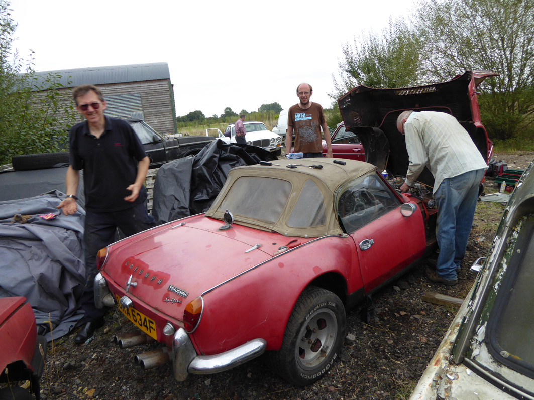

chaseracer Posted September 18, 2016 Posted September 18, 2016 1975 called - it wants its VW Beetle tail lights back from the 'custom' Spitty... Looks like much fun was had!
Dick Cheeseburger Posted September 18, 2016 Posted September 18, 2016 Looks like fun. Intrigued by the Spitfire - is it a two litre GT6 lump then? Six-cylinder 1
chodweaver Posted September 18, 2016 Posted September 18, 2016 Looks like fun. Intrigued by the Spitfire - is it a two litre GT6 lump then?No! It has already been subjected to upgradings! A 2.5 StanParts engine is resident, promising much wheelspinning fun once it has coolant and a clean tank... Sent from my GT-S5830i using Tapatalk 2 Dick Cheeseburger 1
Six-cylinder Posted September 18, 2016 Author Posted September 18, 2016 1975 called - it wants its VW Beetle tail lights back from the 'custom' Spitty... Looks like much fun was had! We wondered what they were from.
Six-cylinder Posted September 18, 2016 Author Posted September 18, 2016 Looks like fun. Intrigued by the Spitfire - is it a two litre GT6 lump then? Triumph 2500TC saloon. Dick Cheeseburger 1

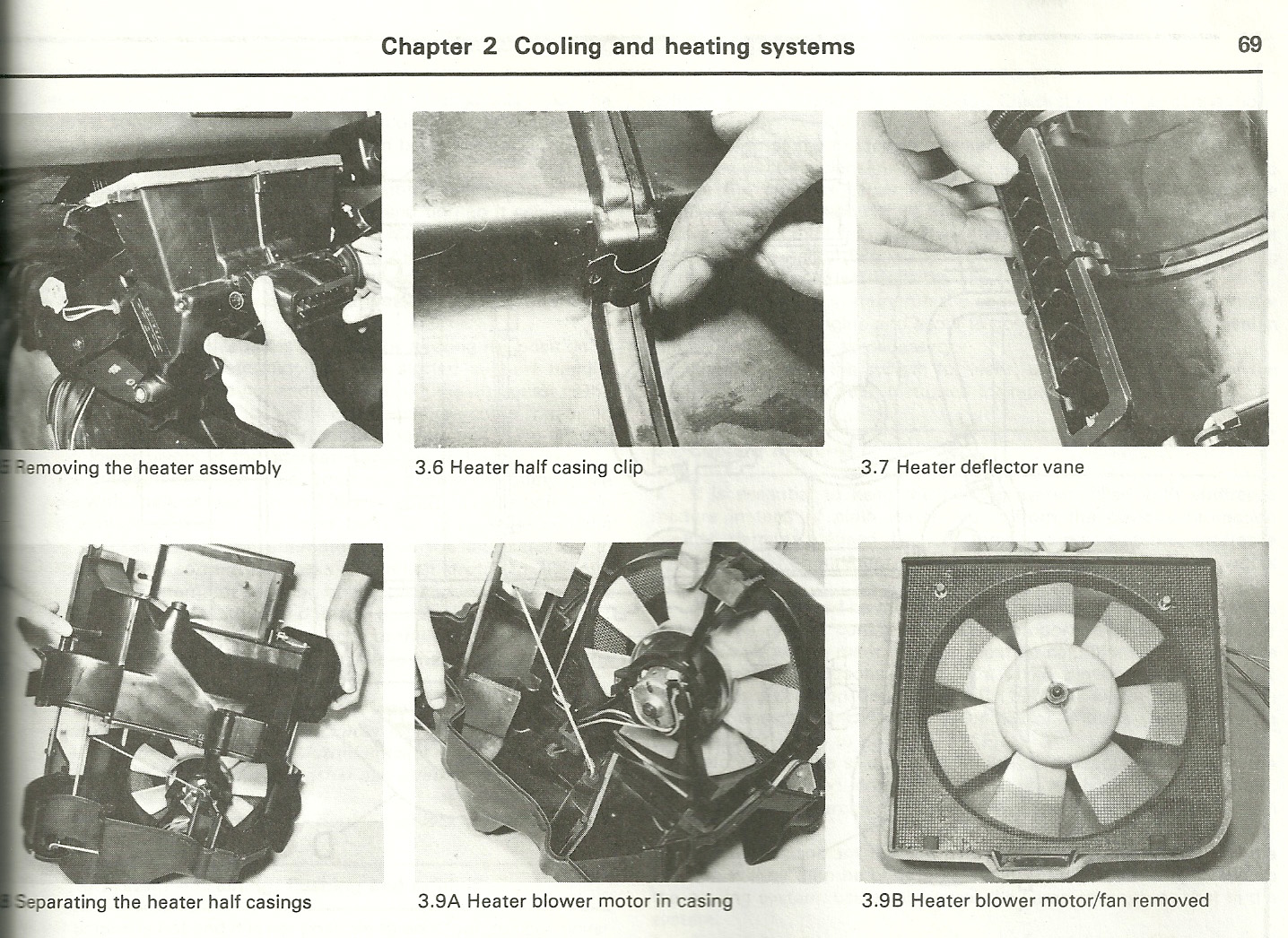

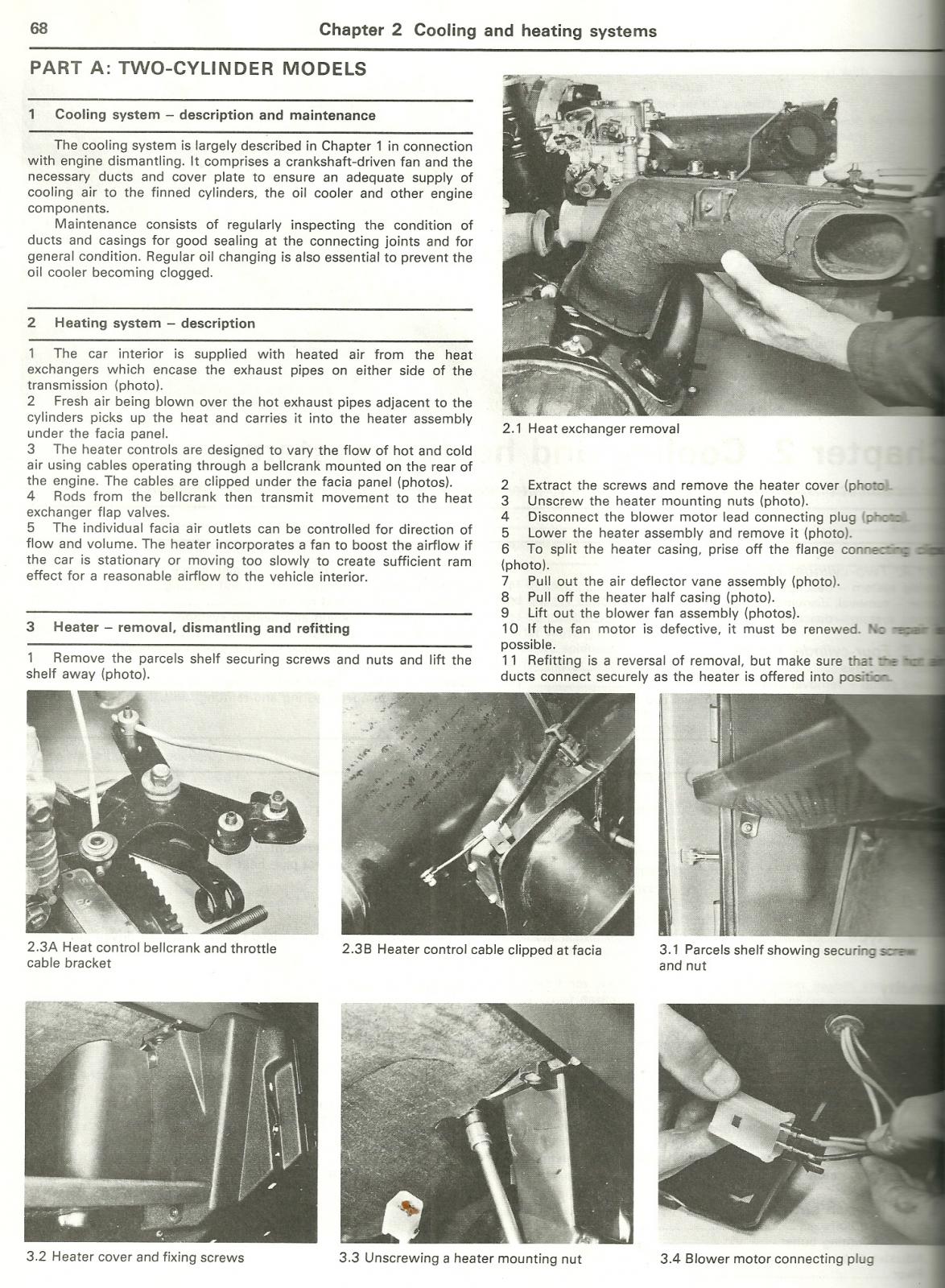

Six-cylinder Posted September 18, 2016 Author Posted September 18, 2016 I've spent a bit of today looking up heater controls for visas. As yet no luck in finding out anything useful. But I will keep searching! The hand book says, top slider cold air control. bottom slider hot air control. richardmorris 1
