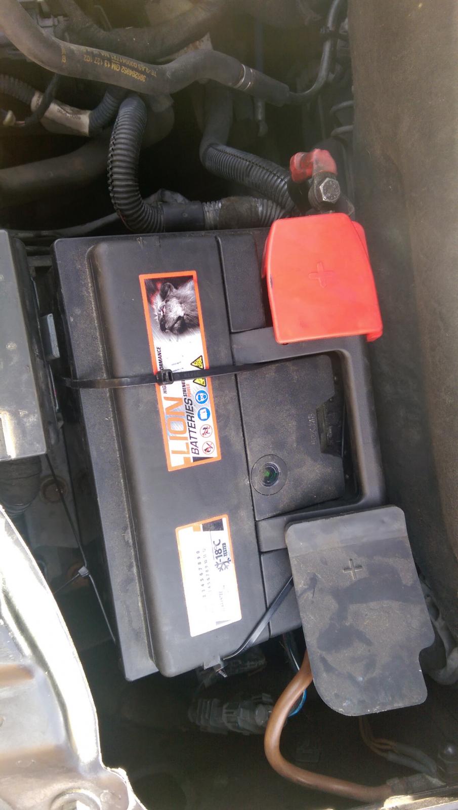

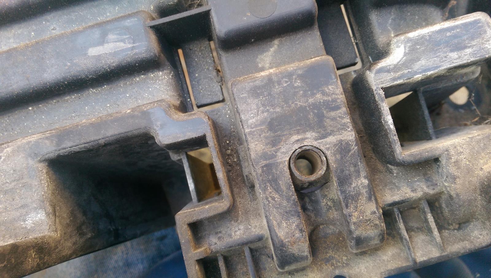

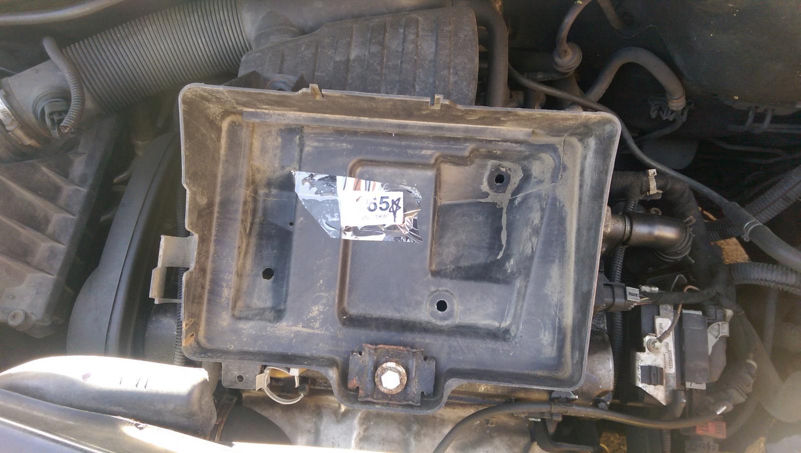

Ever since we've had it the battery securing clamp has been broken
So the other day I spent £12 on a new one FROM A MERIVA A ACCORDING TO THE LISTING...
However, it's totally fucking different
I'll try and work out if it's from a meriva B or another car entirely and complain, if there is more than one type of Meriva A battery tray then I've lost £12 and if anyone wants a battery tray shout up! So I had the old one out anyway to see what could be done
Immediatly apparent was the lack of thread in the captive nut thing
The bolt is fine though
So I wrapped some tape around it to see if that packed it out enough, and it didn't... so I cleaned the tray and underneath it up, and cabletied the battery to the bastard (MOT People, is this sufficient to not be a fail? shaking the battery shakes the car now...)

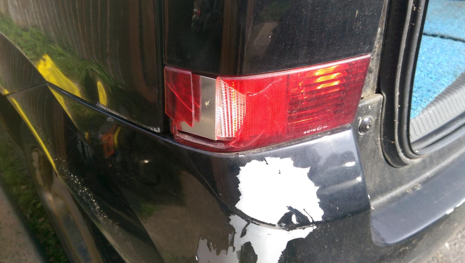

And lastly, to the rear of the car. About 8 months ago, she backed it into a bollard parking, and redecorated the rear corner
and knowing that even though it's a dummy lens for LHD models, it would probably be a fail for sharp edges or summat, so the very next week I bought a new one
and fitted it today!
The whole lot unscrews with 3 screws and unplugs
I washed and waxed under here when we first got it... needs doing again
Then the fog light bit unscrews from the main part
and done! No one will ever know

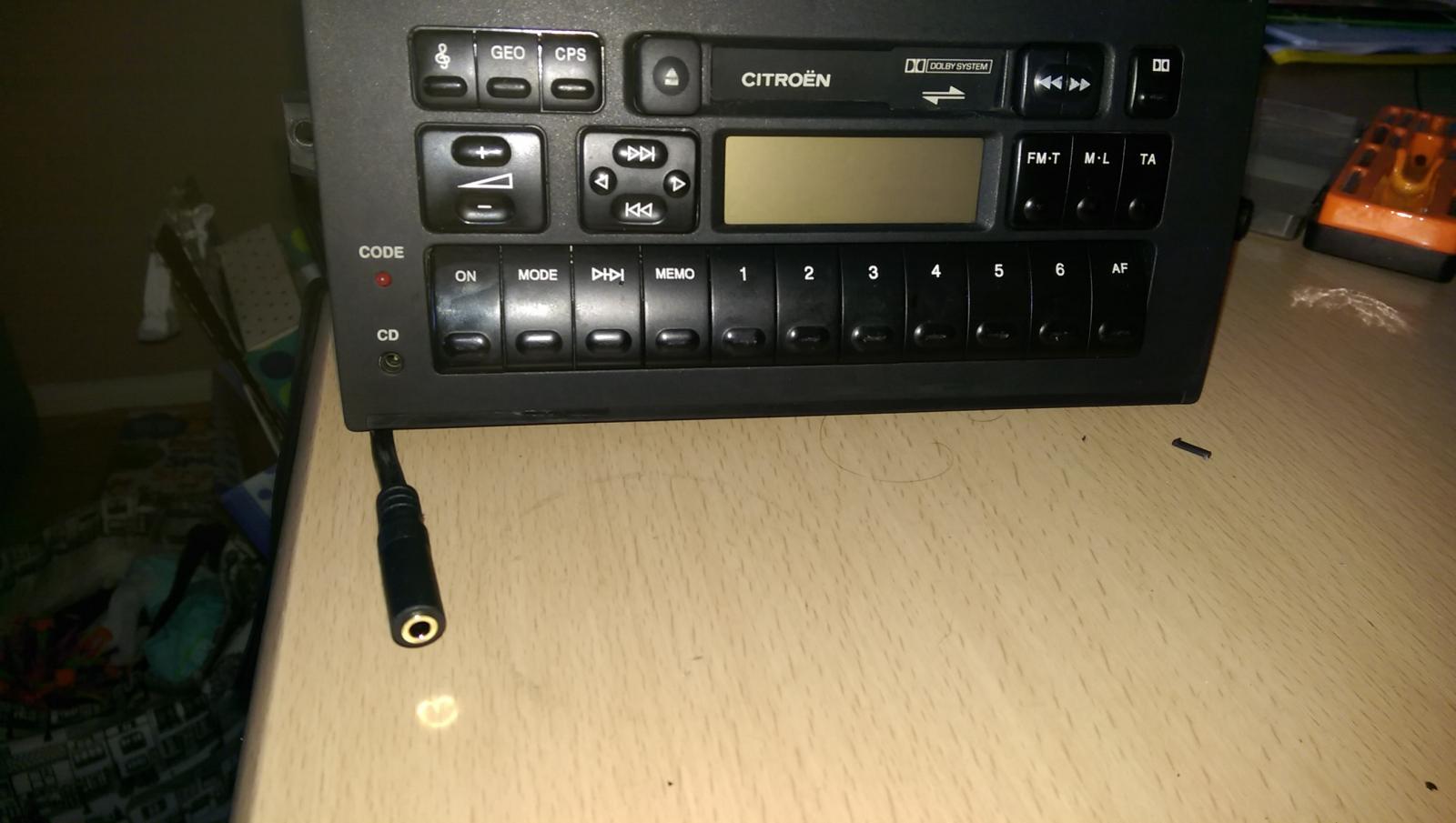

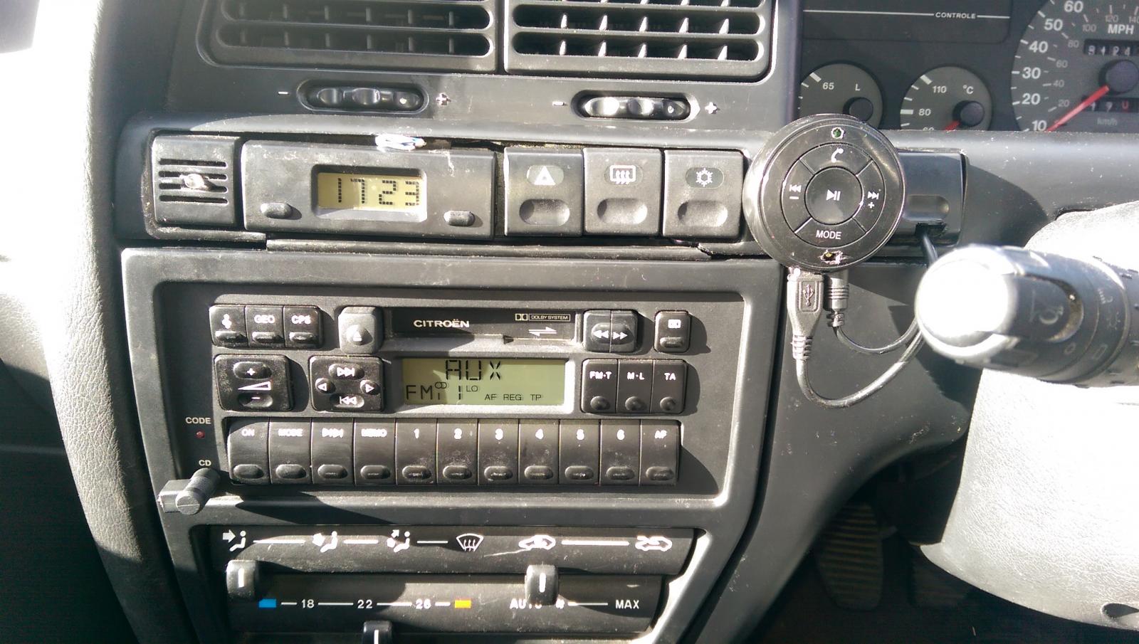

When I sold the ZX, I left the £30 aldi headunit in, as I couldnt be bothered to take it out. Plus, the tape deck in the xantia looks very nice, and I was excited about the steering wheel controls, until I found out they didn't work!
So for my birthday, I invested £20 in some high quality* audio kit, to bluetooth enable the tape player. It worked quite well, using the aux input. It's supposed to play media from a micro sd and usb drive too but I havent got that to work yet, the bt audio works very well though. Amy says the microphone is a bit quiet, but hearable, and I don't make many calls in the car, it's mainly to stream radio (and music when I get a bigger microSD for my phone) without having to have my phone tethered with an aux lead.
I fitted it properly today, after we went to the emergency services fete thing in town

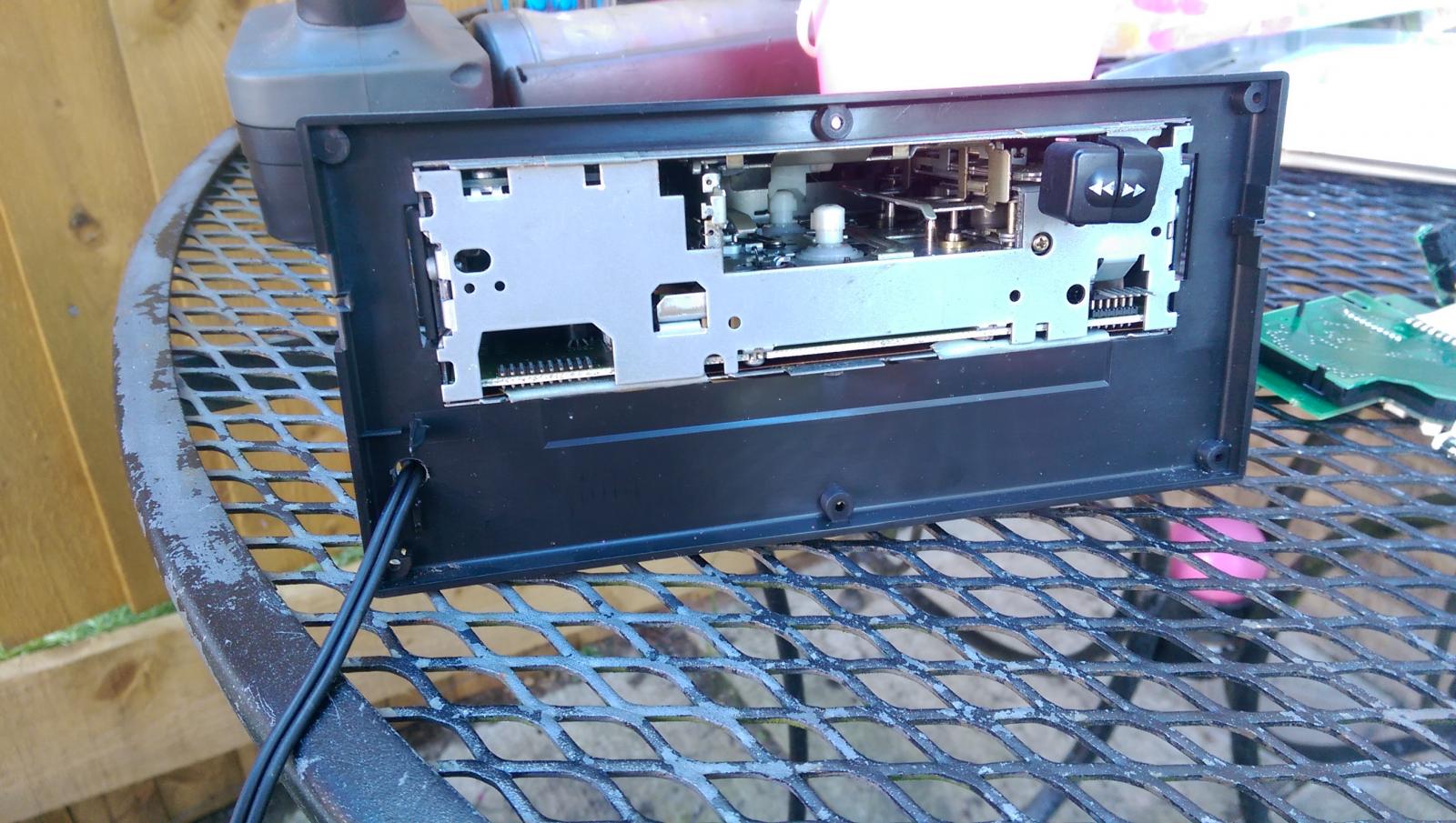

The first thing was to strip the radio down to access the aux input from the back. 6 screws and the whole front comes off, revealing all the tech. I'd bought an aux extender lead so I could unplug it to have the radio out for any reason, so I chopped the plug end off, and holding the wires to the terminals revealed what had to go where
and the white wire for the rh channel
A hole was made to pass the lead in from the back
and my best bird shit soldering made the connections permanant
The boards were put back together, feeding the wires through where they needed to go
Some of the bulbs don't work on the radio, and I can't do much with them so I melted the solder a bit on their connections incase it made them work again (havent tested it yet, it's not dark enough...)
radio back together

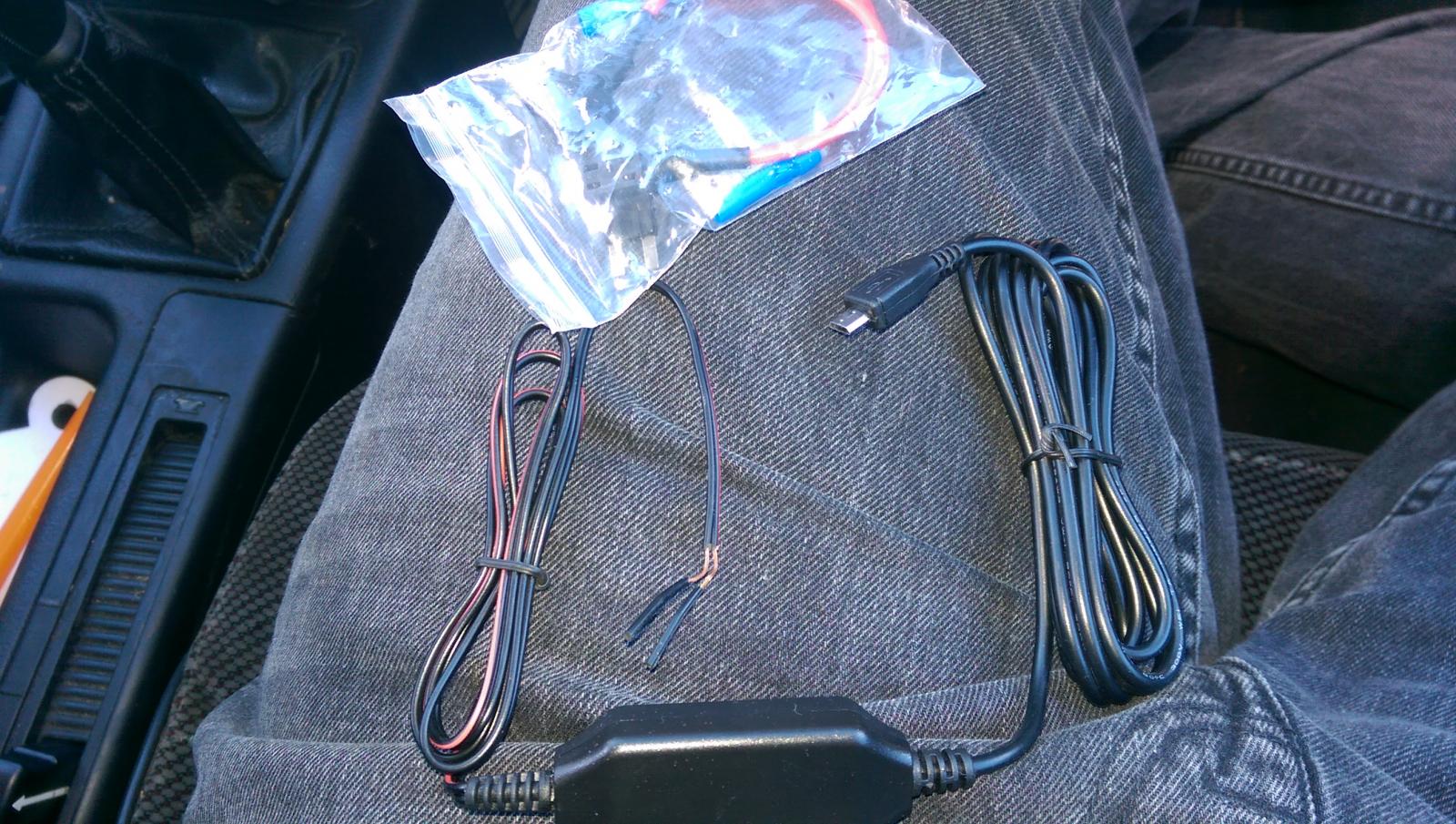

To charge the bluetooth thing, I bought a 12v to 5v1a micro usb thing
and dismantled some of the dash, hollowed out the blanking plug next to where I'd positioned the bluetooth module and fed the wires through
It earths off this bolt I found
and for now takes its live feed from the dashboard light adjuster, which means it only has power when the lights are on, but that stops it being permantly live, and it seems to run for a week ro so on a charge, so should be ok. I'll change it if it's not
The only slight issue is the aux will only select if something is plugged into the front aux socket... I'll work out a way to make it work without one day, but the chopped off plug works well at making it work
but then I tucked another aux lead into the dash to power my mp3 player, which still gets used lots, so as long as their not both on at the same time, both can live in harmony, and I have 2 aux inputs now!
Dismantling the dash did reveal that alot of it is broke, so if anyone is ever scrapping a xantia, I could do with lots of bits (and a new heater selector unit as I bloody snapped the knob off for the fan speed... it can be moved with care using the broken knob, for now I've put it into auto mode so it wont be so bad...
Billy bonus (ish), when I get a vent phone holder, the charge cable reaches perfectly, so I can charge my phone up by unplugging the bt thing, plugging my phone in and turning the lights on. But I don't charge my phone that often in the car, if I start needing to I'll hunt out a fastcharge car kit

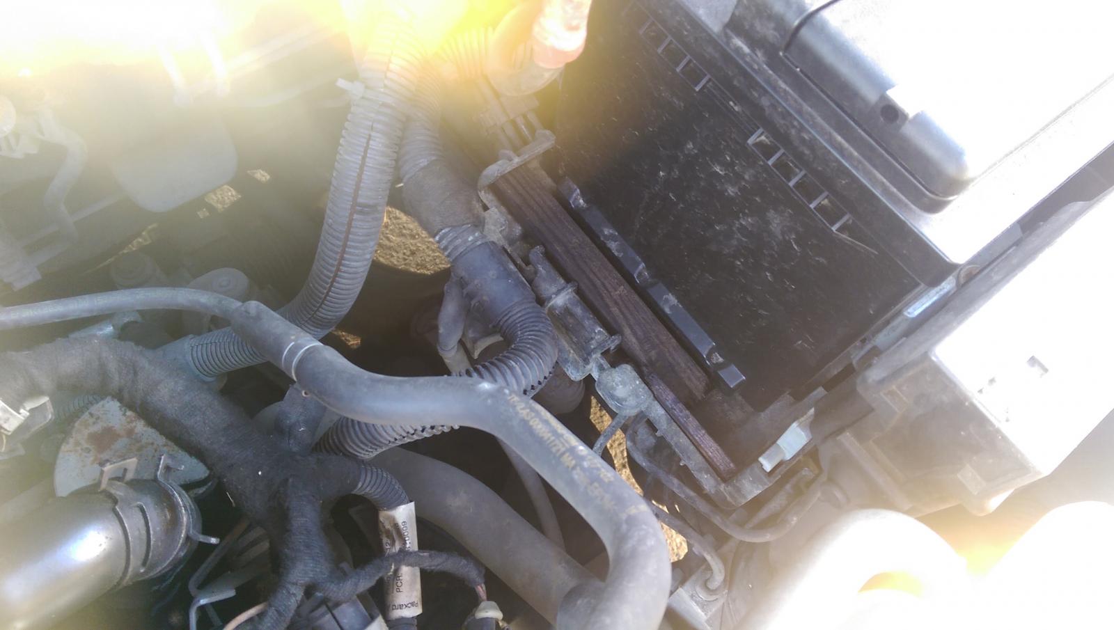

refit ait box and battery tray
refit battery tray
