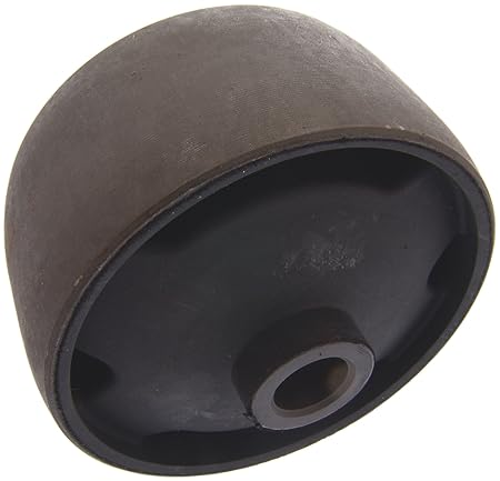

tooSavvy Posted March 8, 2018 Author Posted March 8, 2018 I have discovered my Front and Back Void Engine Mounts are split/knackered...When I'm cranking/firing up the engine has been 'ka chunta chunta chunta' and heavy vibration has come up the wheel from the bulkhead >> goes away as soon as it fires BUT if I'm creeping along in 1st and its cold the whole engine/tranny will 'hunt' a bit Tootles up to my local MOT mukka, I rev the engine against the handbrake and he gives me the verdict.However... I discover... these engine mounts (likely other Fabricated ones) have a steel tubed rubber bush pressed in  I have the part number for both and have set Mick's Garage* away to see if they can source some.They are on the web @14Euro ish but I would rather just get the one hit + boxed & delivered  *EDIT... No! They cant supply anything for me...  However, my M8 in Ireland has a 'breaker' and I have asked if he will sell his old ones. The engine, in ToMM©, is rather like the HC Viva... Totally lost in the engine bay = the engine mounts are in free air and the garage guy says they will wizz off quickly (see less£) Gudd GuddTS egg and Lacquer Peel 2

tooSavvy Posted March 9, 2018 Author Posted March 9, 2018 Seems that Blueprint ADT-380166 Corolla will do for the Front Mount (under rad). As far as I can establish, the actual 'pressed-in' rubber bush is the same as my Carina II - so if the pressing won't line up then the bush can be swapped. What a faff-on  ... no fun, otherwise!  TS
